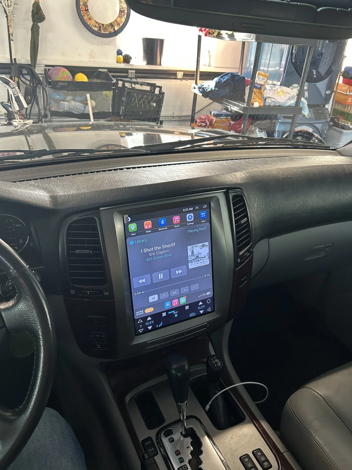

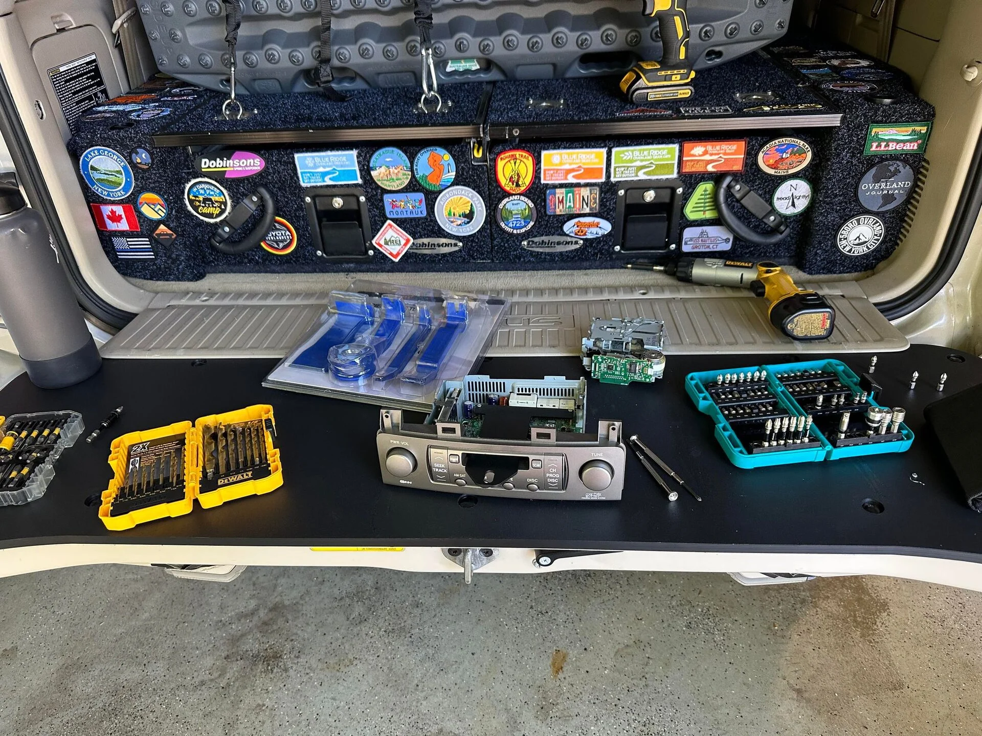

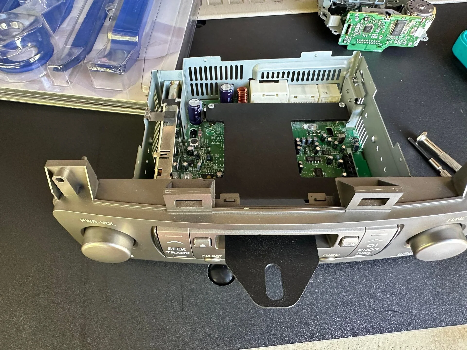

New radio with CarPlay!

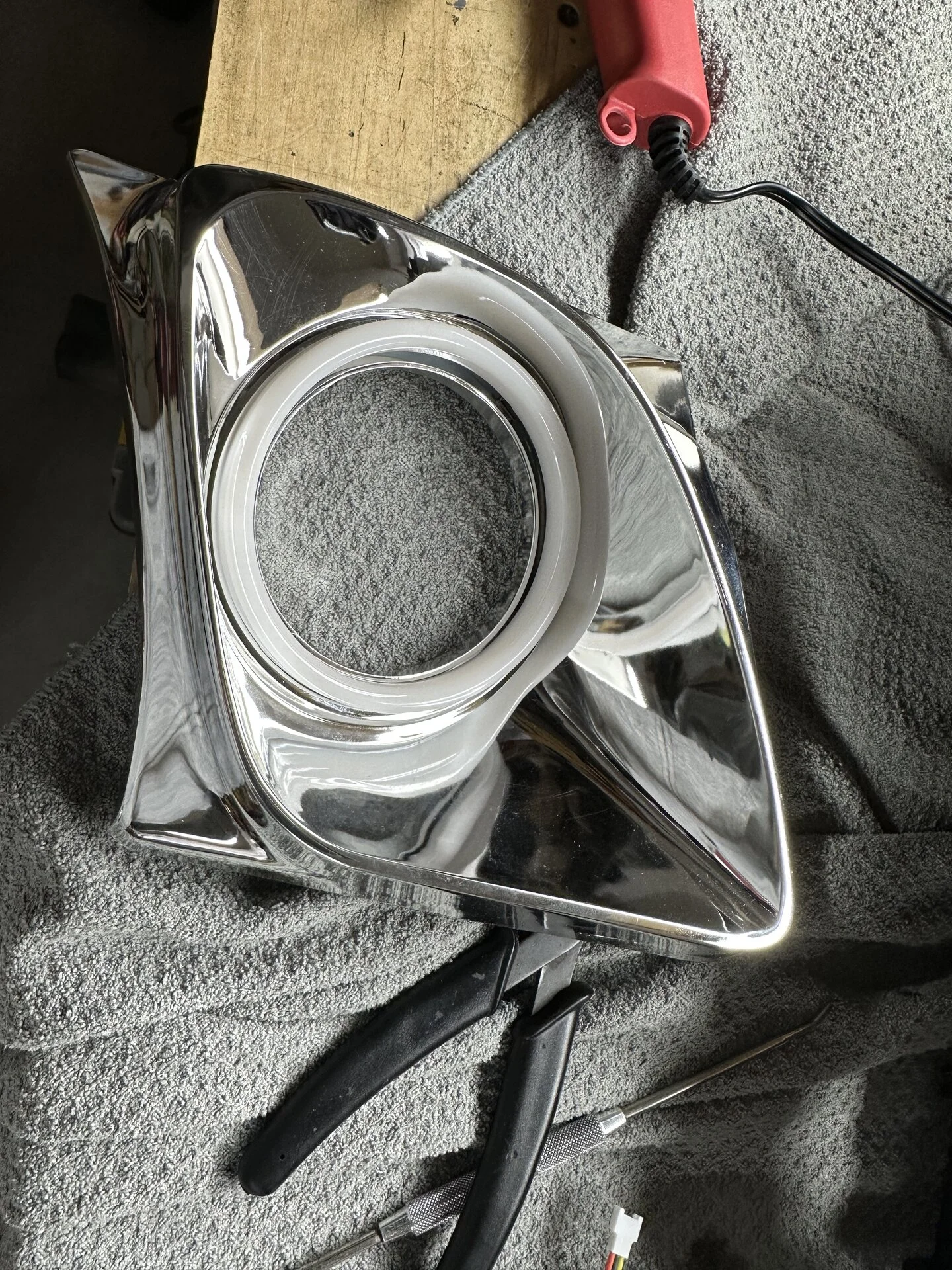

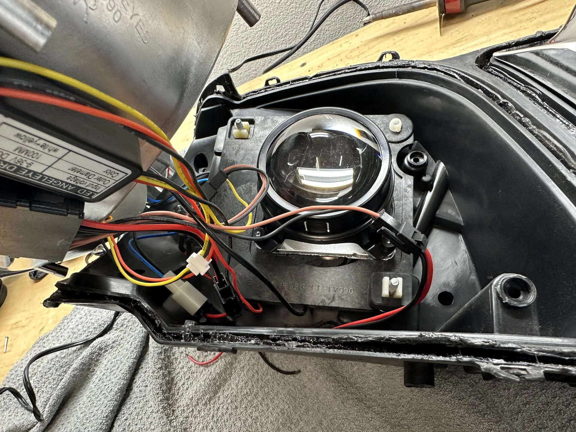

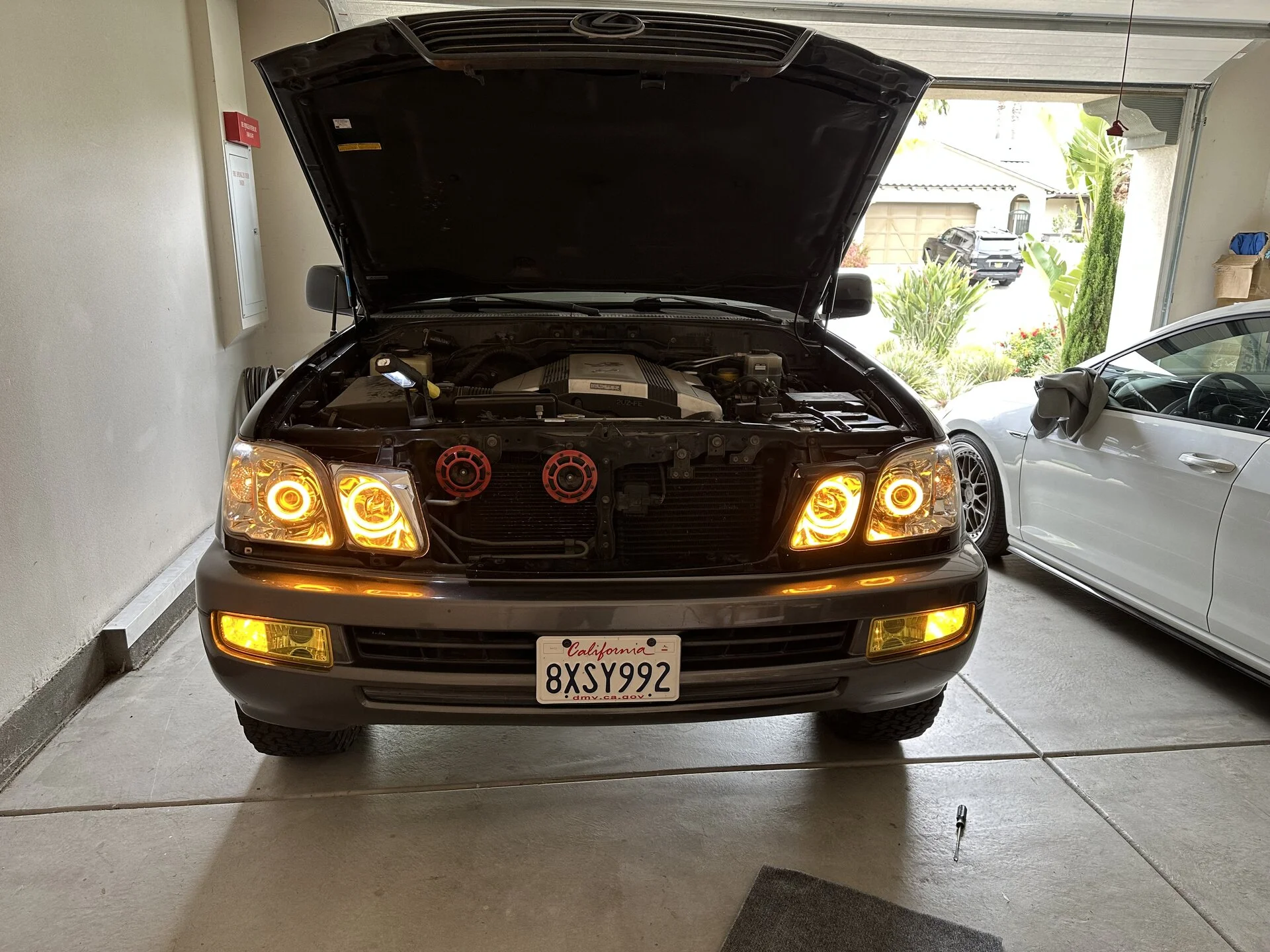

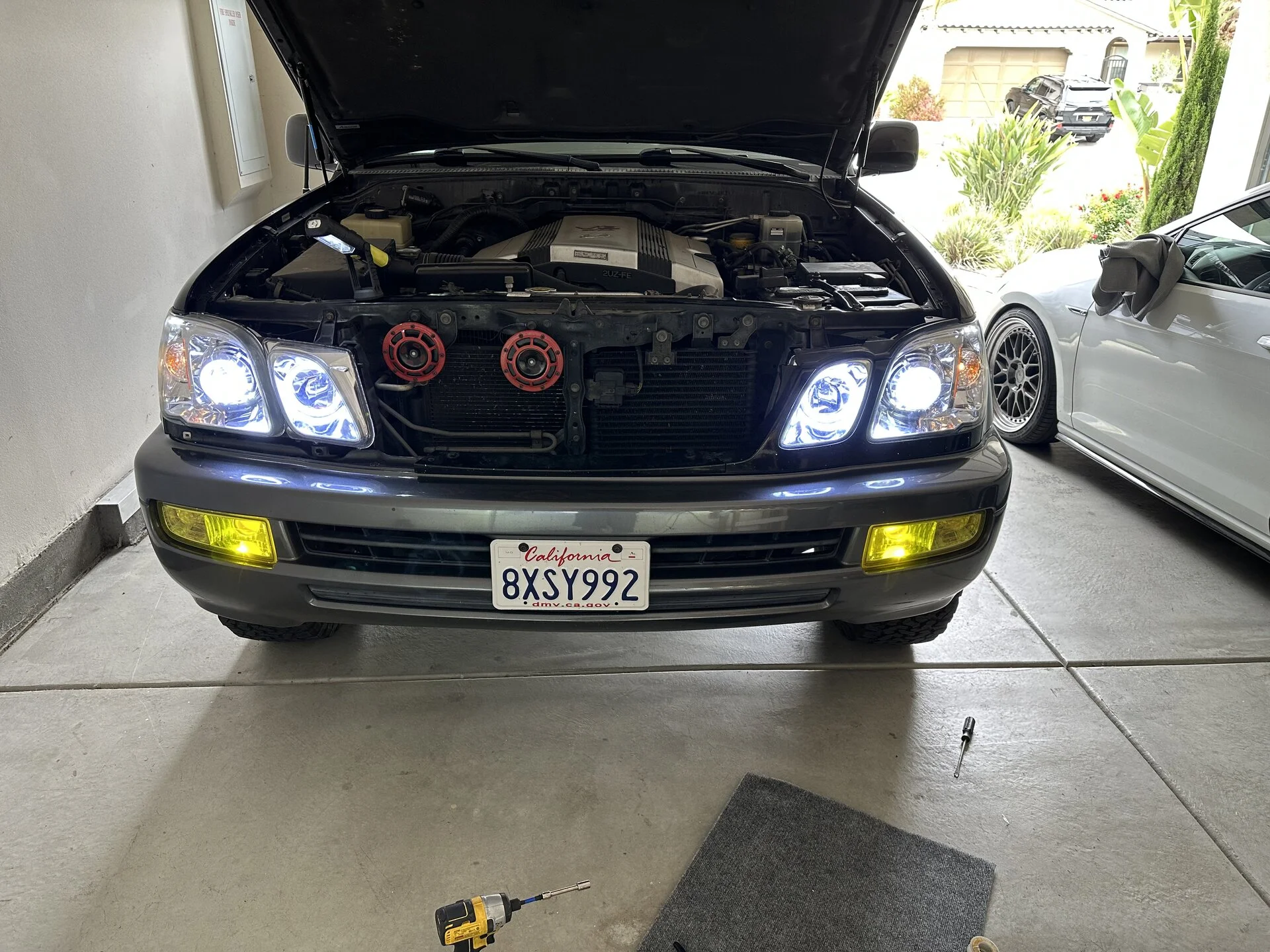

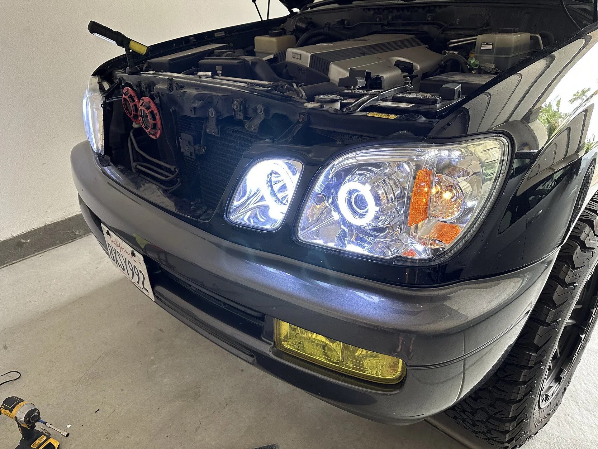

Well i finally got off my butt and replaced the stock halos on these aftermarket LX headlights. Bought some switchbacks off Amazon and wired them up. The DRL are wired to the side markers but I’m thinking maybe wire it to and ignition on fuse so they truly can be DRL. These halls incorporate some sort of voltage regulating box, i just tapped into the turn signals in the bumper and it worked fine no hyper flashing.
The internals of these aftermarket headlights are something else

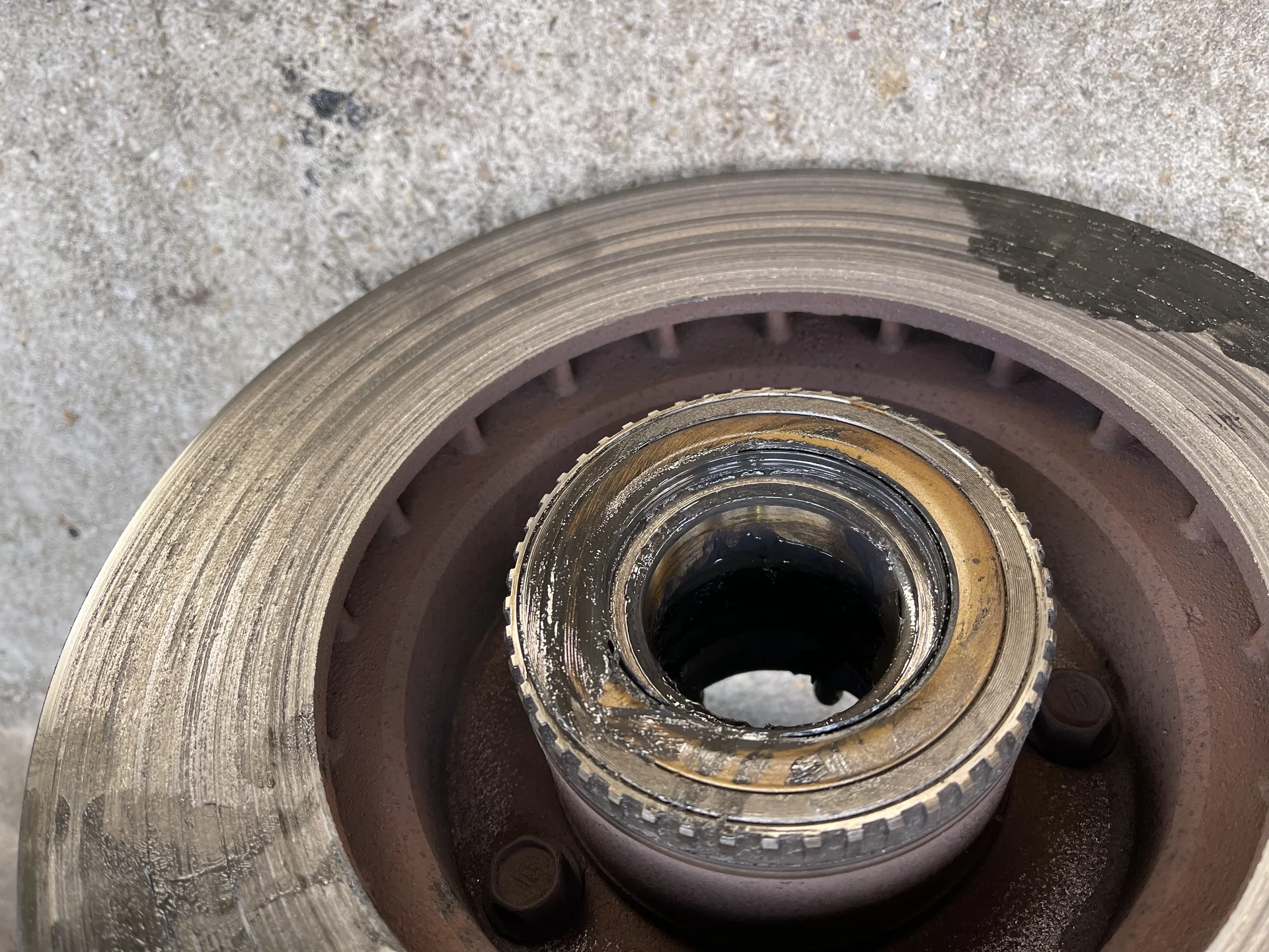

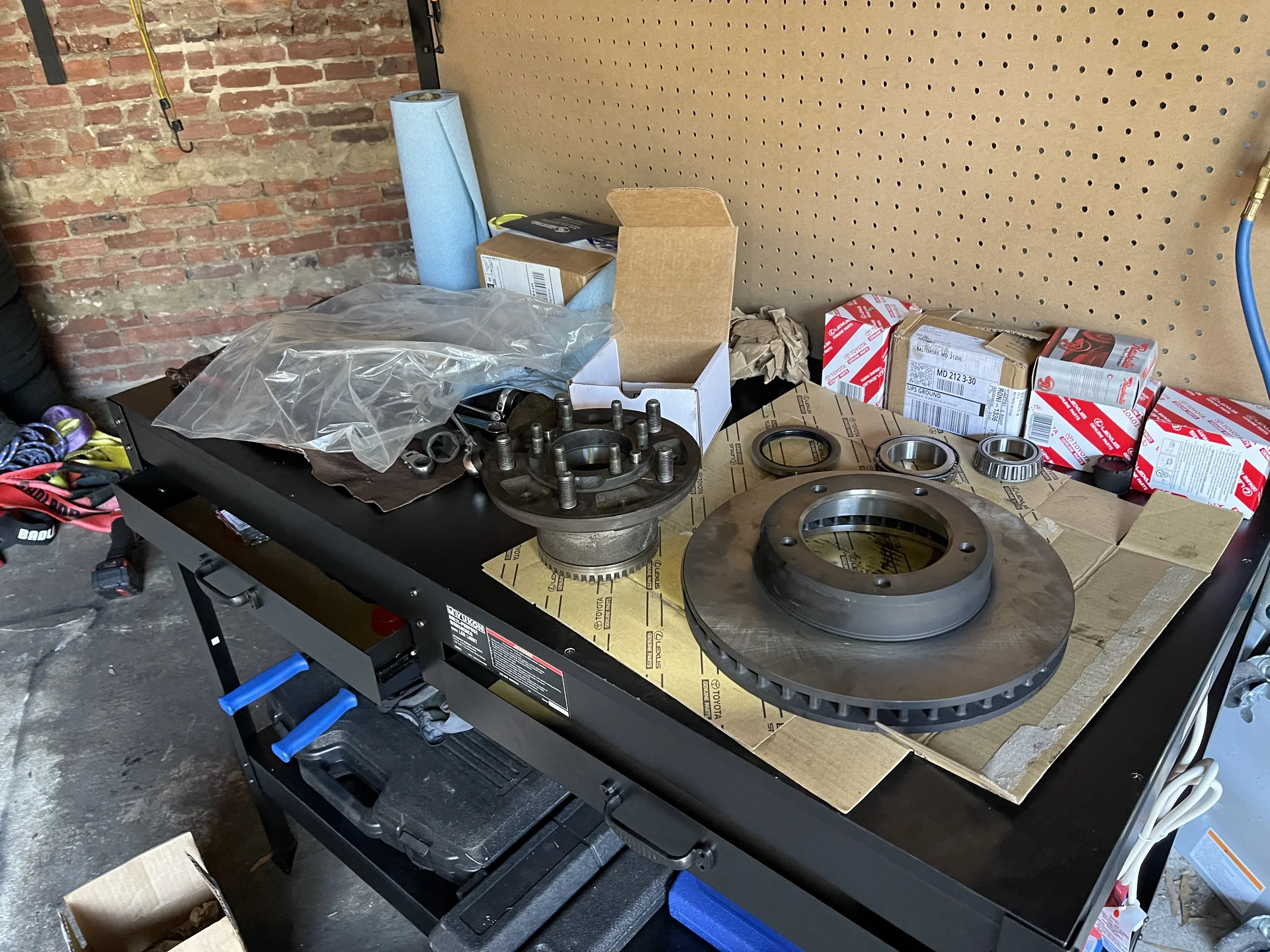

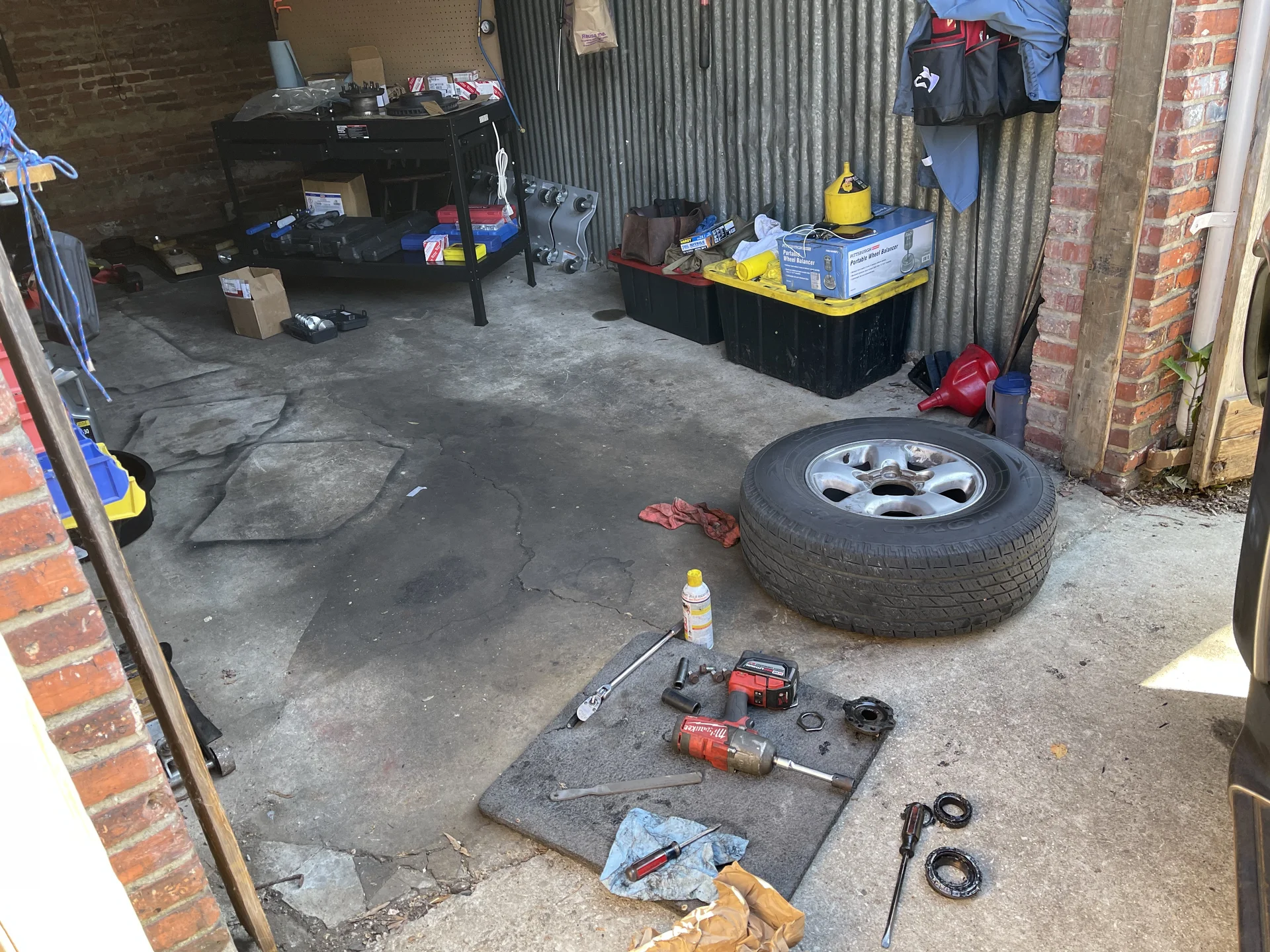

I replaced driver's side rotor and installed KOYO kit with the races, inner and outer wheel bearings. I used TIMKEN grease. I cut the large race and followed the method of using the old race to punch in the new one. On the other side I had a perfect race driver to fit that one. I was pretty filthy and exhausted after the one side, so I plan on doing the other side tomorrow, which does not include a rotor swap, so will be easier.
This was my first time doing the procedure. I followed some REALLY helpful guys on YouTube who take you through step by step. I could not have done it without their help. 2nd Gear Low had a video that was amazing.
all in all very proud of myself. I was a little annoyed with the bending tab washer. I was only able to get it to bend out flat against the outer 54mm nut. I bent 2 other tabs inwards, but they didn't really lay flat because of how the 2 54mm nuts were not lined up. I followed torque specs and everything else to a T. I took my time, and the job was pretty simple. I was worried my rotor would be seized to the hub, but it came off just fine.
went back in the garage early today to do the other side wheel bearing. the procedure was successful. I then went back to the other side, just to double check, that I bent the tabs back correctly on the star washer, which I did. I'd say I performed the procedure flawlessly. I used the best bearings I could buy, KOYO, and I used a brass punch while getting out the races. I love the Land Cruiser I want to make it last as long as I can.

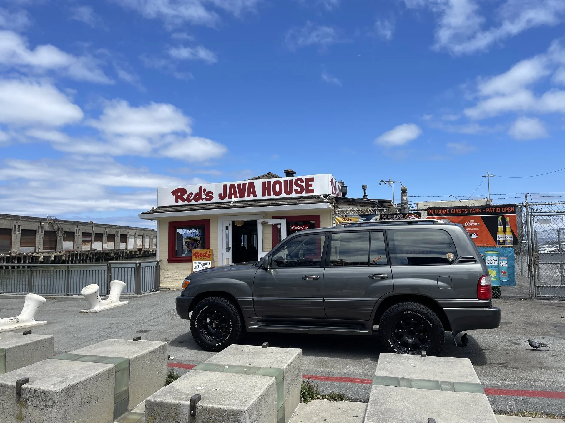

Freshened up fluids under the hood. Brake, AHC, Radiator, Power steering. Then poured a bottle in of my favorite fuel injector cleaner Red Line/ topped off with super and drove into the City for a Hamburger. Yes, it was a tasty burger.

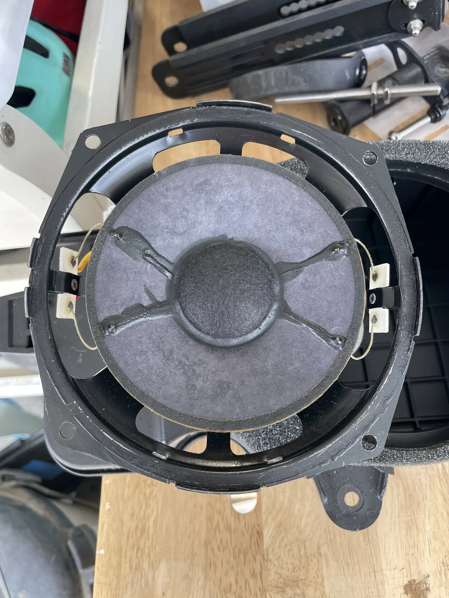

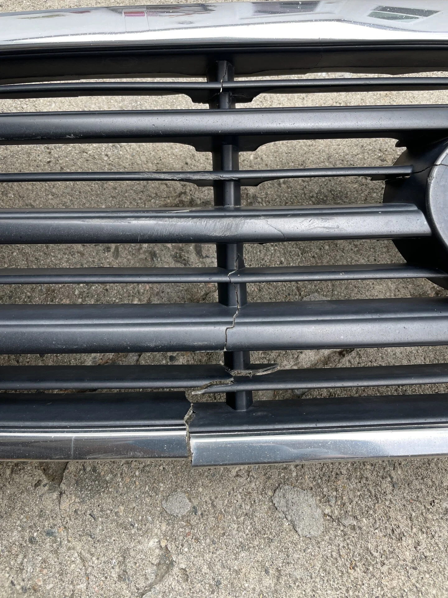

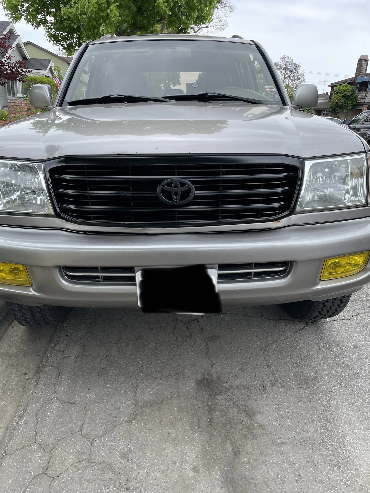

Fixed my cracked grille the best I could then painted the whole thing black and prepped my sub for the new foam surround that should be here tomorrow.

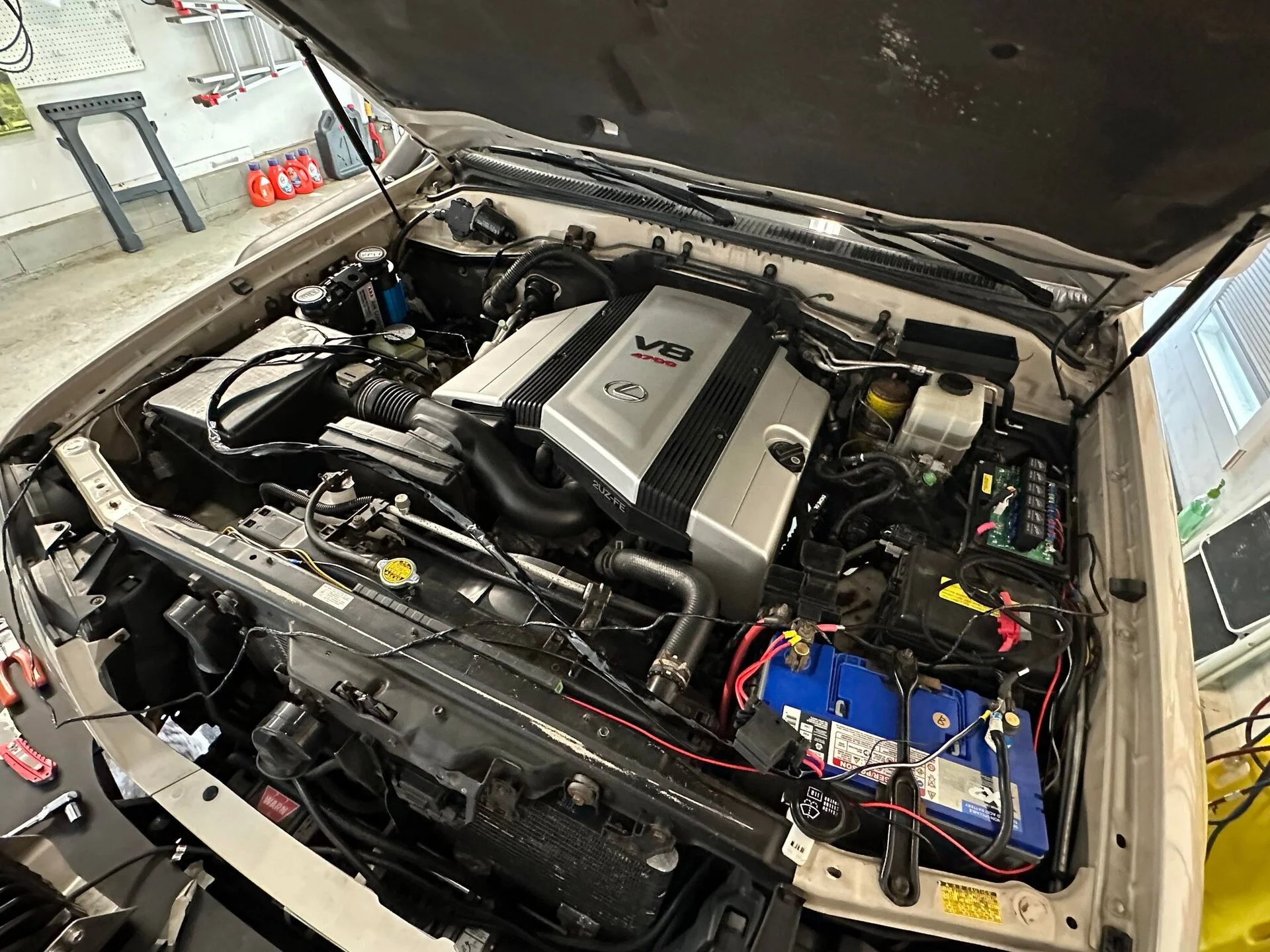

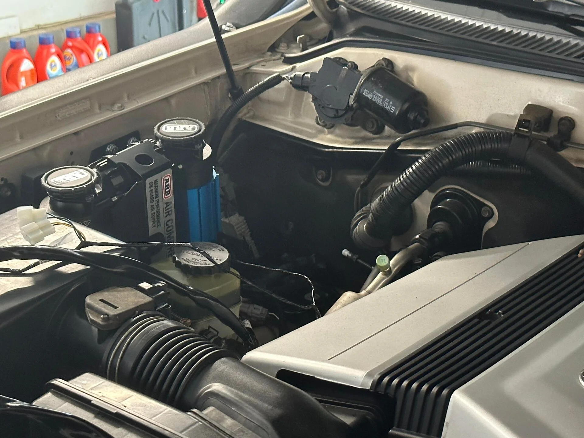

Installed some of my stuff from owl expedition. Media mount and ARB dual compressor mount. I wired the compressor to the sPod and install was super easy. Media mount will be used with my garmin overlander most likely. I hate it, but it's good for when you don't have cell service.
Wires aren't cleaned up yet in the pic. Rest assured, it's a clean install now.

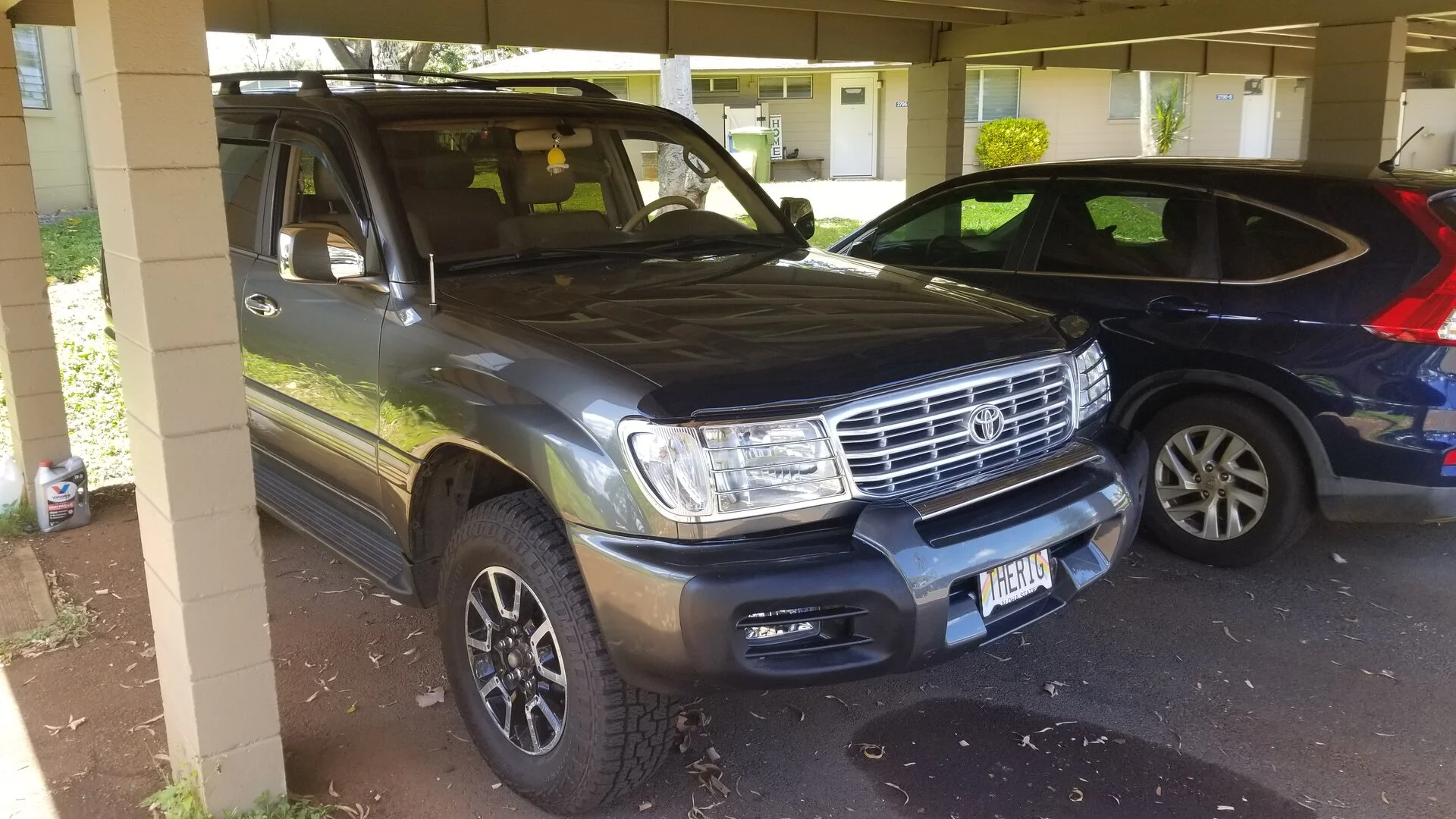

Let my buddy borrow The Rig last week, but just before I did the cheap Chinese antenna replacement broke. So while it was out I ordered an OEM replacement.
Today I got it back, and set to pulling the broken cord out of the mechanism, and replacing the antenna again.

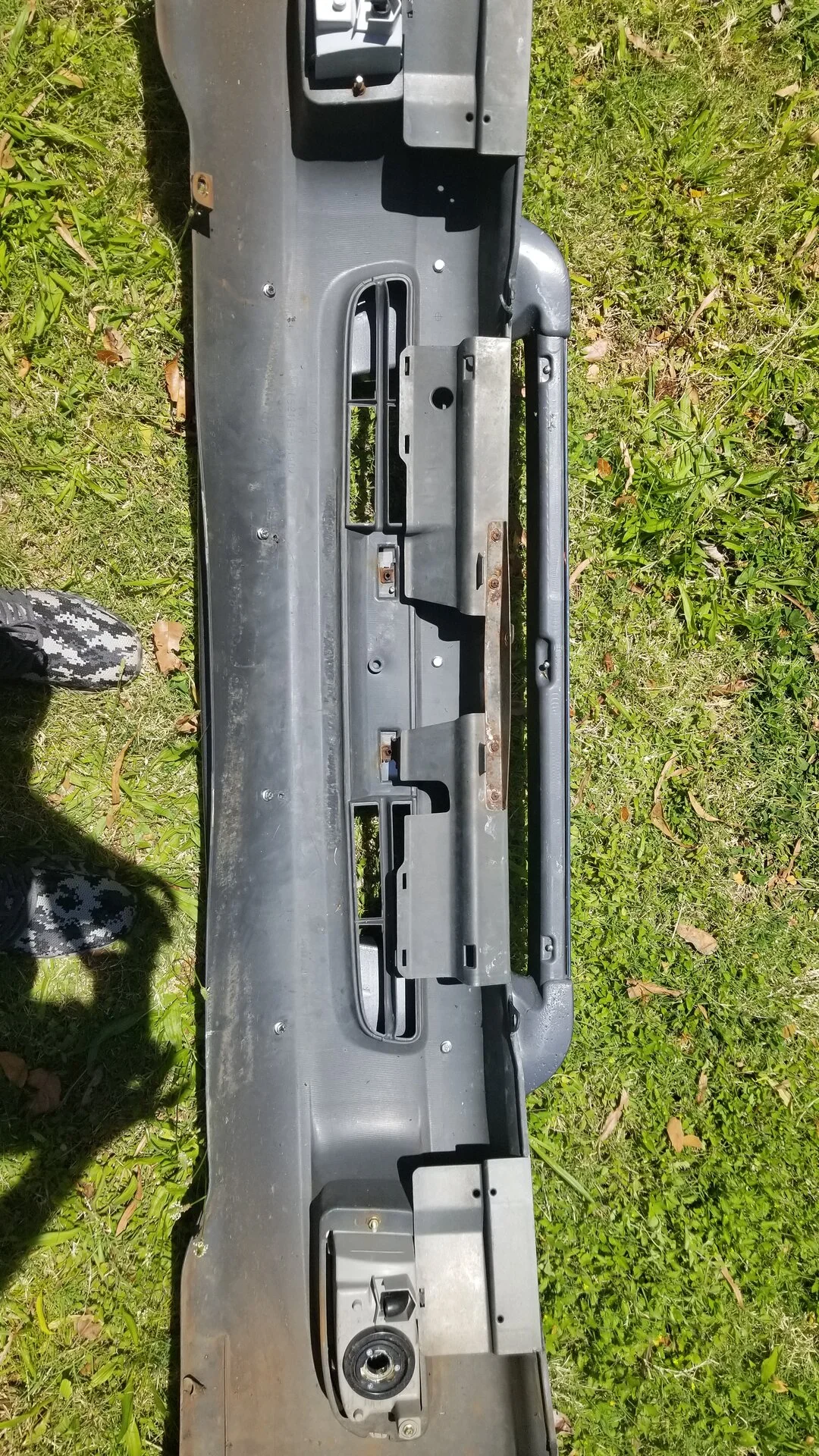

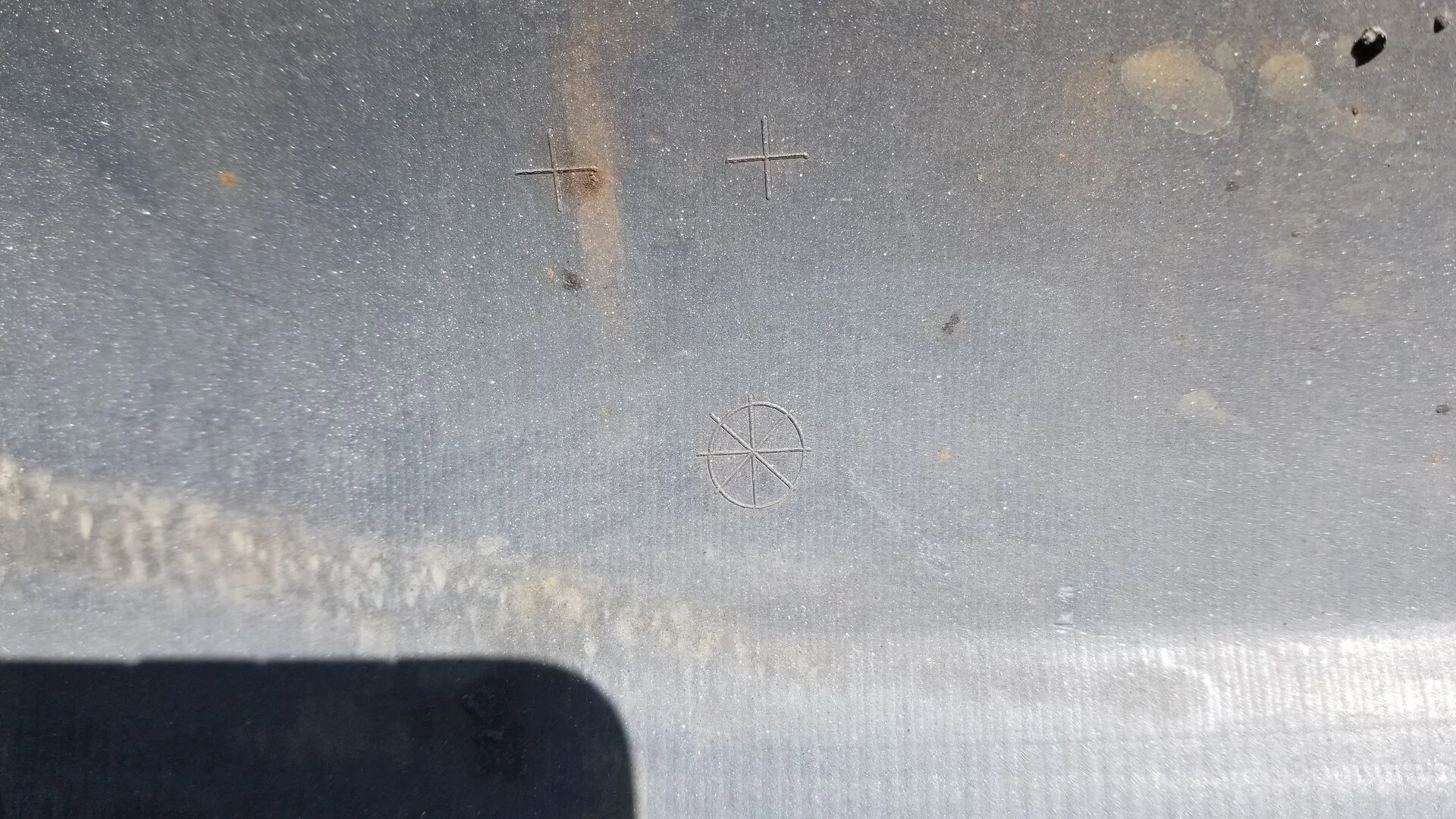

Once that was done I decided to finally install my bumper guard. Realized after getting the bumper off that there are ready-made spots (double-cross in a circle) to drill in the bumper to install it (it's an Asia/Europe factory option), and went easy mode. Total time to take the OG bumper off, drill holes, install the guard, and reinstall was maybe an hour.
I realize the look may not be for everyone, but I dig the hell out of it, and it works for my practical needs (access roads, just trying to keep the fogs and headlights relatively protected from branches).

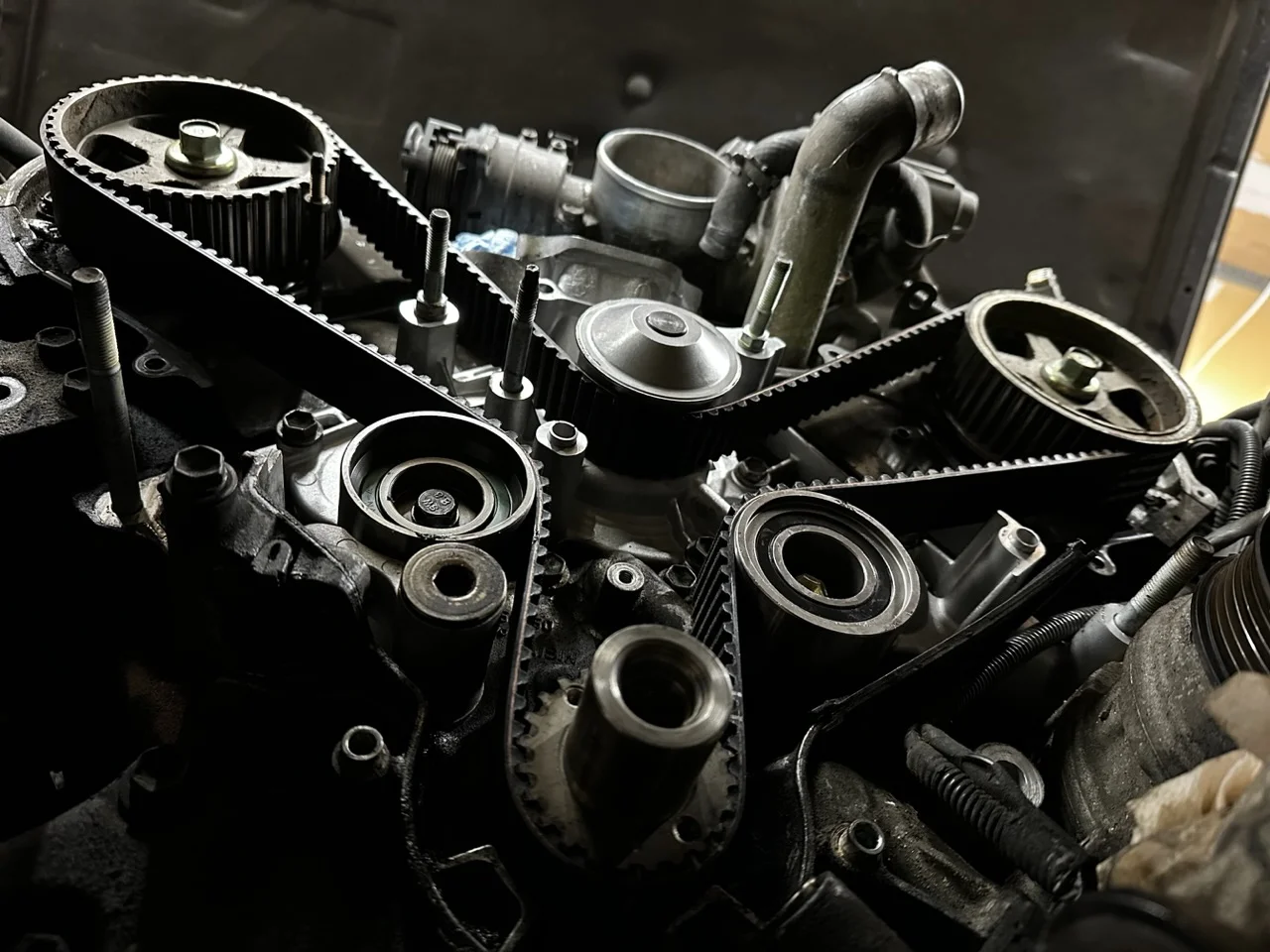

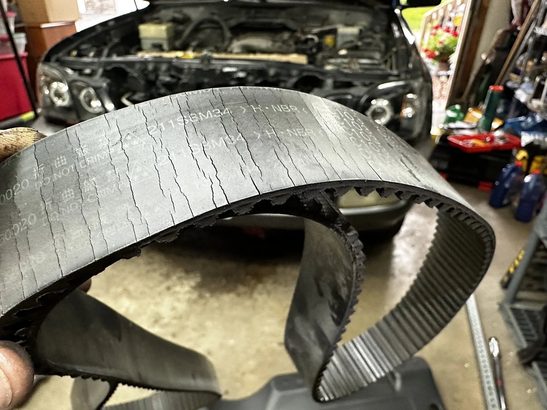

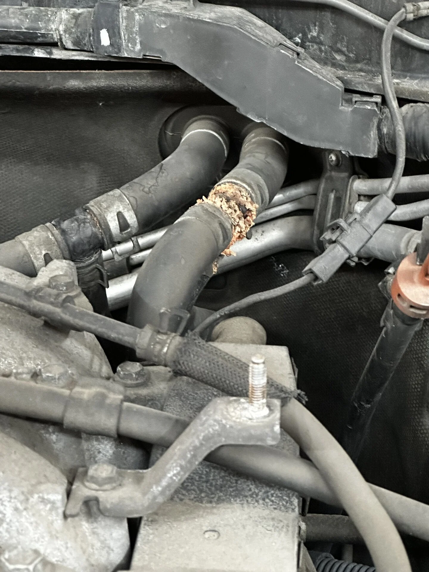

Not much of a holiday weekend, but a productive one. Changed t belt, s belt, plugs and coils. Also the heater Ts. Good thing I got to them now; I had the driver side tee crumble in my hand, right as I was unclamping and twisting it out.
This was a heck of a project! Many thanks to @spressomon, @scottm & @BnvS for their helpful t belt write ups. And of course @OTRAMM ’s YouTube videos.
If you’re wondering, my hundo
is a 99 LX with 292,300 on the odo. Yes, that 90k t belt interval went a skosh long.

The form factor of that bumper looks pretty good; I think I would like it better if it held a concealed winch within the extra girth.
Me too, but itll be a bit before I have the funds to grab a winch and try to fab something up
