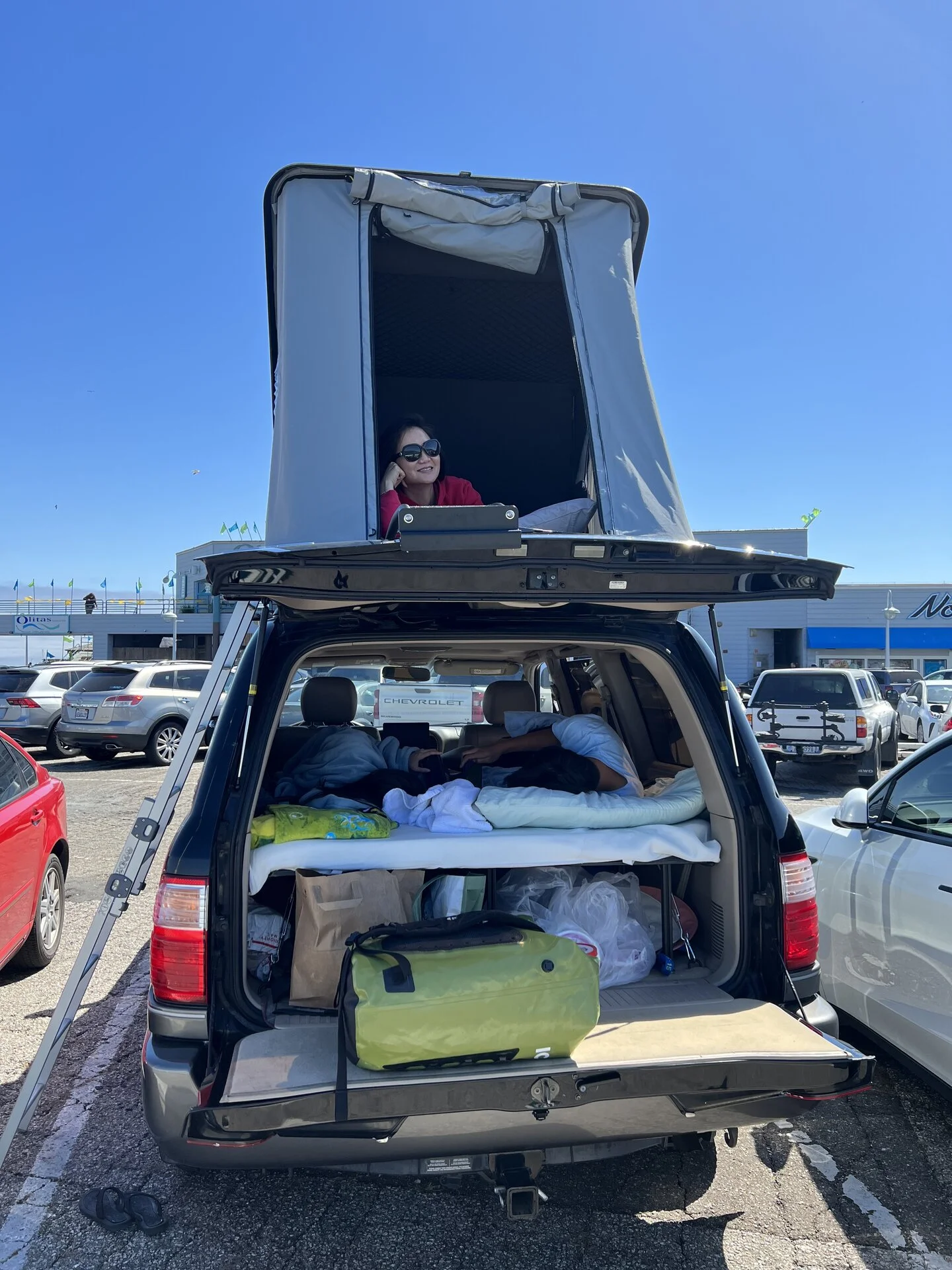

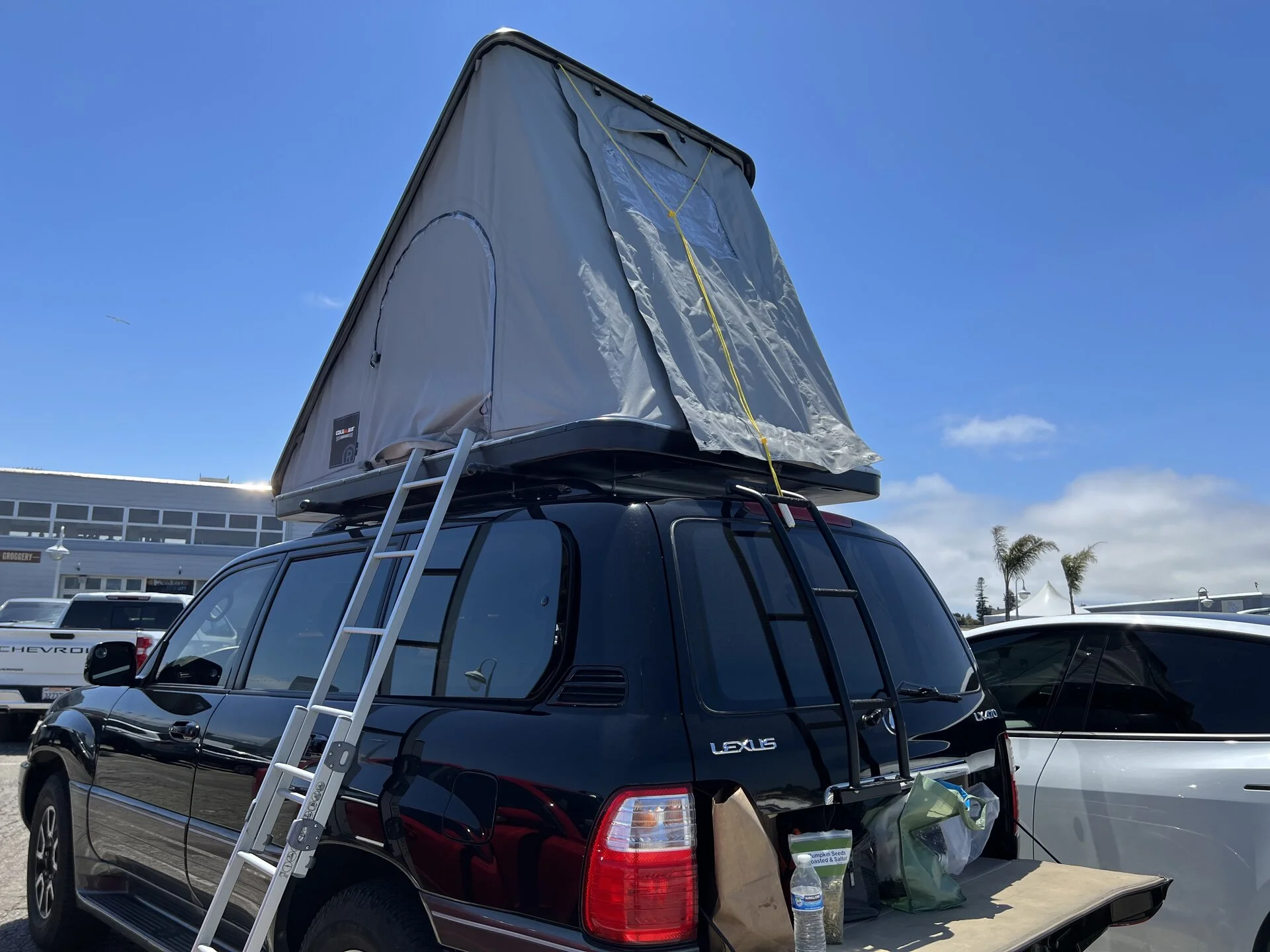

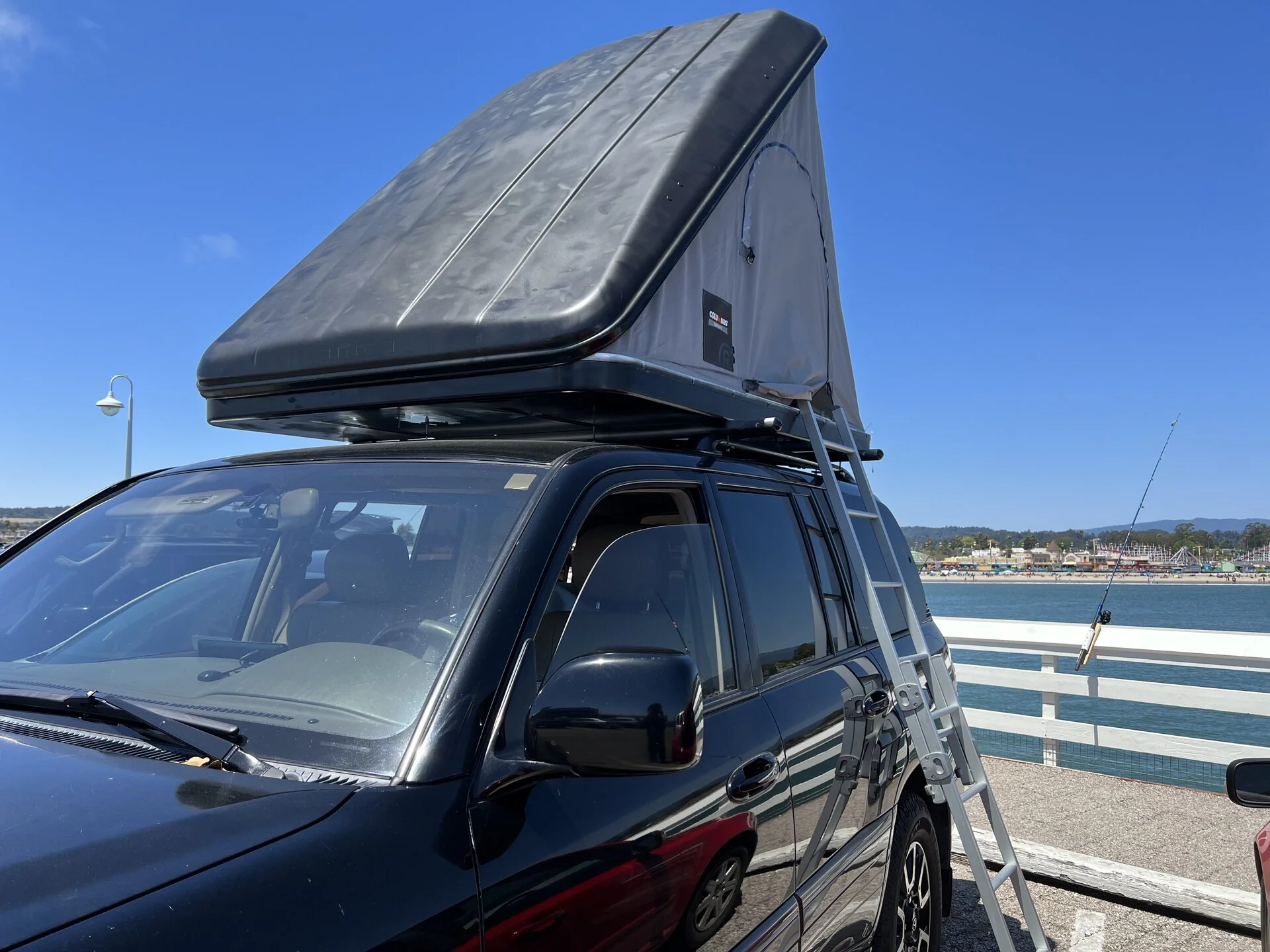

installed the Autohome Columbus rtt (i used plasti spray to make it back as my LX color), Gobi ladder, and first try out at the beach :)
ClassyJalopy, i use the SSP1 from this:
with a queen-size 3-inch tempur mattress topper.

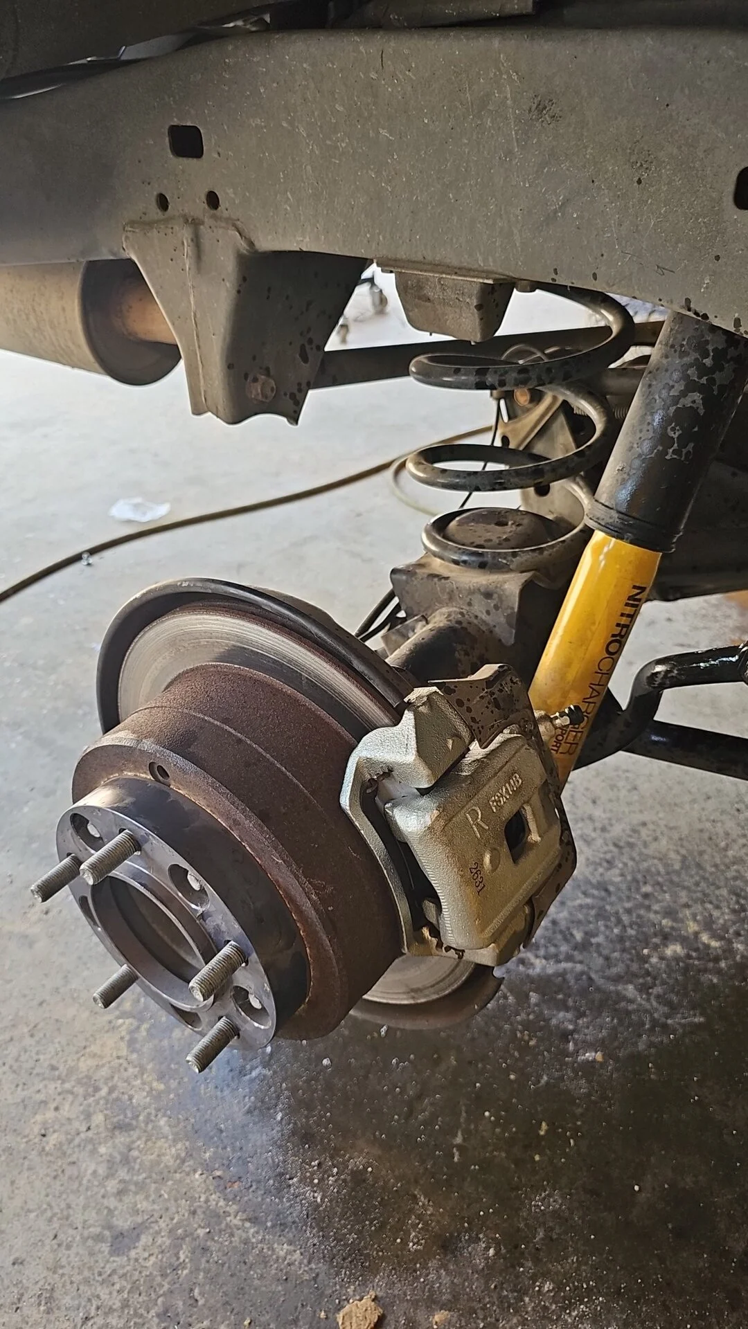

Does anyone know the exact size of the bolts that hold the rear sway bar bushing to the axle? Part #90119-08834. I can’t find the info anywhere.
TIA!

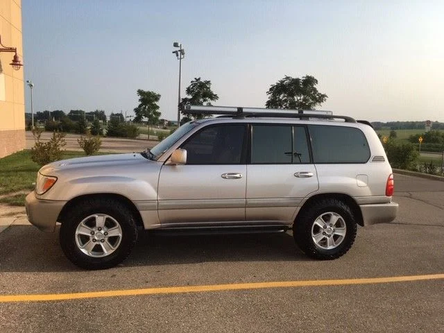

I put on a few more "trust miles" after chasing an intermittent P0305 cylinder 5 misfire with full on limp mode for months
It would rear its ugly head only when the temps were sub zero, which is a problem in Wisconsin.
I think it is fixed now. Here is what I did
-changed the plugs
-oil change, air filter, fixed intake nipple nub vacuum leak where I broke it
-changed the #5 coil with one direct from Toyota (still got intermittent code)
-changed the coils surrounding #5 (went Denso for these), possibly 262k on them, cracked tubes
-cleaned every connector and sensor I thought might be a contributor
-Did 1/3 of the "big three" electrical upgrade, upgraded battery ground only-gained .2v at idle and .3v ish highway
-Washed it and a quick spray detailer- picked up .01 horsepower
poser pic from fall before it got real cold here
Did your P0305 stay gone? I’m having this issue now. New plugs, changed coil, swapped injector with cylinder 3, still getting code.
That seems forever ago, but I ended up changing all the coils and I believe I also found a 2 or 3 wire harness getting rubbed by the serp belt. I must have routed it incorrectly during timing belt change 2 years earlier. code has been gone ever since.

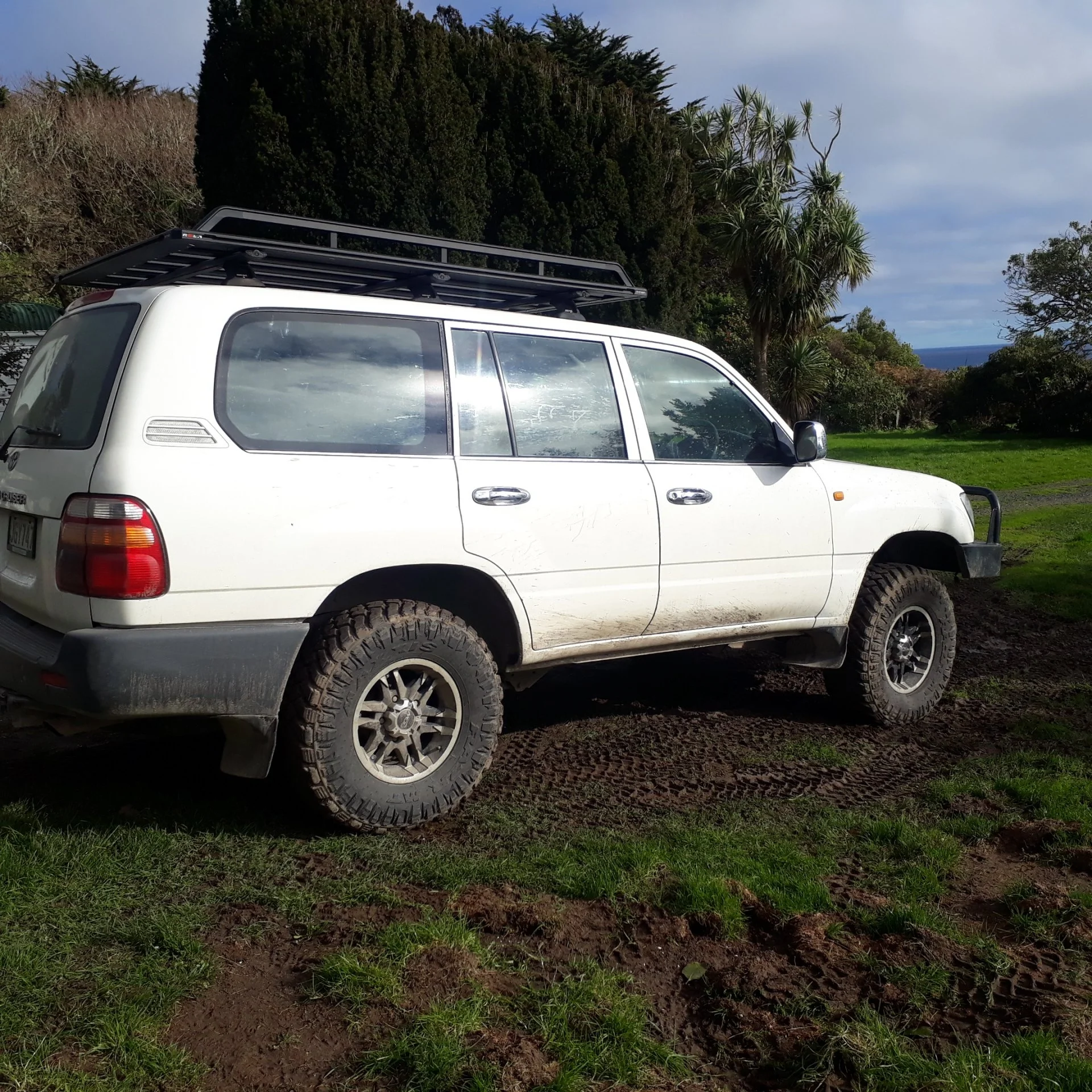

I fitted a 2 metre x 1.4 metre Rola Titan roof tray to my existing Rhino roof bars. If Rola made a slightly longer tray I would have preferred that. Sea freight for a fully made up Rhino Pioneer tray was several hundred dollars and a month's delay, so that's why I chose the flat packed Rola (as if fitted in a freight aircraft).
I also fitted LED lamps to the interior courtesy lights. What an amazing difference..... but have spent an hour trying to find the faulty door switch for the cargo door. I will have another look now that I have read the wiring diagram
Next will be LED lightbar brackets front and rear of the rooftray and a new set of diesel injectors.
How do you rate the roof rack?
Why did you go for the 1400 and not the 1200mm width?

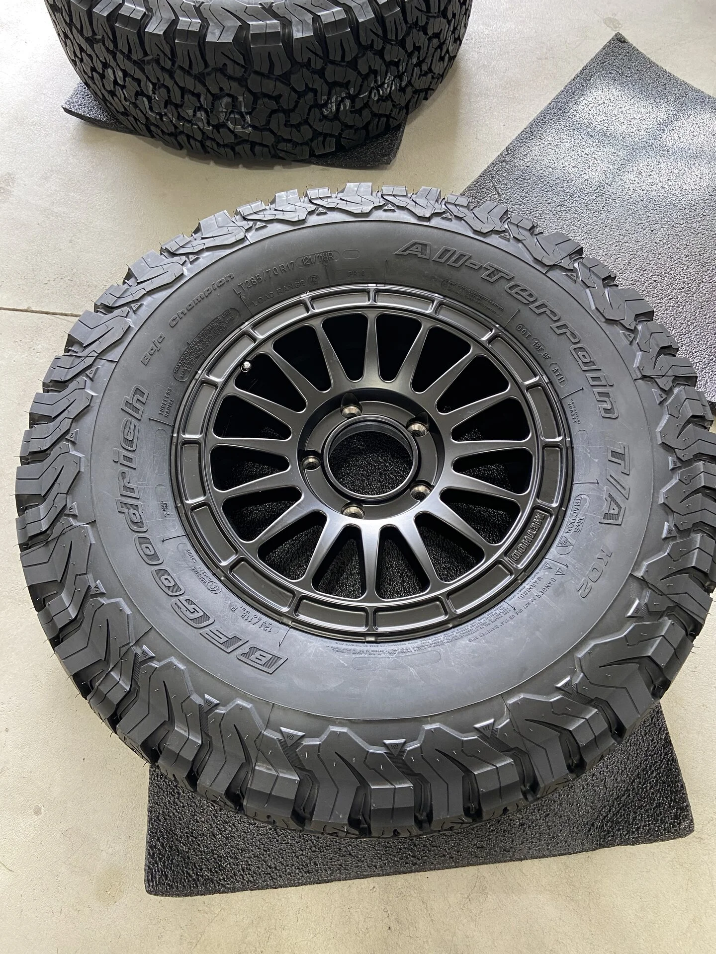

Just switched from 35's to 33's since I needed a new set of tires. Went from Nitto Grapplers to KO2's. Sits a little lower but the daily driving feels a lot better and no rubbing so far! The 35's needed replaced due to dry rot.
Did you go with the 275/70R18s or simmering wider? I have the 275s a love them. Just took a trip from SC to TN/KY/IL to MO/KS, and then Back through MO to TN/l and then through GA on our way home to SC and it ride great!
The continuous center rib on the Toyo AT/II made it a little smoother on pavement but the KO2 has better off road traction, hands down!

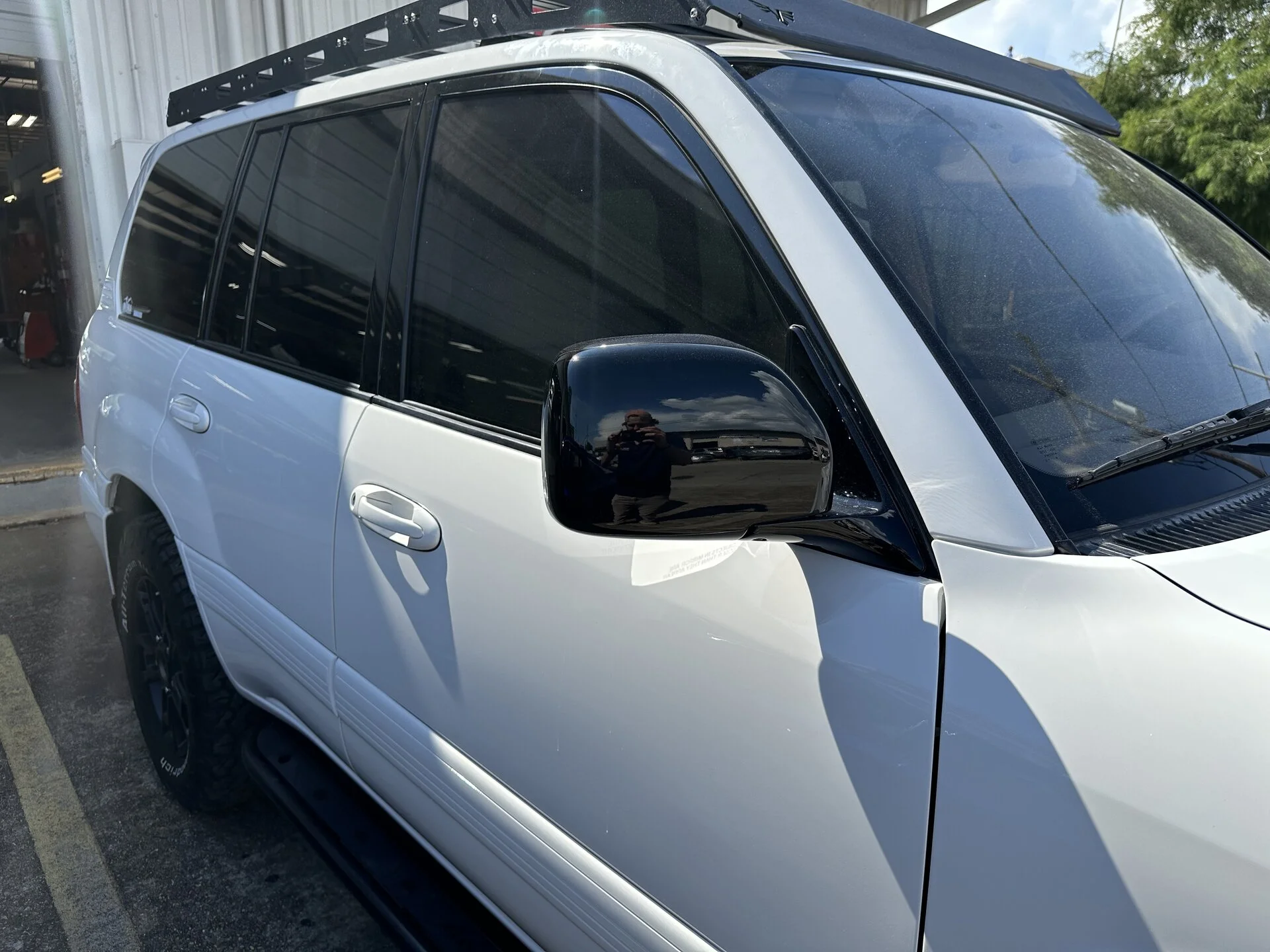

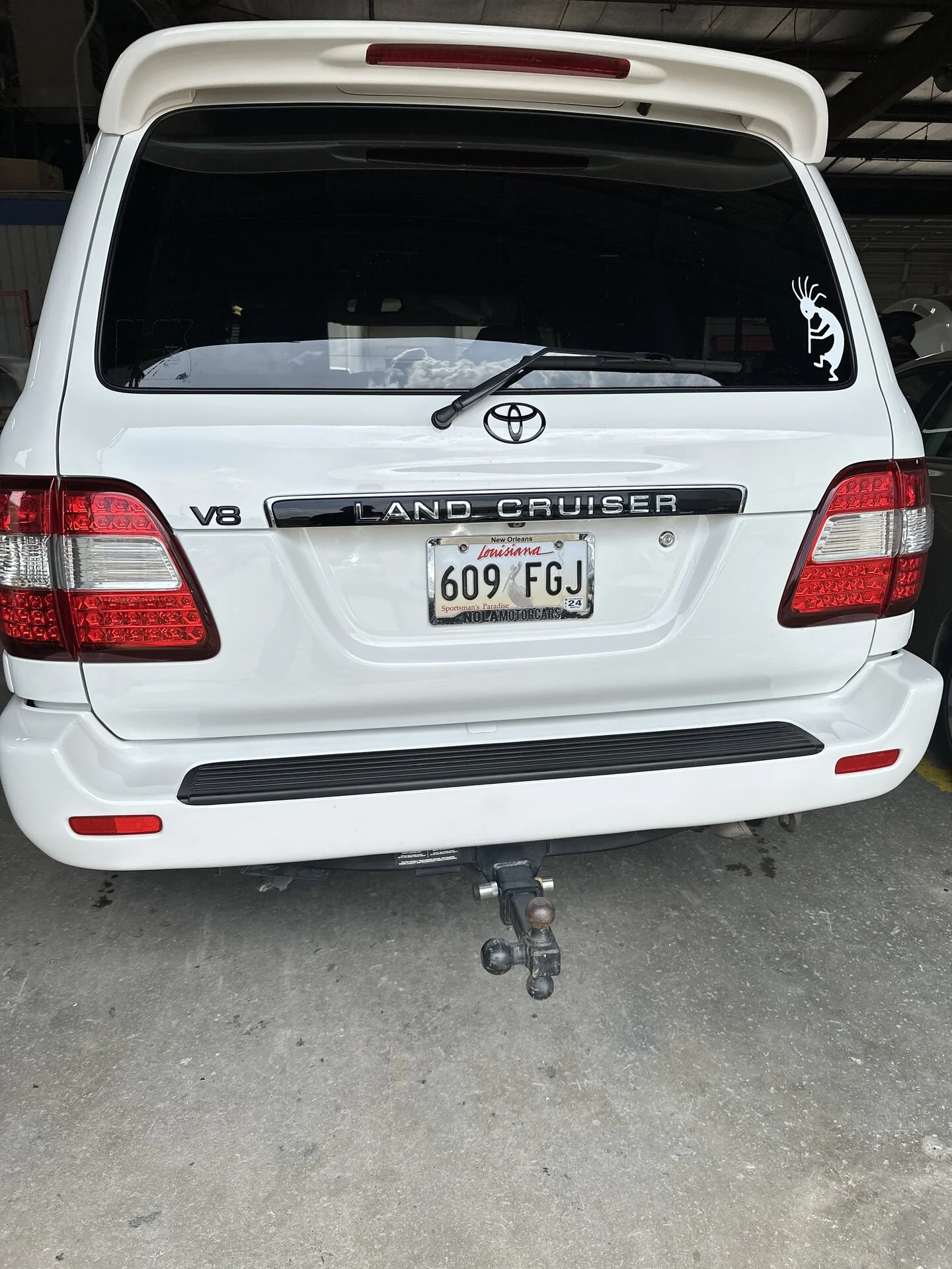

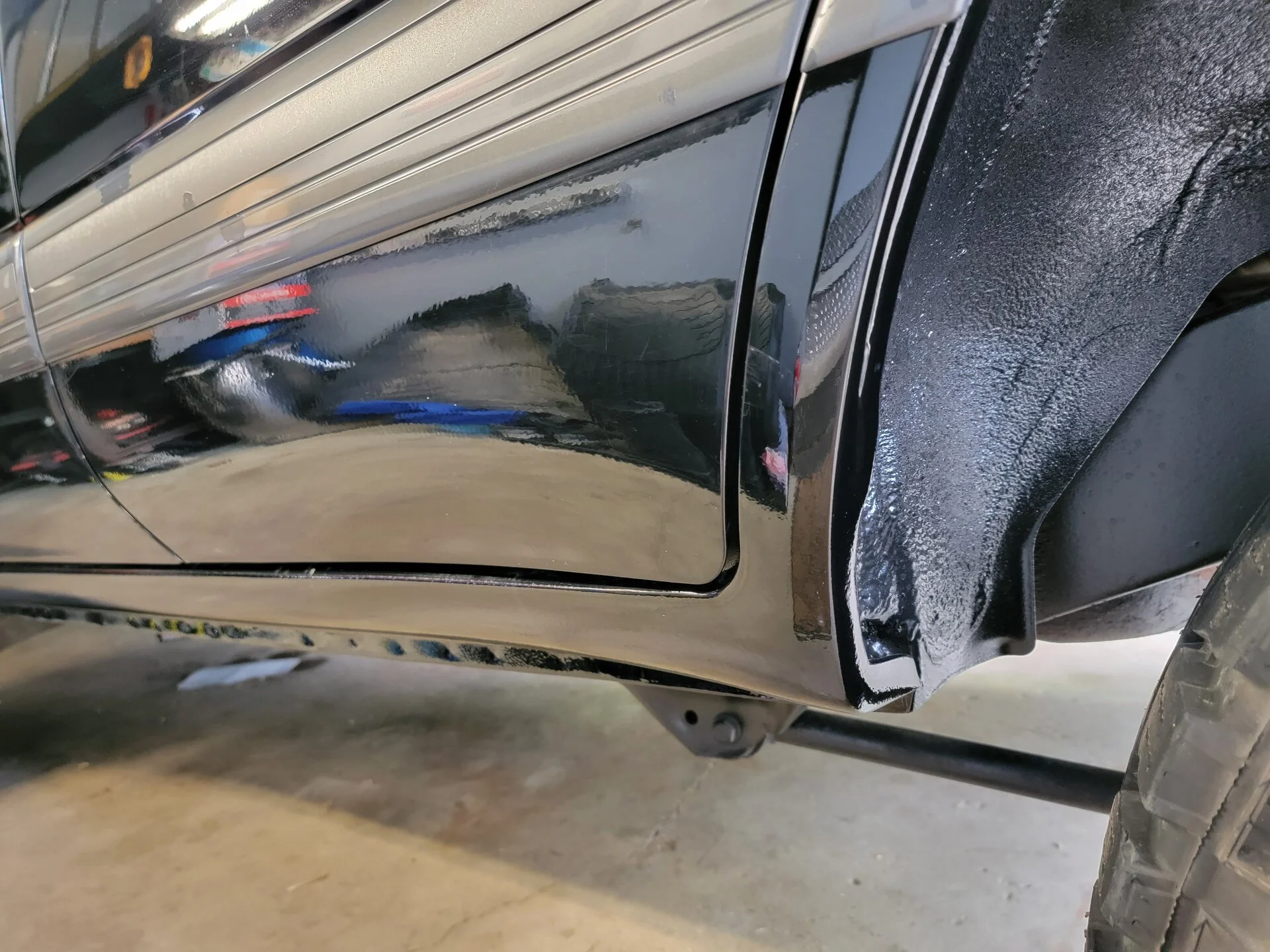

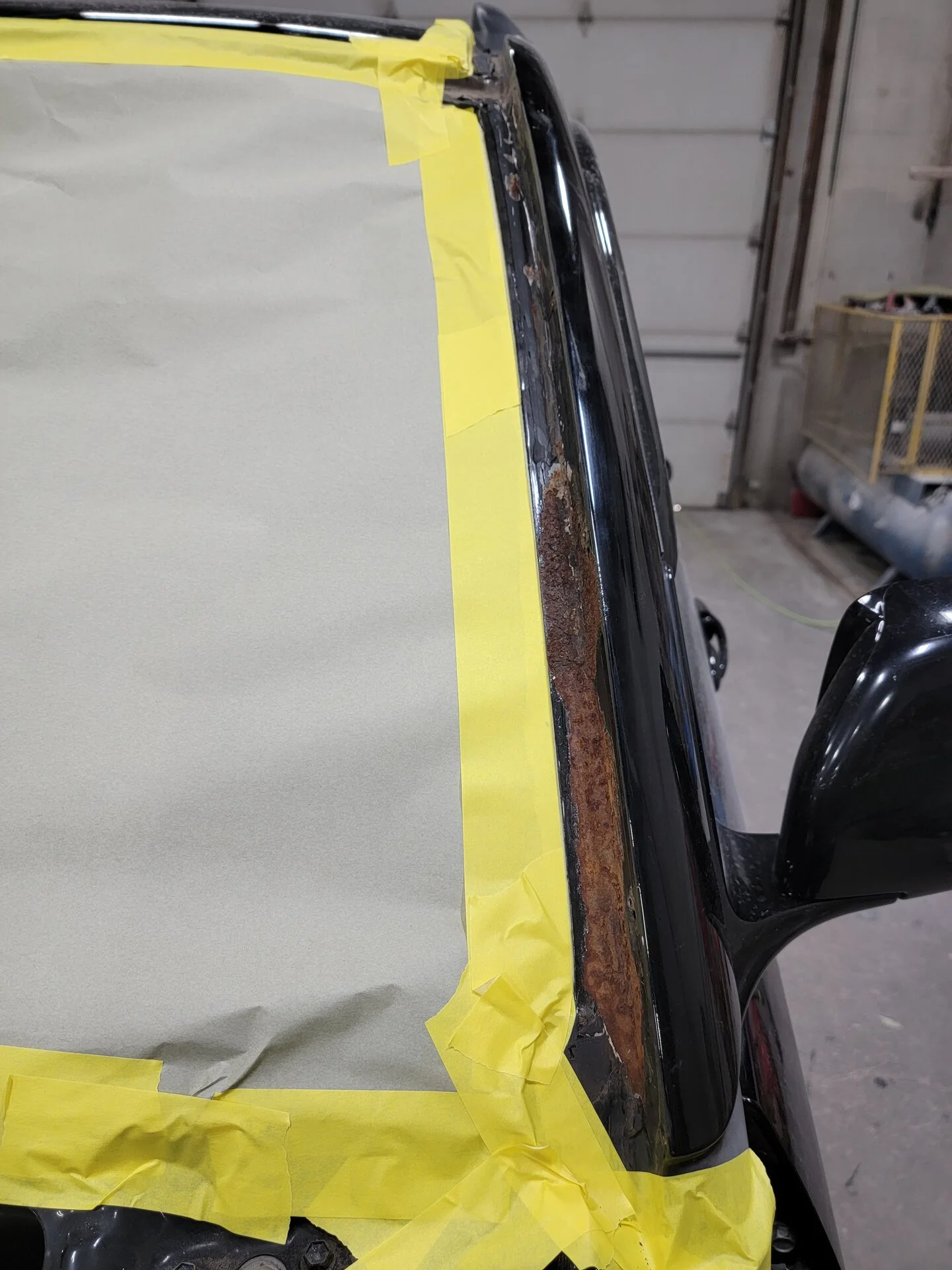

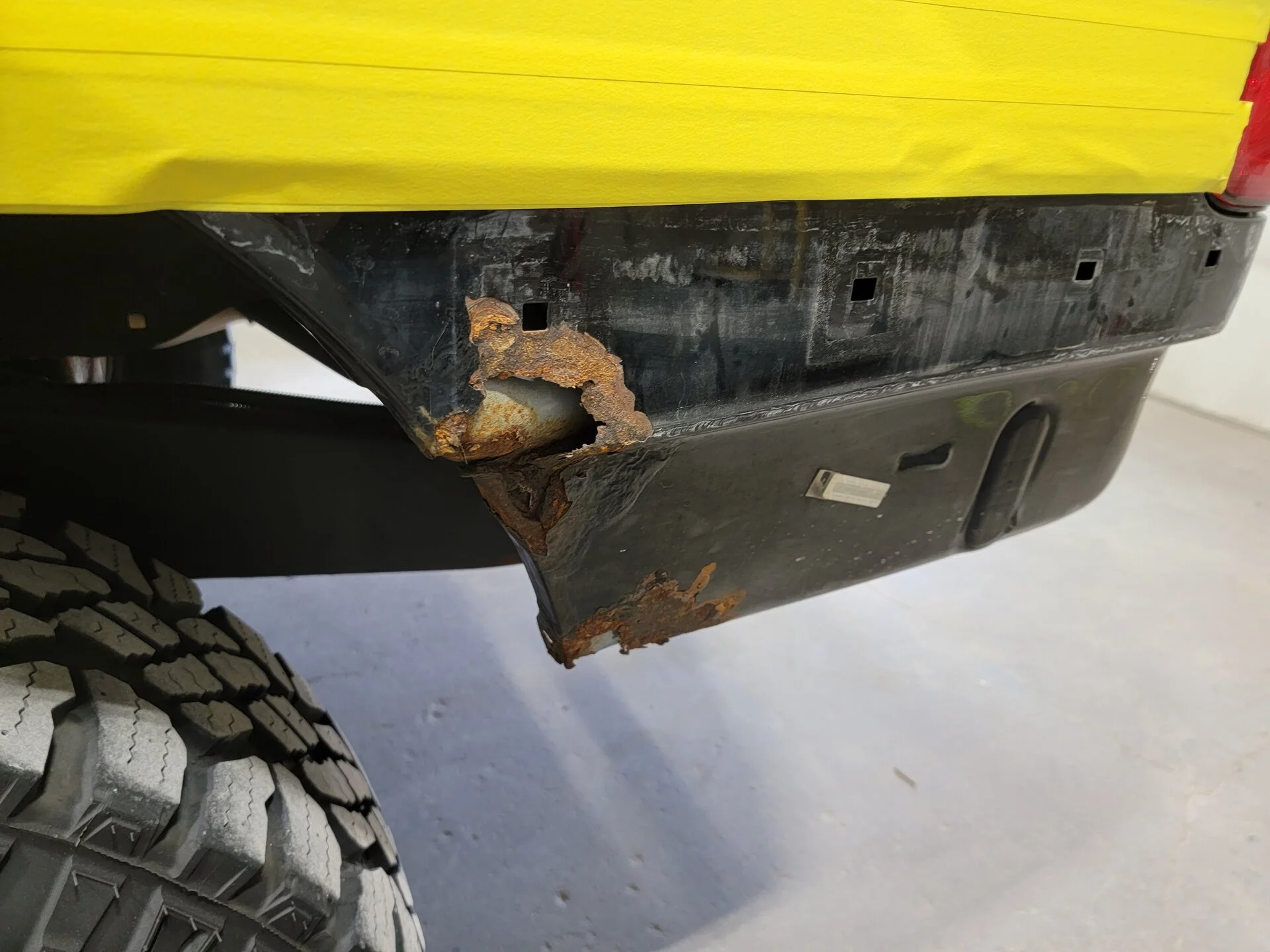

Back from the body shop. Rust repair and windshield replacment.
