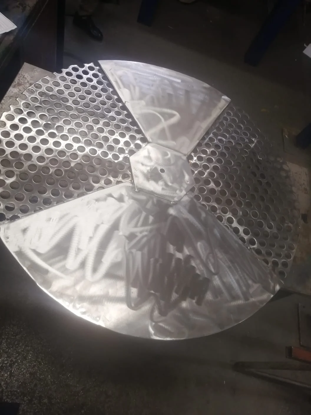

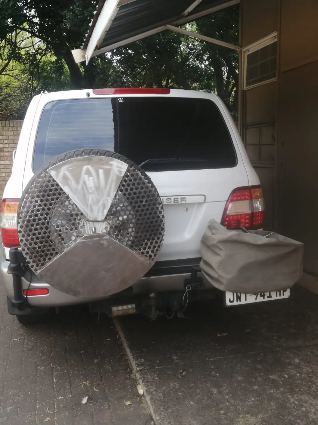

Here is an update, I am nearly completed, handed thee canvas cover and braai grid to a canvas shop to stitch onto the canvas cover some PVC material all along where the square tubing will make contact on the canvas cover to enable me to wash off the sooth on the cover. Will upload photos when completed
excuse my ignorance, but is this a portable bbq?

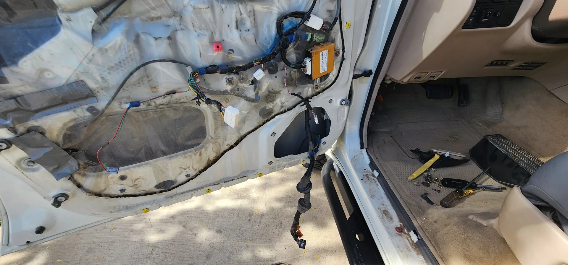

After 2 years of dealing with driver door speaker cutting out when the door was open I decided to do something about it.
A little solder fixed it up. Wish more manufacturers made door harnesses this easy to remove/ repair..

Yes, it is a portable camping braai grid..I am awaiting the 20x20x1.5 square tubing to finally build the three adjustable legs...will upload a photo when it is completed and where I am braaing meat on it..

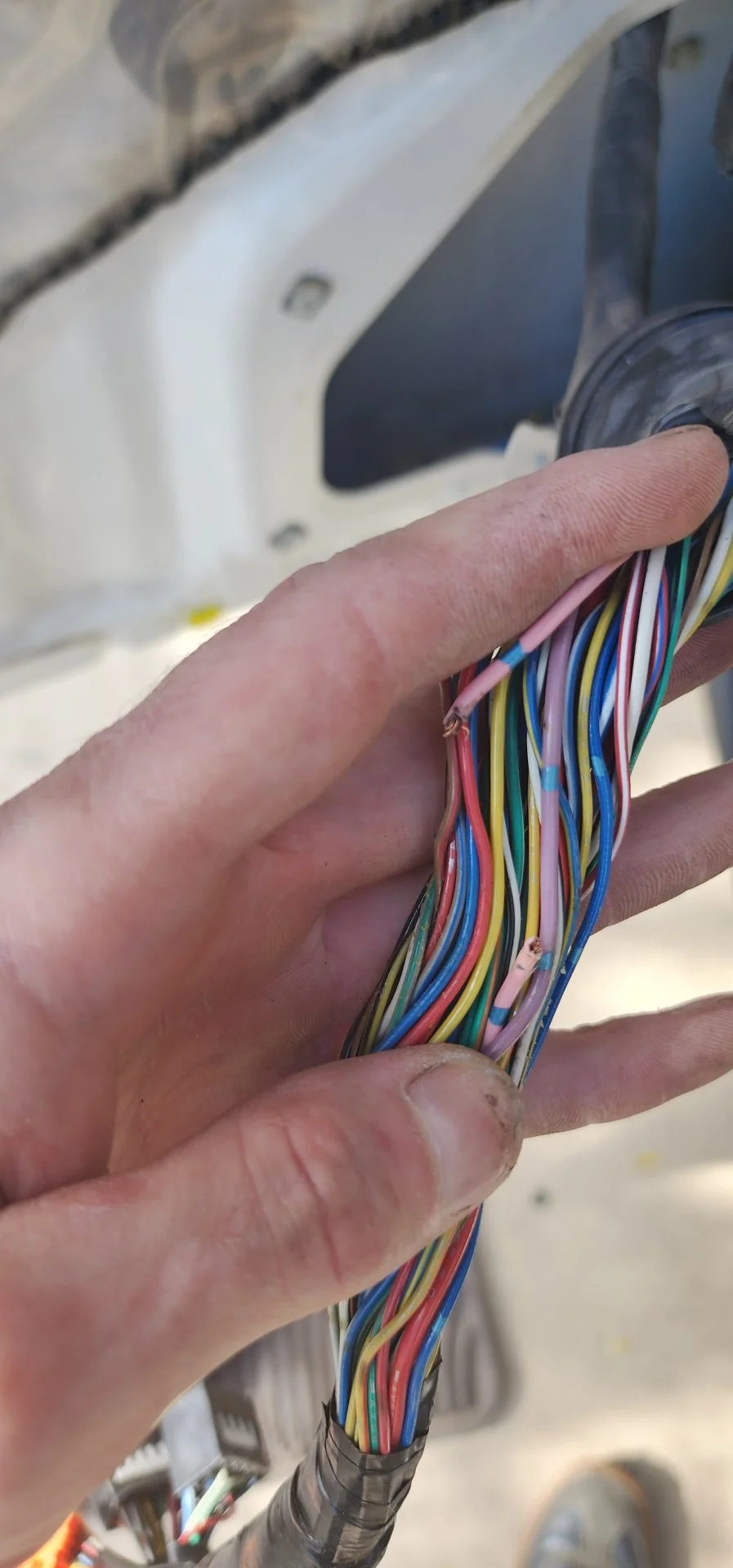

I've got this exact issue. Have to turn the volume to 20 and slam the door shut and it kicks on. What section of the harness is that located?

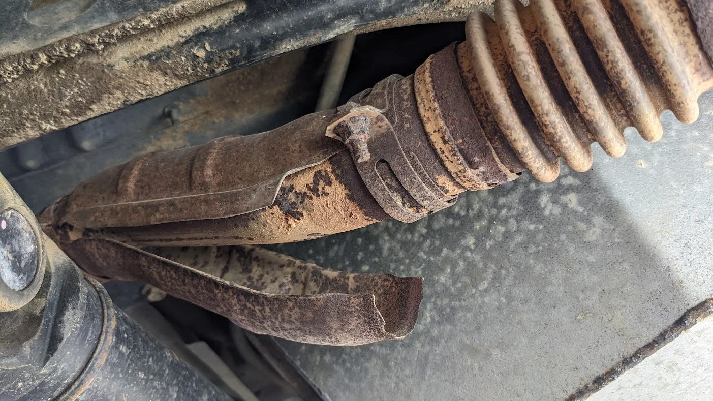

Repaired a pesky exhaust heat shield rattle. I decided to "repair" it instead of pulling it all the way off due to its proximity to the gas tank. We all know that the 100 has hot gas ventilation issues :poop:

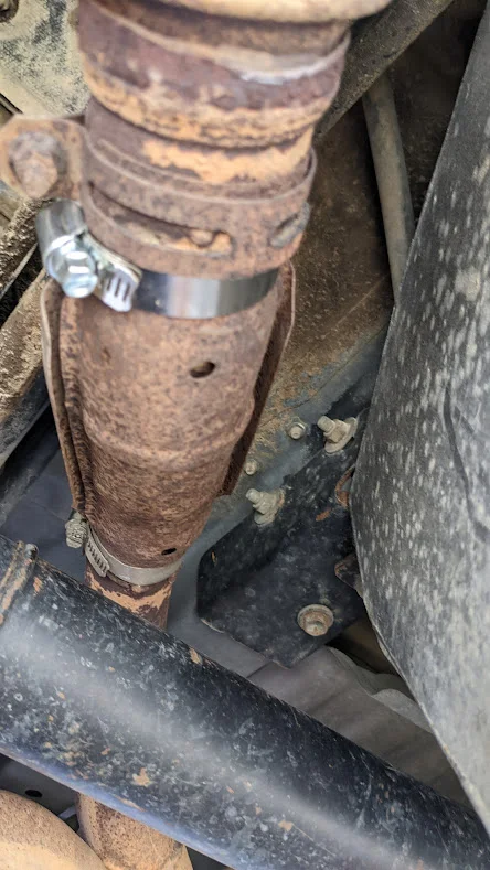

As good as new :hillbilly:
I have been meaning to put some sort of heat shield on the LRA tank since it is so close to the exhaust but haven't found a good solution yet. I am not sold on the stick on type insulation (easiest to install) because it might hold moisture which would rust out the expensive tank in no time :(

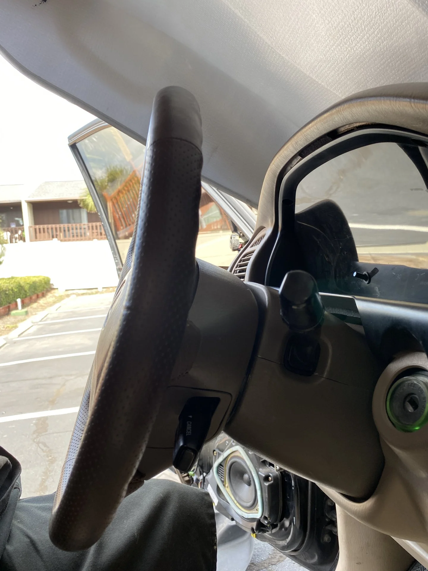

You know that moment when you finally re-install the steering wheel correctly only to find out it is bent? You know? Cause everyone has seen't this before amirite? :rofl: If anyone has a spare steering wheel hit me up, please. Thanks in advance.
It occured to me scrolling past this that if you were of a type to grab the wheel, plant both feet on brakes and PANIC STOP- that could do that to a steering wheel. Also could explain any messed up clocksping, etc., in there- as those aren't exactly meant to get yanked on like that, and any side-loading could have led to the premature fail.
Just wondered. We will never know. 😅
