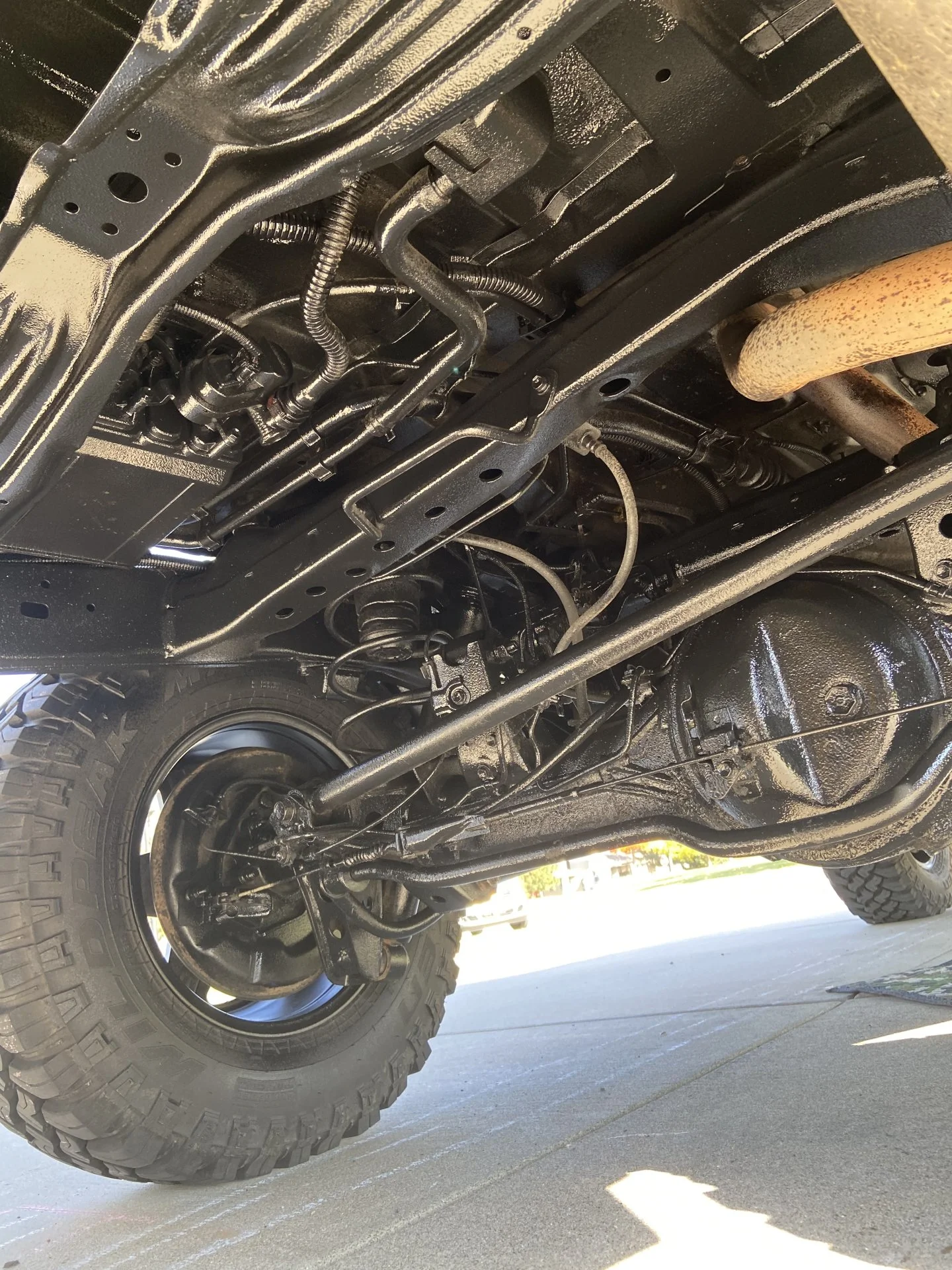

I pulled spare tire carrier and rear bumper cover and gave the frame etc a solid coating of tinted black Woolwax. This rust free Texas truck must be preserved forever!
Dude, can you not? That thing is so stinking clean that it's ridiculous. Haha, never have I ever seen't anyone with clean brake dust shields except you. Brilliant!
Thanks! It does not show its age that’s for sure. It’s like new underneath. 200k on it now and it looks and drives like it has 30k.

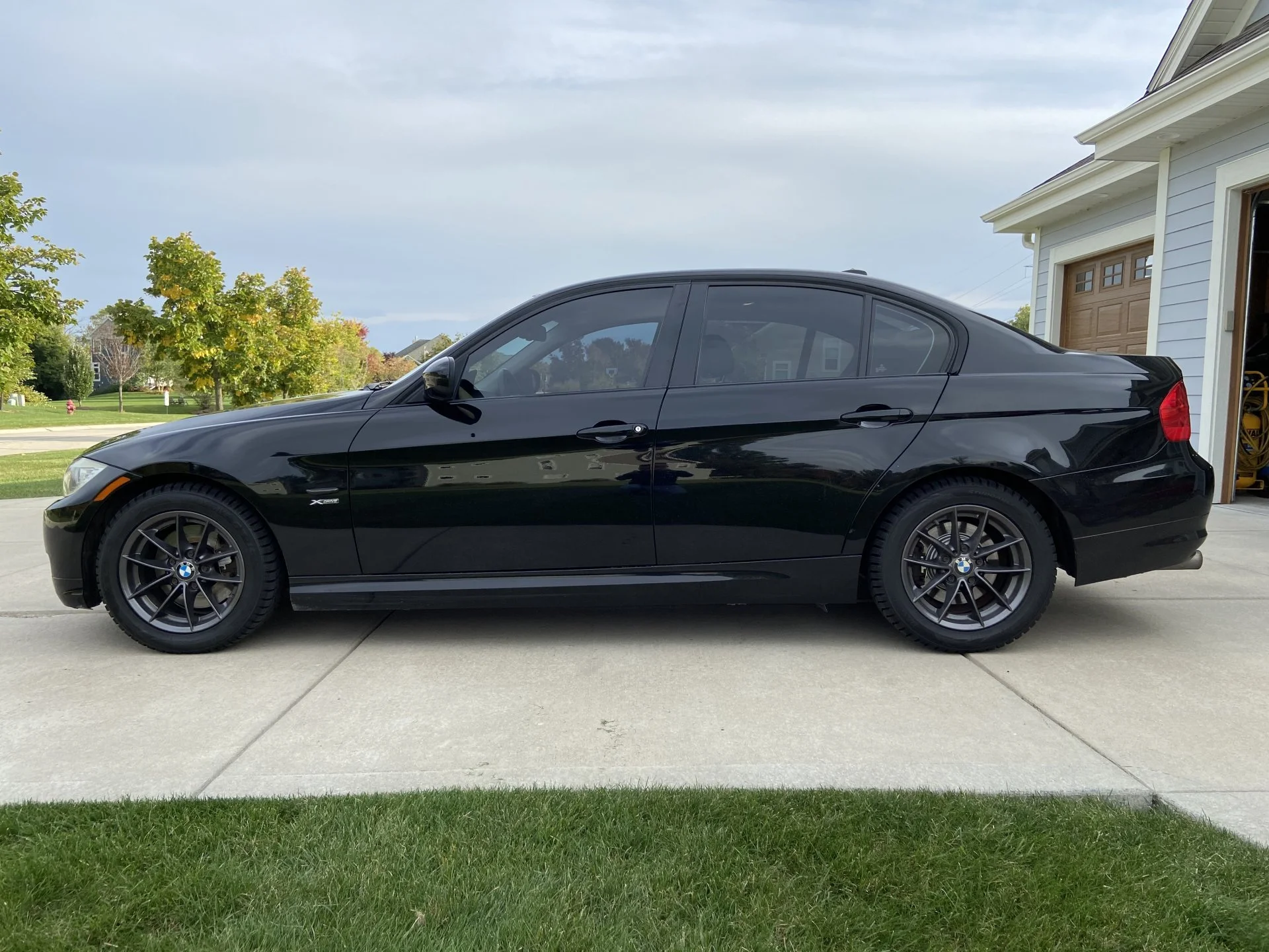

Funny you say that because I did pick up a winter car. The problem is I really miss not driving the LX.

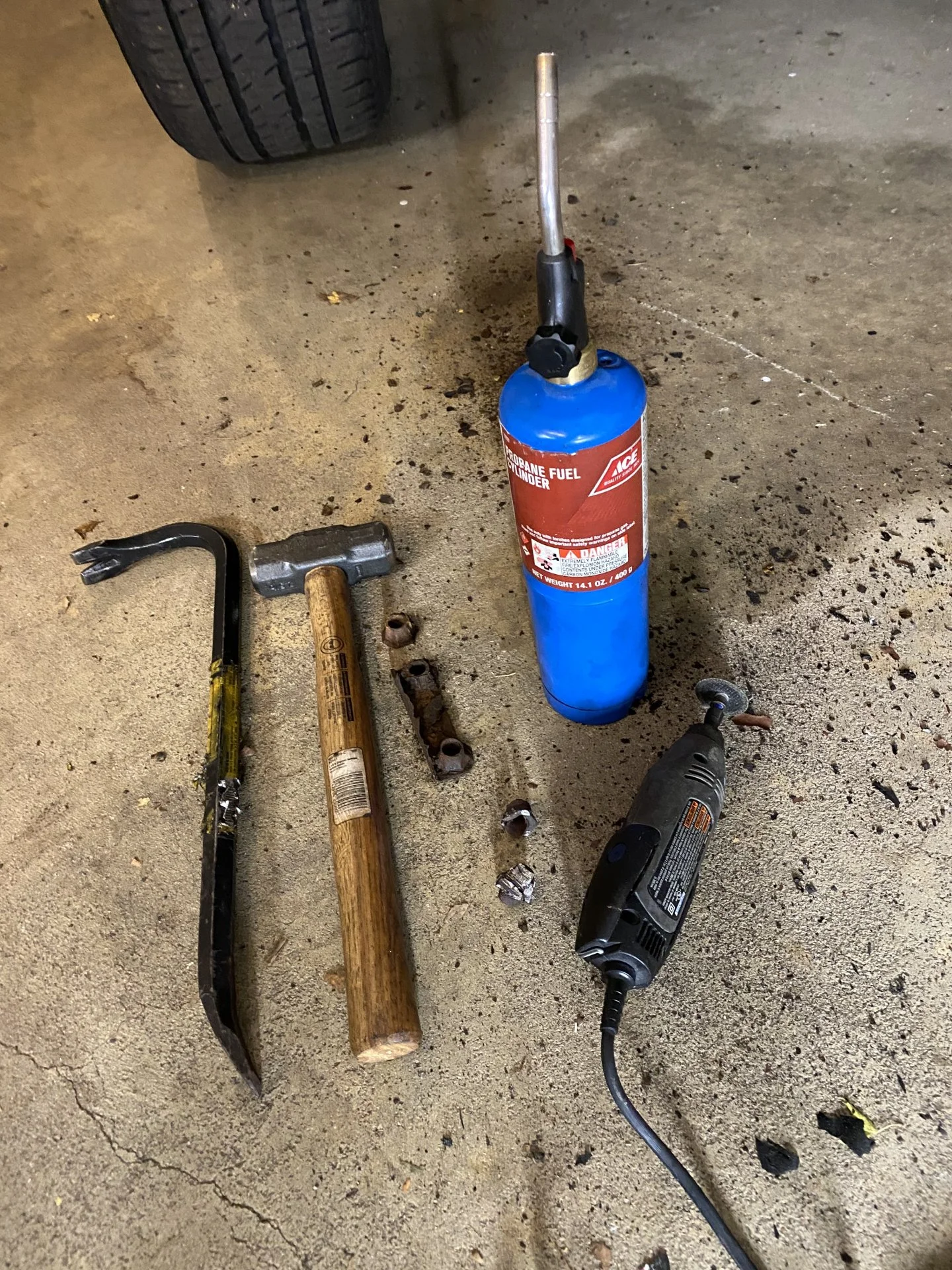

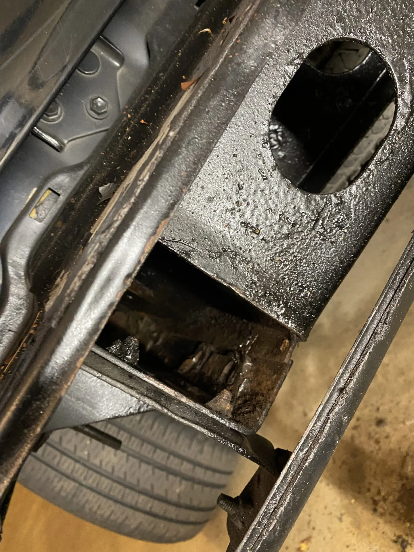

Removed two crusty stuck bolts from the previous receiver hitch. Required dremel cutting the welded nut, heating up what was left and banging them out of the frame.

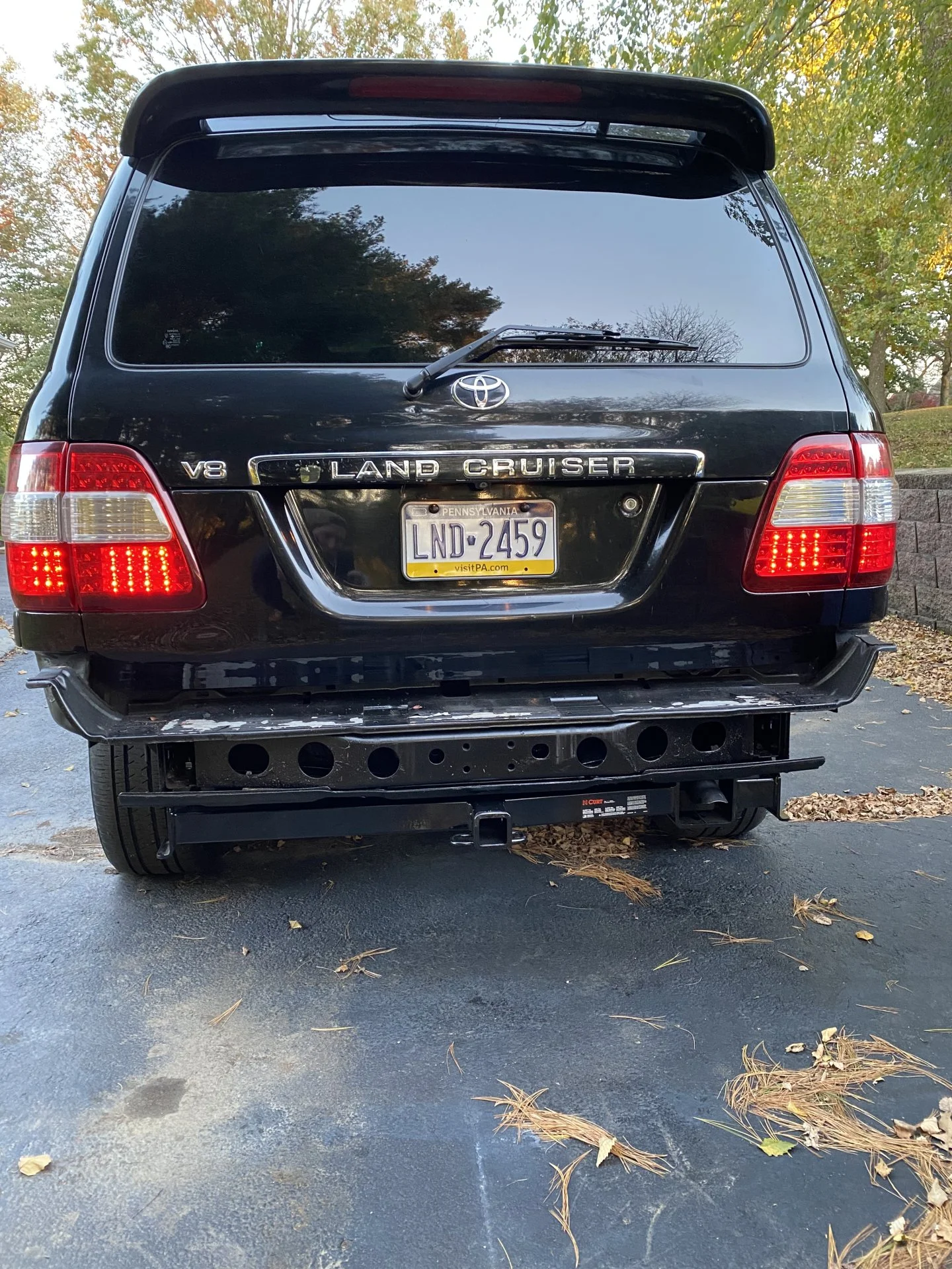

Took a couple hours but the new Curt receiver hitch is on. I used Trail Tailor’s bolts and got some flange nuts from McMaster carr. I finagled a long breaker bar to hold th nuts in place while i torqued the bolts below. I wish I could have found the serrated nuts which would have helped.
Just waiting for a couple coats of rust converter and encapsulator to cure before putting the plastic back on.

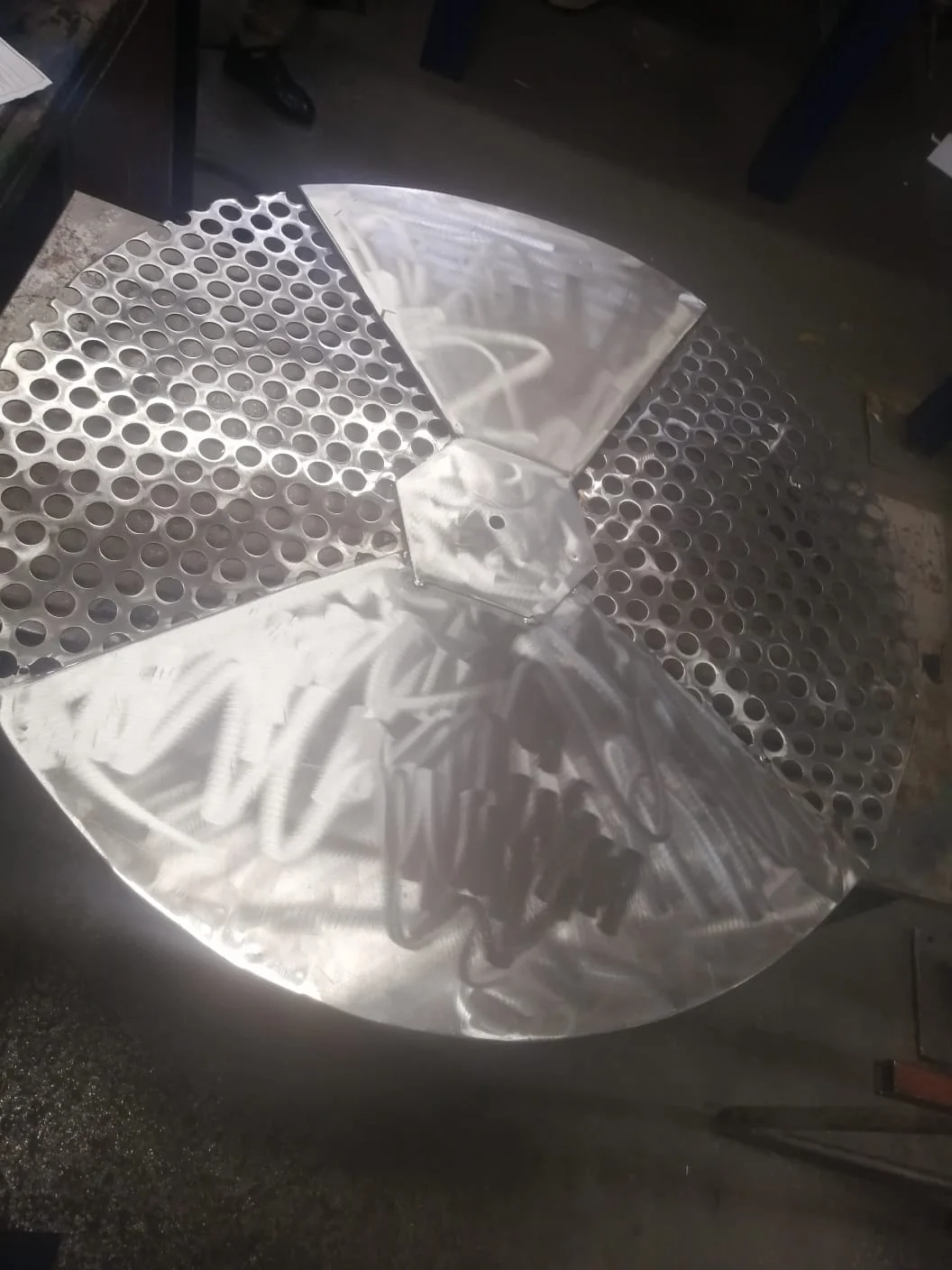

I build myself a spare wheel braai grid ...a spit braai rotisery , a few stainless steel egg rings to use on this braai grid ...nearly completed with these projects
Here is an update, I am nearly completed, handed thee canvas cover and braai grid to a canvas shop to stitch onto the canvas cover some PVC material all along where the square tubing will make contact on the canvas cover to enable me to wash off the sooth on the cover. Will upload photos when completed
