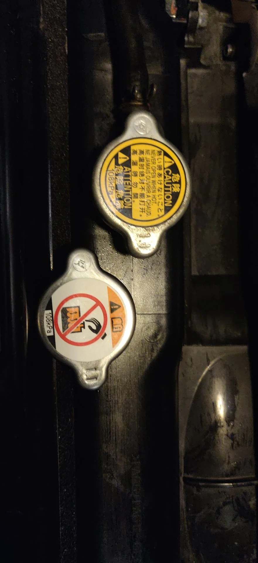

Had to replace the radiator for last weekend trip. The Amazon denso radiator I put at the timing belt job at 191k miles and 11/2019 failed after 21k miles. It leaked all around the seams. Ended up ordering an OEM from local dealership offering online discounts ($518+tax).
For the record, this was the amazon denso radiator I ordered - https://www.amazon.com/gp/product/B004J378CM?tag=ihco-20
Didn't like the cap it came with, I reused the one I had. White one came with the OEM radiator
Didn't like the cap it came with, I reused the one I had. White one came with the OEM radiatorView attachment 3131159
I am curious about this cap. I just did an OEM radiator myself. Also came with a white cap. I think it's the "Mexico-spec" OEM radiator. I had previously replaced the cap before the radiator swap with the one you reused. I wonder what the difference is?
Only visible difference is the sticker. Yellow one is the OEM got from a toyota dealer because the denso radiator does not come with a cap.
Is that + or - 5 horse powers on sticker colors? I think yellow +5. #askingforafriend

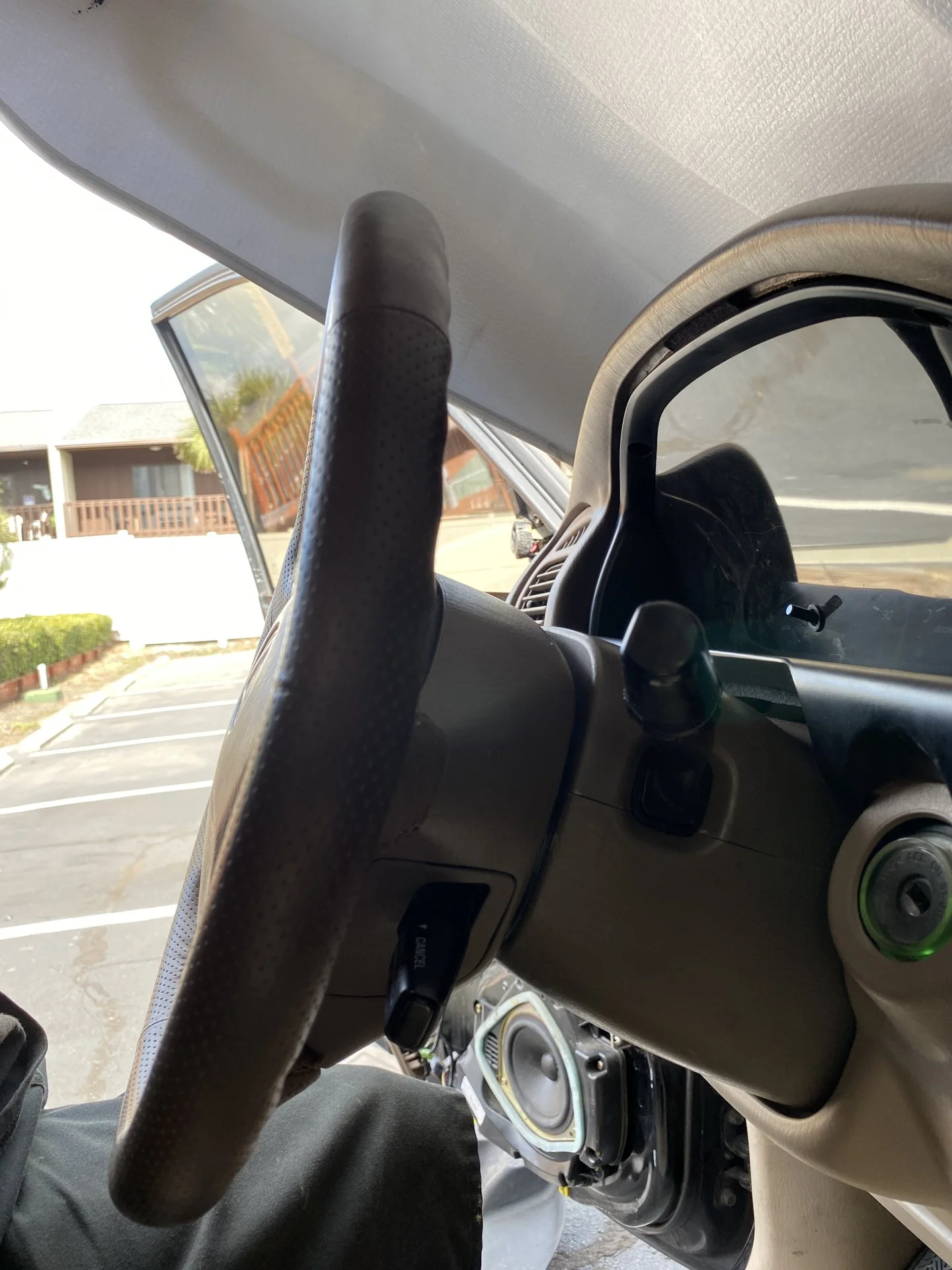

You know that moment when you finally re-install the steering wheel correctly only to find out it is bent? You know? Cause everyone has seen't this before amirite? :rofl: If anyone has a spare steering wheel hit me up, please. Thanks in advance.

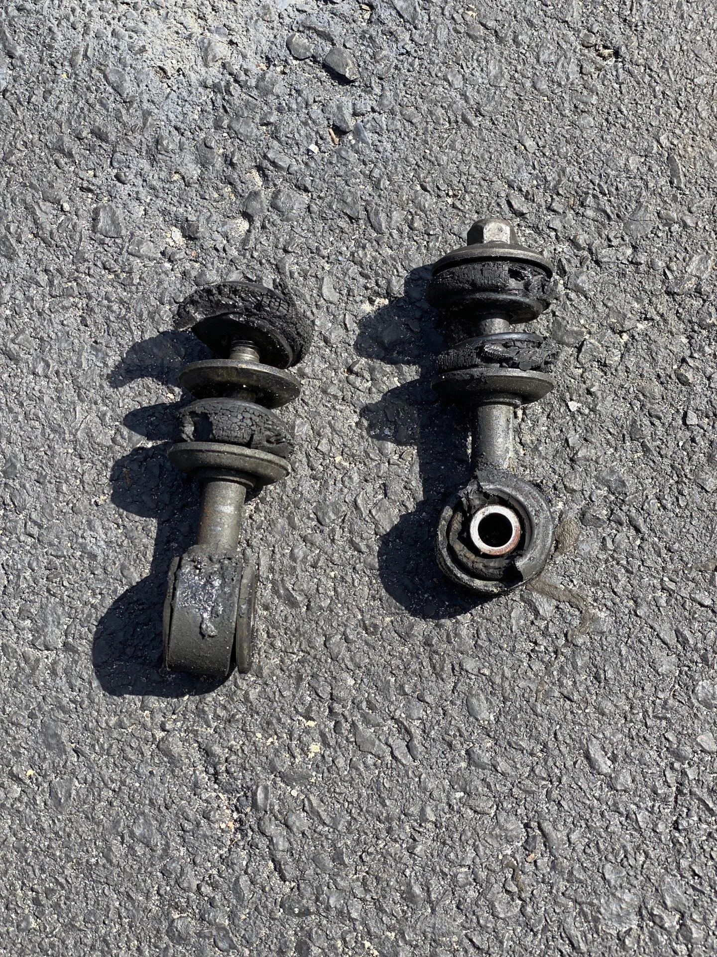

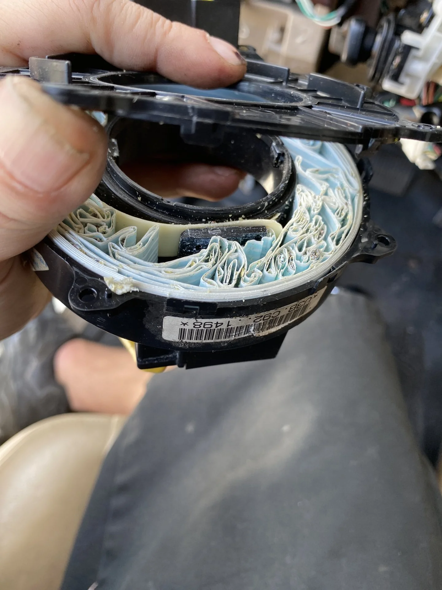

Went to the dealer for an alignment today and change some oils on my other Lexus. While on the alignment rack we ( I ) discovered a damaged torsion bar so no alignment for me after the new rack, all new OEM suspension, and OEM control arms. So, I made do a with sway bar link swap and some not jacked clock spring action. The dealer was pretty butt hurt I did all the previously mentioned stuff on my own so they made sure to find some stuff that is wrong. Hence the clock spring and links. Already knew about the third incoming alternator cause number dos is still howling like a dying cat. Nana nana boo boo stealership. Maybe next time I ask them to do something they'll just take the job I asked for instead of slamming me with a $15k estimate? Here's photos of my sweet clock spring action and links cause we like photos and junk.
How was the torsion bar damaged??
