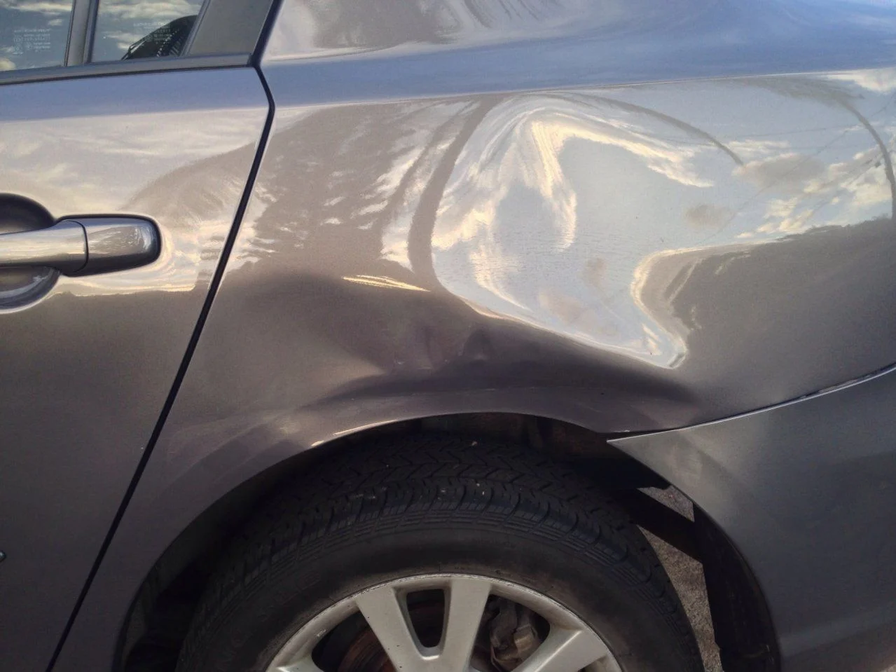

Backed into a Mazda 3. Stoopid avoidable mistakes really grind my gears...

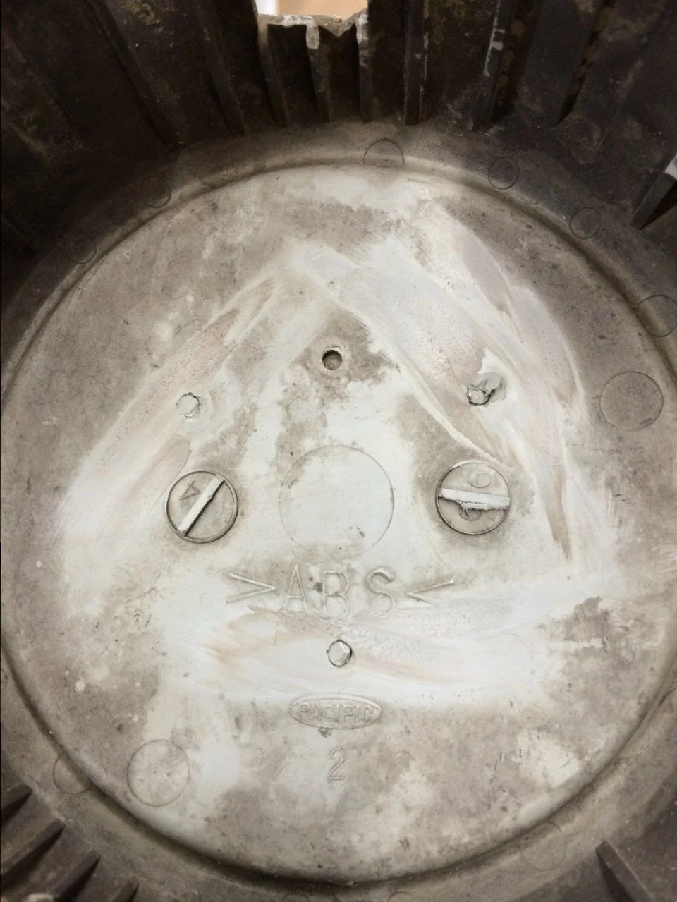

The sombreros have 4 little nubs that glue them into the center cap. You need to grind off those nubs, accessible from the backside, then reglue them into place once you paint them.

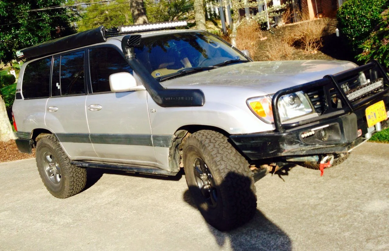

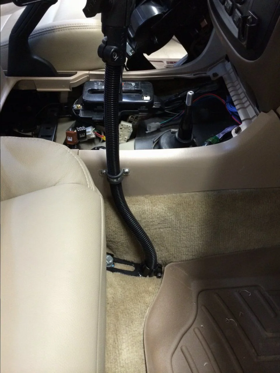

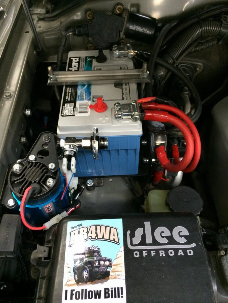

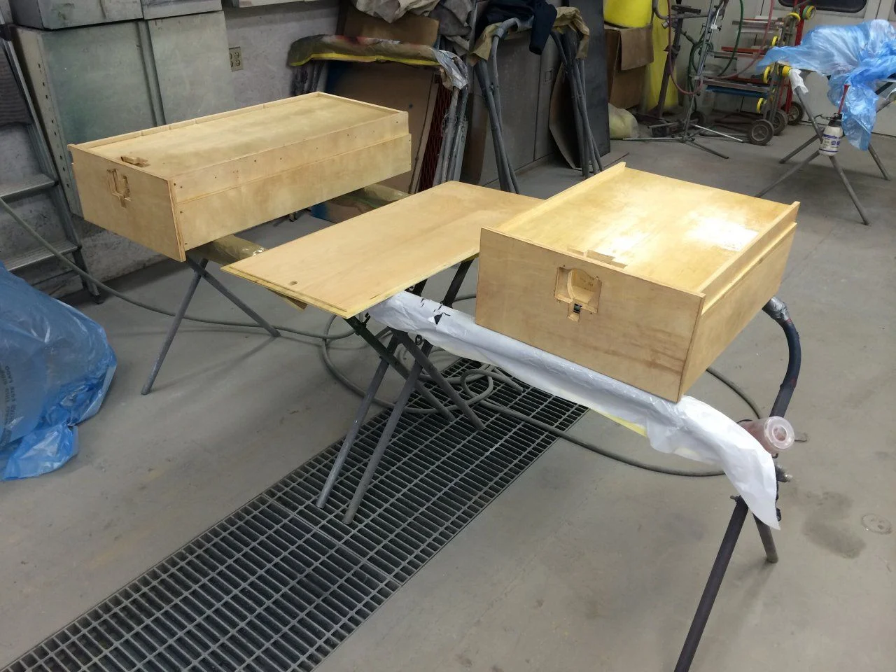

Big day yesterday, got the ARB compressor mounted, wired up my Hella driving lights, sprayed my rear cargo drawer system with a clear poly and installed a super fancy support for my iPad mount.
Looking good! You're really building that thing in a hurry. Is this the one you had @SanDiegoCruiser check out for you?
Yep, that's the one. San Diego all its life until last October. Started the mods on the way back (Slee lift and BIOR rear bumper) and haven't stopped. We got a trip to VT in right after I bought it, and a few weekend trips to the PA State forests. Spring break we've got a camping tour of the northeast planned (Catskills, NY, VT, NH and Cape Cod) and this summer hopefully 100s in the Hills. And a few other smaller trips in between.

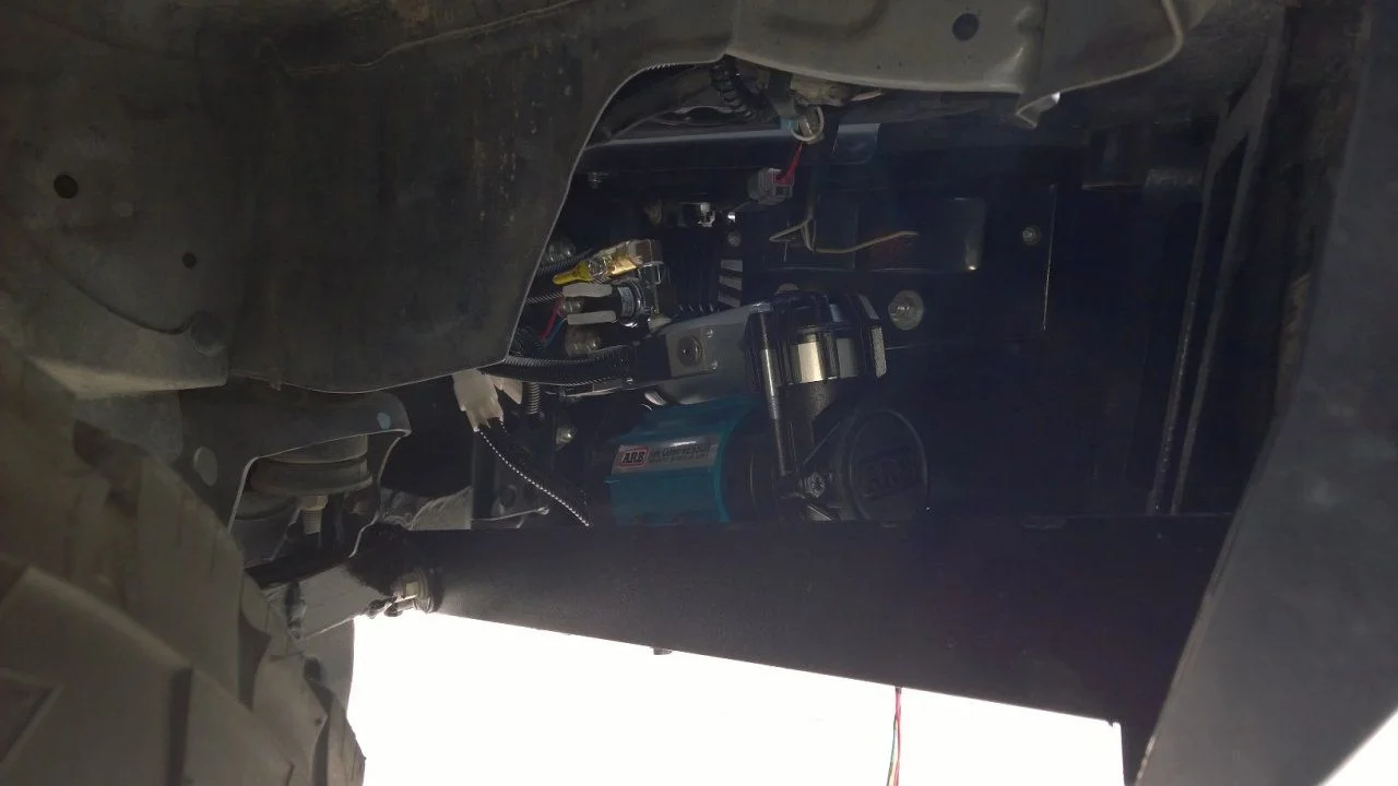

I just put my compressor in a few weeks back in prep for the Air Lockers and re-gear being installed this week.
I opted for a behind the fog-light mounting location as under-hood is all full due to the AHC, 2nd G31 battery and Ukrainian spec cyclonic air cleaner. (Allowing me to run the second battery in the factory location behind the passengers side headlights.)

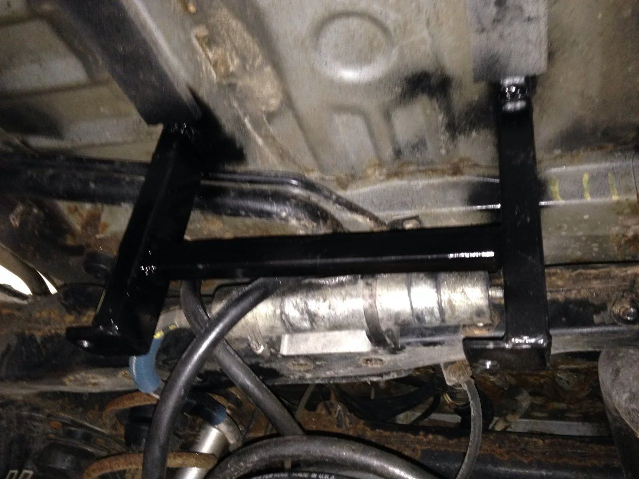

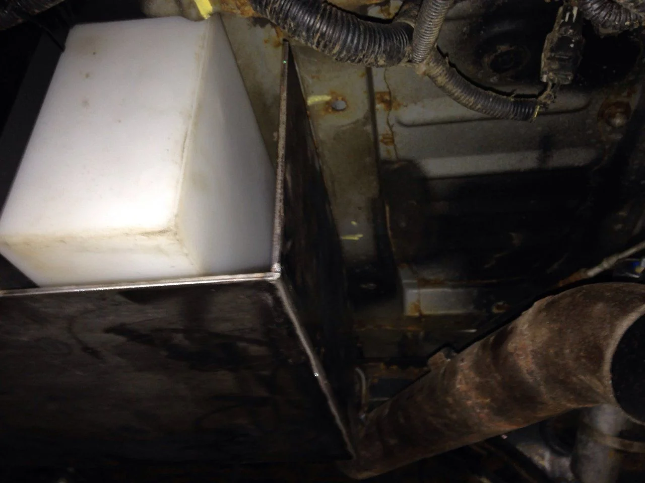

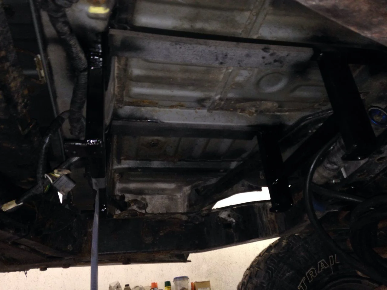

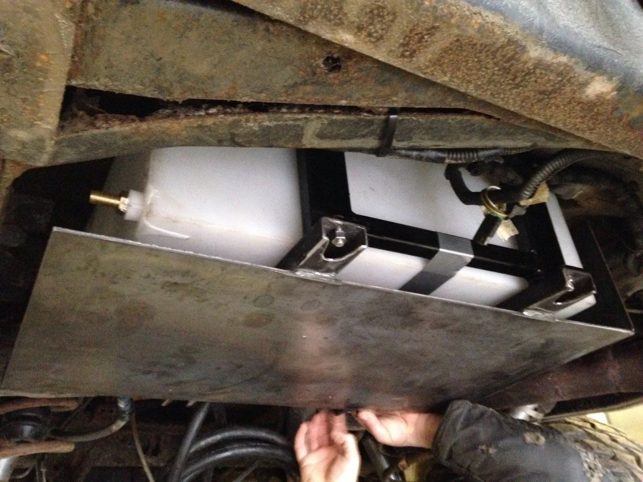

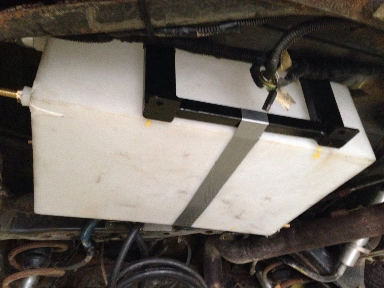

Finished building my mounting system and skid plates for my on board hot water system. 11 gallon tank fits nicely after some slight mods to the underside of where the tire mounts. Welding up a bracket for the pump, which will be shielded from the exhaust and located above it.
