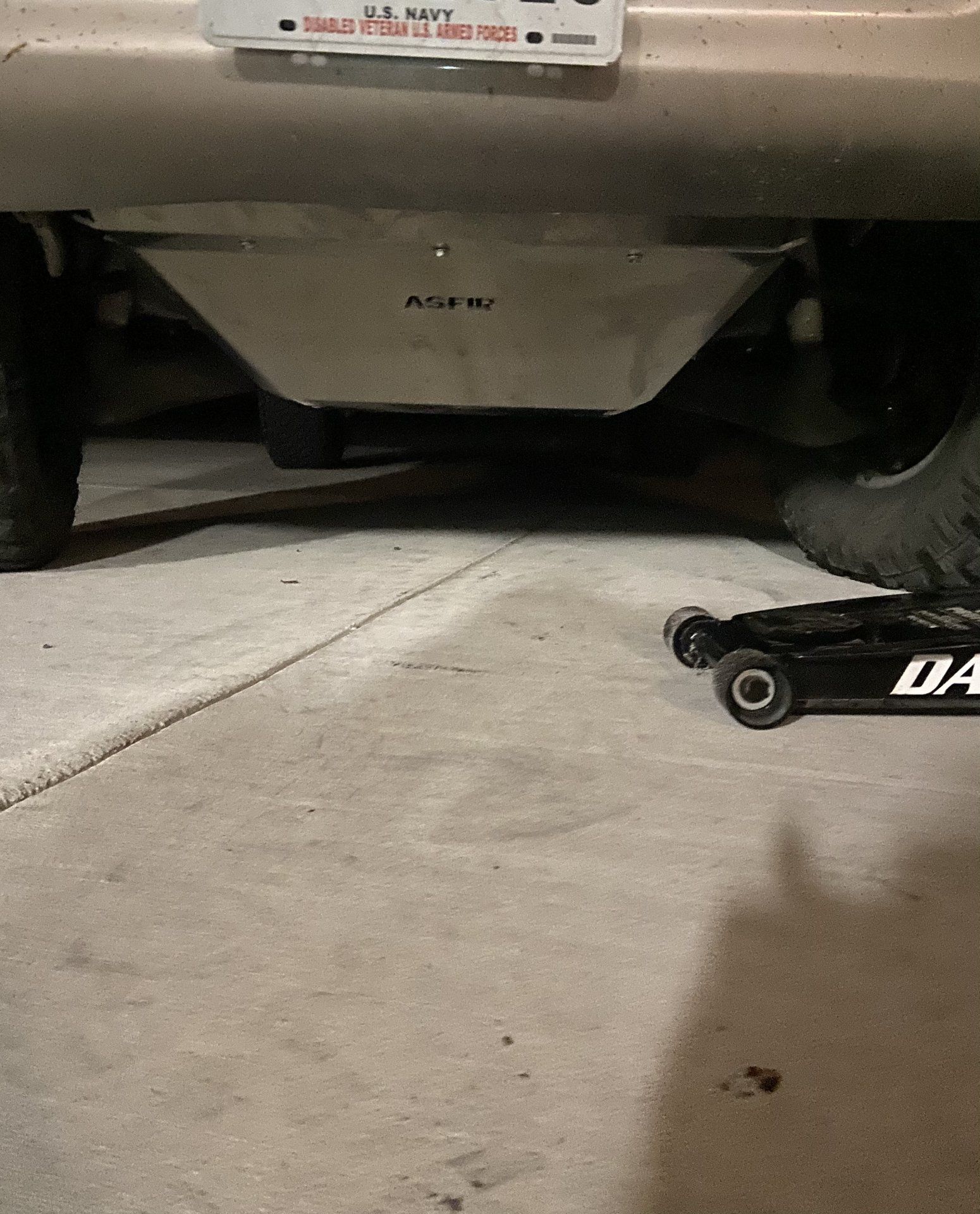

Probably the easiest replacement ever that I’ve neglected for 2 years. Also added some weight to the rear end today.

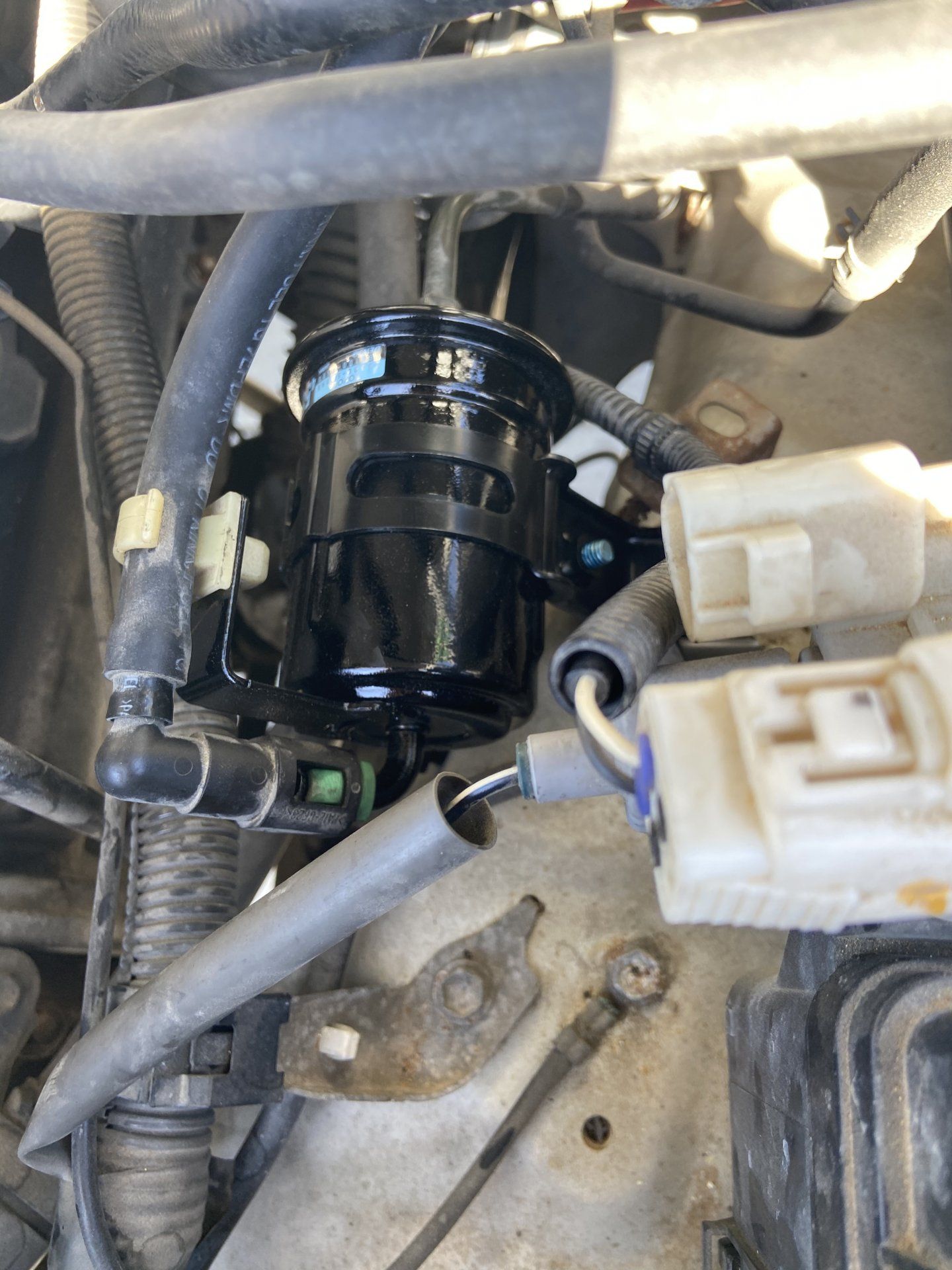

Finally had the time to check this off the list

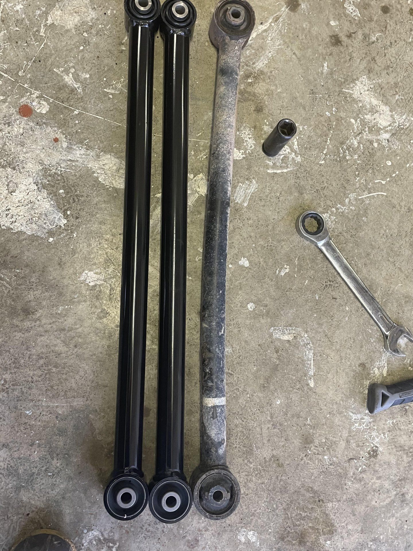

Replaced my bent rear lower control arm with one from Slee, which I guess is made by SPC? The ends are smaller but these are beefy solid compared to OE, several pounds heavier. My mounts also took a hit, and my muffler...and the spout, but all look to be fine. This was a very satisfying job that was so easy, went exactly as I thought it would, and was done faster than what I told my wife it would take (normally she takes what I said it would take and multiplies by 2.5x).
I cant decide if the bent arm noticeably changed tracking of the rear axle enough to feel it while driving but I'm sure just having newer softer bushings will improve the ride even if imperceptibly.
Those look identical to the SPC ones that I just installed.
