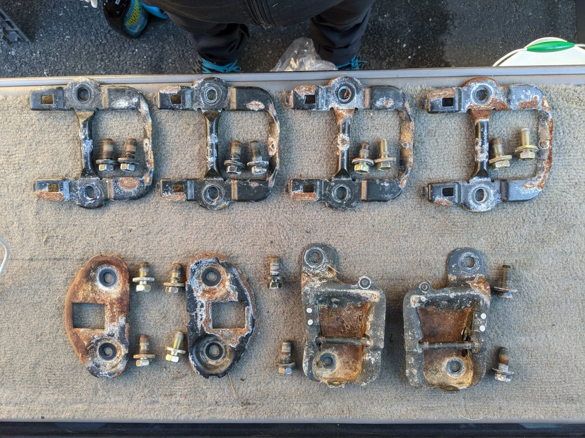

Started cleaning up the rust on the interior of my 2005 LC. Took off rear mat set plate and discovered some rust there. Then I removed the rubber seal around the rear opening and discovered some rust in that area as well. Most likely cause by the leak on the top rear red light and the PO's love of the beach. Found a lot of sand. From there I started removing the striker plates, carpet, and side mouldings.
There were a bunch of surface rust on the striker plates. I was wondering if I should paint it with the Eastwood rust encapsulator that I have, or just put sort oil on them to keep it rust free? What would you guys do?

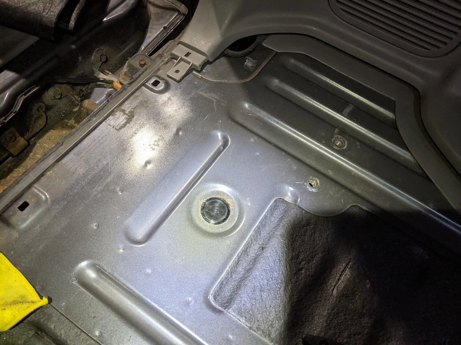

Also, I was wondering what this plastic disk is? There is some rust around it. Probably from water pooling there. I tried to use some trim remover to pry it out. But it seems very stuck and I don't want to damage it unnecessarily.
I would consider media blasting those and having them re-cadmium plated.

I have the same issue (though not as bad as yours). I was just going to grind the rust out, spray it with some rust remover, clean, and make sure they're greased up. I read somewhere here that the third row seats actually have some removable plastic covers on them you can place over the anchors when they're not in use. Can't confirm though.

I use white vinegar and it removed most of the surface rust. I looked up cadmium plating. But I think that is outside my budget at this time. Does anyone know what does the black plastic round thing do? It's very difficult to pry out.

Those covers definitely exist, or did by at least 2003.

Is the round cover closer to the back of the 2nd row seat? Is it possible the access point for the child seat anchor that can be installed? I remember seeing another user talk about installing it within the last ~4 months or so but I dont recall exactly who it was.

I am not sure. I've stripped the carpet and seats from the rear of the LC. But I'm sure the seats come with places for you to anchor your child seats. Unless you are thinking of installing on one of those striker plate locations?

I couldnt find the the picture but I think this talks about what I was remembering.
No LATCH anchors on that seat at all--you have to install the child seat using the seatbelt (pull it all the way out and let it slowly retract and it'll lock, making the child seat pretty secure). The anchor I was referring to was for the rear strap of a forward-facing child seat. There are three of these anchors, all tucked away beneath carpet tabs in the rear cargo area about 8" behind the center of each 2nd row seat.
