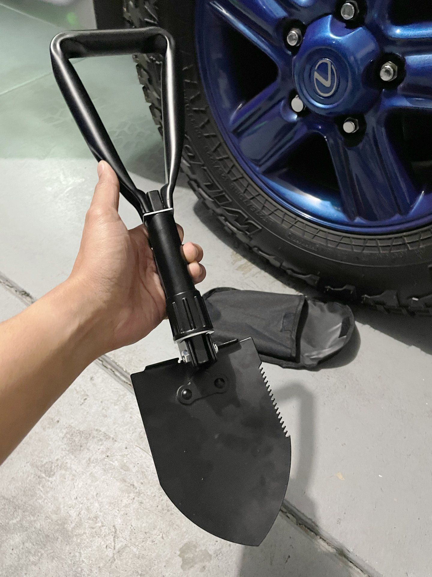

I don’t know about spending 700 for an alternator, honestly that’s a bit steep for me. I’d roll my dice now for a re-man and see if this holds up (hopefully the odds favor me with this one lol). Anyways, back to topic, got some foldable shovel to pair the GoTreads.

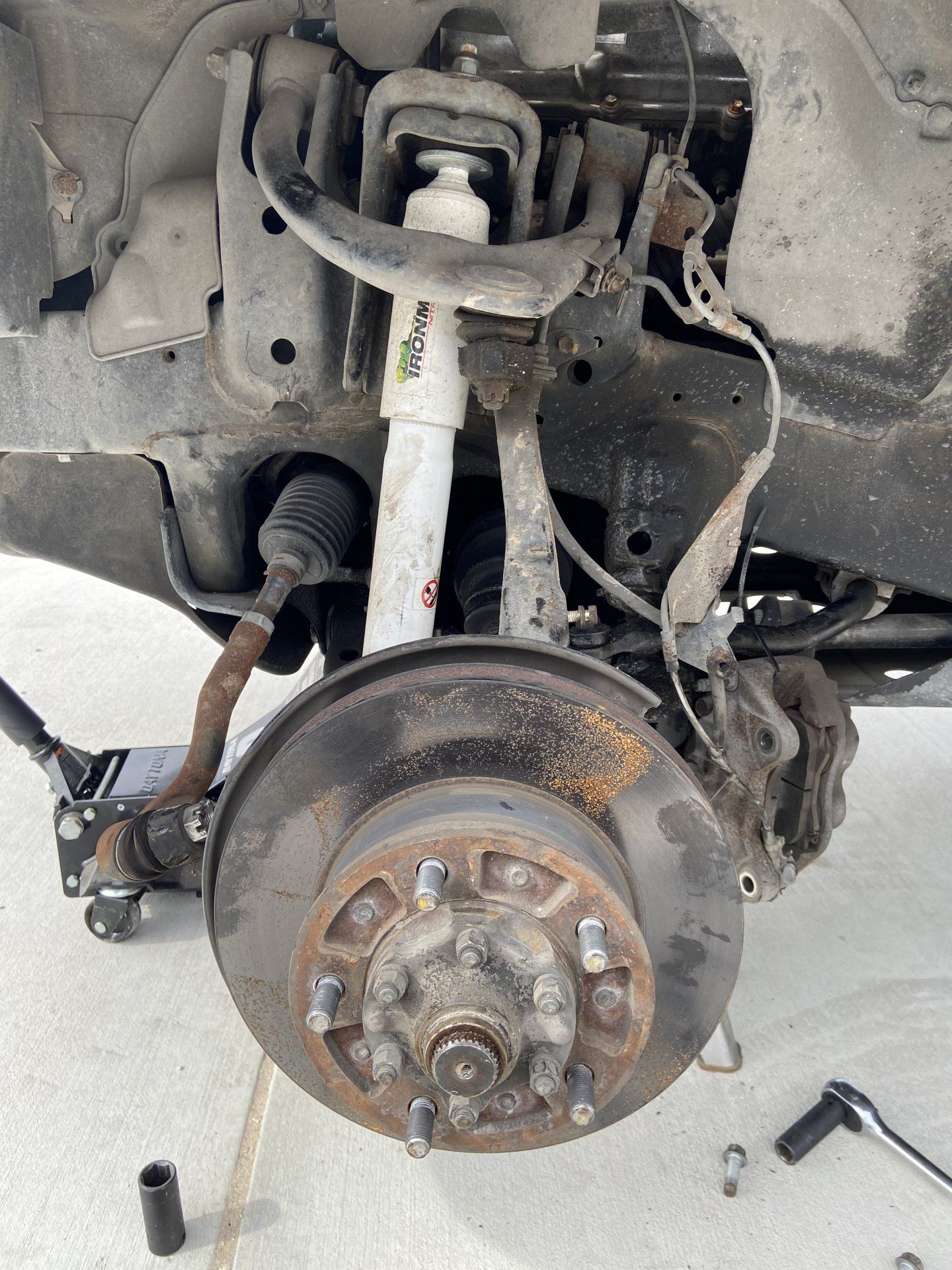

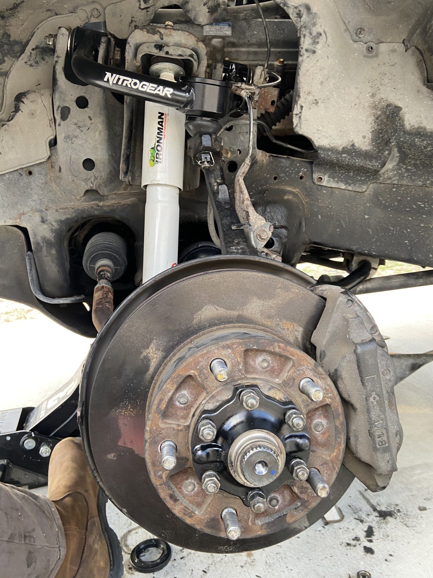

On this edition of “while I am in there” the LC finally gets some much needed parts after 20 years and 230,000 miles
Before:

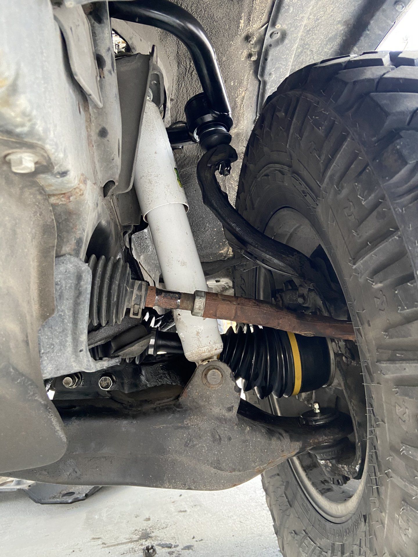

After:
Work was slow today so I decided to knock out a project I had planned for this weekend in between calls.

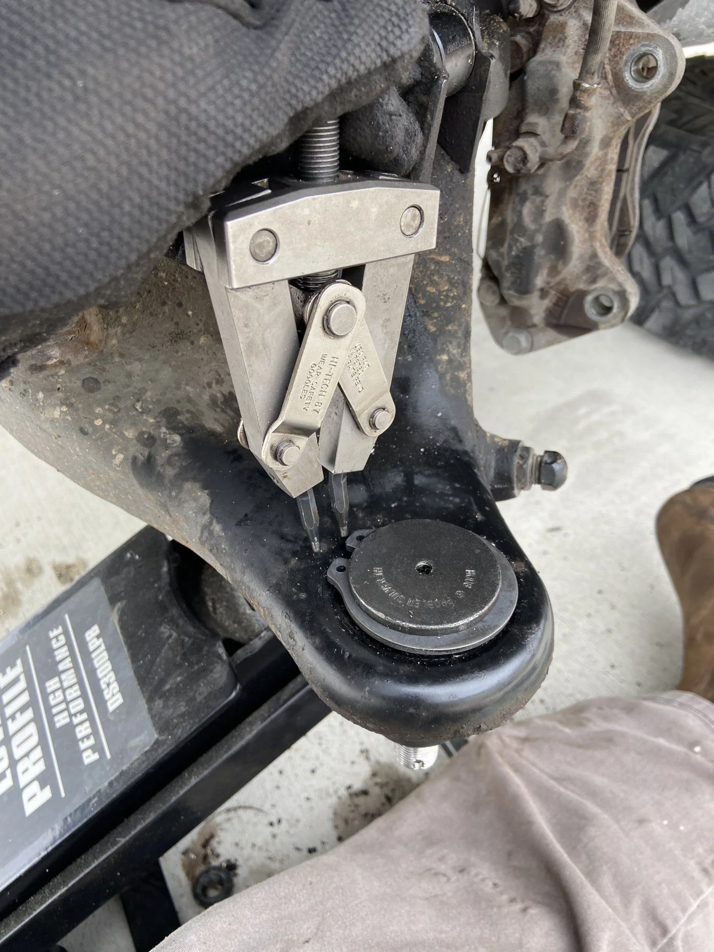

First thing was the LBJ. If you get a LBJ with a full snap ring instead of a c clip, the pictured snap ring tool makes life great.
Everything else replaced includes CV axle and diff seal, drive flange and gasket and lastly, the UCA. )The inner and outer tie rods with boots were replaced a few months ago so I’m not sure why they look so old already)
Now excuse me as I go lay in bed and cry because now my back hurts and I still have to do the passenger side tomorrow
Before:View attachment 2609025
After: View attachment 2609027

First thing was the LBJ. If you get you get an LBJ with a full snap ring instead of a c clip, the pictured snap ring tool makes life great.View attachment 2609030
Now excuse my as I go lay in bed and cry because now my back hurts and I still have to do the passenger side tomorrow
Well done! The other side will be easier since you have already finished the learning part.
The tie rods look like shìt because 555 parts are known to be painted with hopes and wishes instead of actual paint and get covered in surface rust in about 3 seconds!

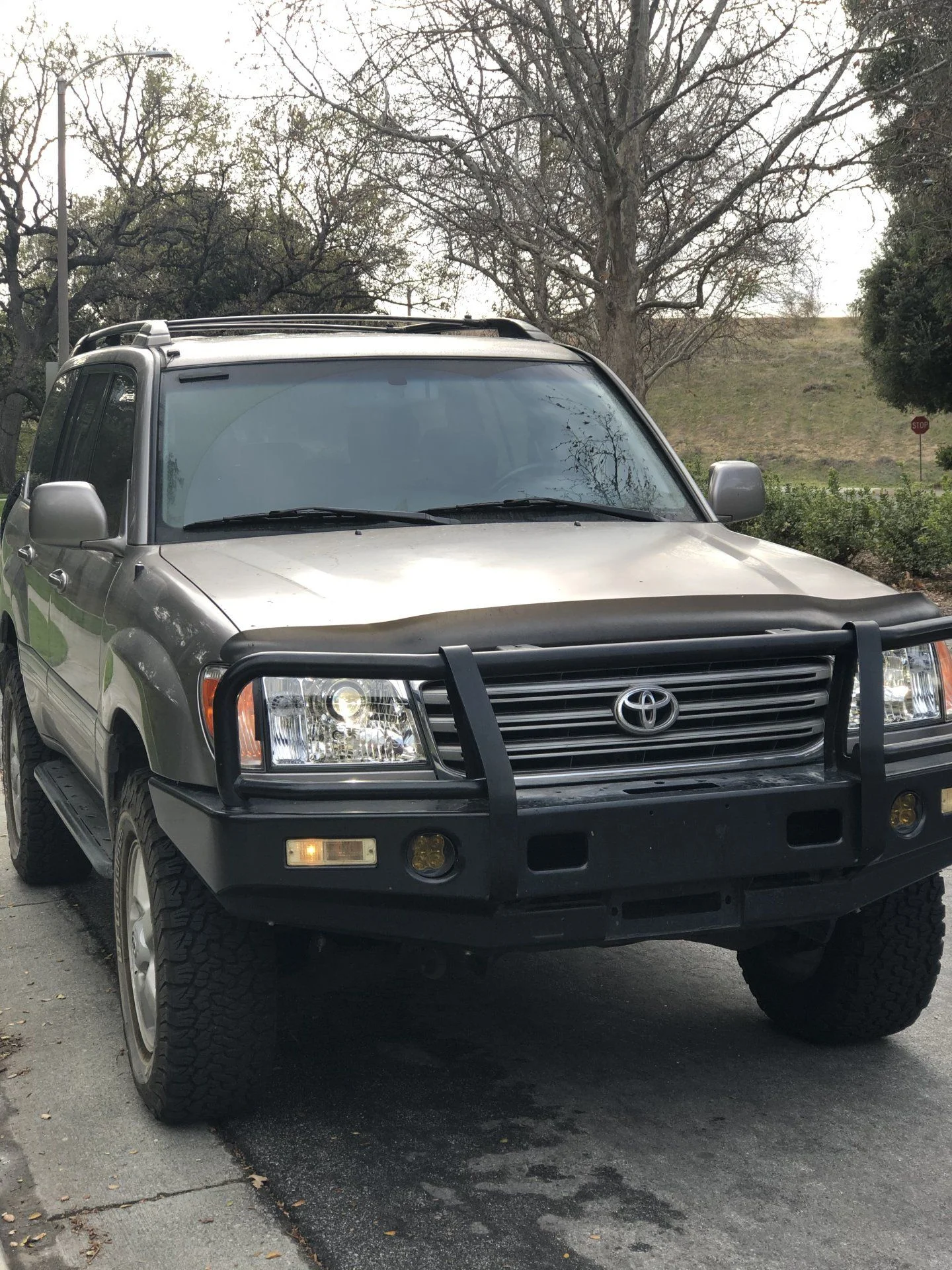

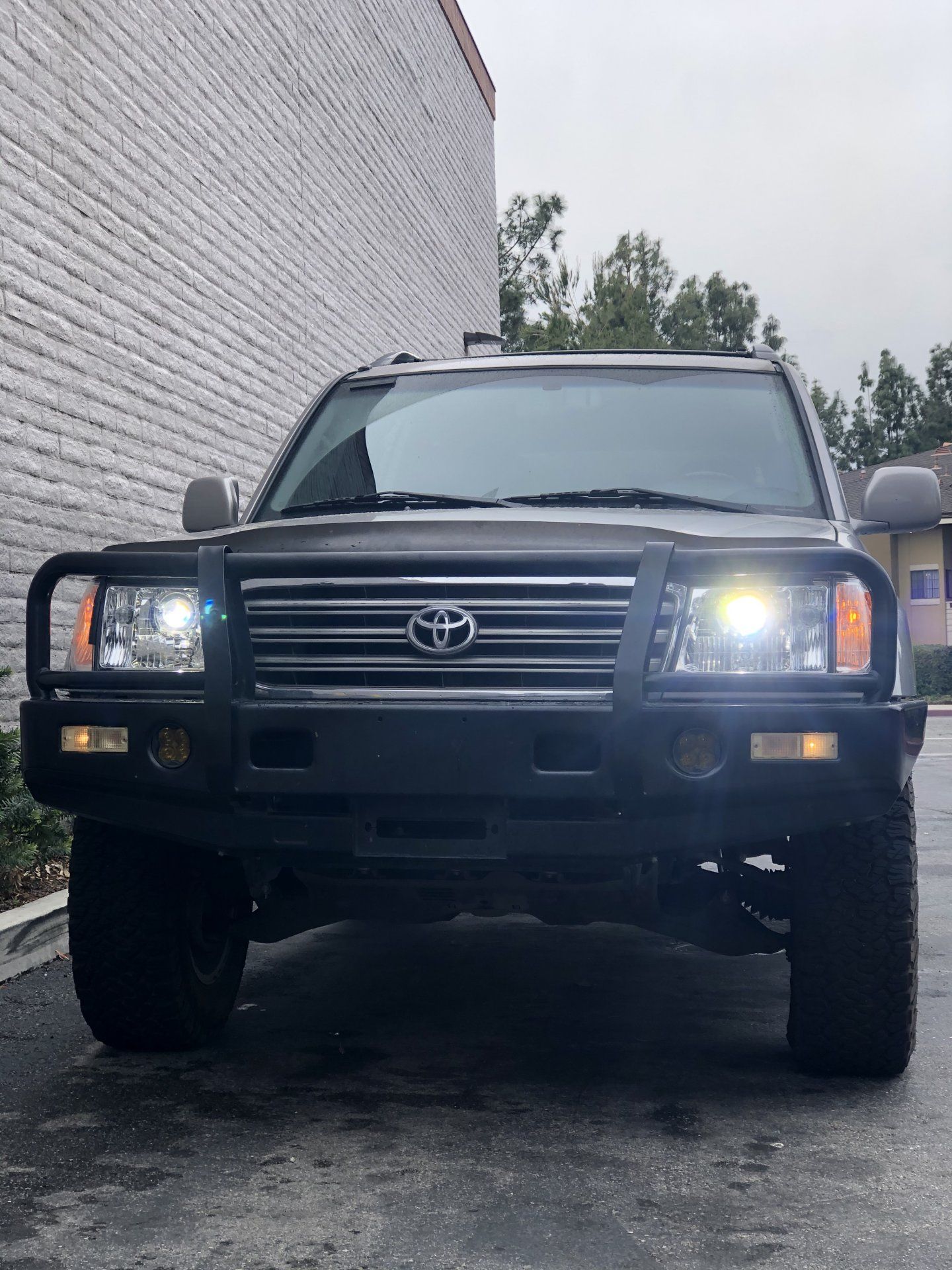

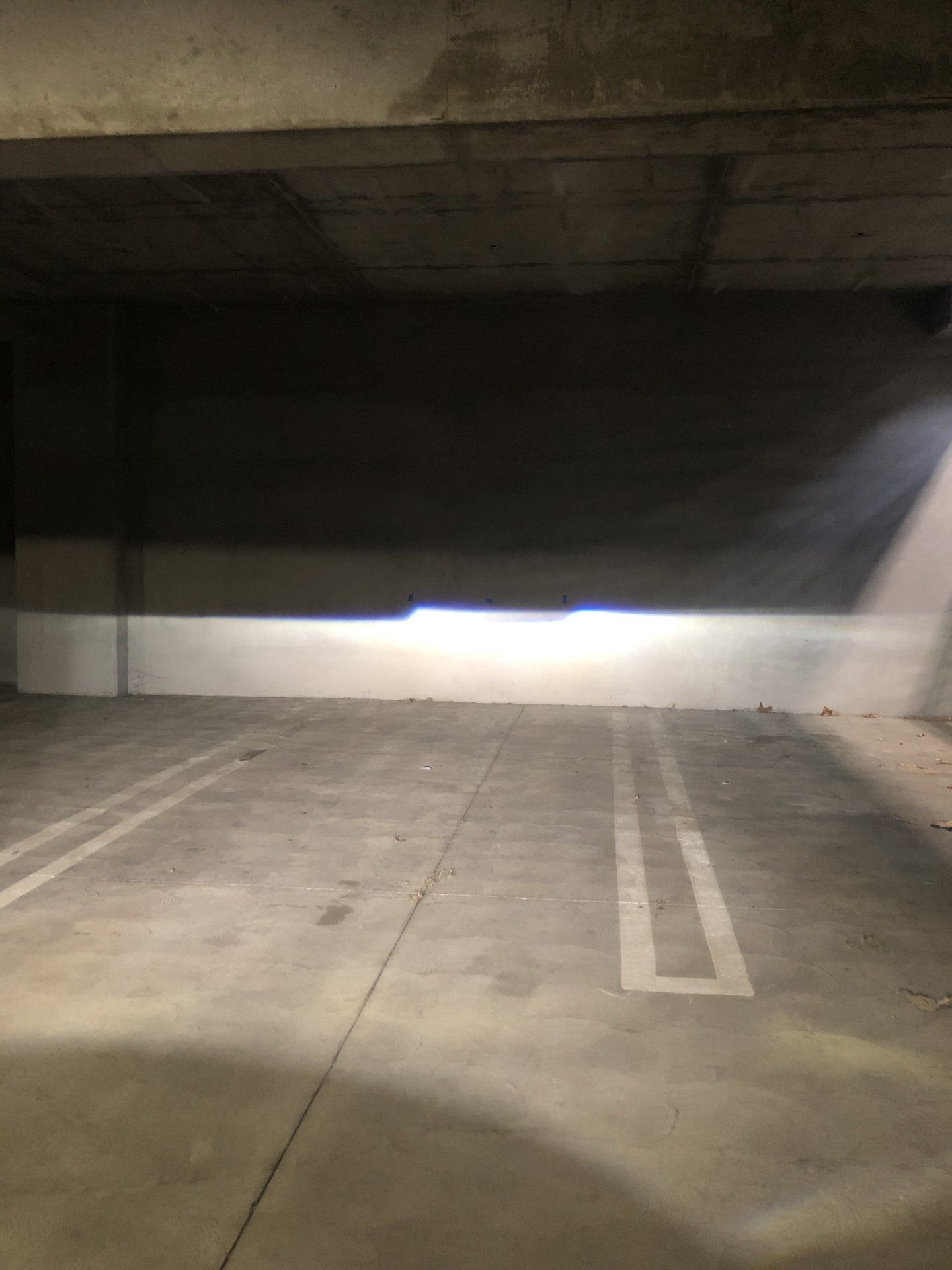

Finally realized a decade+ goal of having a Lightwerkz HID retrofit project on a vehicle of mine.
OEM+ Bixenon build using OEM glass lamps and excellent aftermarket lighting components. Really happy with the look - I feel like this is how our top end 100 series should have left the factory in the 2000s instead of equipped with those terrible halogen reflectors.
The beam needs some additional trial and error tuning but the difference in light output is candlelight+fear of driving after dark —> smiling when I’m rolling around in the evening
Anymore pics of this TJM bumper? Looks great.

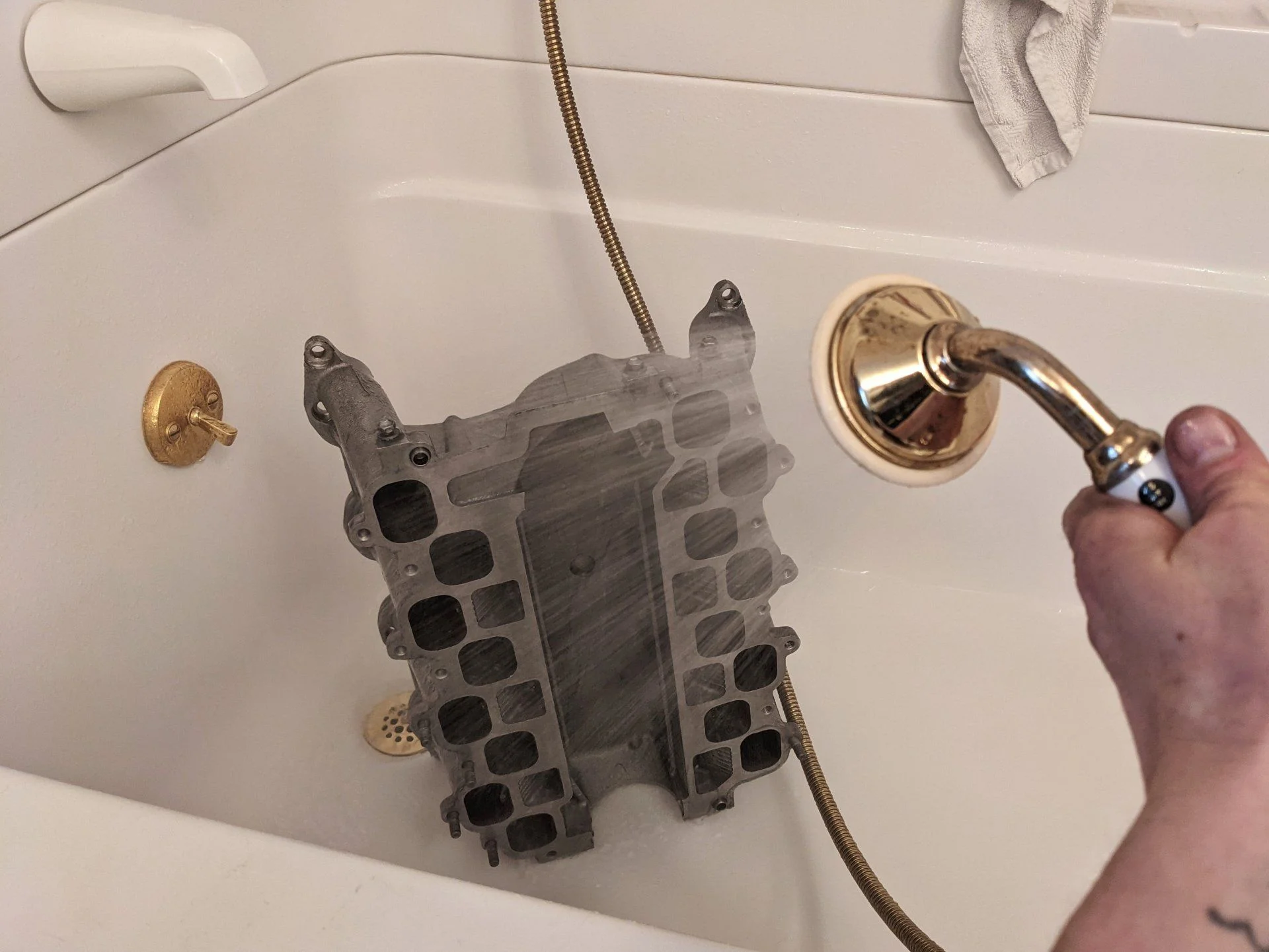

Spa day for my intake. Been snowy and cold and was 60s today, some gave my intake a good scrub.
Reinstalled my cleaned injectors and reman starter. Replaced a bunch of brittle and broken electrical connectors. The injector connectors were a real pain to replace.
Ended the night by putting a dental pick straight through my index finger.
Among all the activities that are banned by the boss, this ranks absolutely among the highest. Almost as bad as tires in the living room and equal to engine parts in the dishwasher
This was just a rinse after a few hot soapy scrubs in the rubbermaid container outside. The tube was cleaner after I finished.
You gotta set those expectations early on. I'm only engaged and not even living with mine yet so I've just been leaving some things on the bathroom vanity when she's visiting. Call it conditioning.
Oo, my friend you have no idea, do you? A fiancée is not "the boss", even a new bride is not "the boss". Your current false sense of security, is how she is conditioning you! Sorry you had to hear it from me.
More on the topic, @Jczajka was there a need to take the intake off? like a leaky intake gasket or replacing the starter?
I ask because my truck as a mice nest under the intake but when I consulted with Paul @2001LC he was really against the idea of pulling the intake unless there is a real need for it. He was of the opinion that it can cause debris to fall into the cylinder head.
