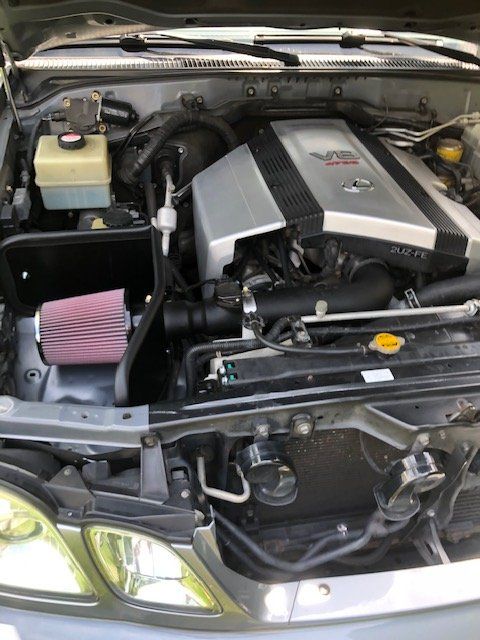

The results look very clean and neat. :cool:
The fit and finish are very good. The only setback I had this morning was dropping a nylock nut down into the depths of the engine bay never to be seen again :doh: So I had to make a run to Lowe's for it's replacement.
The test drive went beautifully. There is now a V8 growl under acceleration where once it sounded like a Tesla. :steer:
Curious if you have ScanGauge or something similar that you are using to monitor the engine? I'm interested to know how this modification affects air intake temperatures?
I'm not using a ScanGauge at the moment Pete. Many folks believe the only cold air getting in there is at cold start. :rofl: The box is just wishful thinking.:devil:
I've had very good luck with K&N for many years, in many mobility platforms and I like to think the 4.7L air pump in the Four7t will as well. Others advise the oil cloth does not do it's job and harmful particulates will infiltrate but I'm not so sure. I will need to stay out of the deep water for now...:cheers:

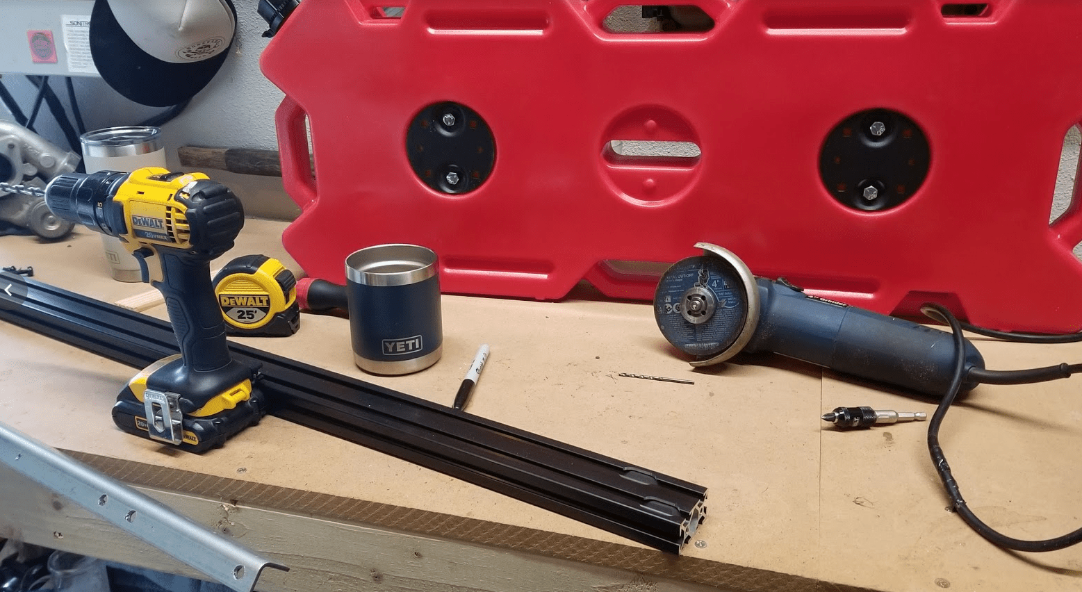

Didn't like the cost or options for the branded attachment options so made my own brackets to get the Rotopax mounted. Much less expensive, and probably stronger.
