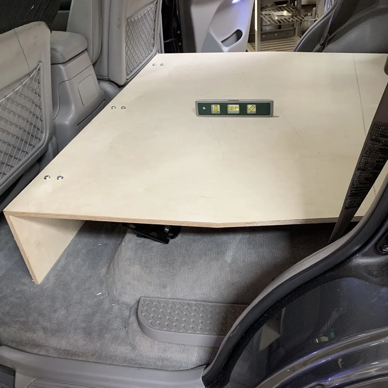

Started my second row platform.

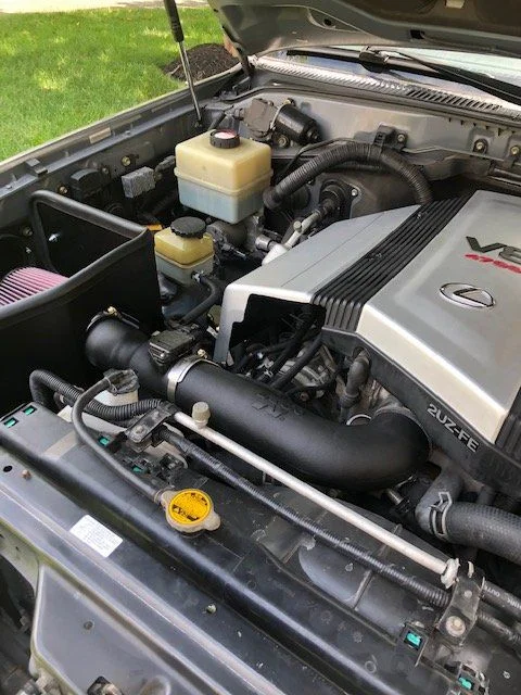

Found a younger MUD'r who had sold his '03 LC with a K&N Cold Air Intake for sale. Brendan and I came to terms yesterday and I went to work this morning...
Once I pulled this off the engine, the front end came up ~1/2". Can you say restrictor plate racer?
The results look very clean and neat. :cool:
The fit and finish are very good. The only setback I had this morning was dropping a nylock nut down into the depths of the engine bay never to be seen again :doh: So I had to make a run to Lowe's for it's replacement.
The test drive went beautifully. There is now a V8 growl under acceleration where once it sounded like a Tesla. :steer:
I used to have a 2003 tundra with the 4.7 and this intake... its making me want one for the lexus now haha
I have an SRT intake on my GS430. Was one of hte first mods I did when I got the car ten years ago. It completely transforms the sound of the UZ motor. Even better if you have a catback exhaust.
What's the downside of doing this on a 100? How would that hold up to water and mud? My engien bay looks like hell after every trip. I literally spend hours pressure washing everything to get all the mud off. On the GS, I always cover the open air filter with a bag to not get it wet.
Anybody have experience with doing this mod on a LX?

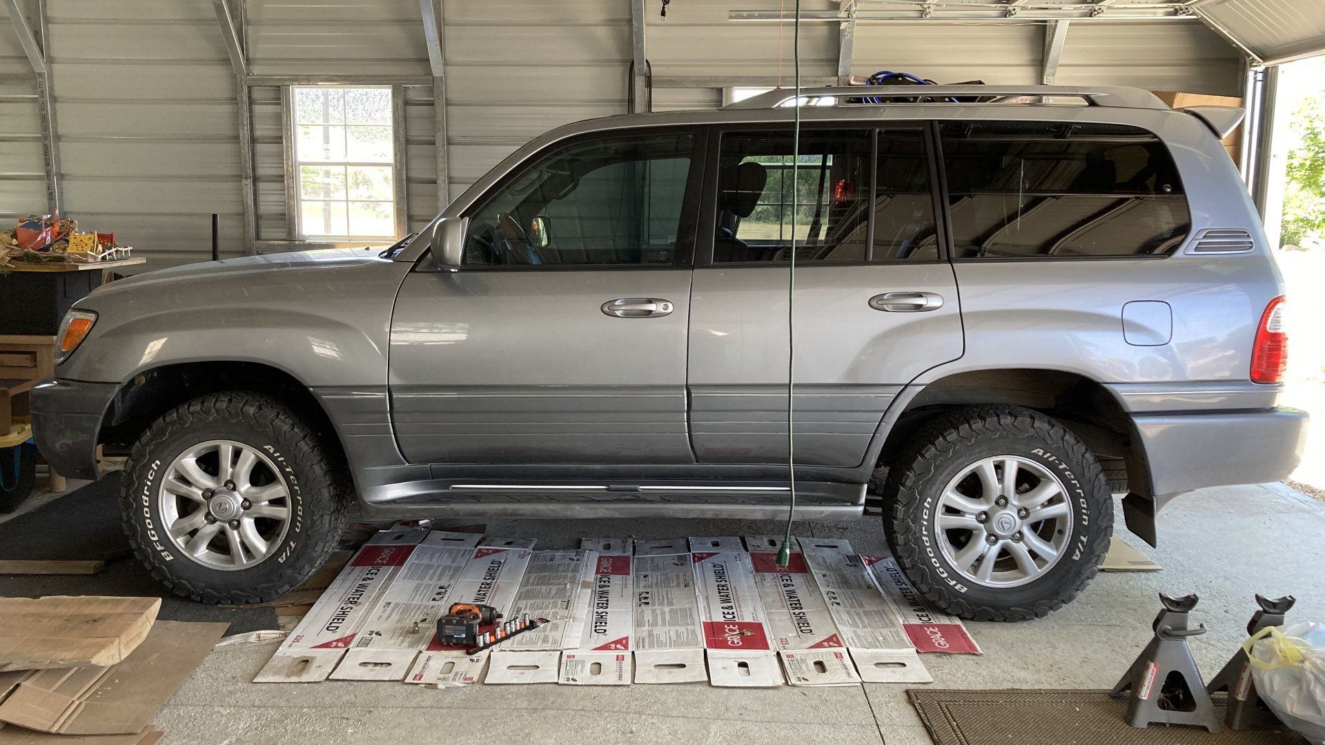

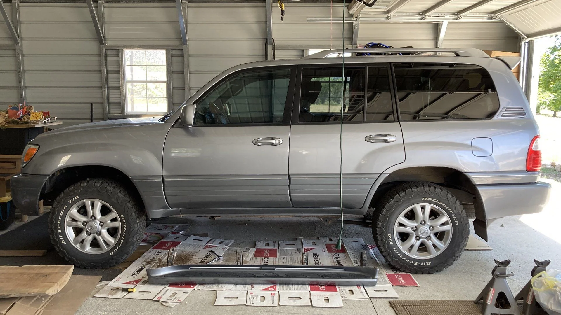

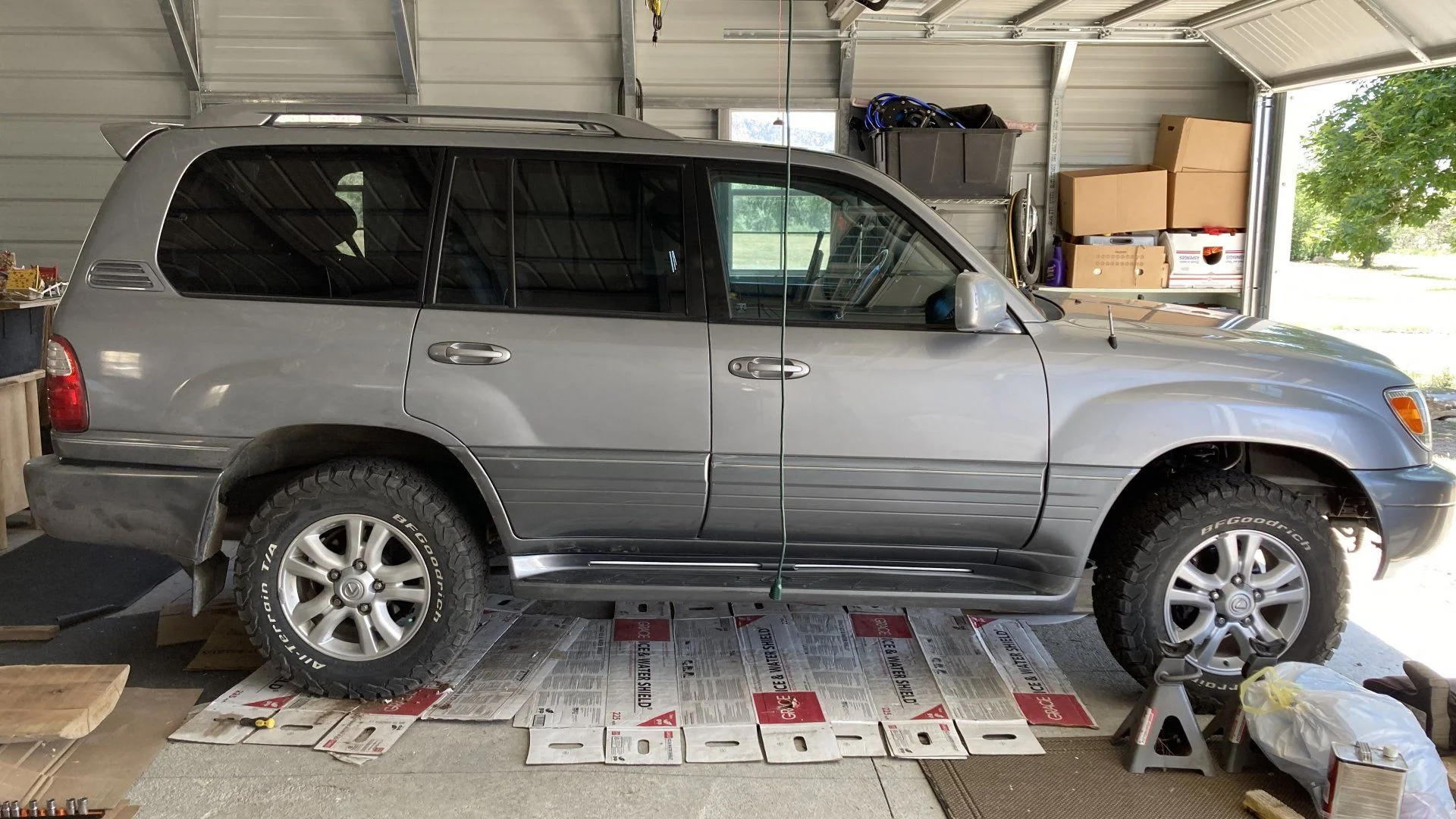

Getting ready for a couple days in Moab, so the running boards came off. We’ll see if my better half likes it or not next week. Meanwhile about 5 lbs of stone and sand hoses out of them...
