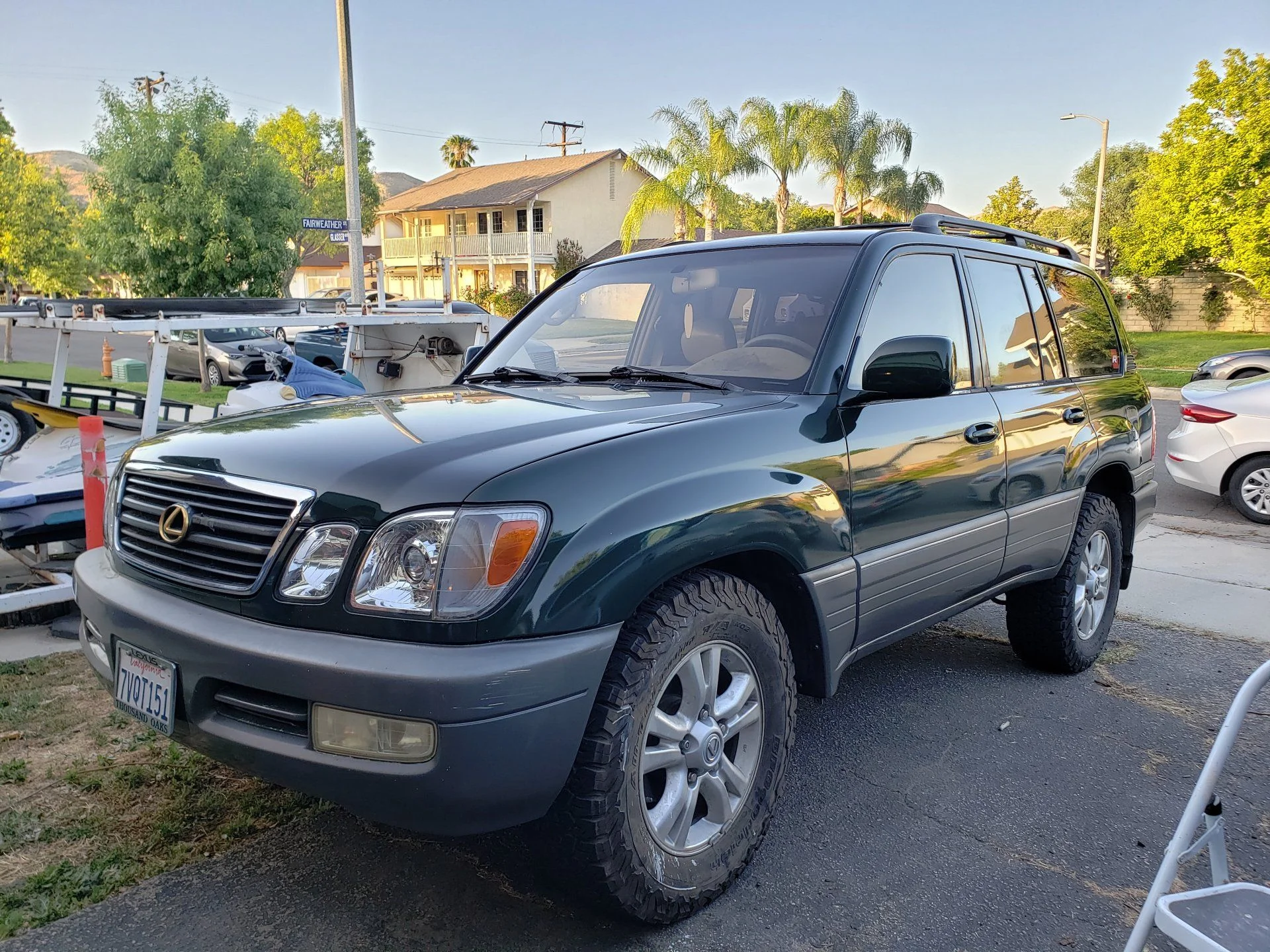

Purchased an incredible 2005 Land Cruiser. White with 215K well documented miles on it. The vehicle was kept in a climate controlled garaged, meticulously maintained, bathed often and hand dried before being put away for the night. Drives like a dream! And so the build begins.
First things first, went with Dobinsons < 2" lift with torsion bars and the latest and greatest IMS shocks. Install went great this morning. 4 hours later and she's ready for one of a kind wheels and some beautiful Cooper 33's.

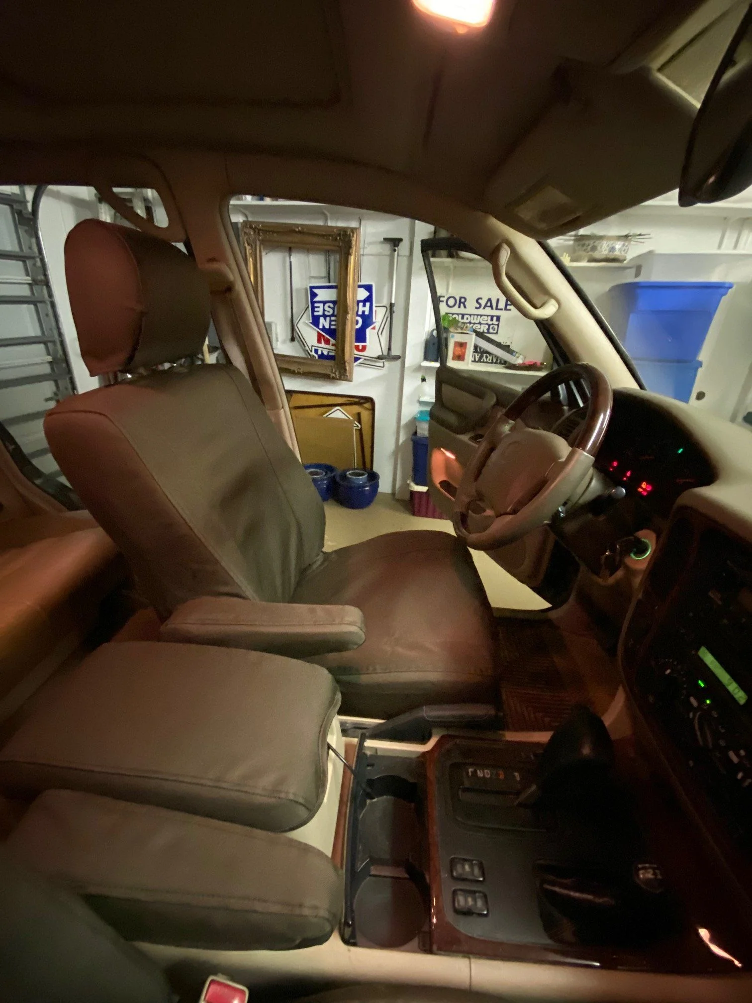

Inside she's nice & clean though I think I'll put in the new cushions all around and some nice new leather too. Perhaps two tone, we'll see.

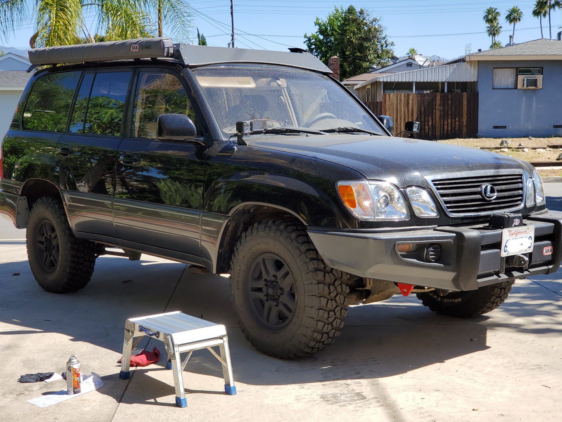

Got off my butt and did a couple things.
-Found some old rack bushings and used the sleeves inside with the washers for the spare Tire mod. Perfect length!

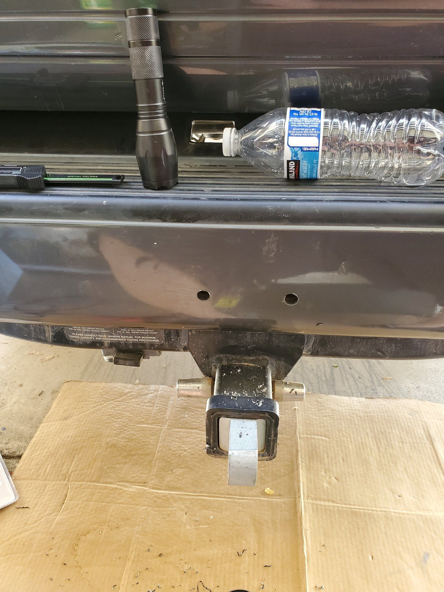

-Ended up having the pintle pattern holes in my rear bumper frame. Ordered the receiver and need to drill the last two holes In the plastics to expose the captive nuts just above.

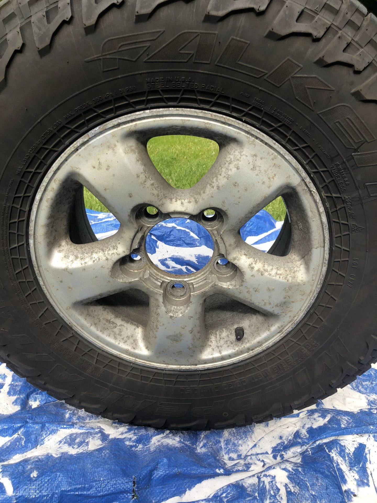

-Painted my wheels flat black.
Am very intrigued by this as well. Would love the cleaner look and additional departure angle this would allow (though minimal)... Not to mention I could get rid of the current hitch that's all rusted out 🙈
I assume this would limit the towing capacity and max tongue weight a bit?

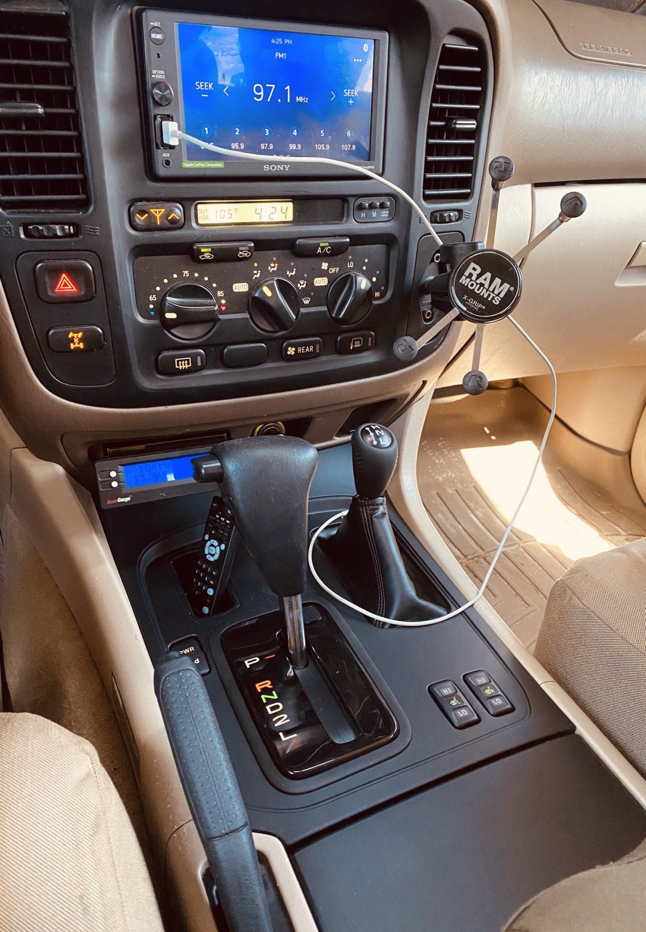

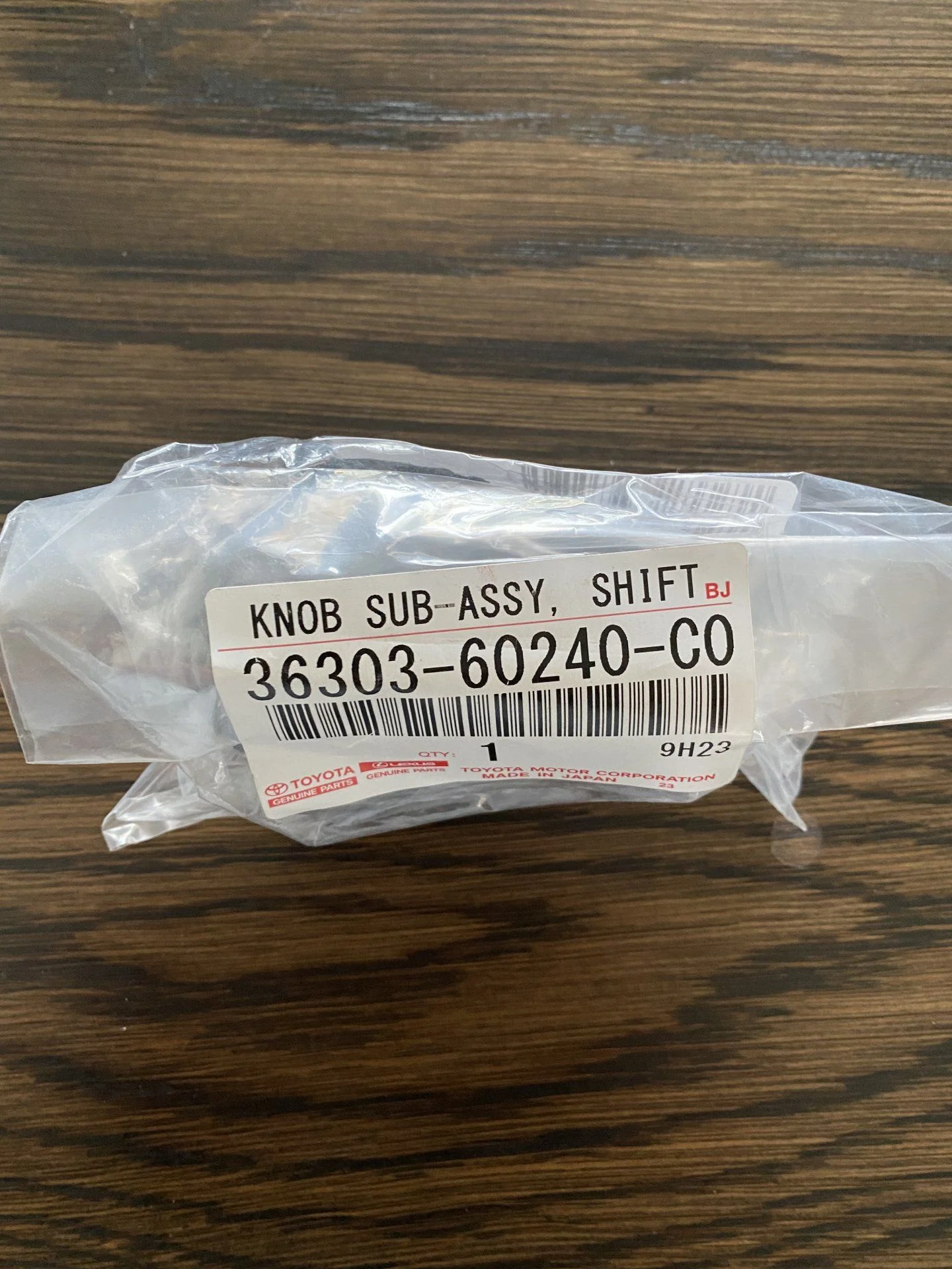

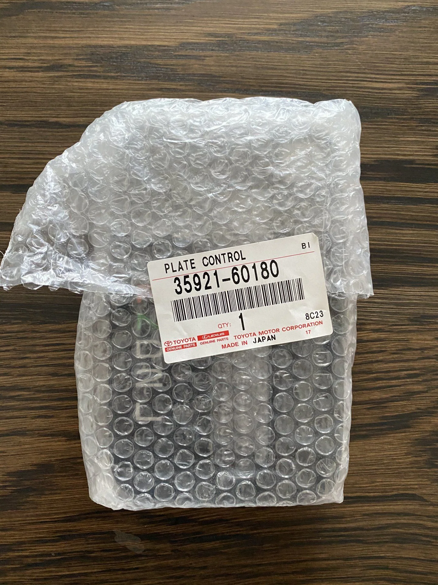

Updated the front console with a new OEM 80 series gear shift handle (followed @Ayune directions); New OEM t-case shift knob; new OEM shifter face plate; new OEM panel.
New RAM Mount from @BenCC and new ash tray mount from @CruiserGarage to mount Scangauge 2.
My 1999 Cruiser front console looks showroom new again!
Simply put on a receiver mounted to the cross member. Then while trying to get my spare out of the way discovered I HAD an anti theft key in there. Wtf!🤬😡! Who the hell staels spares... anyway, Glad I found it. Would have sucked to discover that anywhere else. It’s through the bumper . While not beautiful it is functional.
