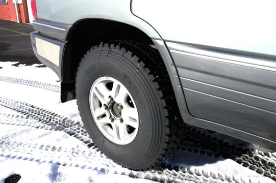

New tires, just in time for snow
Toyo M-55 255/85R16's...
...33" of super hard tread.

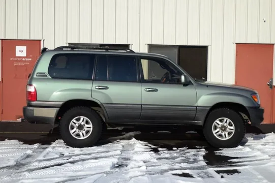

I got some new tires two days before Thanksgiving and then went and took the LX on a road trip to Idaho and back to Eugene. The tires did splendidly on gravel, frozen two lane, and high speed highway. Pretty smooth and quiet for the tread and hardness.
We got hit here in Eugene with some major snow (for us) and I had the opportunity to try them in the snow today. They worked pretty well with no slipping that I could tell. I will run them through the winter and spring and will then throw a comprehensive review up on the forum.

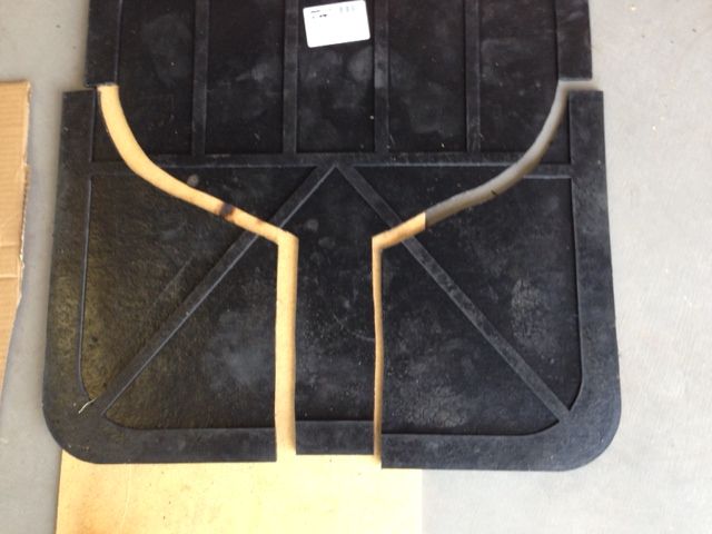

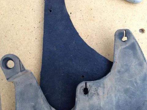

Mudflaps. I couldn't bring myself to pay almost a $100 for front mudflaps - OEM or not, so I went to Napa and bought a 24"x 24" semi mud flap for a whopping $14. I cut it up and made two flaps for the hundy. I also made a pair for the Tacoma. On the Tacoma I had one left on the front and used it as a stencil. I noticed on the original that it had slots to allow the flap to tear away if bound, so I added those to my new ones for both the Tacoma and hundy.
cutting:
tear aways on Tacoma flap:

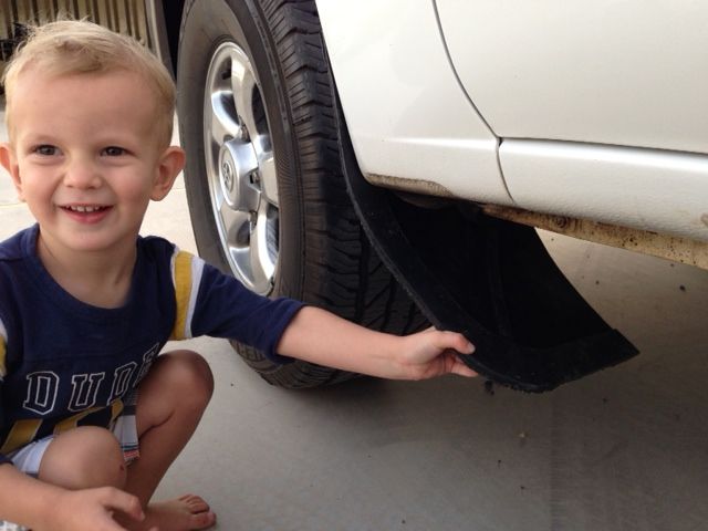

I really like that these DIY flaps can flex so much - which I think is an improvement over the OEM ones because they could break sliding over a rock for e.g. My helper Dude showing the flex:
They also drop down lower than the OEM ones I think - and should be compatible with my sliders...

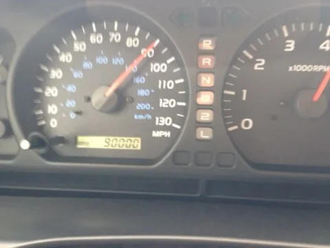

Also this 01 hundy finally turned over the big 90k on a quick trip to Tucson for family photo shoot.
