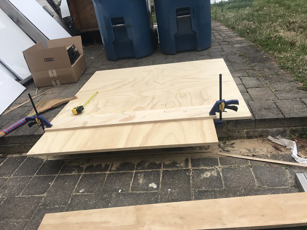

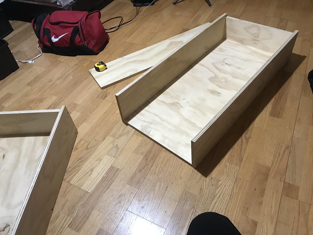

Day 1 of quarantine, boredom struck me badly so i started building my sleeping/storage platform. If shiet hits the fan and i lose my job, i can sell my house and move into my cruiser.
Left over wood, built the drawer units
I don't have the patience or need to make it look pretty like the last one, as long as it's functional, might not even carpet it.

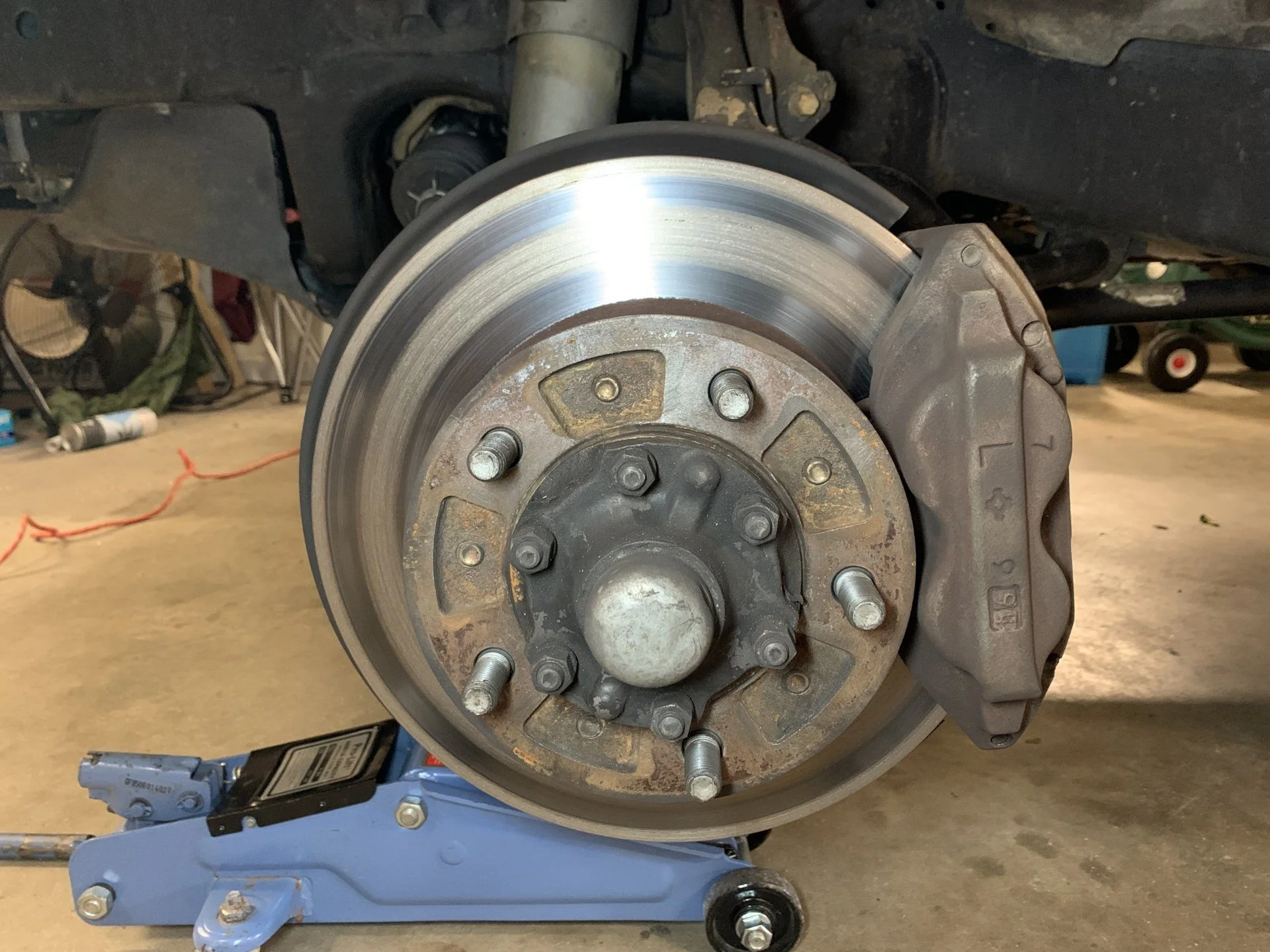

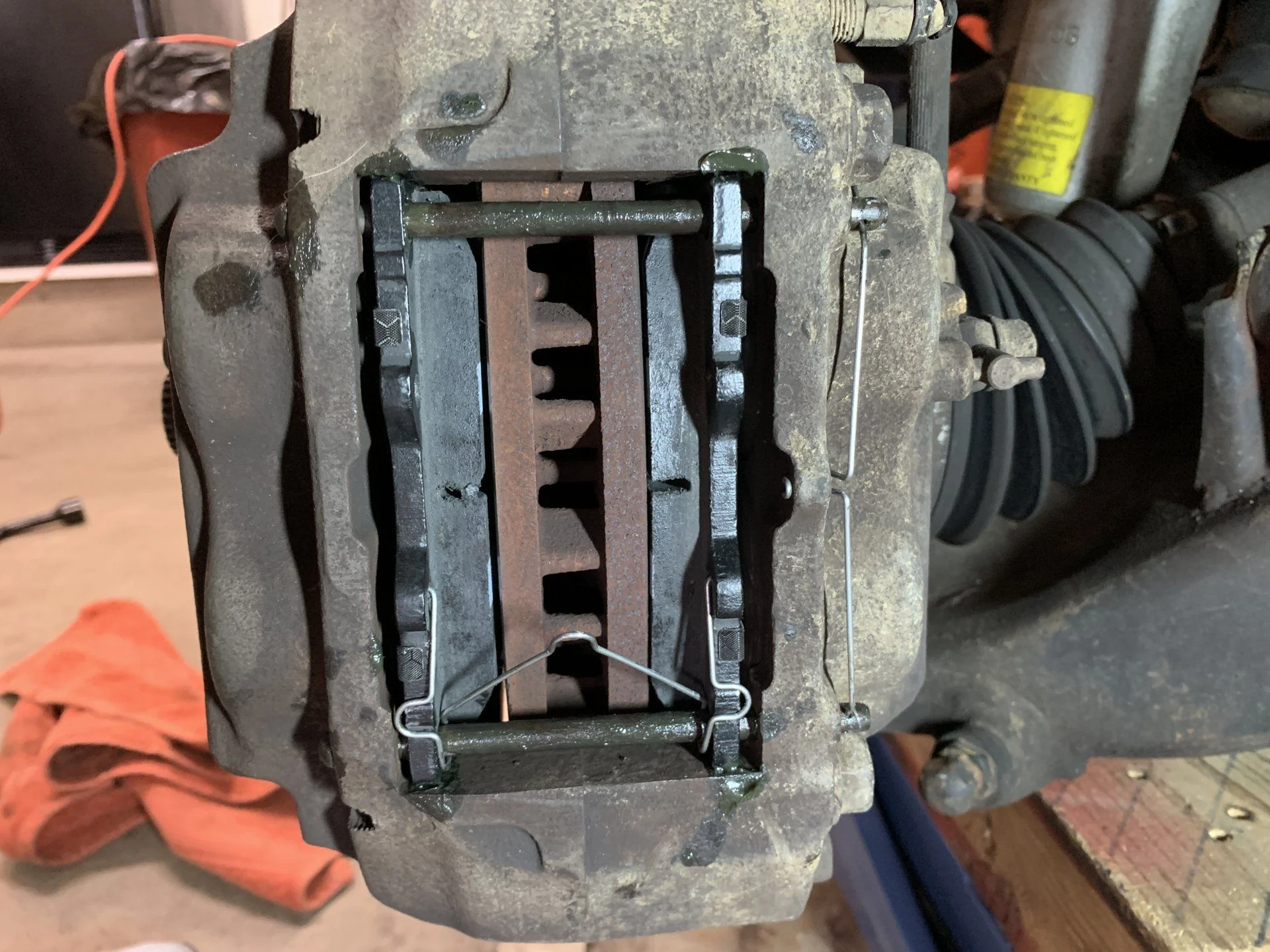

Started hearing a terrible grinding noise from the drivers front wheel. Kinda sounded like the squeal tabs on brakes so I went and bought some ceramic pads from Autozone. Got home, removed the wheel, and quickly realized just how gouged my rotor is:bang: Bearings are fresh and tight, upper & lower ball joints are solid, steering rack/tie rods are brand new, so what could it be you may ask?? The damn c-clip popped off the axle shaft which allowed the rotor to move in and out over every bump, which caused the pad to scrape my rotor at weird angles. The clip was just hanging out in the dust cover. Threaded a bolt into the axle, pulled it outward as far as I could to slip the clip back on, ‘resurfaced’ the rotors as best as I could by sanding and scuffing to make it driveable in the meantime, and threw in the new pads. I have two new rotors and larger c-clips on order. I’m really glad I caught this because it could’ve been a catastrophic failure! It also solved the ‘clunk’ that I assumed was worn splines in the hub flange.

Same exact thing happen to me last month. I noticed my brake pedal going soft and having to pump it twice to get stopping power. The clip had popped off and the 54MM nit had backed off a bit. I chose to not replace the rotor or pads since both were fairly new with low miles on it. A month later and you cant even tell anything was wrong with the rotor and braking is great.

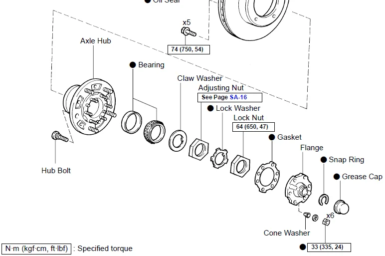

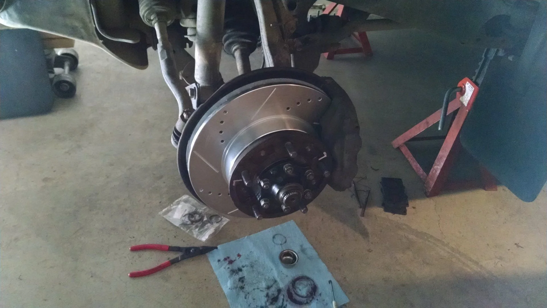

@TheForger, Your C-clip does not control your hub and rotor moving in and out, that is controlled by the two huge spindle nuts shown below. I would wager that the clunk was your CV moving in and out of the hub slapping the back side of it. I would triple check the spindle nuts on the front side and the seals and surfaces on the back side for damage. cruiser outfitters stocks everything you need including drilled and slotted rotors, that is where I got mine.
100% agree. That's why the bearings were actually the first thing I checked and they're torqued to 68ft-lbs to get 14.7lbs of break away and seem tight don't have really any play in them. It's really weird because you're right -- the c-clip doesn't keep the hub from moving, it keeps the axle from moving. However, after reinstalling the c-clip there was a noticeable reduction in play. So honestly I'm kinda at a loss for words as to how it helped. Obviously the axle no longer clunks, but I still don't quite understand how that could've caused the rotor wear. Maybe the missing c-clip allowed for like 2mm of movement and that was enough to cause the gouging??? All I know is I don't have nearly as much play (the little bit remaining is from the stretched c-clip, but like I said I have more on the way) and my brakes no longer grind :)
