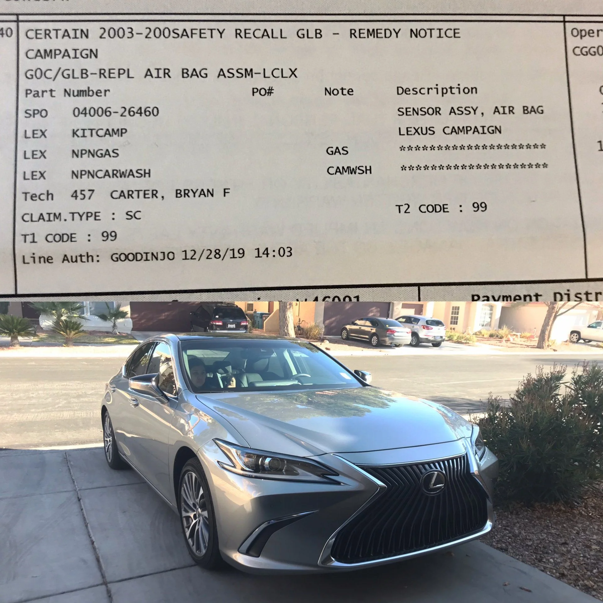

No more carfax alerts: airbag recall done and drove this purdy little thing like I stole it :steer:

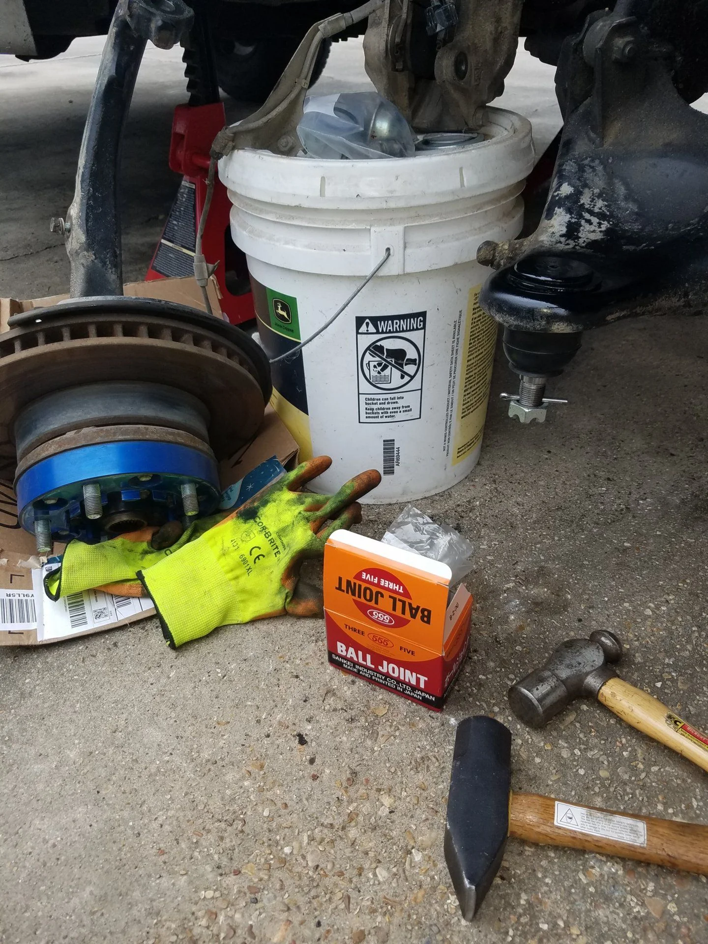

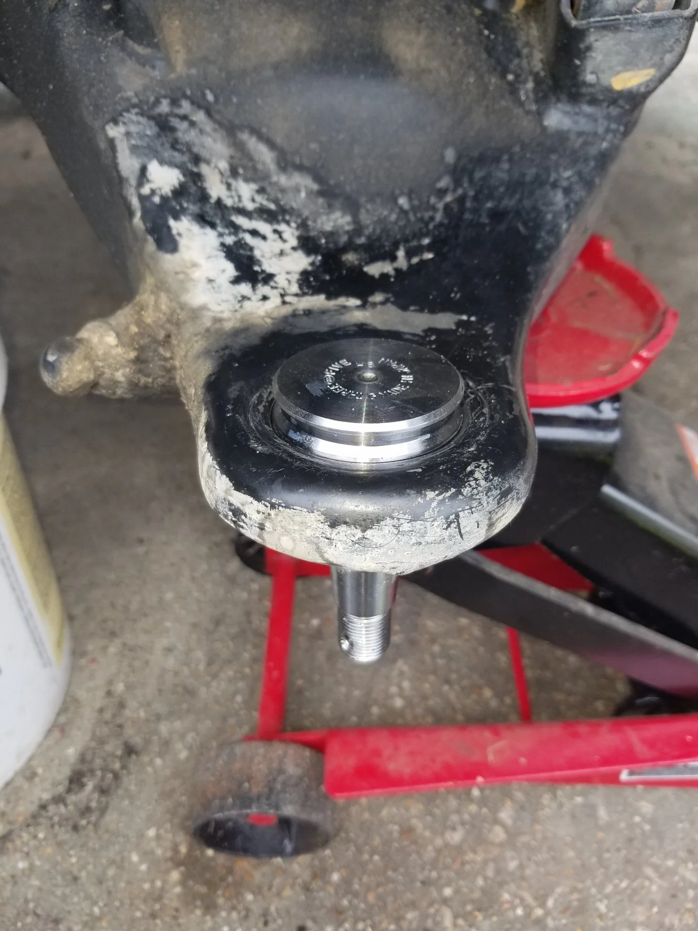

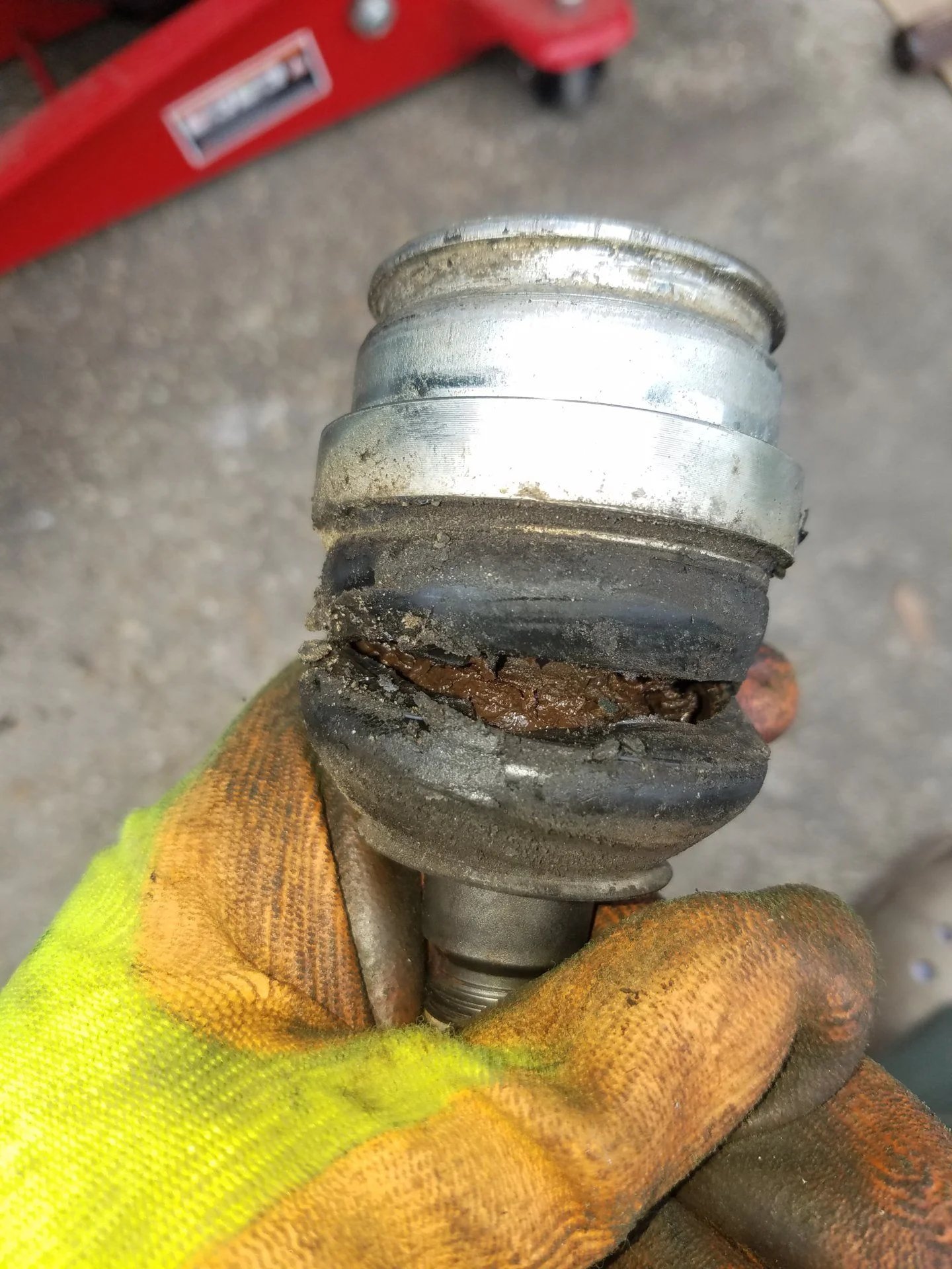

Changed my right lower balljoint with a Three Five replacement. A torn boot did the OEM joint in and I found almost 1/4" of play in it moving the elevated tire around with a prybar. Sourced the replacement balljoint at my local Napa and used a loaner press kit from Autozone to remove/replace. Hit top flat of 555 joint with a quick coat of primer and black rustoleum after putting c-clip and boot on to prevent rusting.

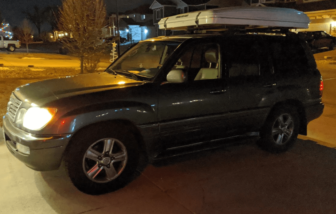

I regret to inform @nukegoat that I made the mistake of bringing home an '06 LX without nightview.
Better pics and videos and all kinds of nonsense to follow once I have some time in the day.
