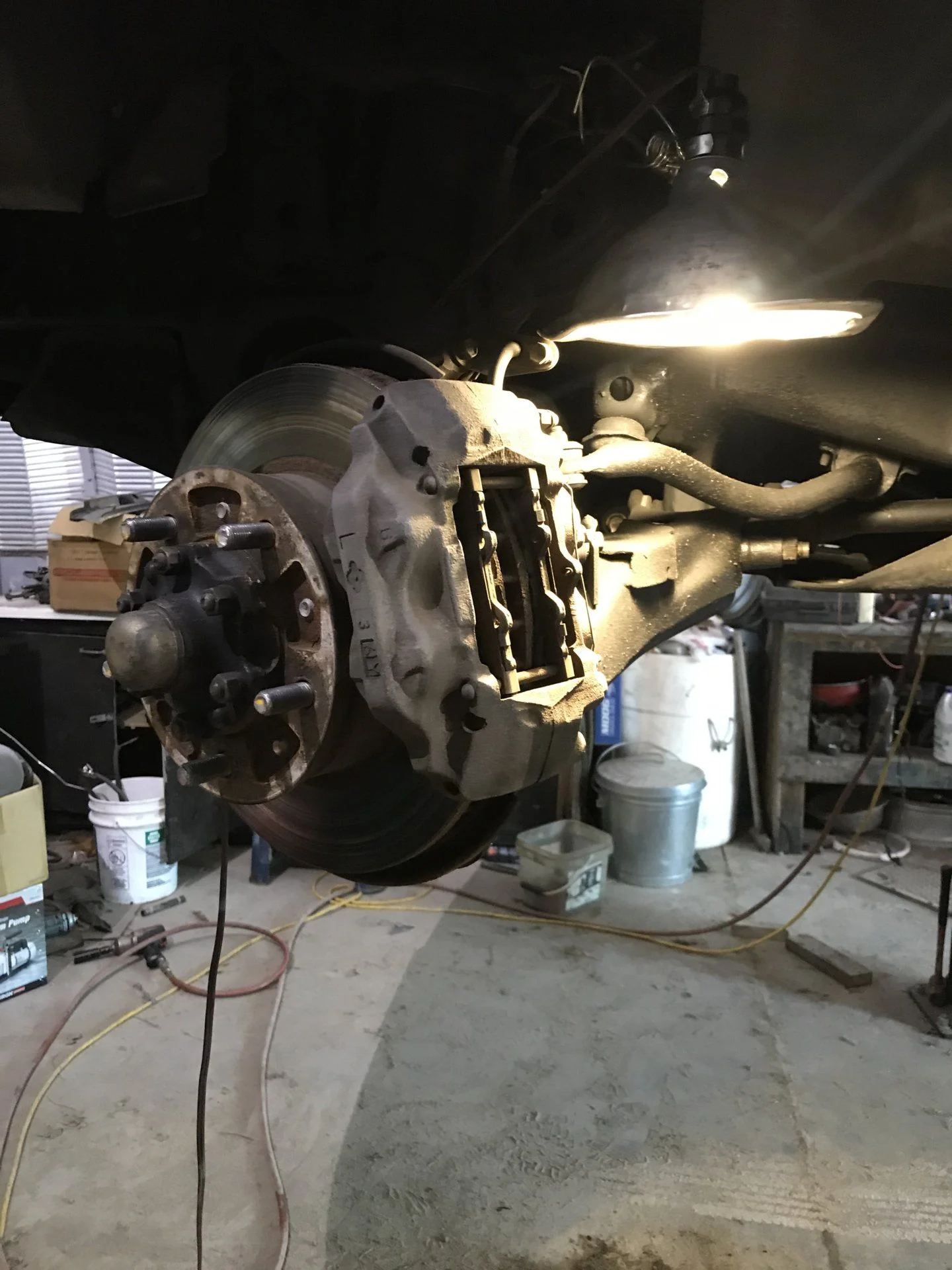

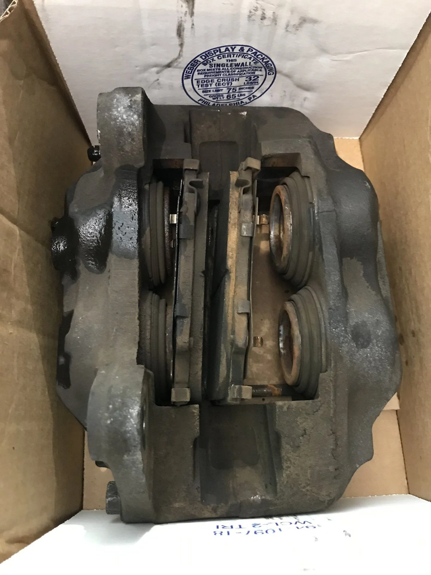

It all started because I needed to do rotors. The fronts have always had vibration (warped) but the rear pads where on their last legs so it was time.

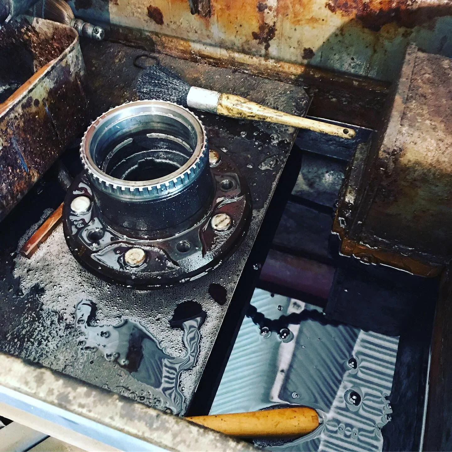

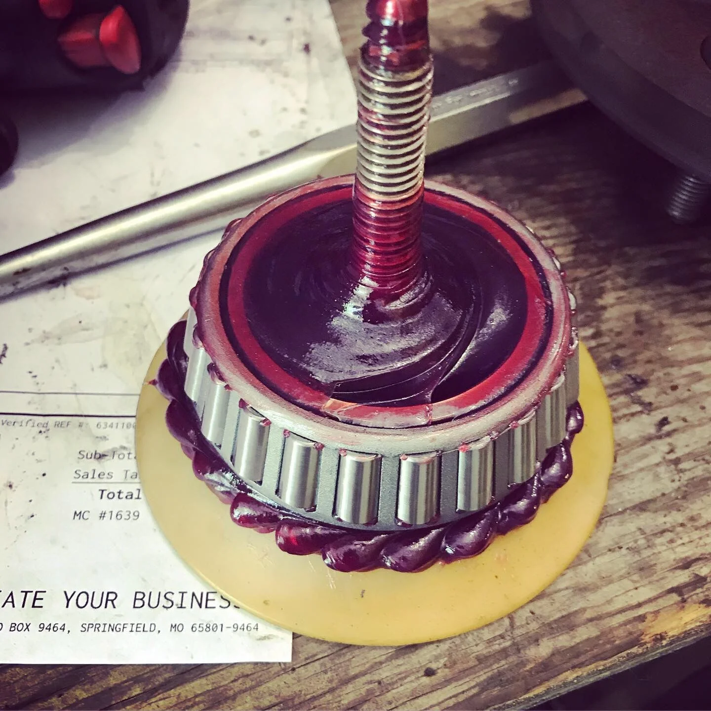

If you haven’t done these before, it’s not fun. To do a front brake job you need tear down the hub, so you will need to repack the bearings on the reinstall. might as well replace them inner and outer, I did. We came to the conclusion that the front calipers were hanging up. So instead of doing a rebuild kit, I bought new ones. I wouldn’t suggest going through Toyota for these $$, I was lucky and was able to get them ridiculously cheap through my mechanic. I don’t think I would of been comfortable with doing the front set up on my own, with the bearings and seals and setting the preload it’s a lot.

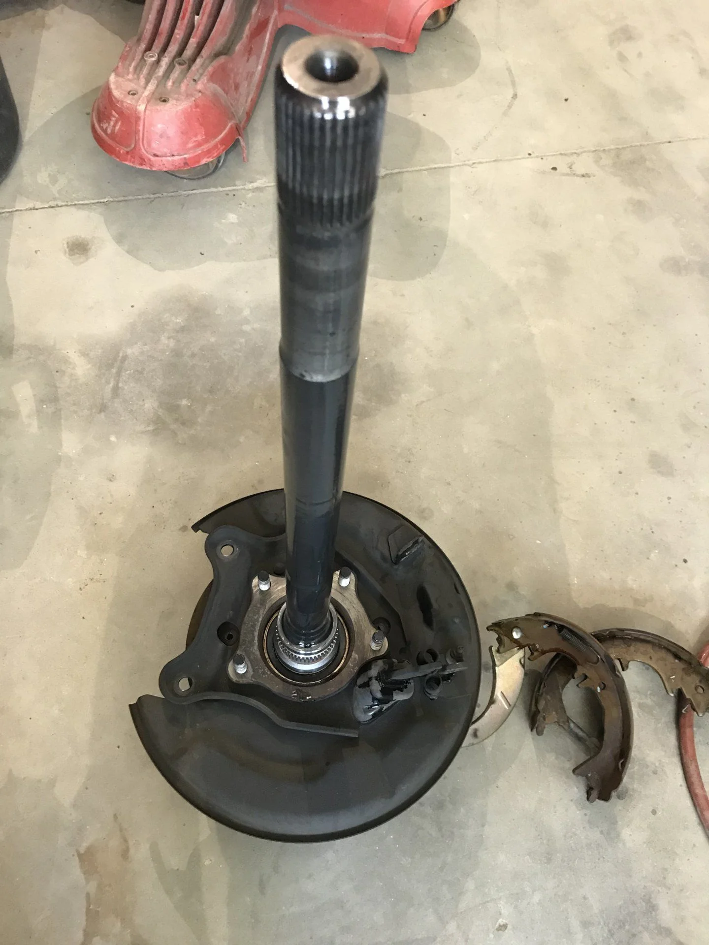

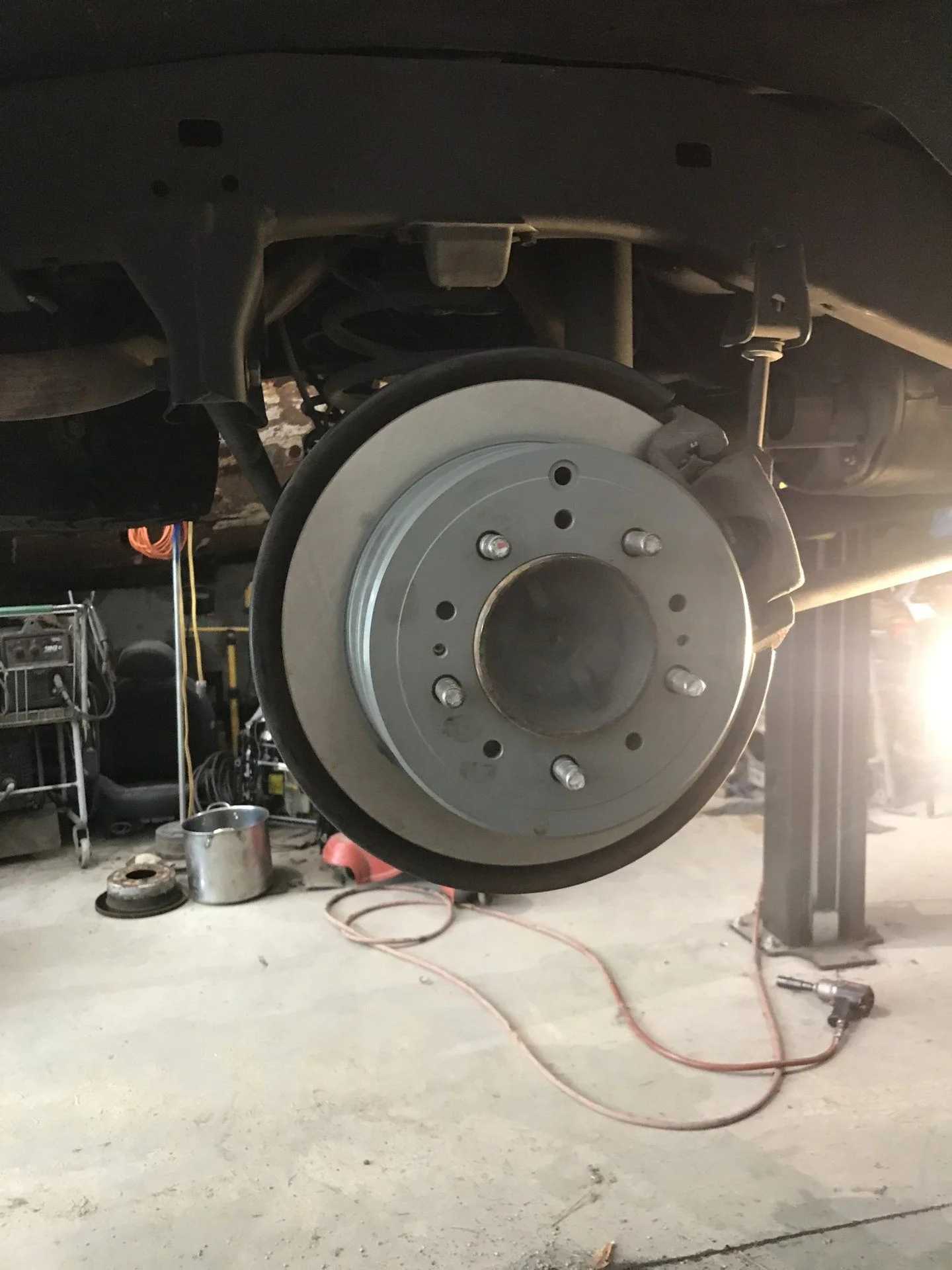

The rear brakes were fairly straight forward, we just did rotors and pads, calipers were not hanging up on the rear.

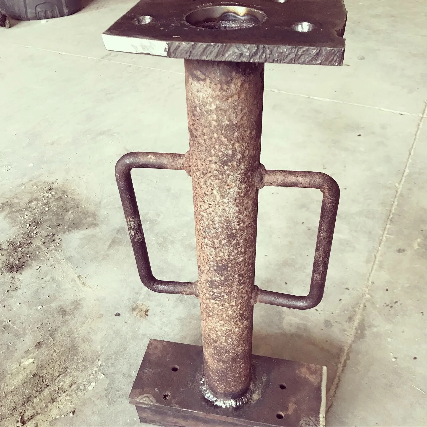

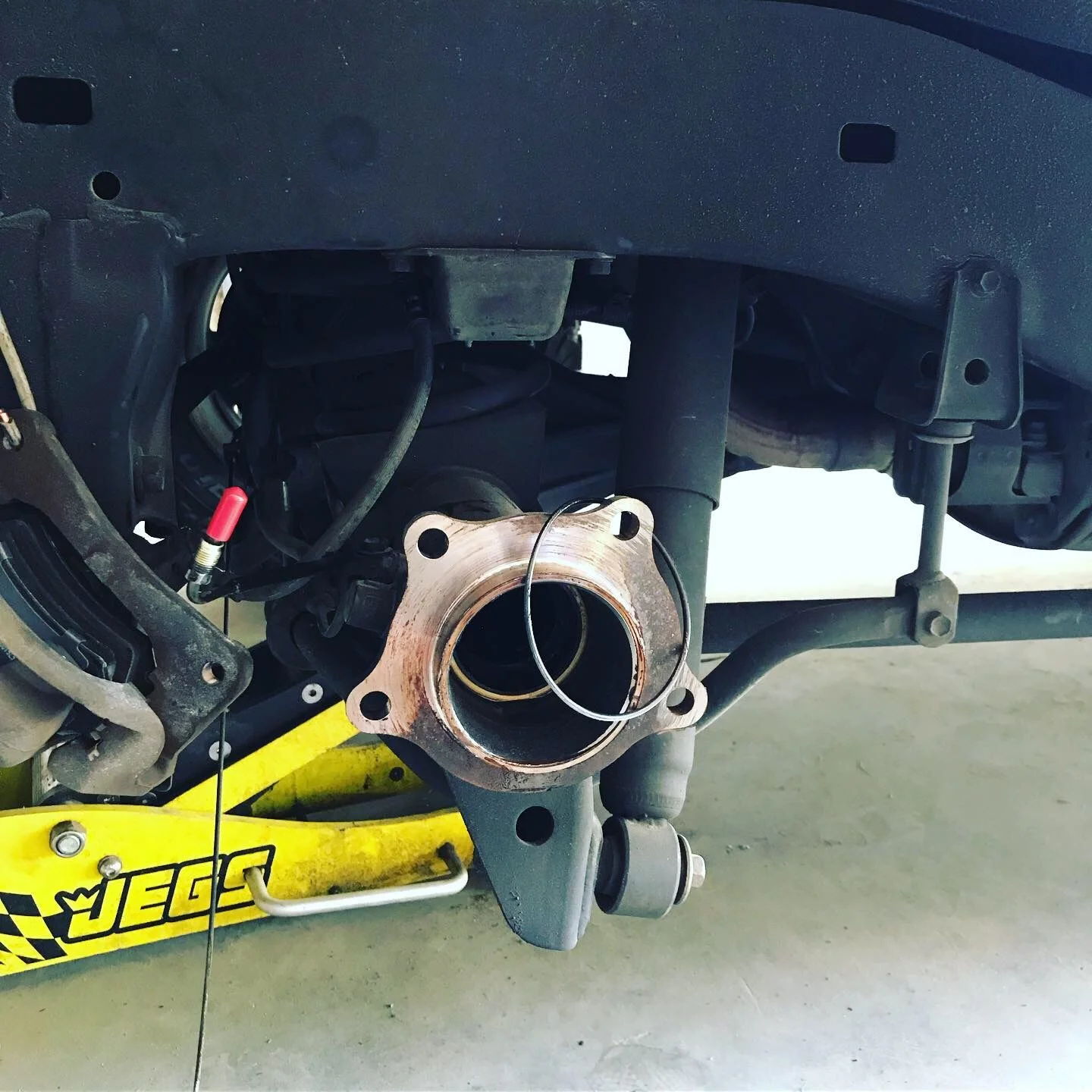

However, during rear brake replacement my buddy found the driver side bearing was clicking and binding. I figured ok, no sweat, I’ll get some new bearings throw them in next week. Wrong. I won’t get into how much work was involved, but my guy had to fabricate two tools to get the bearing free and it took all 20 tons of his press to get them out.

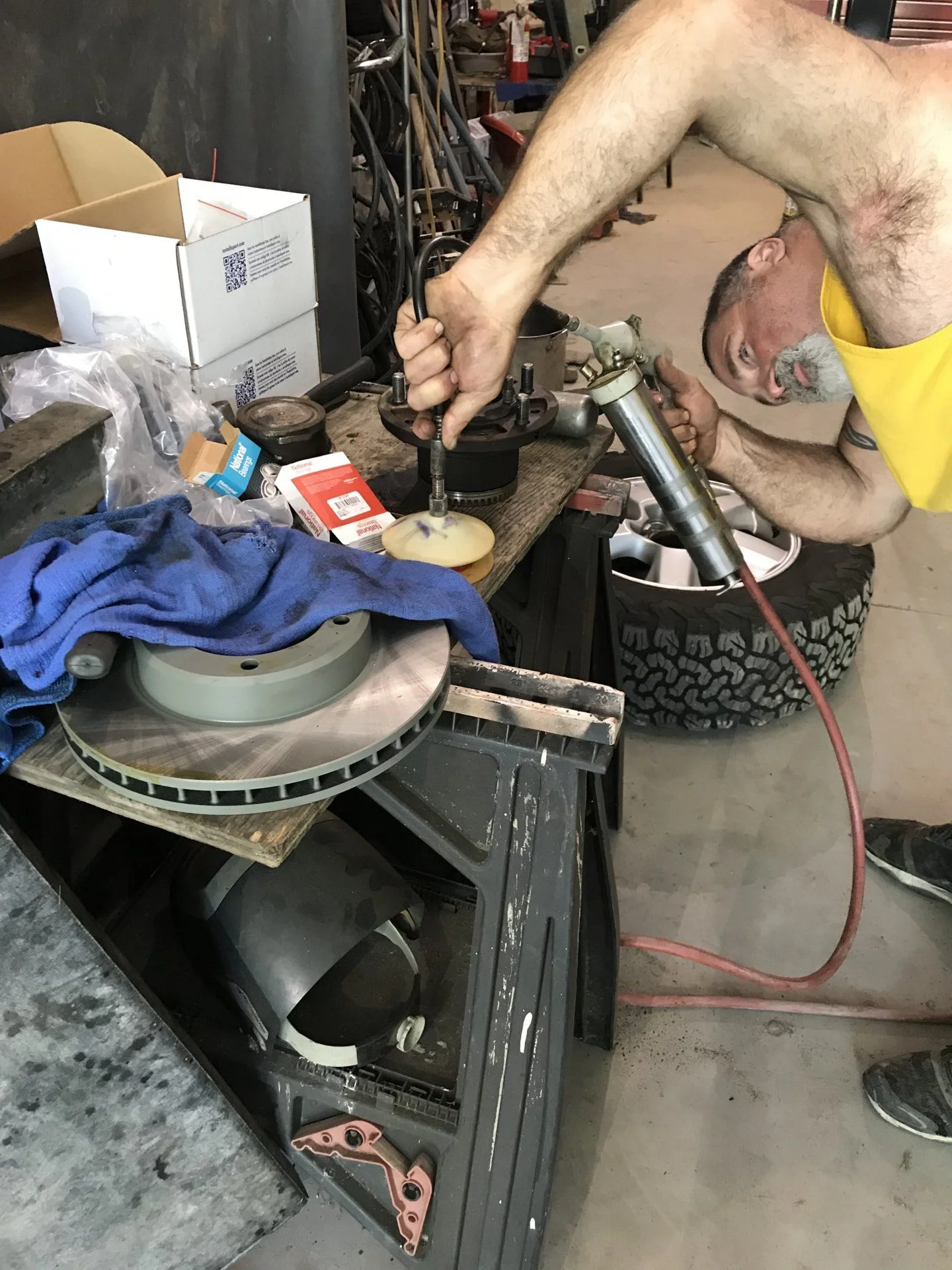

We were also able to virtually eliminate the drive line clunk by using a pneumatic grease gun. But also discovered the clunk generated from pulling away from a stop were from the calipers sticking.

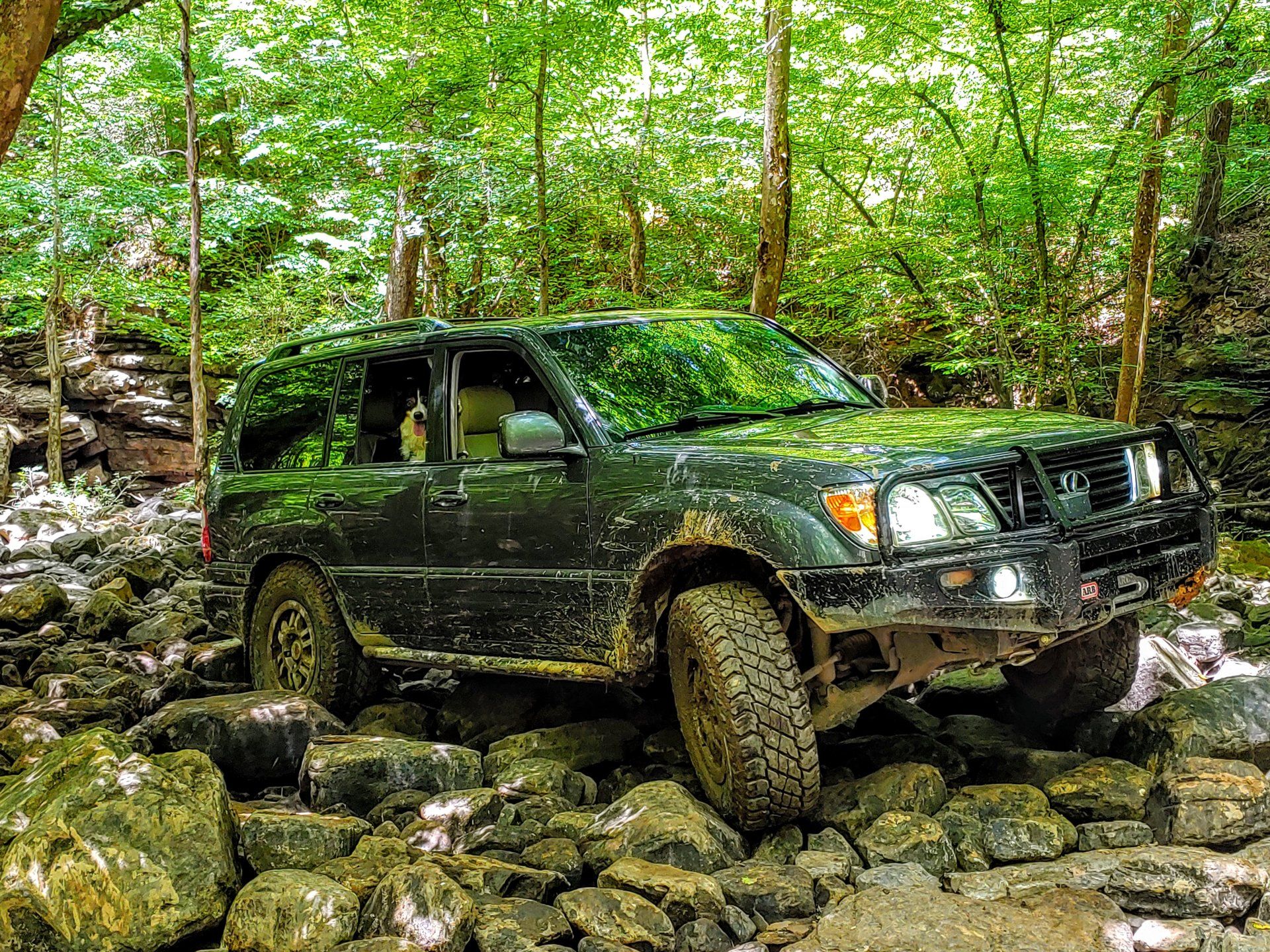

Drove it on some rocks. Really fun day in Tennessee with another mudder in an LX and 2 4Runners.

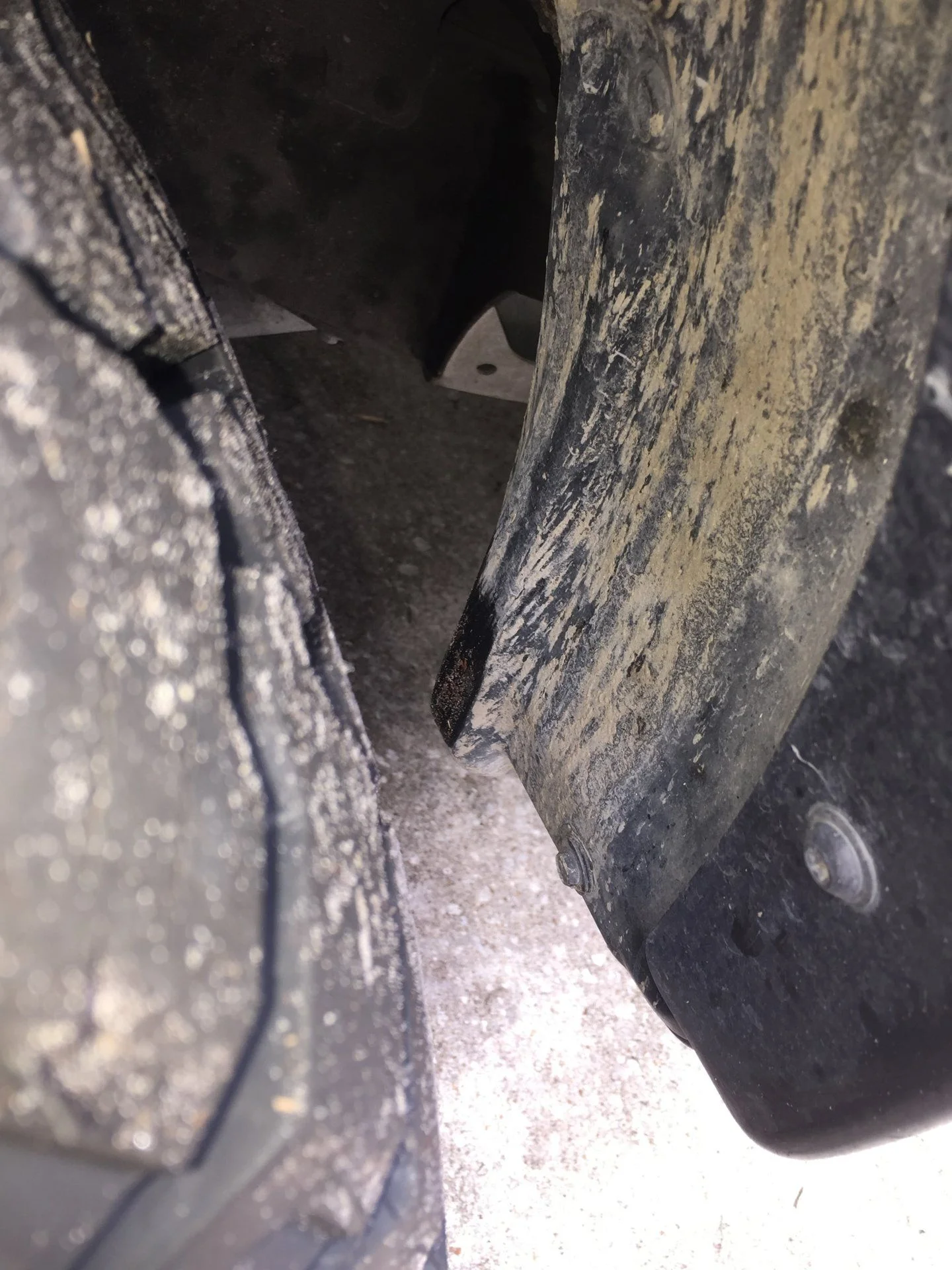

Slammed my back end on a rock the size of a hot tub and tweaked the plastic and the bracketry inside. Oh well, I guess I have to buy a tire carrier bumper now... Darn. Shucks. Fiddlesticks.

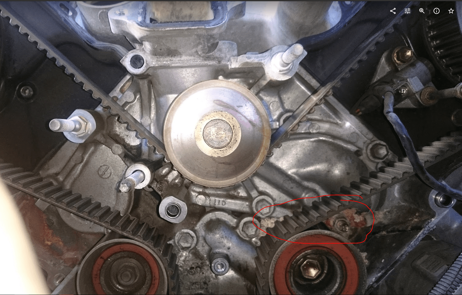

I pulled the air intake and passenger side cover to inspect my timing belt. 1/4 banana job and we'll worth the few minutes it took. My LC is just under 201,000 and I haven't been able to find any service records of it being changed. Much to my surprise it looks new. No wear and not a crack in it. In fact the line up marks are still visible. I'm considering leaving it alone and investing the $300 else where for the time being.
My belt also looked good but they did not change the water pump...

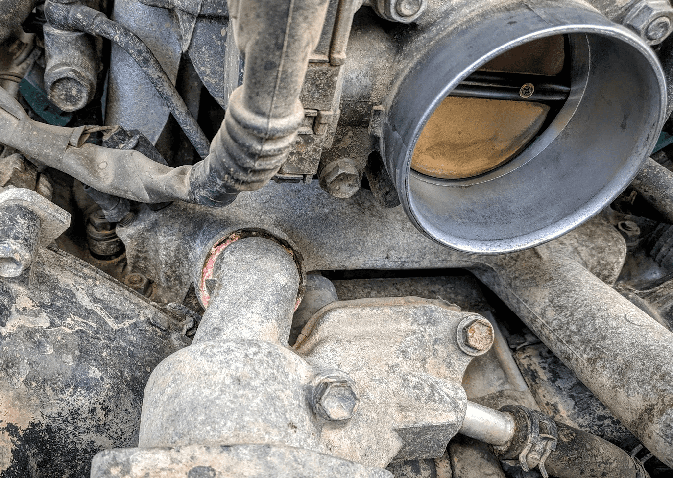

How'd you fix that leak?
Pull air intake, drain radiator, remove water inlet housing. Lost a cup or two of coolant because I didn't drain the block.
Clean all surfaces with emery cloth/barrel brush, apply correct FIPG (08826-00100) and a new o-ring (96761-35035), torque to spec (13 ft/lb).
I waited a few hours to add coolant, may not be necessary.
CO-5 to CO-9 in the FSM has parts diagrams and more detailed instructions, @2001LC 's thread has some excellent pictures and instructions as well: Coolant leak at water inlet and...
This would be a good time to change the thermostat and gasket, if needed, and clean the throttle body. HTH

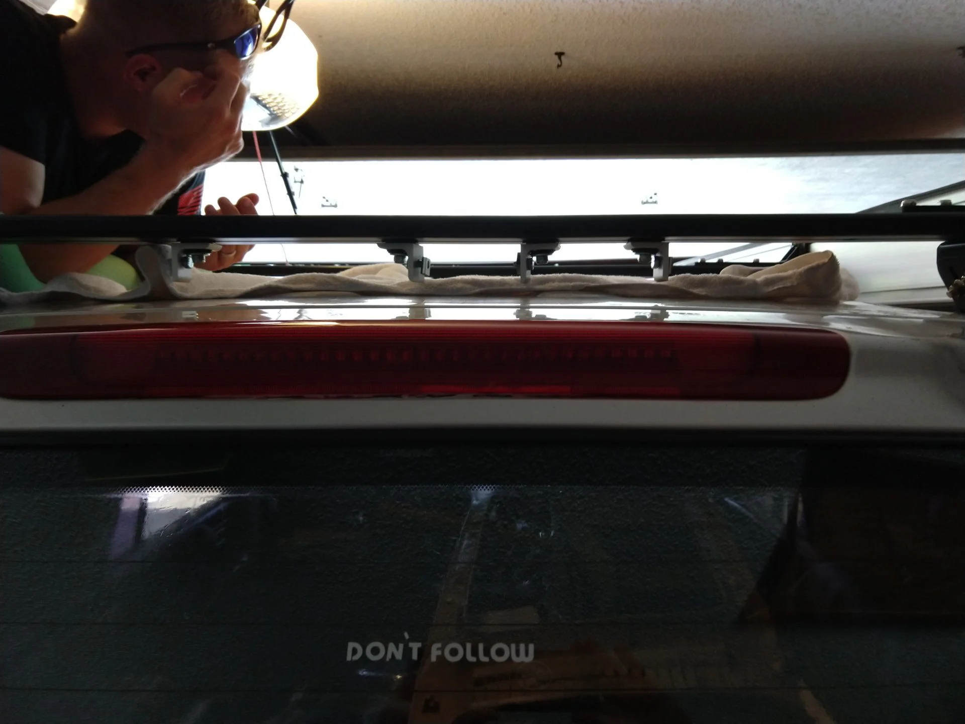

I also installed my @TrekboxX tailgate cover. Perfect fit, looks great, will definitely age better than the old carpet. I was worried I was going to over-tighten and bust the well nuts during install, called David, he picked up and walked me thought exactly what I needed to do. Great product, great guy.

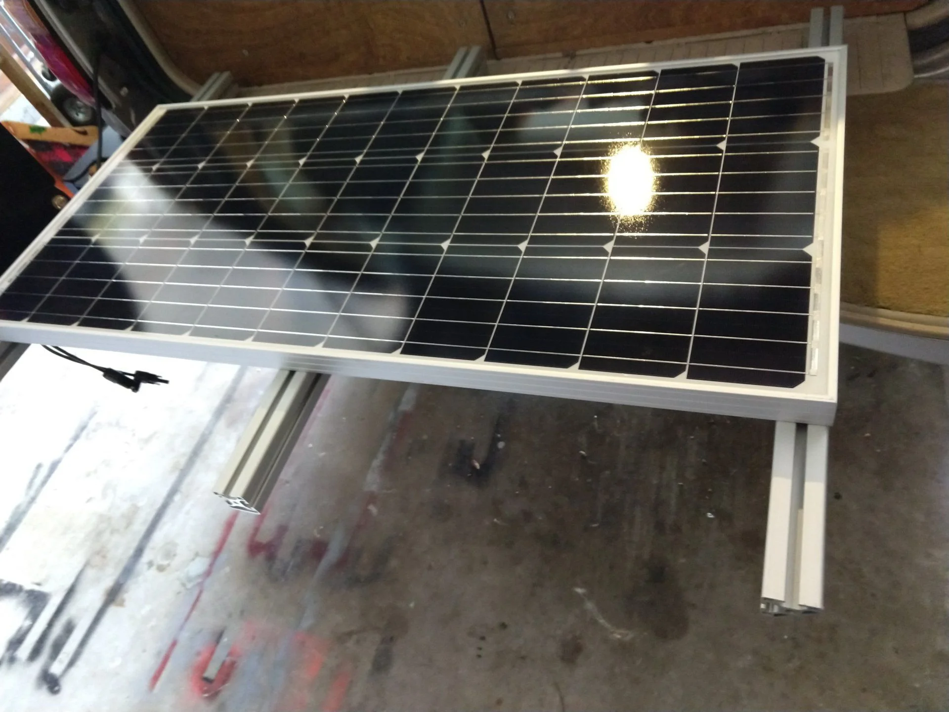

@DragoISAR helped me finish up my solar set up.
100 Watt Renogy panel and Victron SmartSolar controller. Finished as the sun was setting so I will report back with results tomorrow
Update: direct sun yielded me 76 watts @ 5amps. Engel fridge manual shows .5 - 2.5 amps/hr. So very satisfied with this
