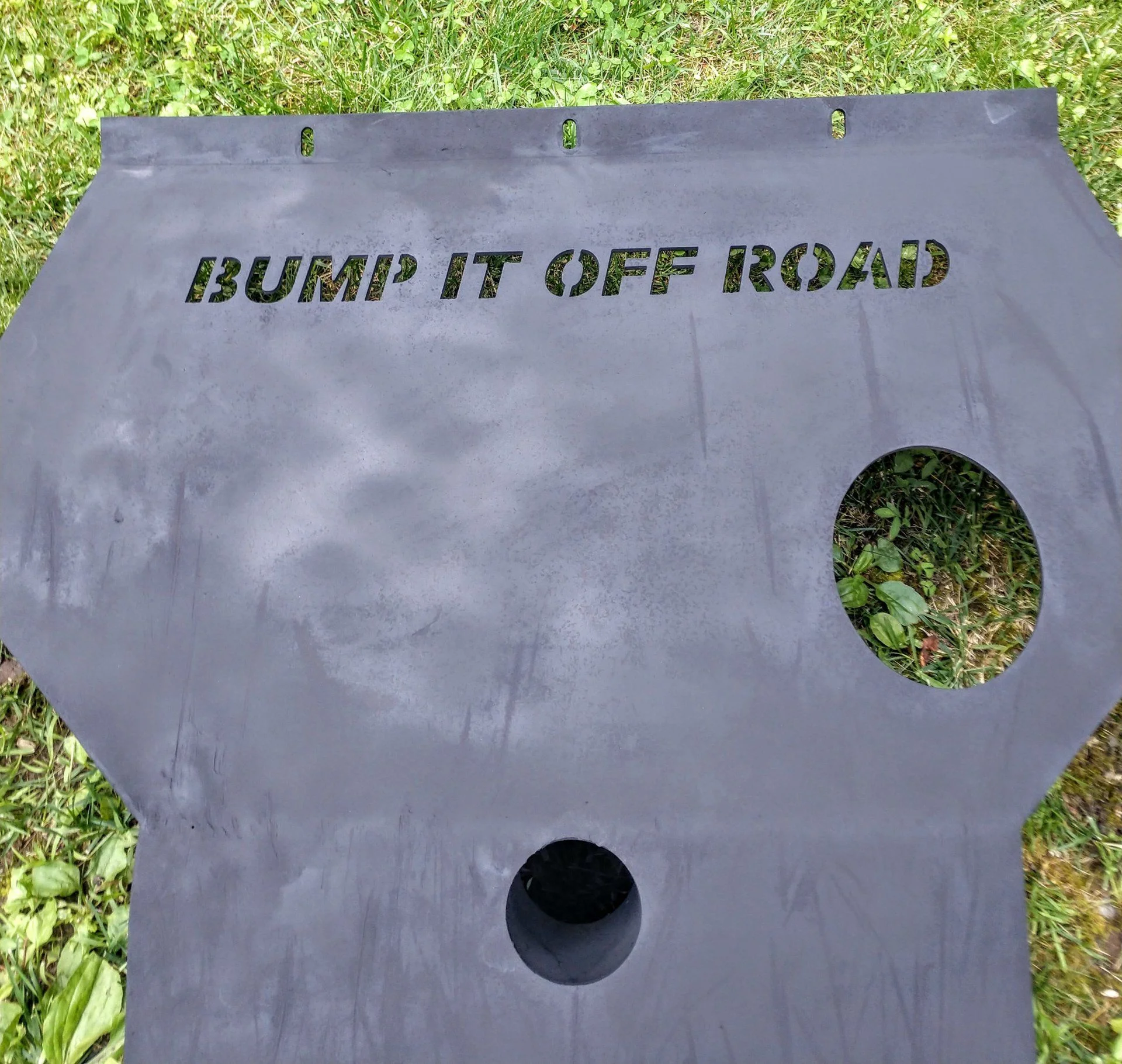

Repainted all the skids after scratching them up this year and last.
Ready to add more scratches at Coal Mine Cruiser Classic next week!

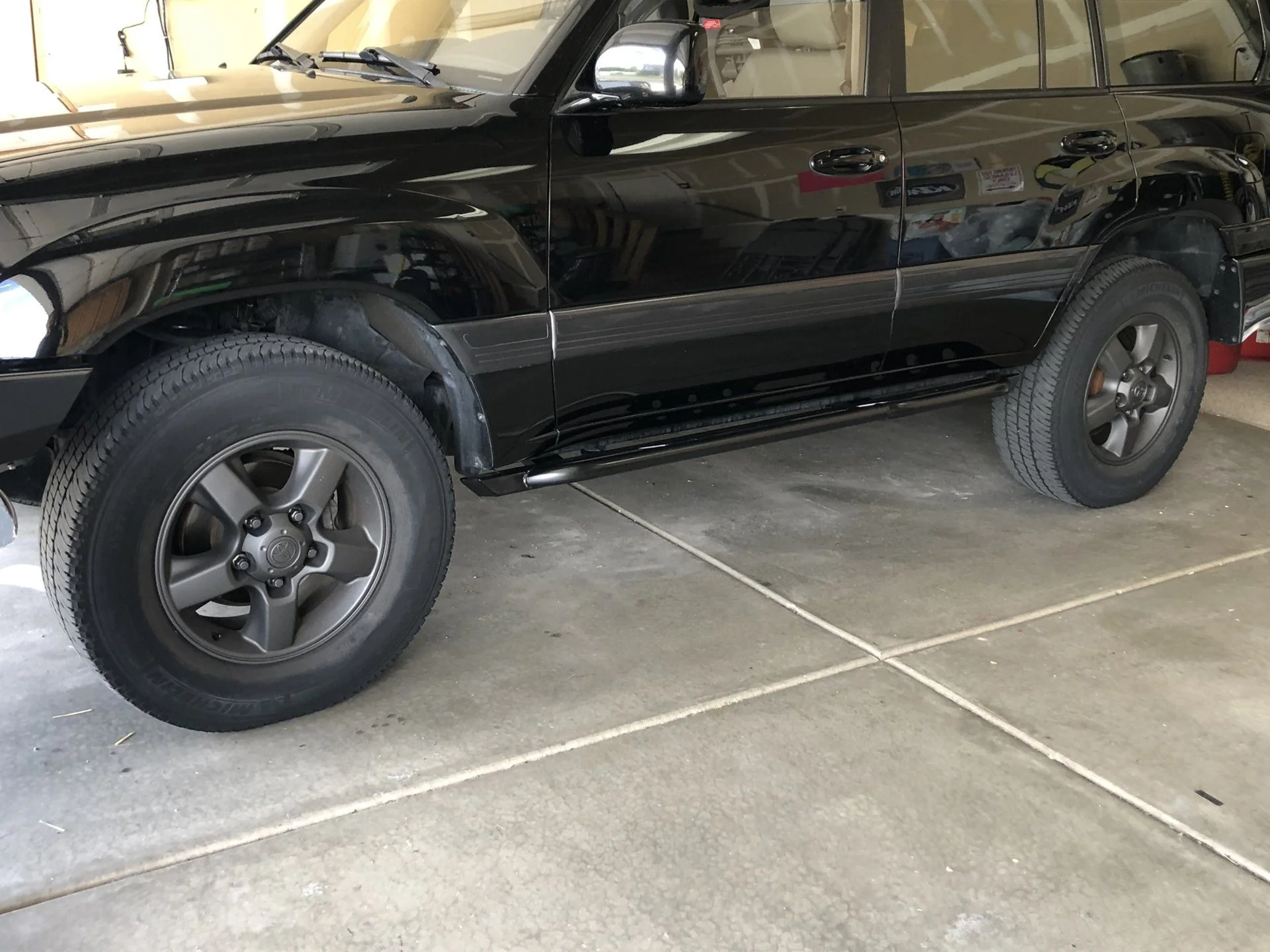

Finally got my OPOR sliders on from Metaltech!

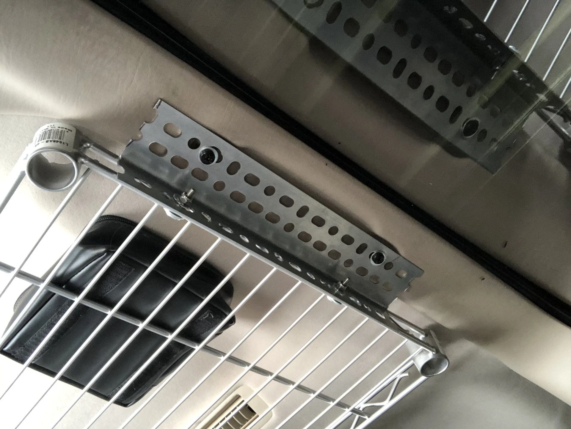

Installed an attic
