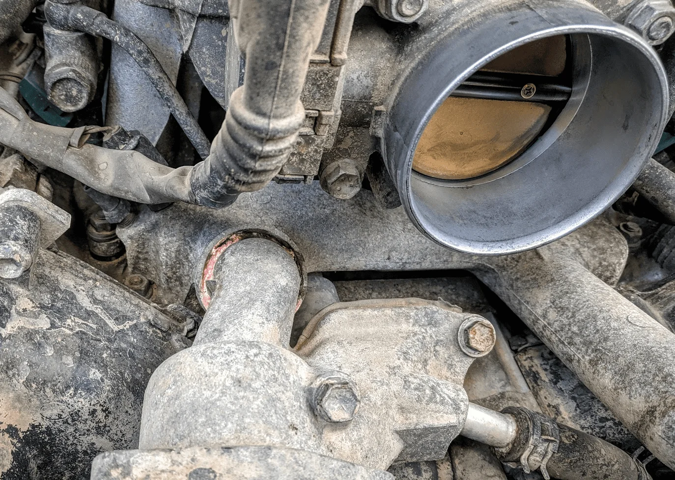

Fixed a leak at the water inlet housing from a non-FSM TB job discovered while cleaning the throttle body:

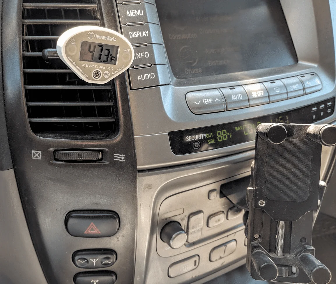

Cut and capped leaky rear AC lines in the engine bay, replaced desiccant, pulled vacuum and recharged. Blows nice and cold now:
