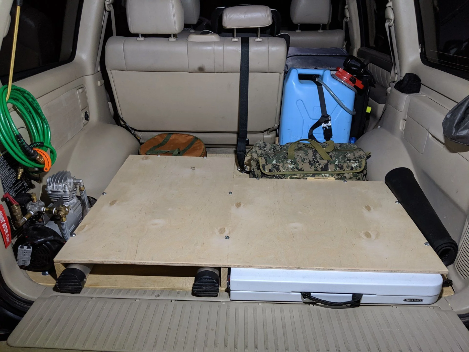

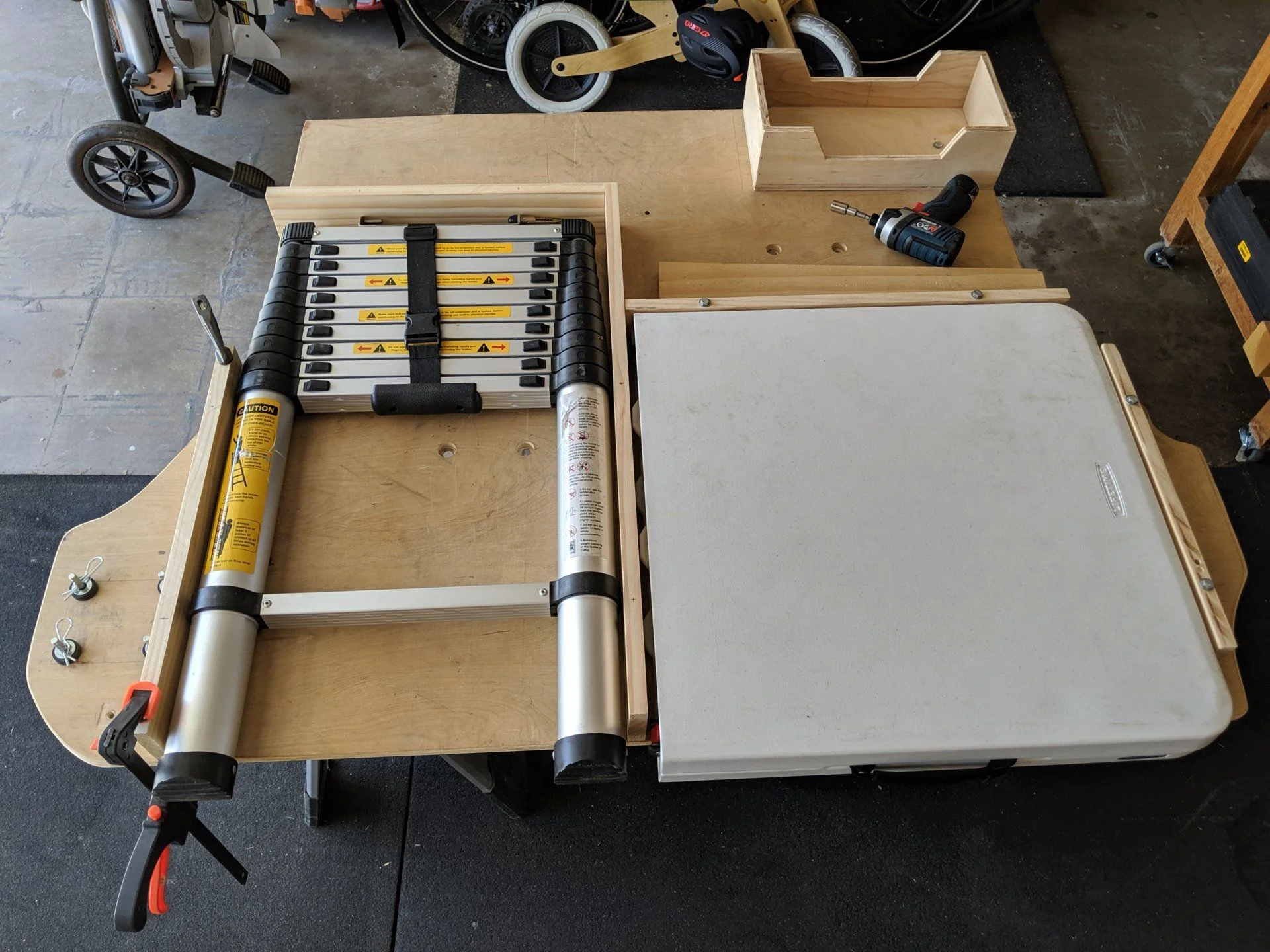

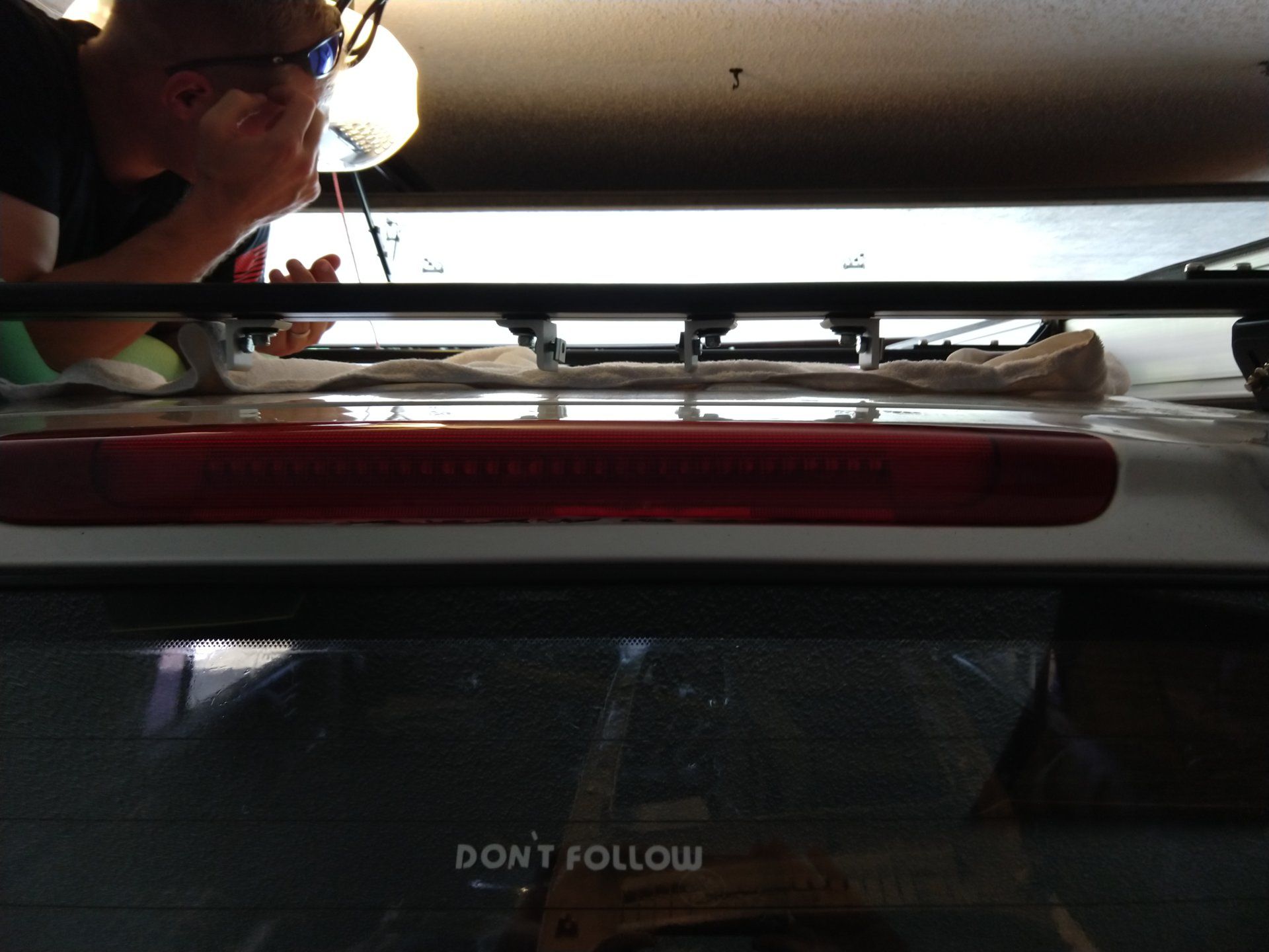

Made an addition to my storage in the cargo area. I was never really happy with storing my ladder upright next to the window. Too many straps to secure it. I really liked how I stored my table, and the ladder for my roof top tent fit perfectly in the space between my table and compressor. Now I don't need any straps. Shaved a whole 30 seconds off my deployment time.

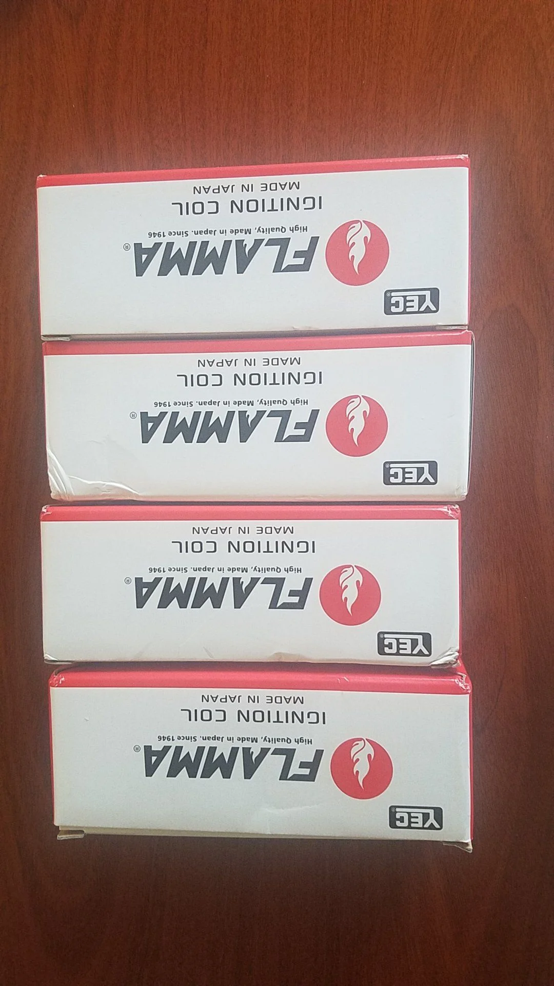

Recently my engine started running rough when cold and almost had no power up to 25 mph until warmed up. I have replaced the PCV valve and Denso spark plugs about 2 months ago so I was looking at other causes.
Last weekend I replaced the MAF sensor with a new Toyota one and that helped quite a bit but there was still a missed heartbeat here and there when cold. Once warmed up - it was silky smooth.
Today I decided to replace the coils with YEC Flamma GC107F. The old coils are definitely past their prime as they came out cracked. One surprise I wasn't happy to see was the first coil on the driver side bank was full of oil :oops:
I am not sure if that is a sign of valve cover seal failing or something more sinister. Anyway, I cleaned it up and put new coils in. I have yet to drive it to see if my engine is back to smooth running when cold.

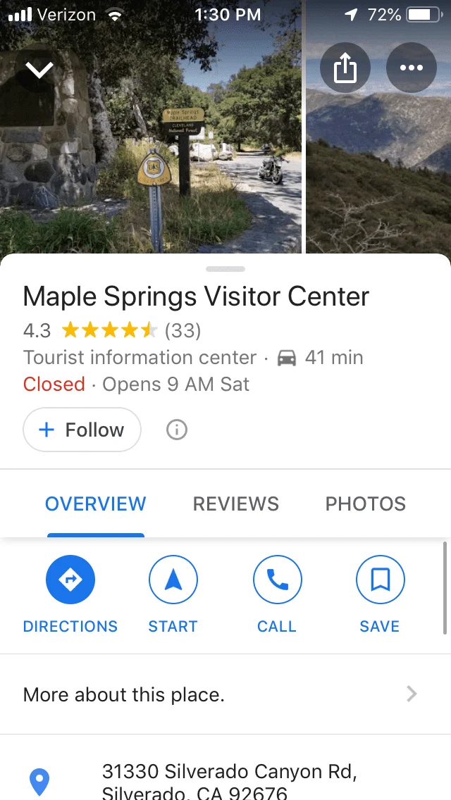

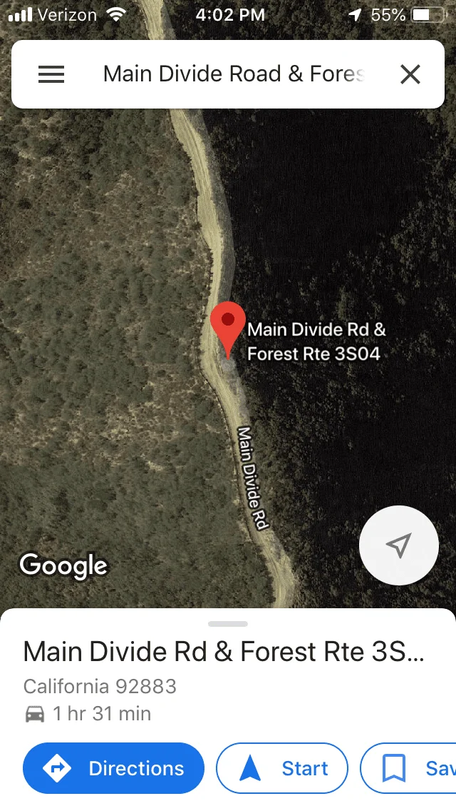

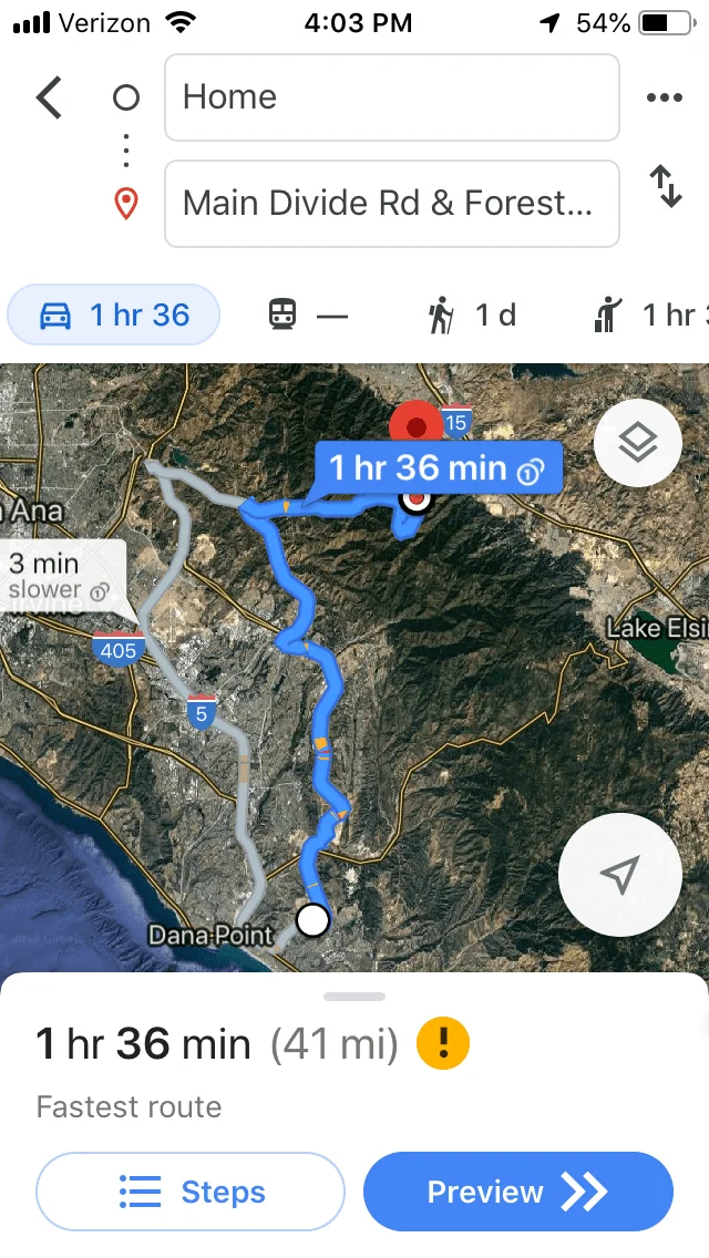

All I did was punch it into google maps and I got up there going all the way through Silverado. Was awesome. Proof below (if necessary...) And looking forward to riding up with another LC partner at some point.

I will go with you if you give me a weeks heads up. I was already planning a trip up there this weekend anyway, if you want to meet up!
Count me in too. I'm in the OC.
Well that’s great, we’re all just jealous since the gate from 4 Corners has been closed since the fires. Hope it’s all clear now and not a fluke, either way happy you made it up!
