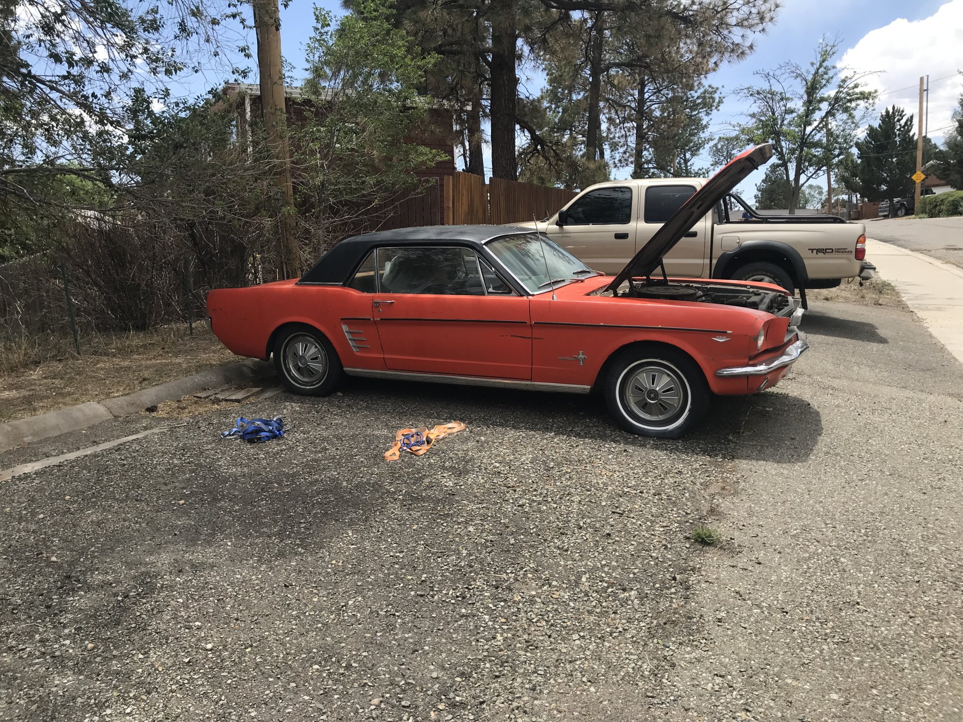

Got this orange thing running today, shot rat s*** out the exhaust and smoked like crazy but we are off to a good start.
The float was stuck and a little corroded but easy fix, even had the carb rebuild kit in the trunk for me to rob the gasket from!
Running it off a gas can currently because the tank is disgusting, not sure what the magic concoction for cleaning out bad fuel gunk is but I’m open to suggestions.
Also have to figure out why the cap on the brake master won’t come off and probably fix something in the brakes because the pedal just goes to the floor

Nice old pony. Autozone says to use a mild soap and water. Makes sense - it's not harsh on the tank and takes oil away with it. I was pleasantly surprised by this article.
Yup. Dawn dish soap and hot water. Then put a couple pounds of nuts and bolts in it and tie it to the front of a cement mixer and let it tumble for an hour or so. Yes, I have done this a few times and it works great.
