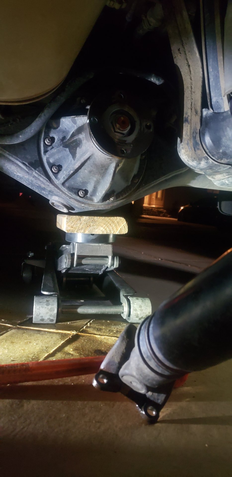

I've had the driveshaft thump/clunk for a long time. The inside of the slip yoke had grease packed in with the consistency of wet clay. I'm cleaning it out and using Motorcraft PTFE grease. It is my first time ever working on a driveshaft and I'm glad I bought the crow's foot adapters a while back.
That reminds me that I need to grease mine.
I highly recommend it. I just finished the front drive shaft last night (full time 4wd) and the difference is incredible. Acceleration is better but more importantly the braking is now smooth instead of 'chunky'. I should have done this a long time ago.
I recommend using the Ford PTFE but I think any PTFE will do the trick. Make sure you brush it all over the splines. I may or may not hit the Zirk fitting with a grease gun for maintenance. I might just do this job every so often. No idea how long it will last but I've read up to 2 years with no problems in a Tacoma.
I did it on my 100-series when I initially bought it, taking apart the entire slip yokes, cleaning and re-greasing. Then I typically do it every 1-2 years when I'm changing oil and Trans fluid (I only drive it 3-5K miles a year)
On the rear DS, it helps to remove the grease fitting and drive around for a bit to let any extra grease ooze out of the splines. Hitting some speed bumps at speed will help. This assures no hydro locking issue occurs if by chance extra grease was trying to find its way out of the splines. The front DS doesn't move up/down so not a huge deal if you don't do this.
Good info Aaron, thanks amigo!!!
