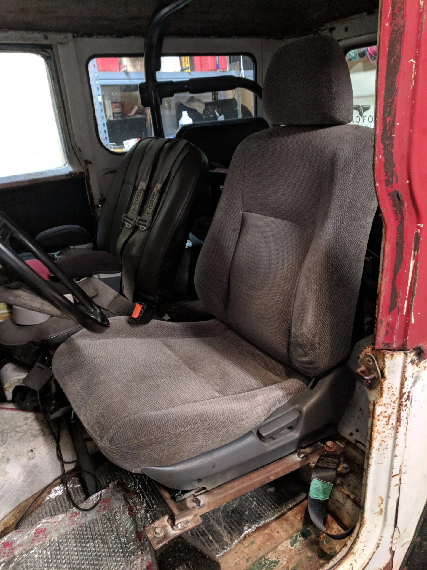

After suffering in my 40 all day last week. And, then sitting in Joel's 40 and seeing how much more comfortable it was I finally got around to installing a new drivers seat in mine. Man, what difference!
Much better Kev, I think I felt my ass touch the tub a couple times at the dirt devil!
