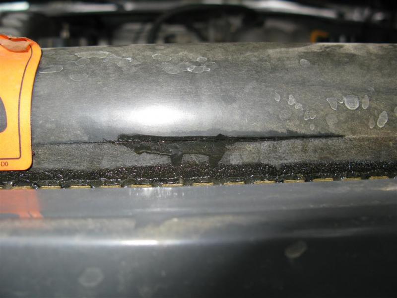

out with the new, in with the old.
93 3row brass core radiator replacement for 95 2 row aluminum.
Random 16 yr old plastic failure on top tank. And im very aware to stay away from the tank when wrenching. I think its time had simply come to give up. Thankfully it didnt happen in the middle of the night returning from $out's. but the next morning a mile from the house.

I know that crack very well. My JB Weld fix last about 2 weeks after mine split. Those radiators are not cheap.
I know that Brian at ACC just installed a new one on his 80 to replace the broken plastic. Not sure if it was a custom deal or something off the shelf.
Yeah, not cheap. And I didnt bother with the JB after seeing some top tank failures take out a hood and fan on mud.
RHT hooked me up but I couldnt get ahold of Rick so the process wasnt as smooth and I didnt get the same price on the radiator as Dan. Not sure if it was a regional price difference or clerical snafu. Its almost like they charged me for the 95-97 unit which cost more and doesnt work as well supposedly. I was in NEED so I didnt bother to question it at the time.
they say the 3 row brass cools better than the 2 row aluminum .......and I listened :)
never had temp problems and religiously stayed away from the tank and nipple when wrenching but it cracked anyways. Hwy temps were dead on 186 just as before.
