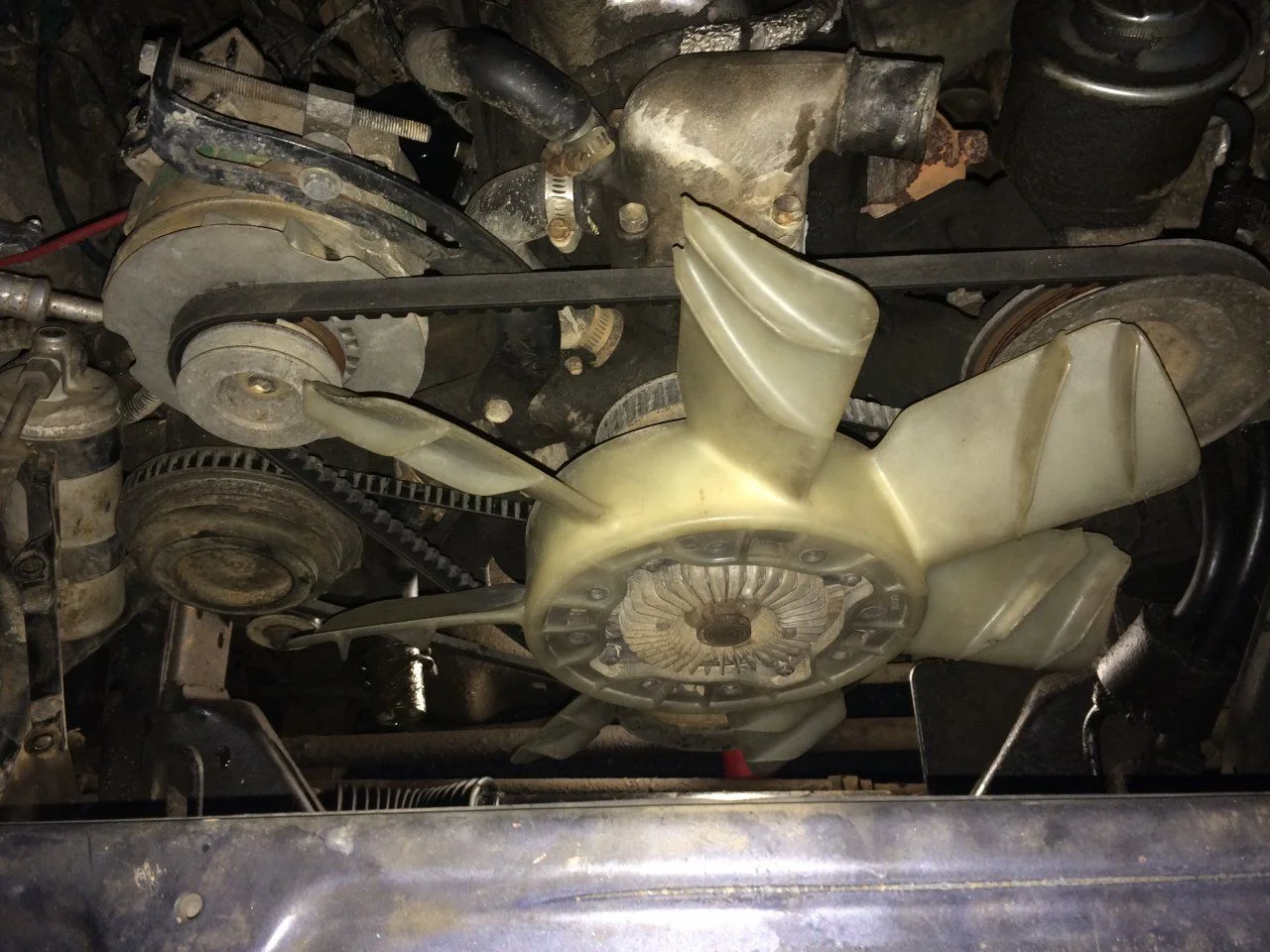

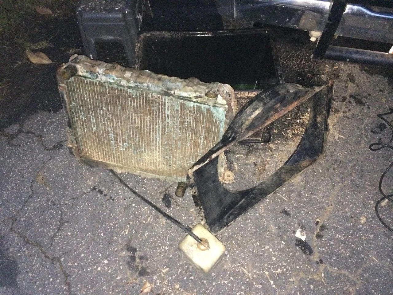

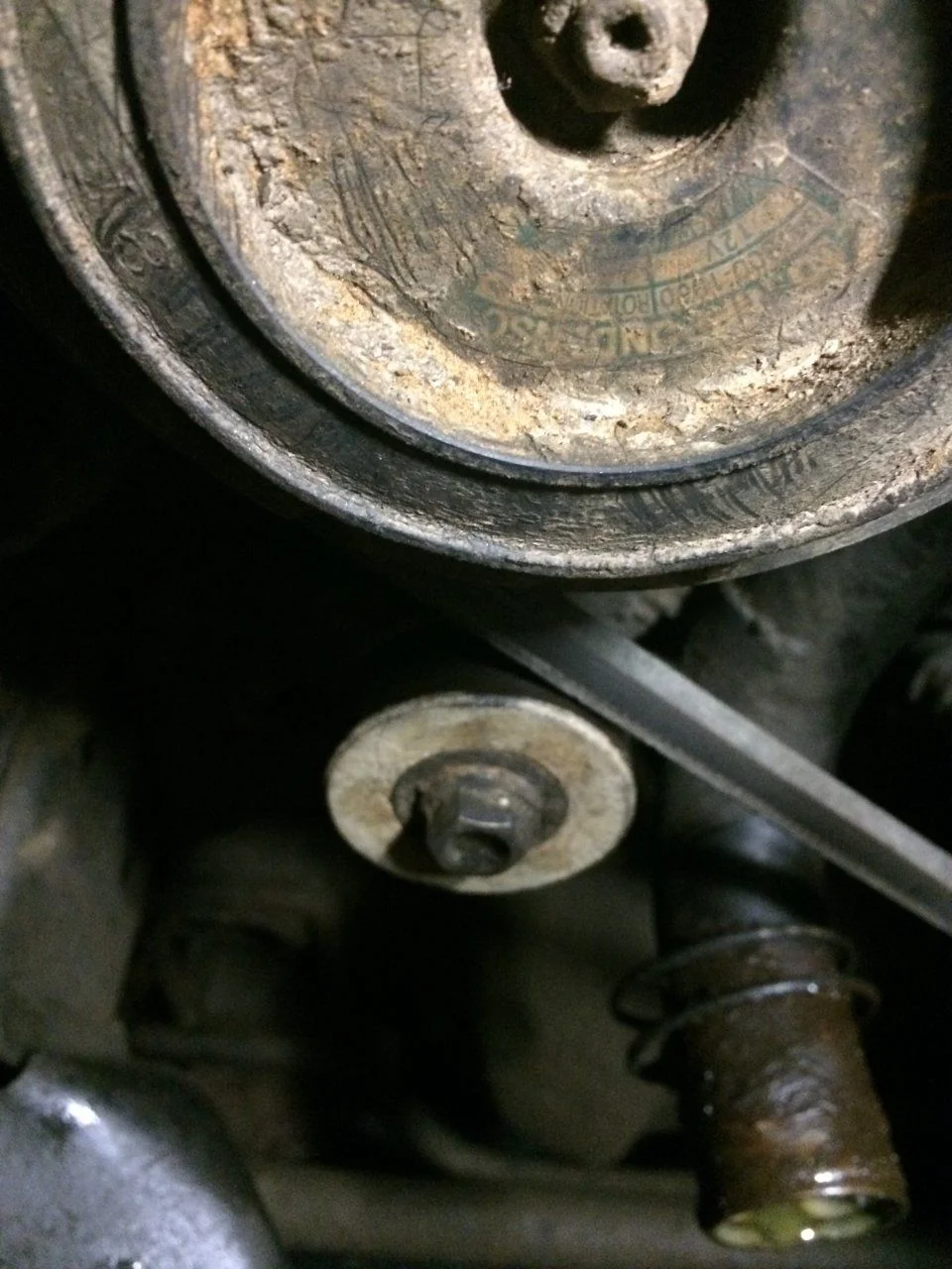

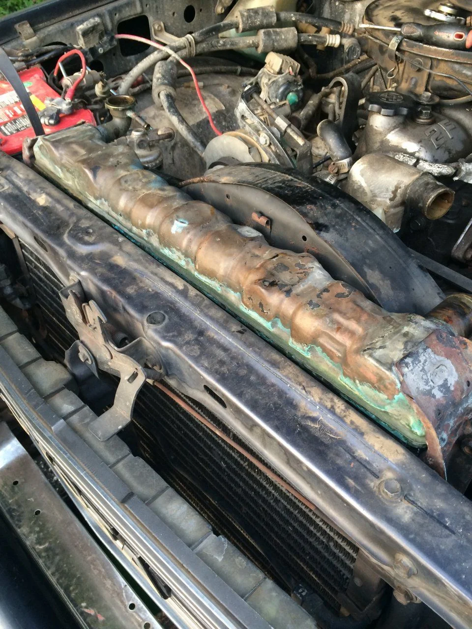

Well after a few years of tolerating a leaking radiator, that was "repaired" I decided to pull it and put in a good one. But once I had it pulled out I decided that since I was in there it was all gonna be new. So I'm picking up new hoses in the morning from Ralph Hayes and the new water pump and gasket will be here Tuesday and Wednesday from amazon!
Gonna also replace the idler bearing, makes a hell of a racket
She was covered in grime, so after this pic I hit it with the power washer before I tore it down

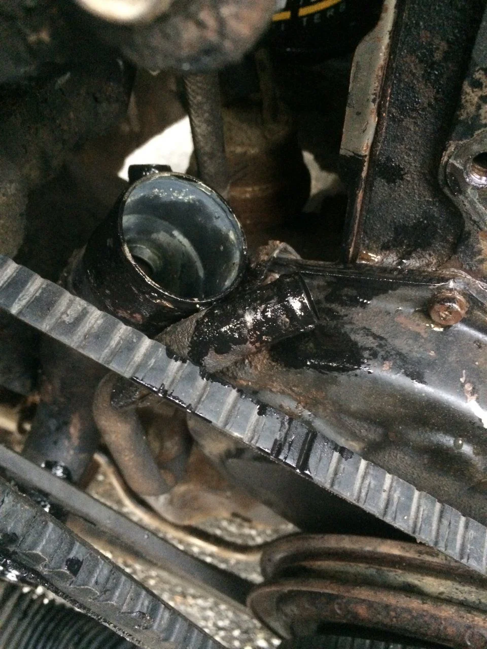

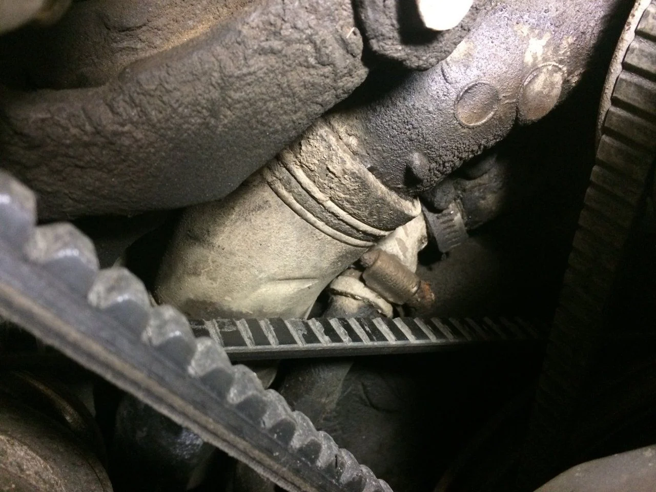

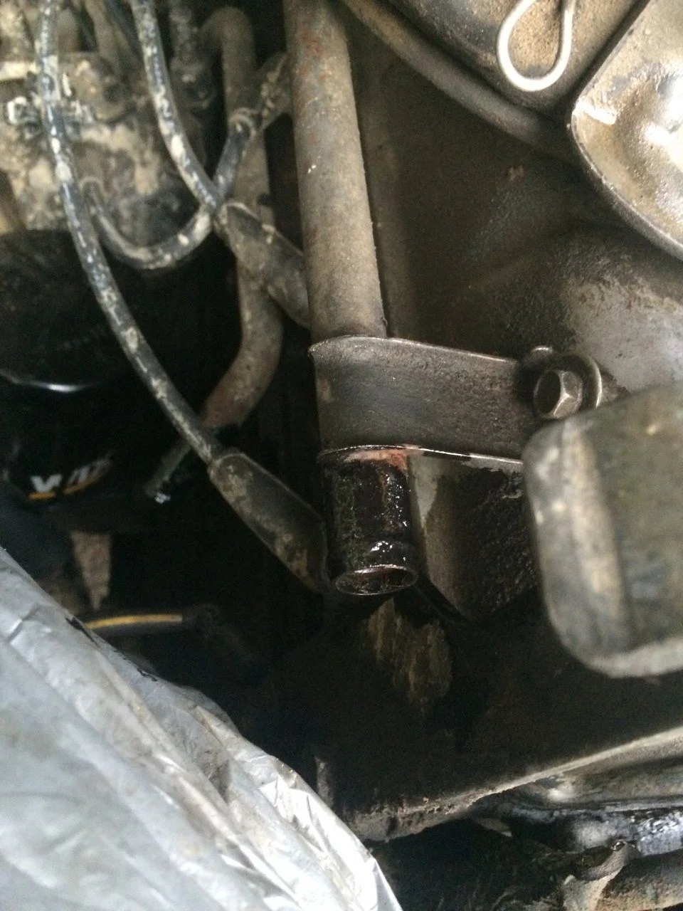

The ends of the pipes were in decent shape but I coated them in some POR 15 for some added protection

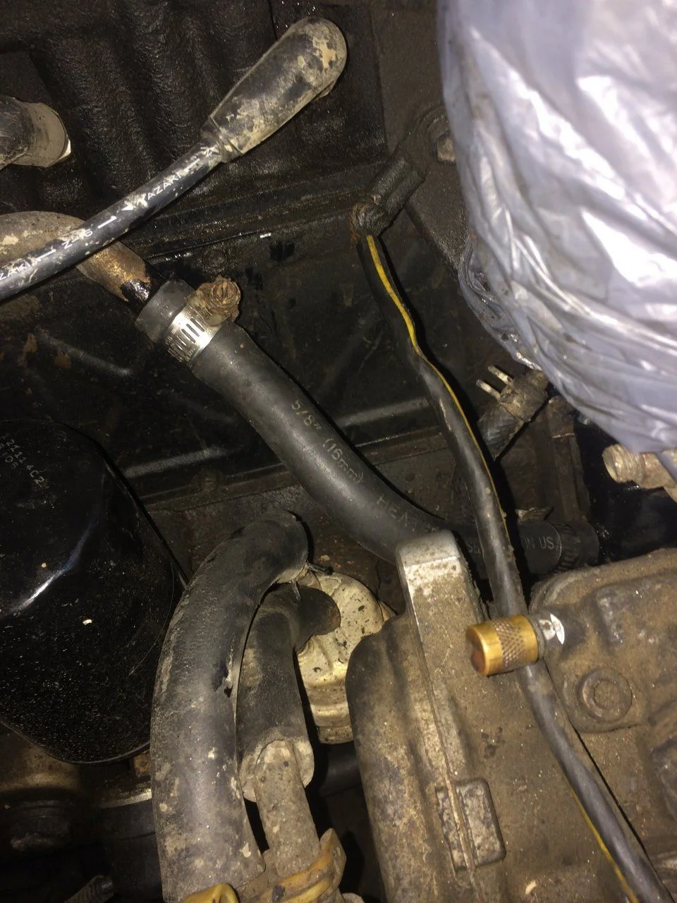

Wasn't going to replace the oil cooler hoses, other than the one out of the water pump. But as I was working I said what the hell and put in new ones....gotta order one for the top, thought heater hose would work but it kinks too much.

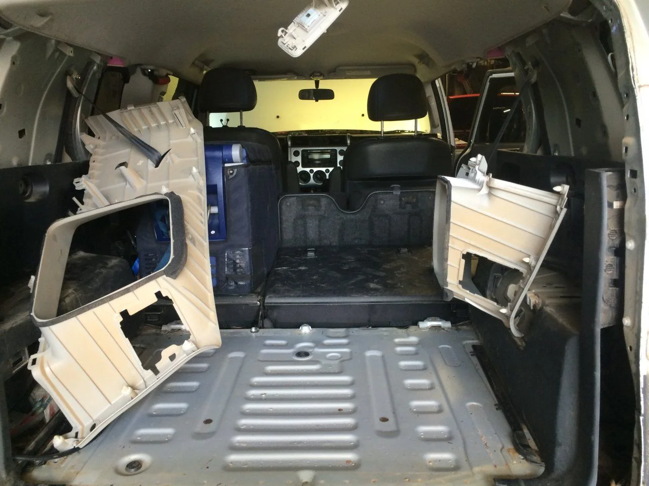

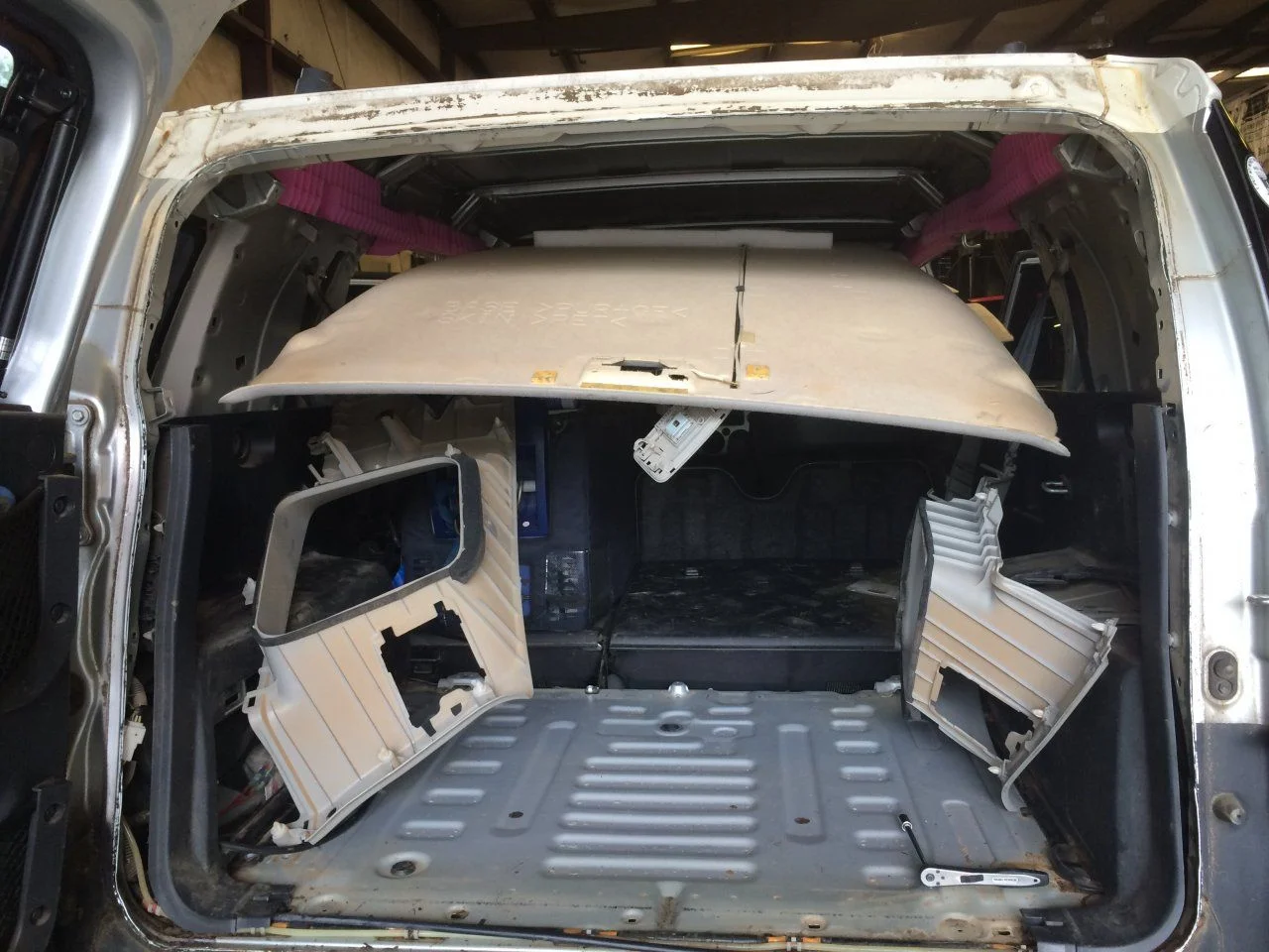

Found a used OEM roof rack that ACC had removed from another FJC and replaced my broken one. The downsided was that one of the corners on the roof got pushed in and one of the nutsert clips that the rack bolts to through the roof skin had come loose.
This meant I had to drop the headliner to retrieve the clip and push the dented roof back out. You have to pull almost every interior plastic panel to drop the headliner, which meant emptying out the back of my cargo area (too much junk in the trunk) all the way to the sheet metal floor pan. Spent a solid 6.5 hours doing all this. Ughhhh.

Hot Damn Rick.... thats a lotta work for one bolt. I think I would have put my faith in the other 11 to get the job done :grinpimp:
And leave a 8mm hole in the roof exposed to rain?!
Also, two bolts go into the same nutsert bracket which is held onto the subframe by a retainer clip. It was actually this retainer that had come loose and therefore the nutsert bracket was just spinning. Weirdly designed system....I should have just tack welded all these in place once I had the bolts started at each cleat.
