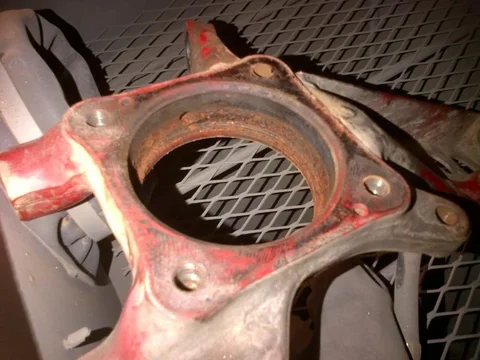

IFS spindle rebuild...I seem to be eating unit bearings faster than normal. I think I know why now. The seal inside the spindle that faces the CV axle was toast, as well as the mating seal on the end of the CV. Probably killed my wheel sensor too (VSC/TRAC lights on). Had no luck tracking down replacement seal for the spindle from a local source. Eventually had to order from Lowe, but reused my old seal in order to get it back on the road. Just smeared a tub-full of grease between the two seals for now. Got the new bearing in and cleaned up the spindle and rotor dust shield.

The unit bearing cracked as I was pressing it off the hub flange.

I think I am going to do this rebuild as well Rick. Would be interested in your tips. I like rebuilding the bearings at 100-150k so I am due.
I posted a similar thread with a few more details in the FJC forum. If you are running stock UCA, then separating the ball joint might be avoided. I took my spindle completely off because separating the UCA is relatively easy with my TC uniball uppers. If you remove the two 19mm bolts from the LCA (and the tie rod outer) then you could just rotate the spindle around on the truck and still access the seal. I removed/replaced the CV seal while the axle assembly was still on the truck. If your spindle is gunked up and needs more attention - like in the blast cabinet, then you'll need to break the upper ball joint to remove it completely.
Unit bearings aren't generally considered serviceable. They can be separated and repacked but it usually isn't worth the time.
If they do need to be replaced it is far easier to buy the entire hub and bearing assembly.
We're not really talking about servicing the bearing itself. There is a seal tapped into the inner face of the spindle arm that I don't think I've ever replaced. The CV axle assemblies come with the interfacing seal already mounted and tend to be banged up from shipping. I had an extra one of the CV seals, but I didn't have the spindle seal readily on hand. I think the lesson learned is to replace the inner seal on the spindle as well as the outer seal on the CV assembly, if you are going to the trouble of replacing the unit bearing too.
