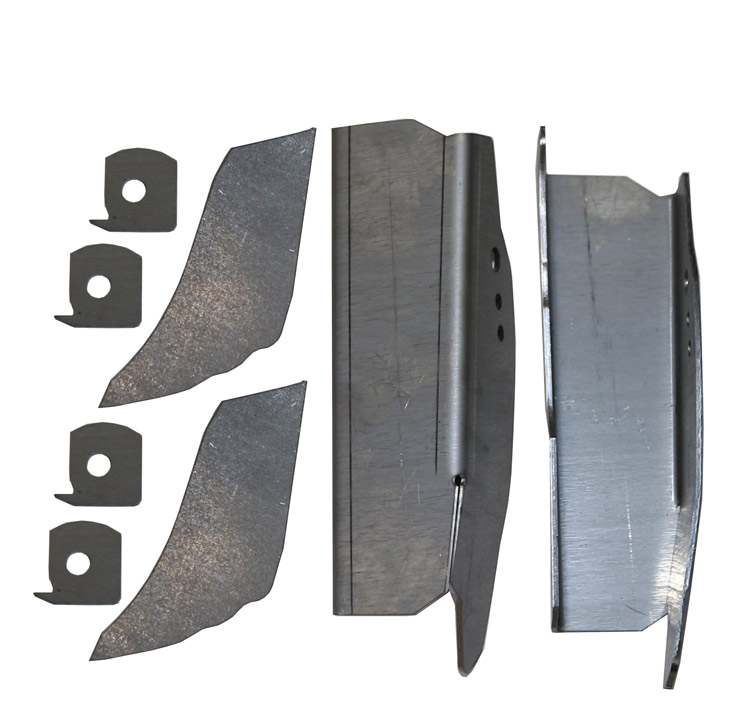

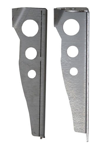

Is that the metal tech gusset?
Total Chaos (version 1.0) The new version allows you to keep the front sway bar attached.
1.0 $43
2.0 $60
