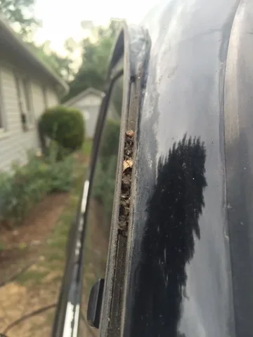

What's the advantage of removing the rain gutter trim?
For me it was 2 fold:
1. As Landcruiser80 said, "It looks better." Especially since mine was chipped and dented.
2. They trap dirt and gunk that you won't see or be able to remove until you take them off.
Witness the trap that is rain gutter trim!
