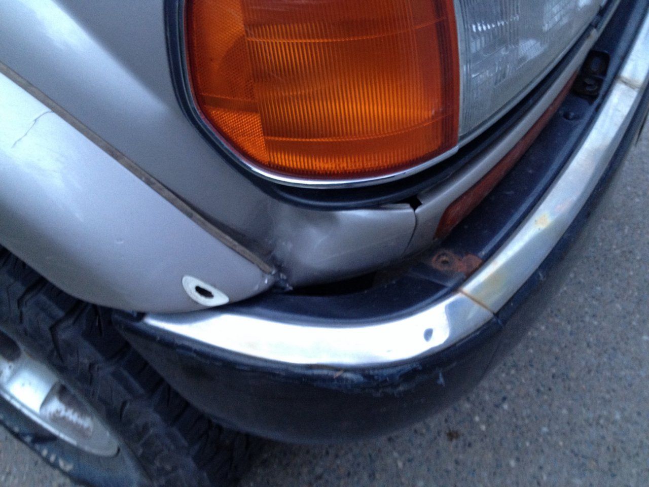

Slow motion impact with a fallen tree. Looking the other side trying not to roll off the hill. (Hole from damage multiplier installed by past owner). Time to start working on the bumper build and some metalwork.

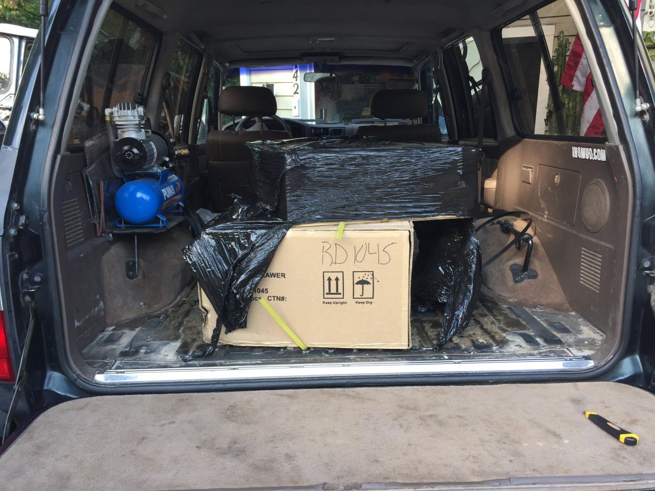

Installed some outback drawers.
Man the quality sure has gone down. I would have expected far better. That's not even from the dent and scratch pile.
Maybe replace the black plastic wrap with carpet? Can the cardboard at least be stained?
lol you guys are awesome! Yes, they look better than that, i'll take a pic.
However, i will say that i was a little pissed at them... i mean, when you spend over $1000 to get drawers for your truck and they come, then you have to practically completely disassemble them and then measure to find out that you have to drill holes in them to fit one of the most popular 4x4 trucks in the world... i mean come on!
