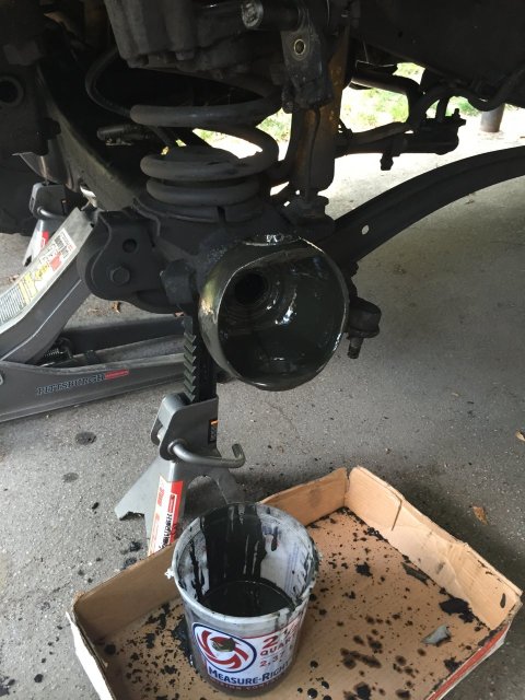

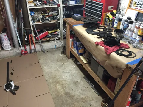

Started knuckle rebuild and pulled the bumper to start mocking up bumper build.
Needless to say it as in desperate need of a rebuild.
Got all the parts laid out and cleaned this weekend. Unfortunately found out that there has been some play in the wheel bearings and need a new spindle.
Packed wheel bearings in front axle and finished the cut out on my stock bumper for my winch fairlead.testing all the work out this upcoming weekend at Durhamtown Tellico aug. 8th20150802_180146.webp
