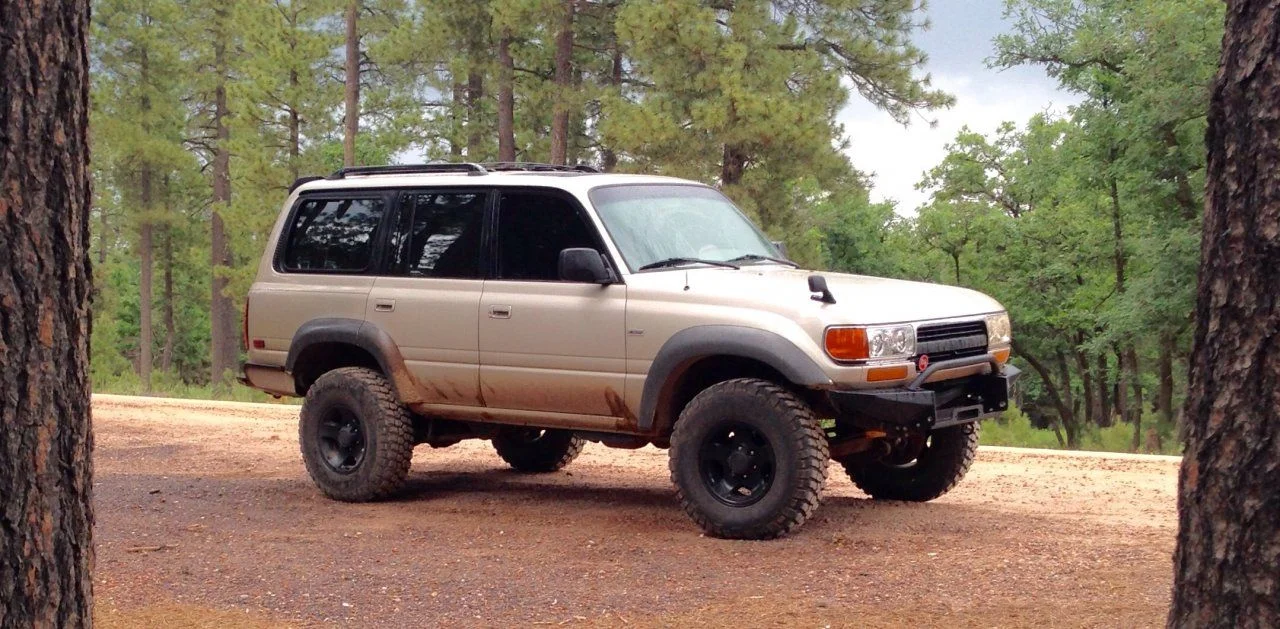

TJM 50mm progressive coils, FOX 2.0 1-2.5" lift shocks, TJM rubber caster bushings, OME stabilizer, SGI-5 to correct my speedo
Total lift was about 3" all around. Hoping it'll settle some.. I wanted to stay around 2".
