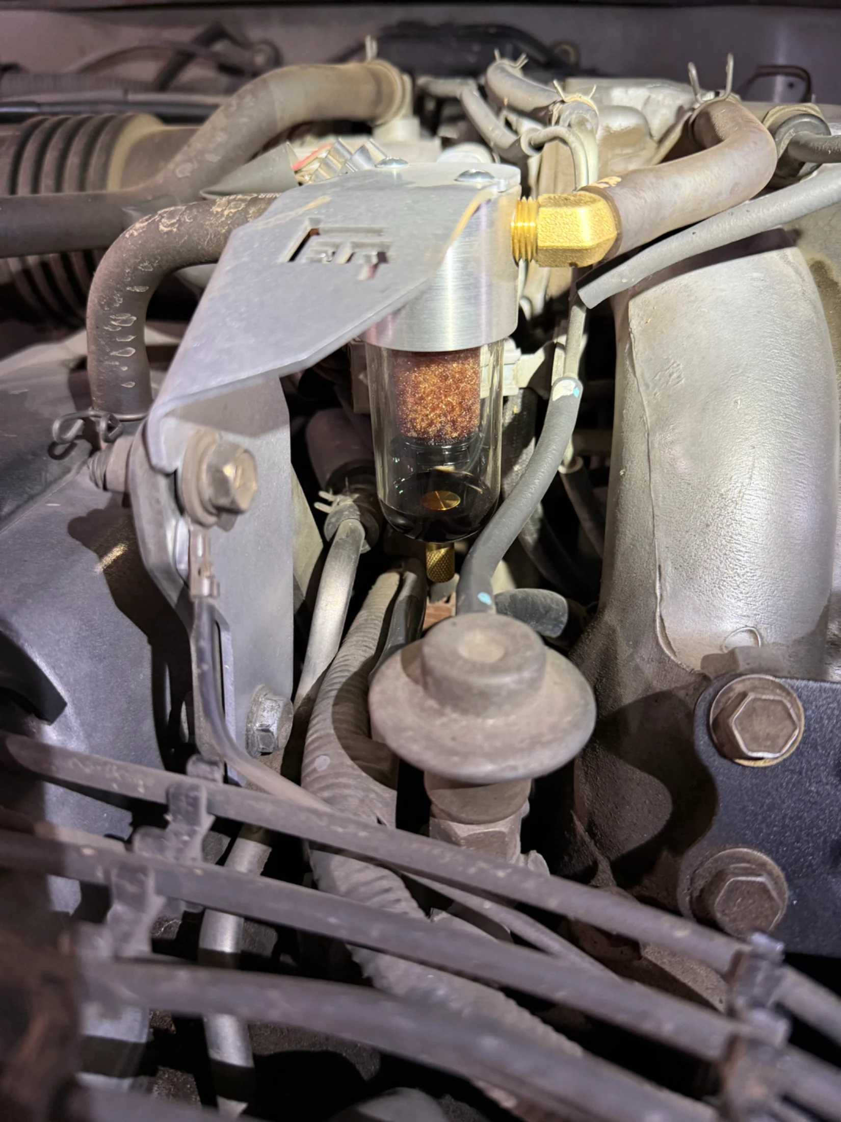

To new for me to say but in the thread dedicated to the catch can it’s estimated around 5k +/- miles or every oil change.
This is mine added 3,419 miles ago during last batch sale. Rig at 287k now.
I have no experience with catch cans, but interesting enough, what is there in that bowl all was collected in the first 300-500 miles after install and seemingly not much or nothing more since.

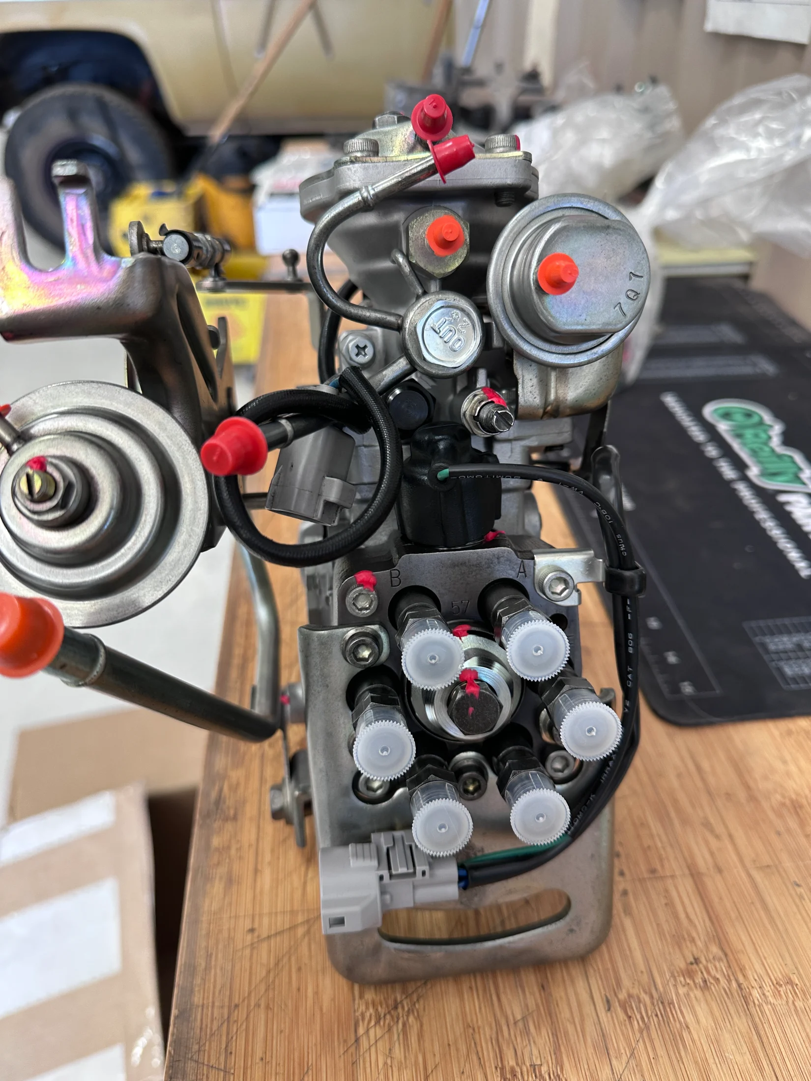

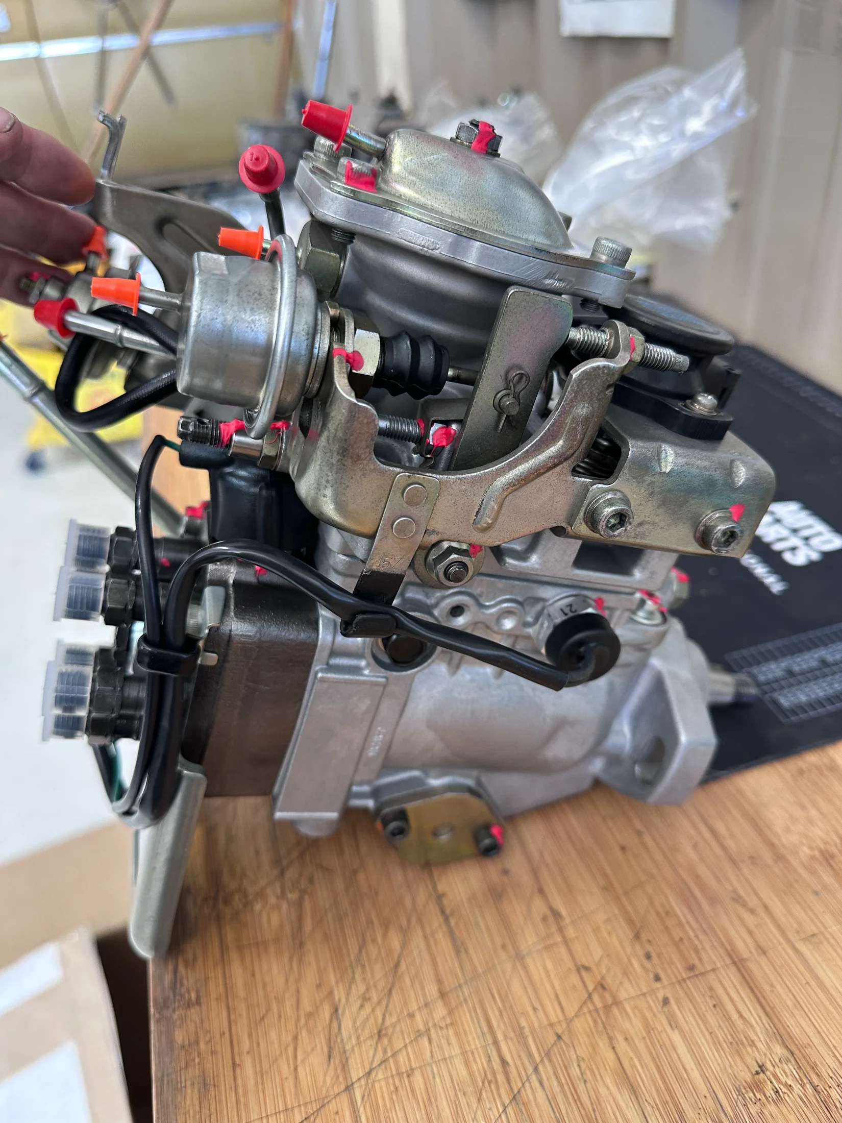

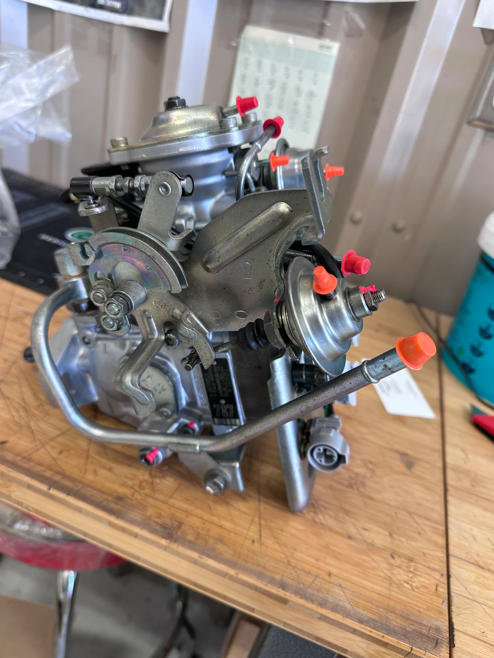

@OGBeno Looks mint. Do you do FTE pumps also?
This was rebuilt by Diesel Fuel Injection Service in PDX. Some of the best in the biz.
Your -FTE is nothing different than an -FT pump. All Denso rotary pumps are modular units. (From the POV of pump rebuilders).
Give them a shout. Won’t be cheap. Will in fact be very expensive.
@OGBeno
Appreciate the info. I hope not to need one for mine, but if I do in the future, it's good to know who's reputable.

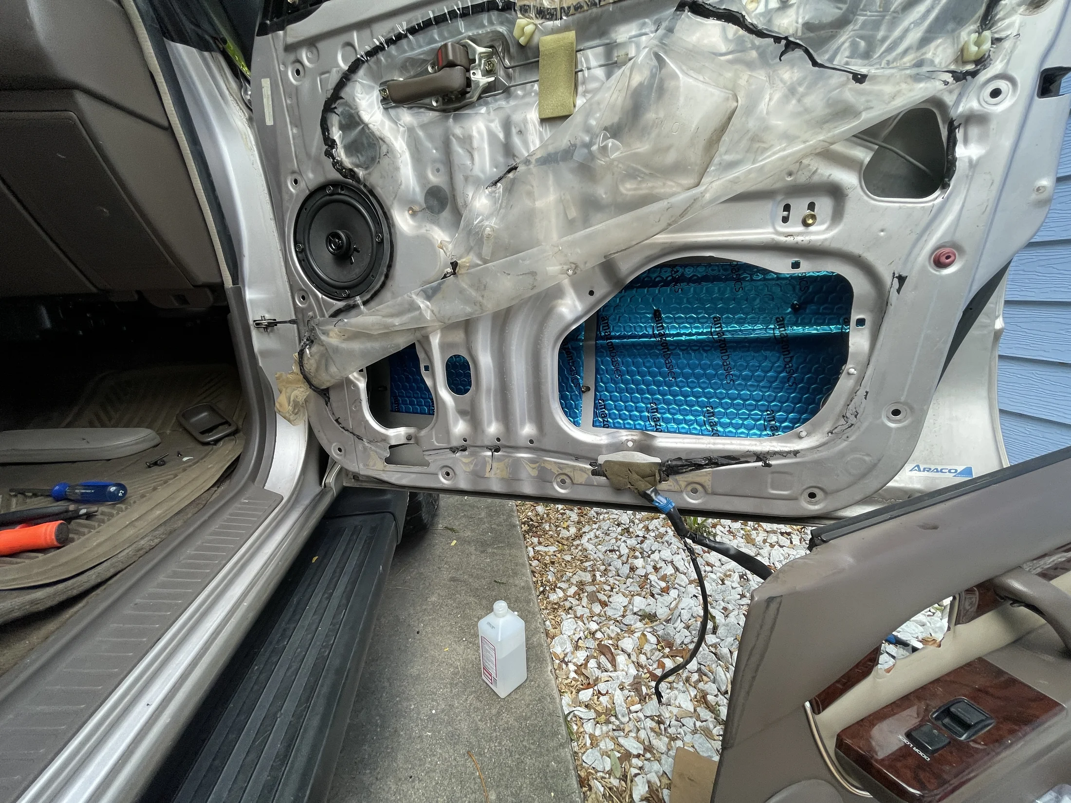

Afterwards, I spent some time reading about sound dampening (LOTS of solid info here on MUD about this), ordered a 10 piece pack of 14.5”x10” material from Amazon ($20) and did the front doors. My understanding is that majority of effect is achieved by covering 25% of the portion of bare sheet metal to reduce its ability to act like a drum.
Dampening mat: Amazon Basics 14.5” x 10” (145 sq.in. per pad)
Front door requires:
1,120 sq in (280 sq.in = 25%)
Placed 1.lbs 11.2oz (2 full pieces in bottom, 1 half -long way- in center-ish of top / 362.5 sq.in. / 32.4%)
First impressions: It’s not night & day difference, more like pulling a ski mask or winter hat over your ears; you can still hear but the sound is a bit lower, softer. Added bonus is the feeling when shutting the doors; it feels more crisp... a tactile improvement. Then I moved onto the rear doors...

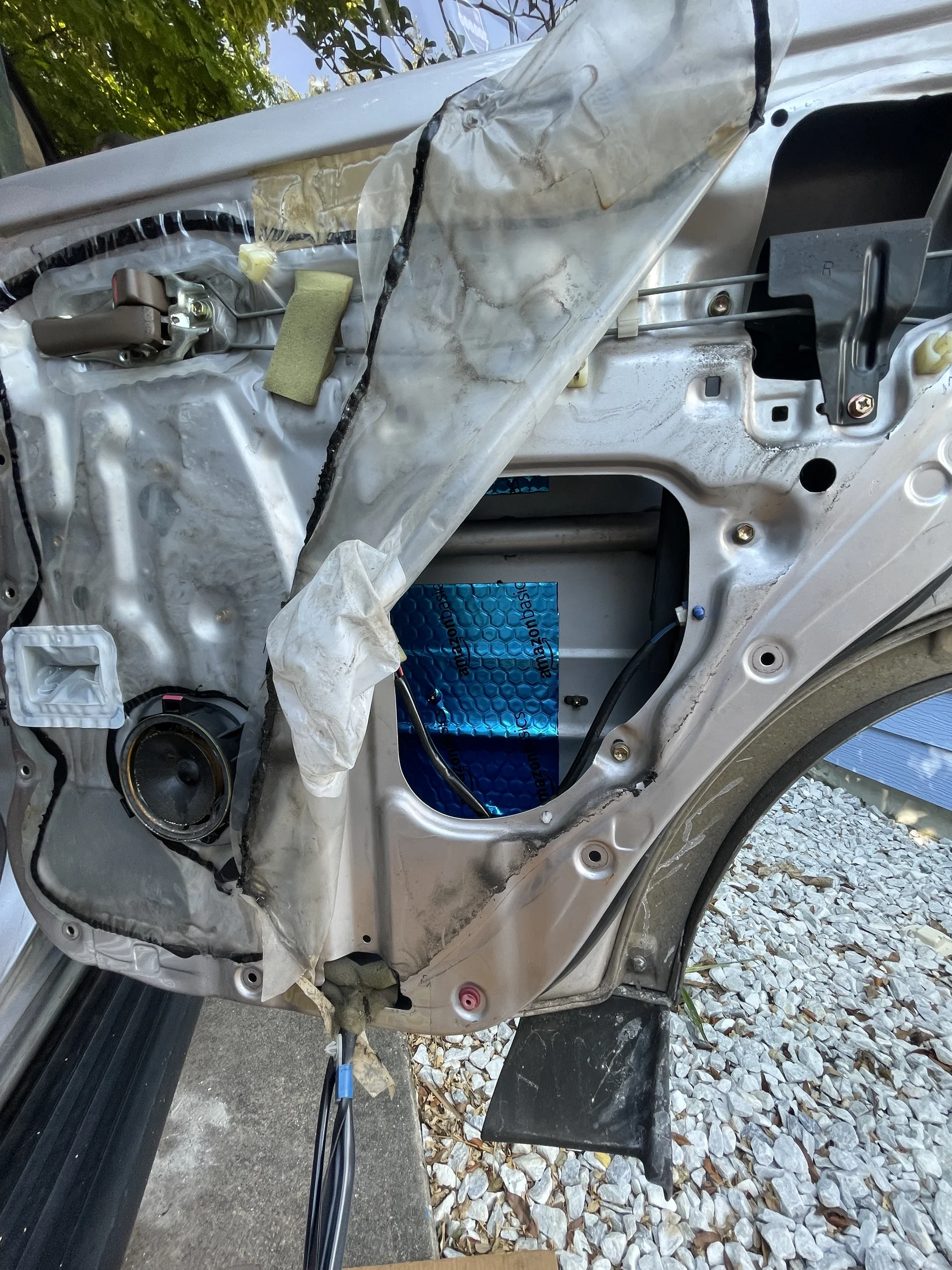

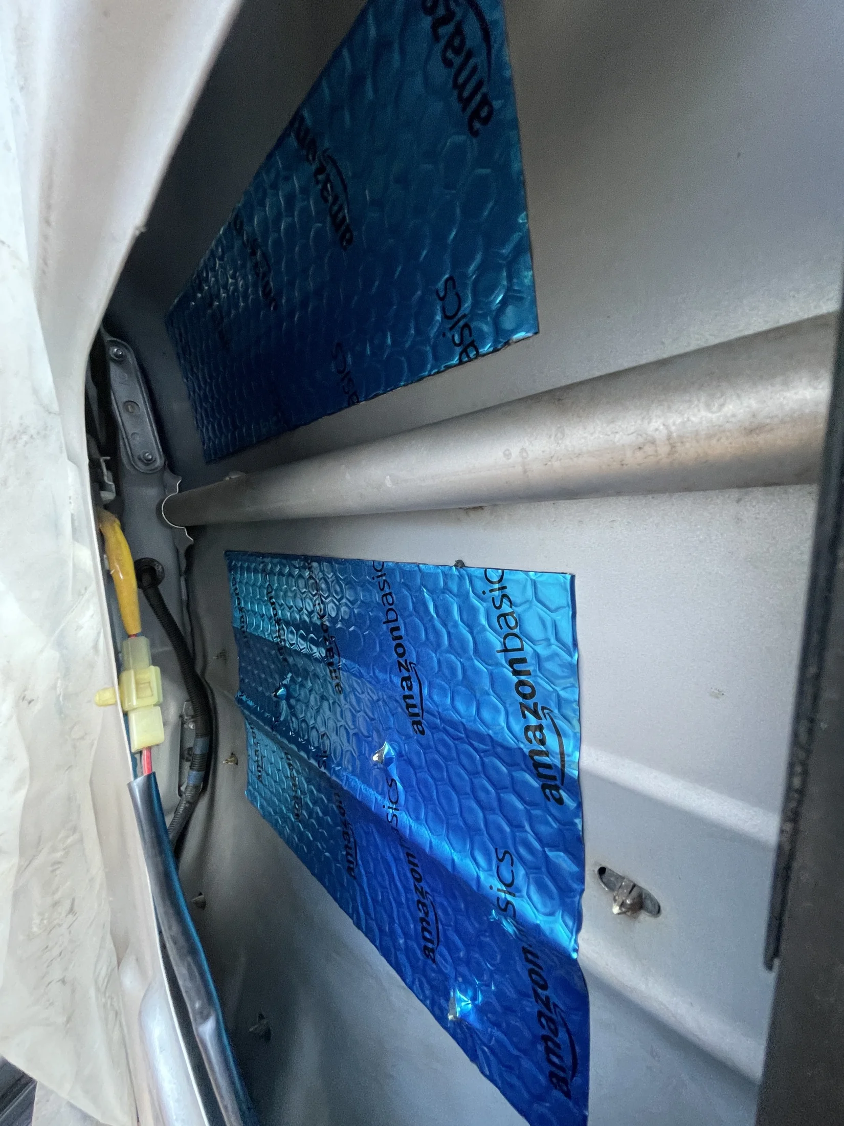

Rear door requires:
728 sq in (182 sq.in. = 25%)
Placed (1 full pieces in bottom, 1 half -long way- in center-ish of top / 217.5 sq.in. / 29.9%)
After a bit of driving, here is my takeaway: Doing the fronts was more noticeable but I suspect the rears add reduction in cabin noise overall (captain obvious statement, I know). The quieter cabin is noticeable at both low speeds and highway driving; feels more like a modern car inside. Very worthwhile addition for just $20 and some installation time. Music/car audio also sounds better, despite the lousy speakers.

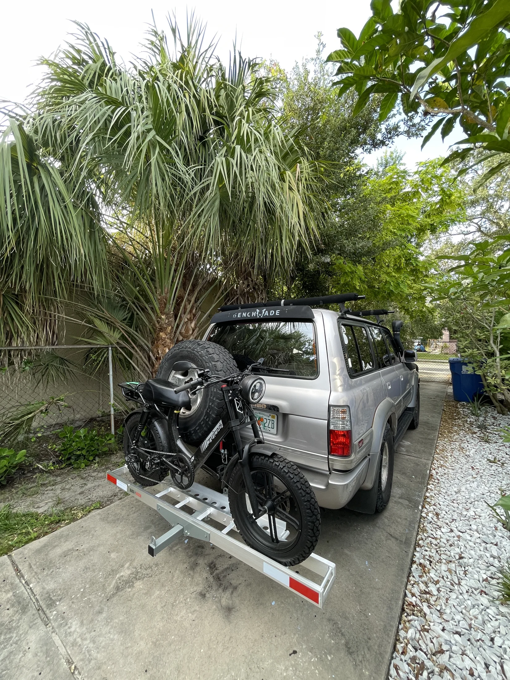

Lastly, test fitted the Newley received bike rack:

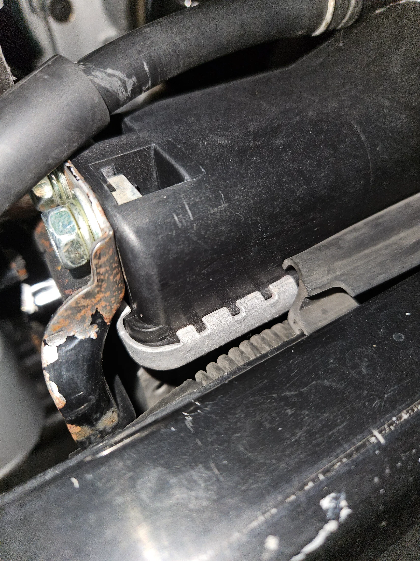

I changed my oil and washed the engine bay last night. There was coolant in these "teeth" on both ends of this recently replaced (by the PO) factory rad. There was no evidence of it traveling from somewhere else, and both hoses and clamps at the other end are new. Is this radiator failing?

Most likely:confused:

If it was recently replaced than it is likely good to go. Clean off the coolant and see if it returns. If If returns pressure test the cooling system to find the leak.

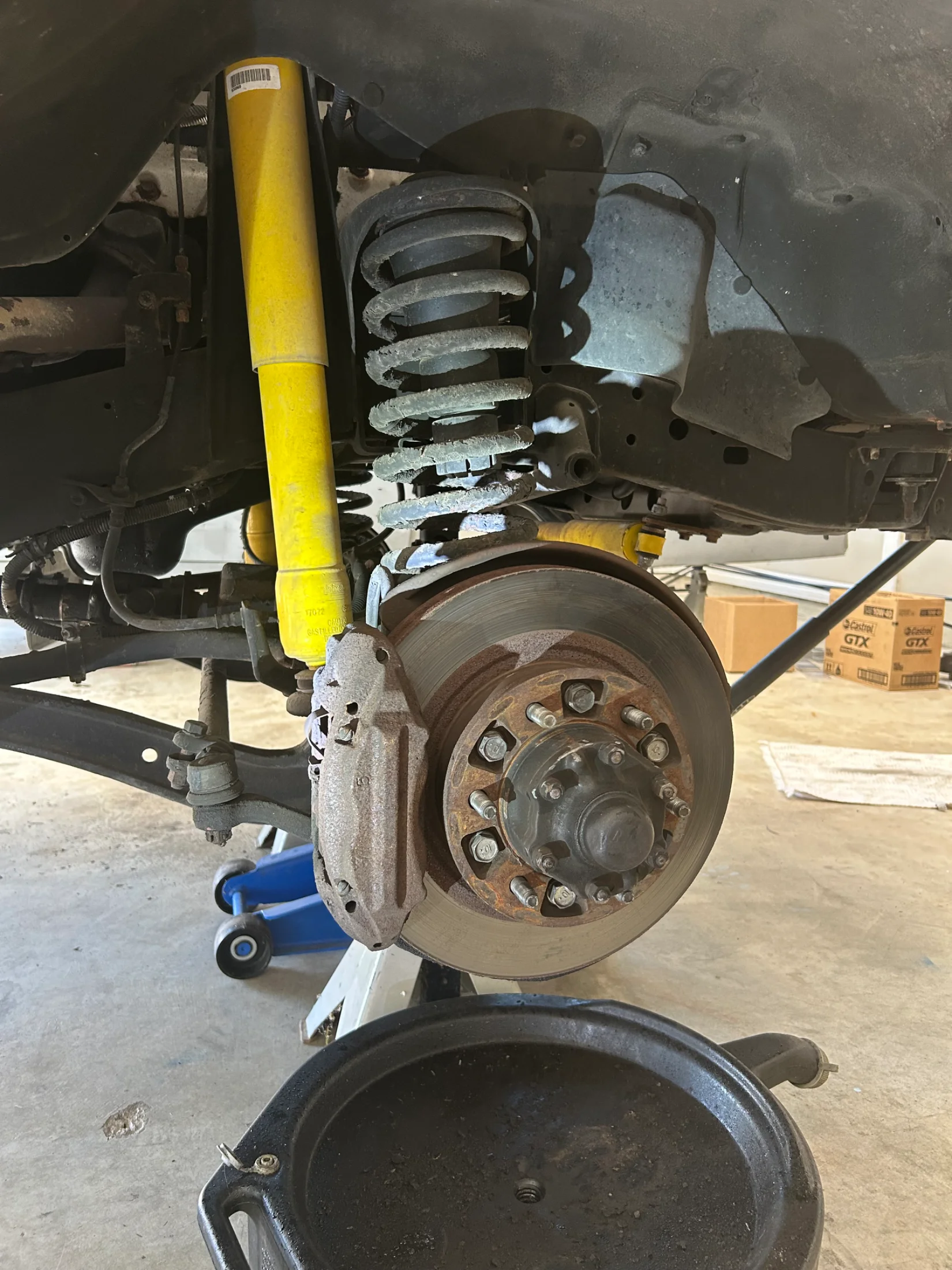

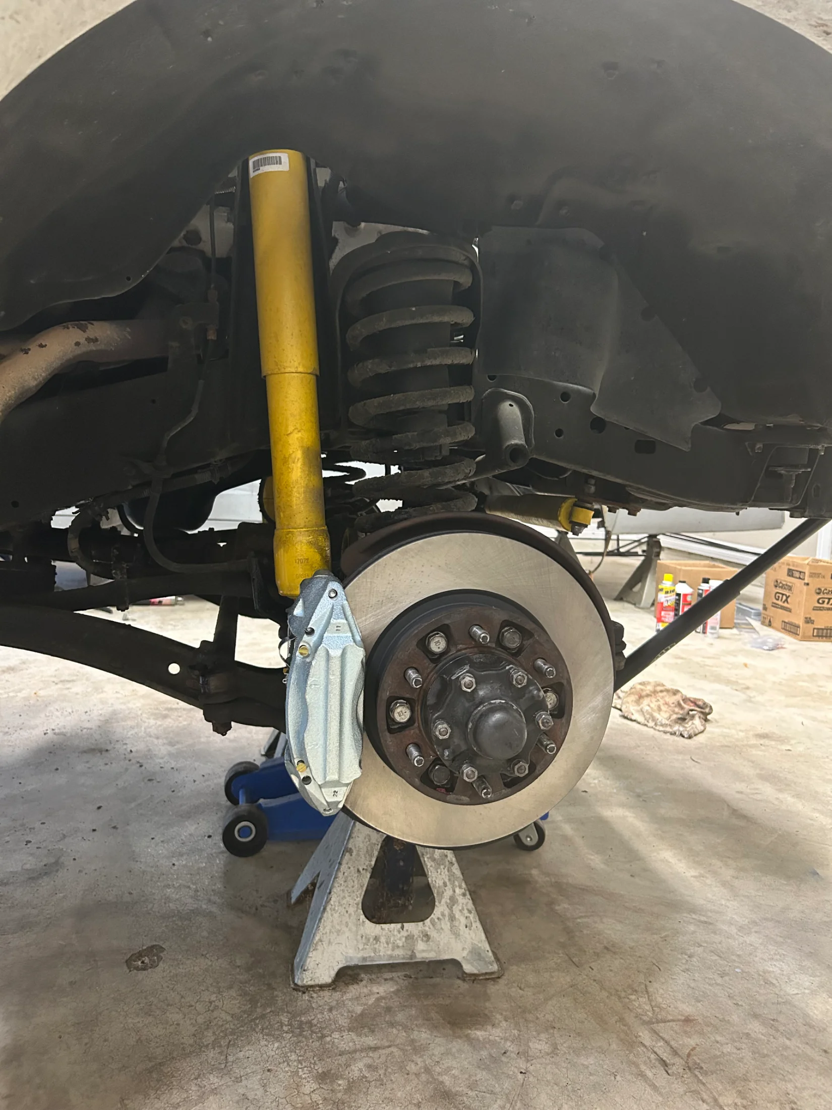

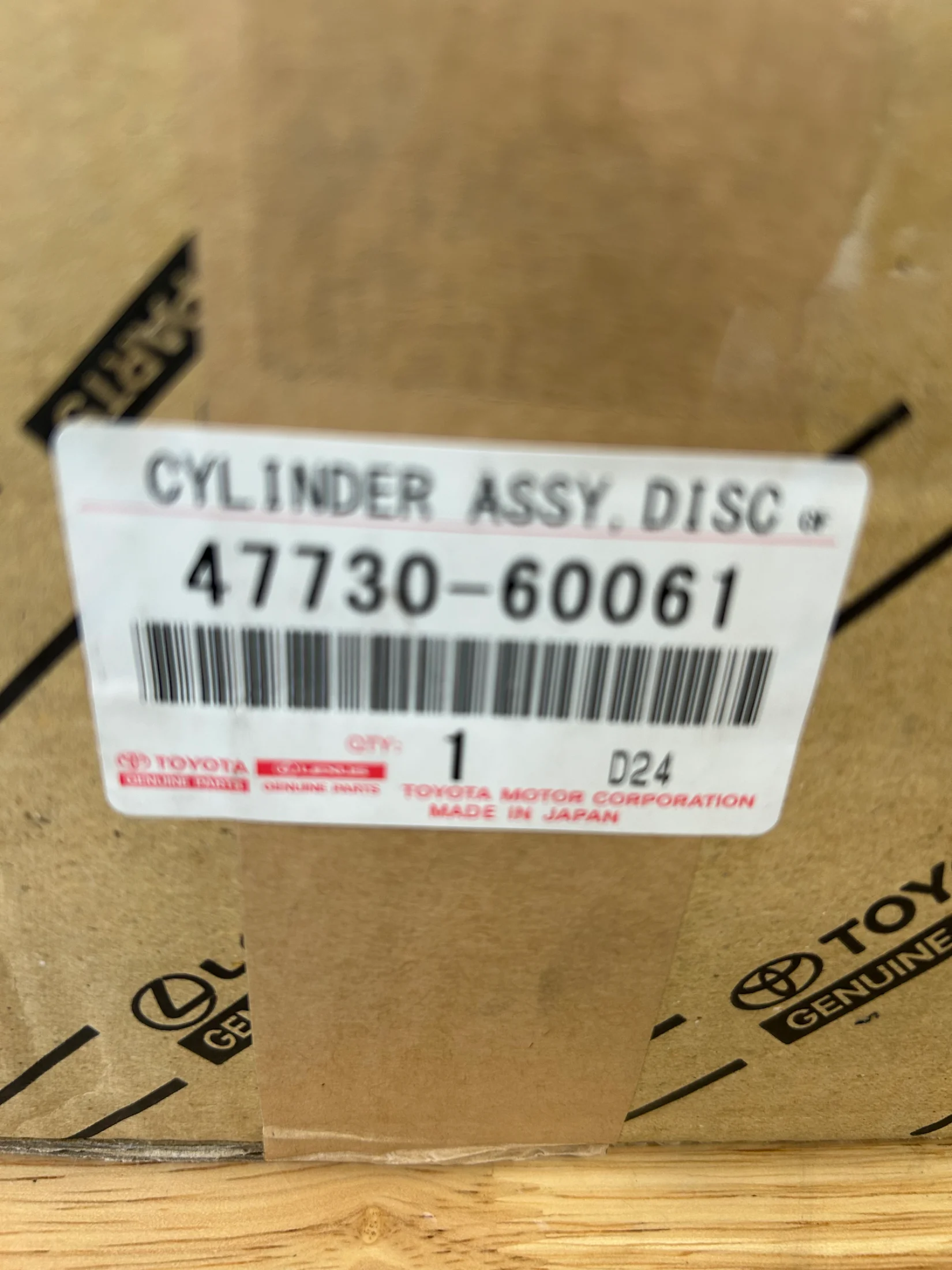

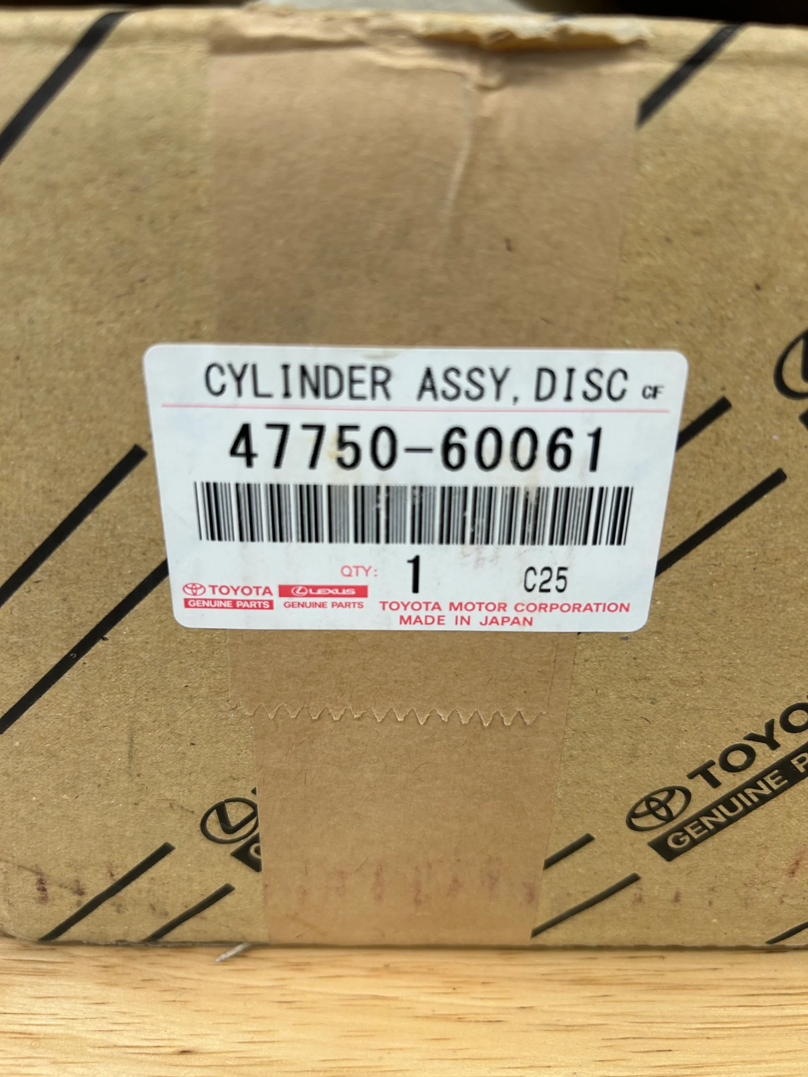

Finally dove in and replaced front rotors, calipers, and re-packed bearings. Went with OE Refurbished Calipers - as luck would have it one of them was not correct, will have to wait another week for the replacement to arrive. Even with, one old one still on braking is 100% more responsive.
FYI - Lx Calipers for 96 still available new OE - much happier!
