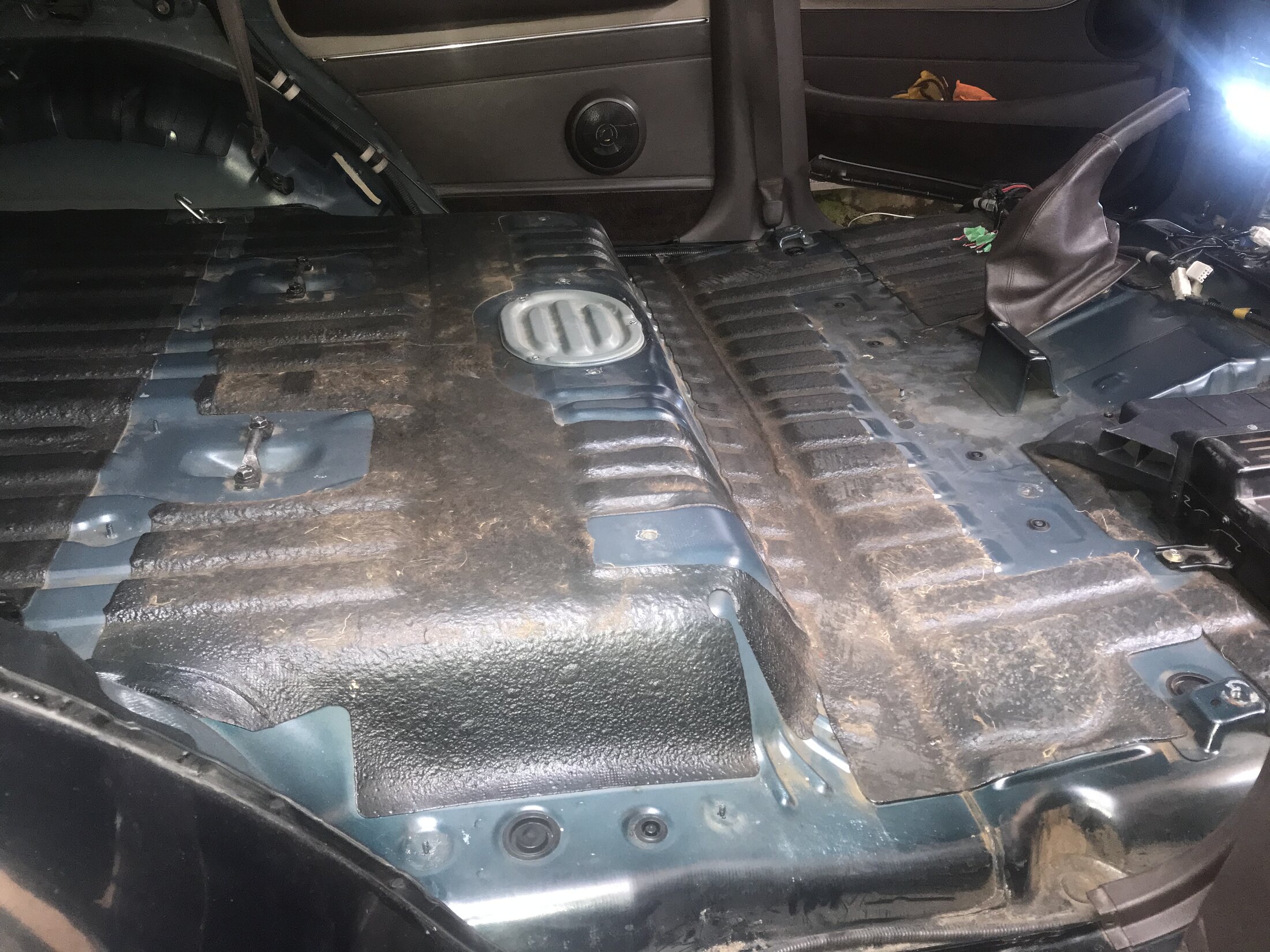

Continued with the base lining of my 92. Last weekend I chased down and corrected a couple cel codes for EGR system and a dead O2 sensor along with replacing the broken headlight and switching all 4 headlamp bulbs for some fancy 9005 sylvanias. I was surprised to find all the bulbs I removed were koito. Also removed a janky add on alarm/associated wiring. This weekend I adjusted valves(all were tighter than spec) replaced valve cover gasket and pcv grommet, set the timing (advanced it a couple degrees from the fsm recommended 7). And replaced nearly every single vacuum hose on the rig. Also tightened up the trans kickdown cable. Some combination of today's activities cured a slightly erratic idle it's had since I got it, and the drive home from my shop revealed a obvious difference in the cruisers ability to maintain speed. I'll be curious to see what fuel mileage does, my first tank yielded 9.6. after tuneup and cel corrections I got to 10.8. I'll report back after I burn through this tank.

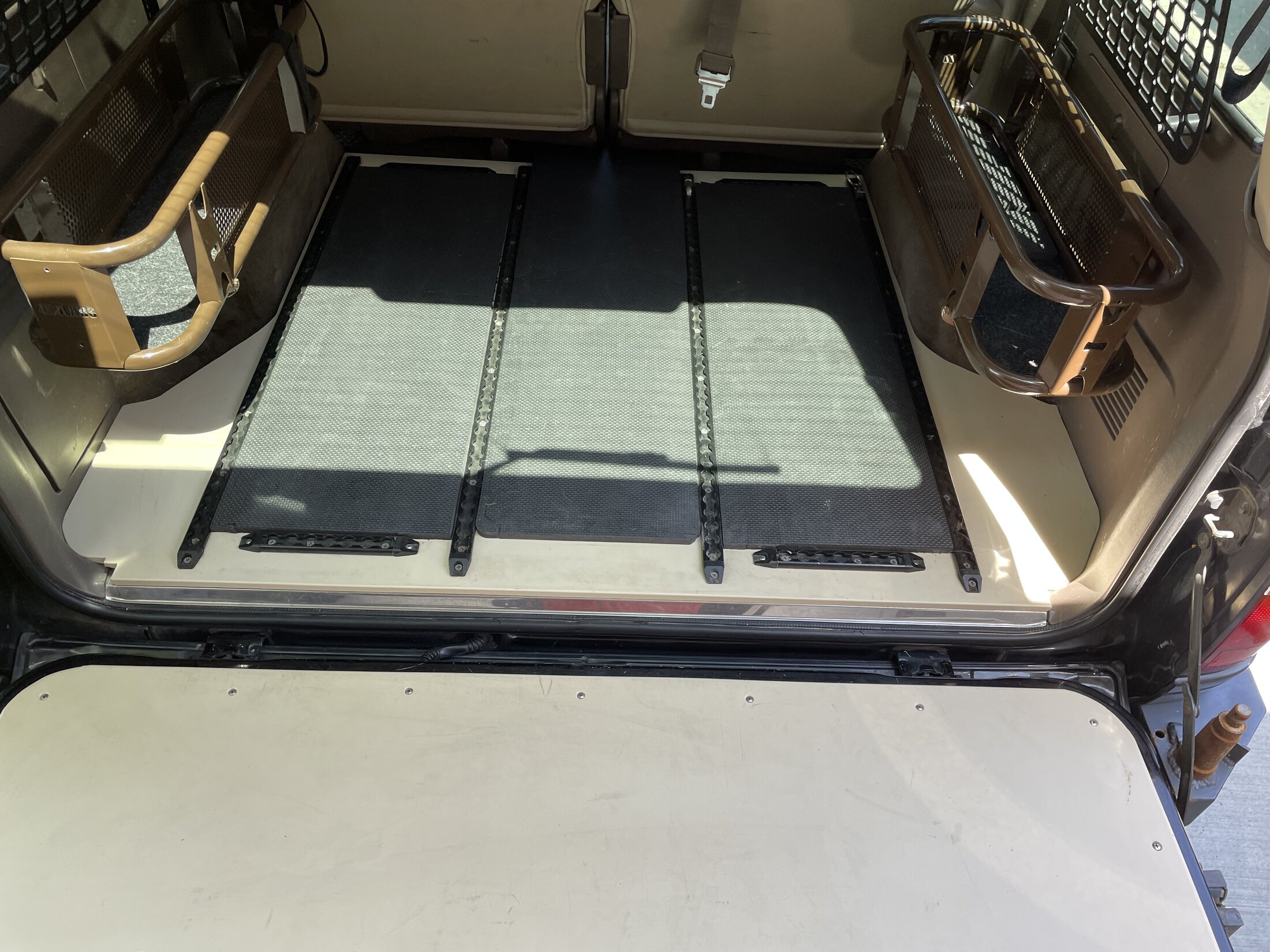

The previous owner of mine installed this plastic floor, and I'm trying to guess how it comes out. I'm pretty sure it's screwed down into the D-ring holes, but there may be more to it (I can see some kind of metal support structure along the front edge).
Looks like a good "learn through play" situation. Just go at it with the right tools and start taking things apart. You cant really do any harm. If your nervous, take some reference pictures as you go so you can back track and put it back together correctly if need be. Stay organized, put hardware in sandwich bags or little plastic containers of some kind. The cheap ZIP Lock Tupperware containers are good. Another good habit if at all possible is to put hardware in its corresponding threaded hole, or if the hole has no threads, drop the screw in and wrap a small piece of painters tape around it so it cant fall out. That way you have all the correct screws in their holes. An especially helpful organizational technique when you have different length screws in the same piece of hardware, and you need to keep track of which exact screw goes exactly where it needs to go.
