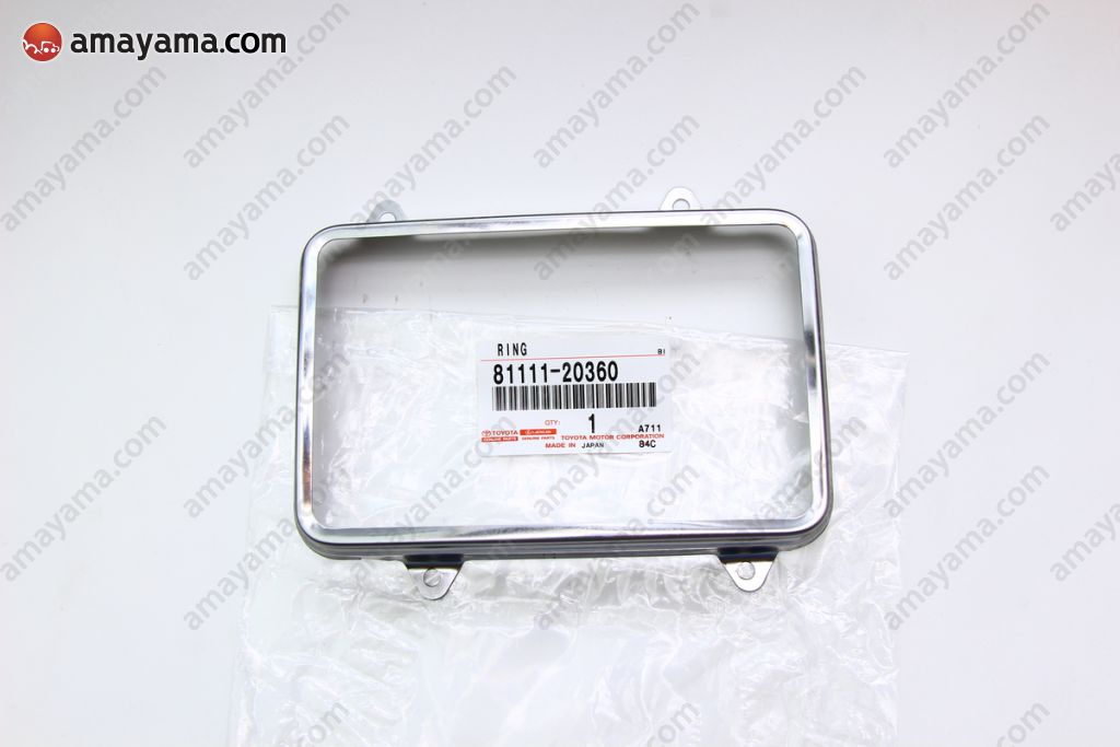

So Ive been putting together a quad light kit. I have the mounting brackets, the bezels, the corner lights, wiring harness (Courtesy of Jose) and the lights themselves. What I dont have are the retaining frames (found on partsouq) the light buckets and assorted hardware (springs, screws, clips etc). The light buckets on partsouq seem to be unavailable, but when I enter the part number (81114-22391) they pop up as available in the US for early 90’s Tercels and 1990 Land Cruiser. Anyone have an idea if they will work with a for my quad light conversion? The photo attached is a screen shot from partsouq.
I can't help with the Tercel/60 part, but it looks like Amayama has some frames available:

Do I need the buckets or are the retaining frames all I need?
Oh sorry man I misread your post. I thought you were looking for frames. Yes you need both buckets and frames.
Ok. The outer buckets are available but I can’t find the inner ones. Are there after market ones available?
Not that I'm aware of. It seems like quads are a dime a dozen in Australia - you might be able to get used parts from a place like All Four x 4 Spares:
And I can dig up some contact info for guys selling whole kits if you want, but I imagine you don't want to do that if you already have all those parts.
