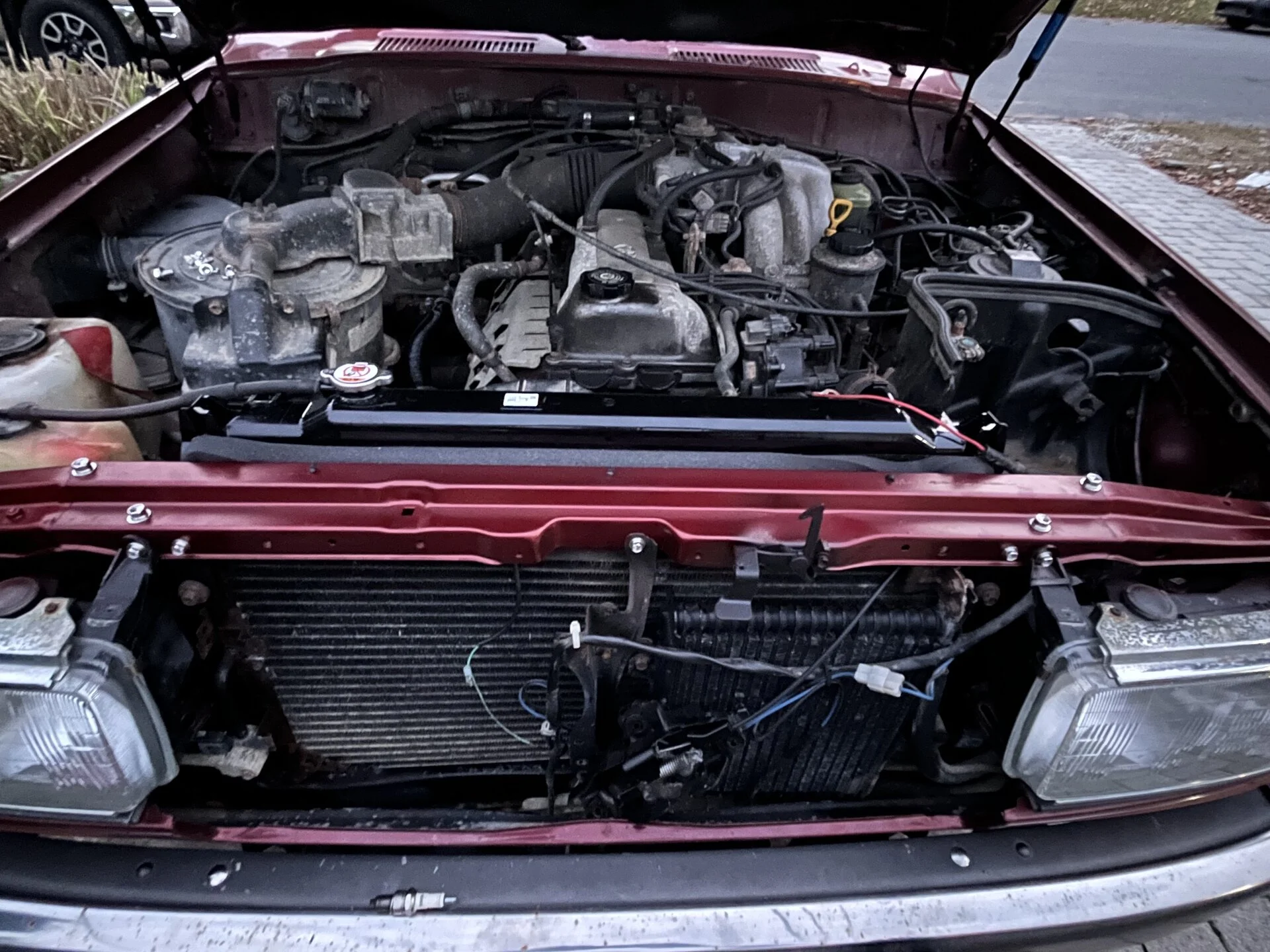

new toyota radiator with all new hardware and cleaned sanded and painted all brackets and support while apart

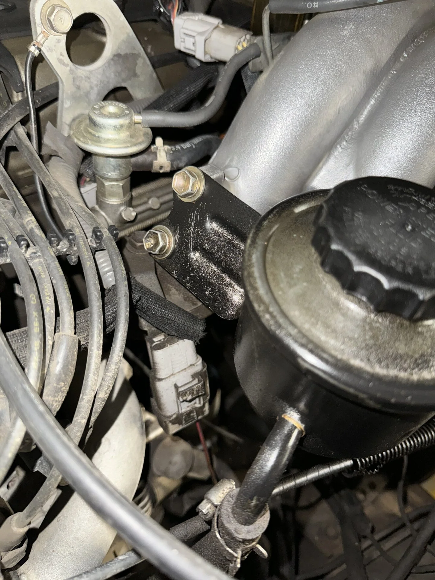

Off topic question, for the life of me I can’t find the part # for this connector I broke a while back. Going through the fall maintenance list and would like to replace it. Anyone happen to know the part number? It’s the white connector with one wire coming out of the base right below the power steering pump.
Thanks in advanced!

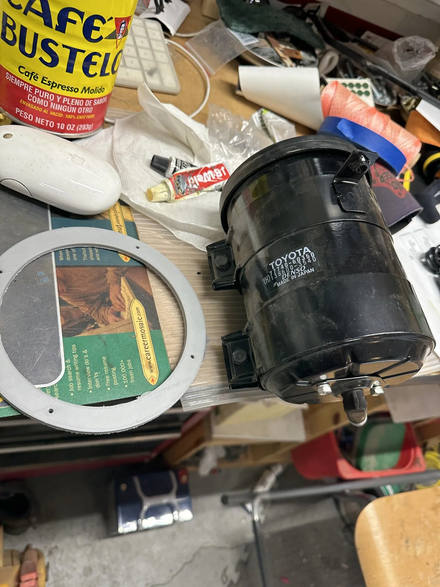

I printed some front speaker spacers for my new speakers and I went to the parts hoard for a new charcoal canister. I’ve had this since 2009 or 2010 to fix a boiling gas issue, but the original passed all the tests so on the shelf it went. The original finally gave up the ghost.

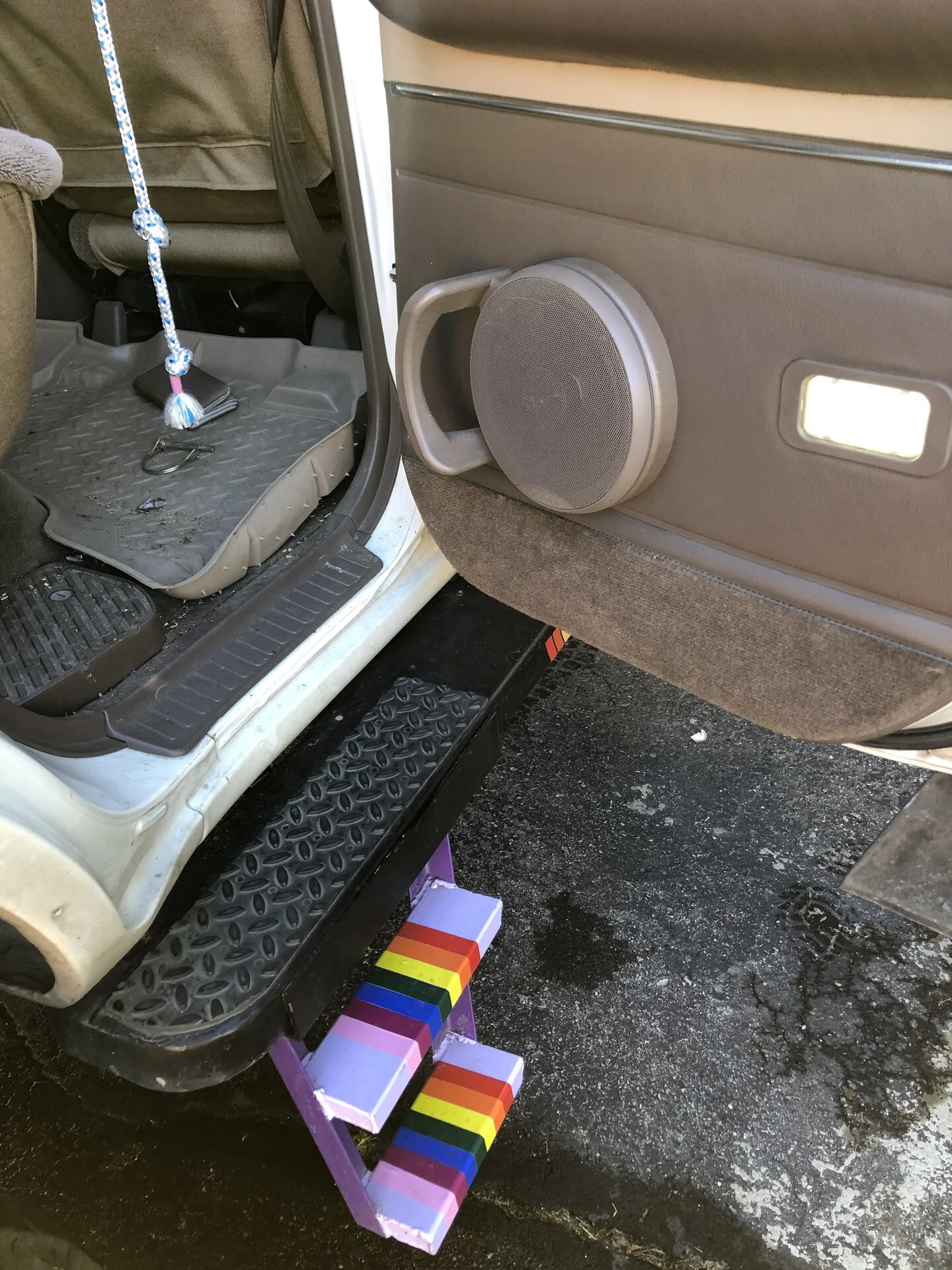

I have had the rainbow steps mounted into the slider receiver for a while so my kid can climb in. I just added the speaker spacer/handle to assist getting in. I don’t think I need the rope anymore.

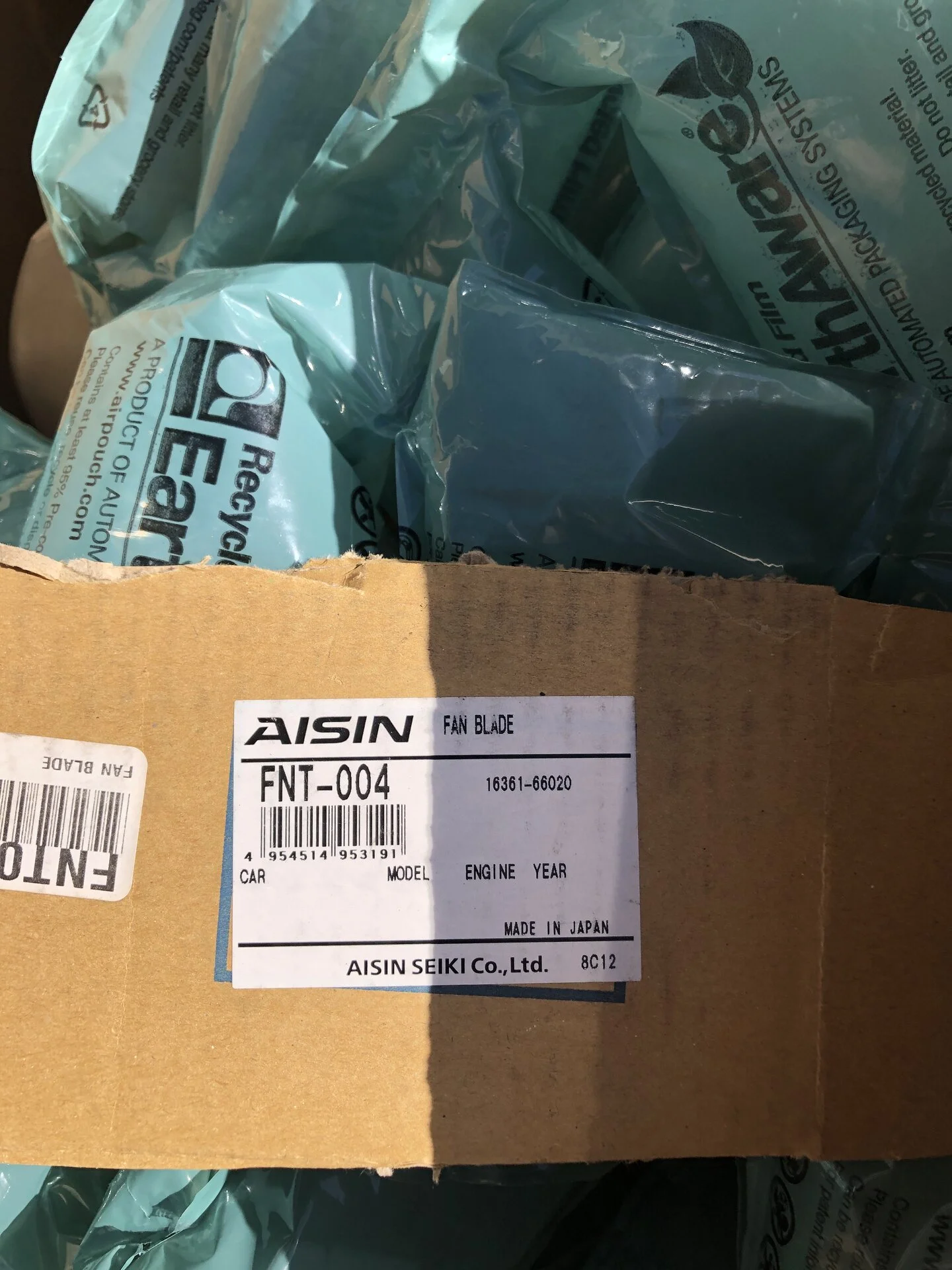

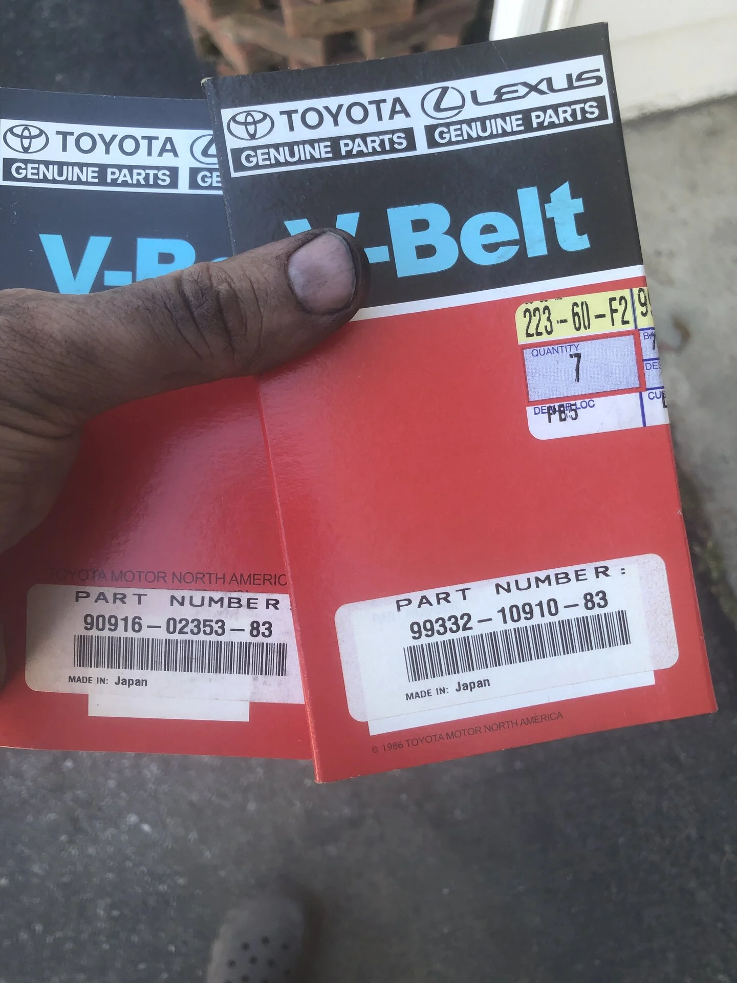

And it’s been getting cold at night here so I developed a coolant drip from the lower radiator hose thanks to worm clamps. I drained everything, installed a new water pump, new fan, belts, block drain valve, and Toyota spring clamps. Should fix the drip and the belt squeals I had seem to be cured. The water pump needed to retire.
