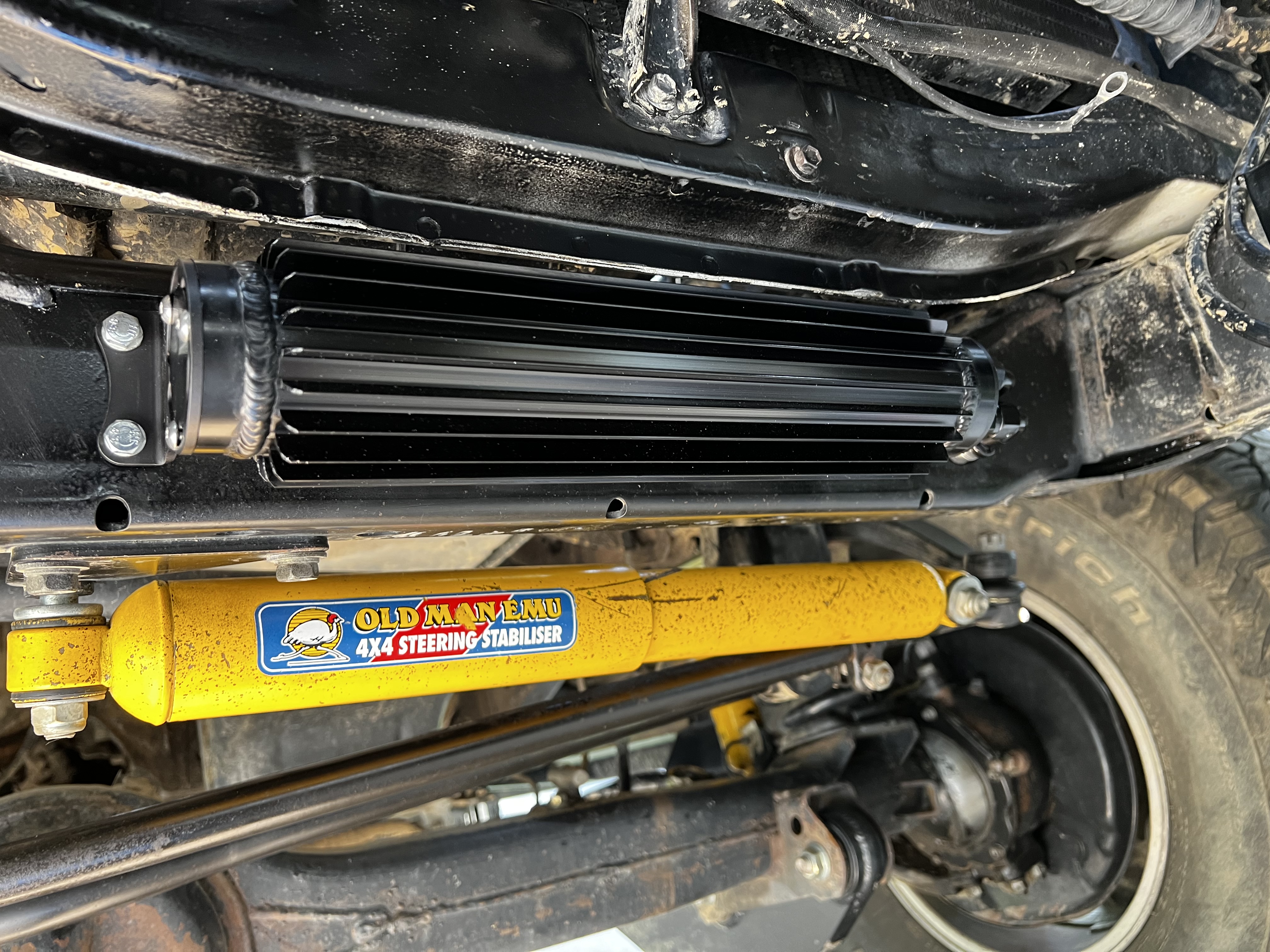

I finally got around to installing my 17” Derale cooler for the power steering...just in time for the hot weather here in nor cal
I bought the derale 17”cooler and pieced it all together...I used rustoleum professional gloss black on cooler for easy touch up, 3/8’s trans hose with push lock fittings..
first pic is paper clip OEM cooler on top for comparison ....

Sorry I know it’s old but how did you mount it to the frame? Existing holes or drill new holes? Thanks
Looks like the wits end kit. If I recall it requires drilling and tapping.
Ok thanks
No problem. Being the wits end kit you can probably find plenty of more detailed write ups. There might even be info on his website still.
its not i put it together myself..witsend had stupid delays like he always does
Gotcha. Looks like you duplicated it though.

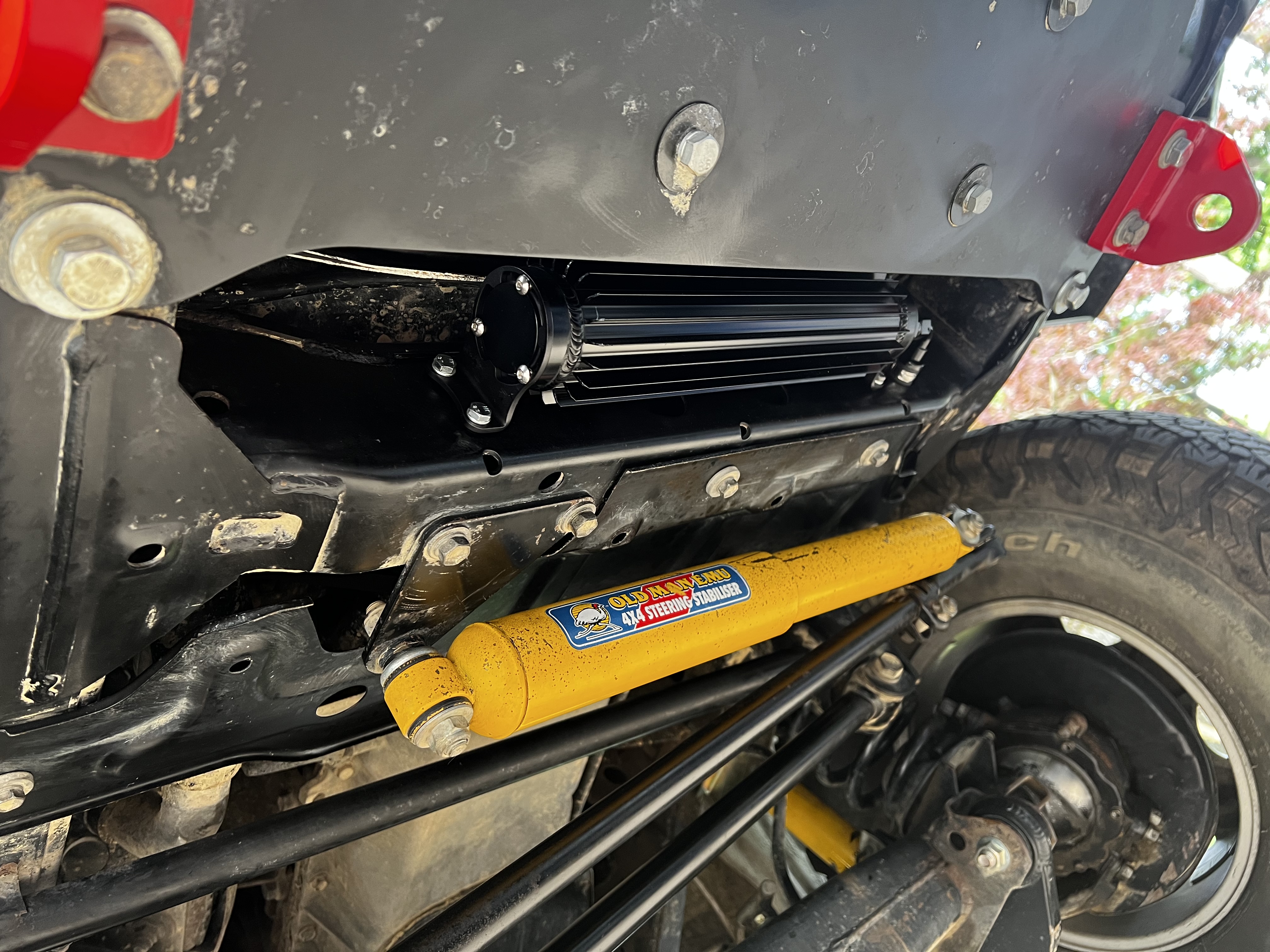

Quick pic of mine that I duped from Witt's list (his kit was out at the time), easy drill and nut-sert for the 4 mounting bolts. Biggest PITA for me was getting the paperclip out without destroying it....still had to do some heavy bending.
Definitely worth the upgrade....I get a lot less growl and hard steering when crawling now. :steer:
