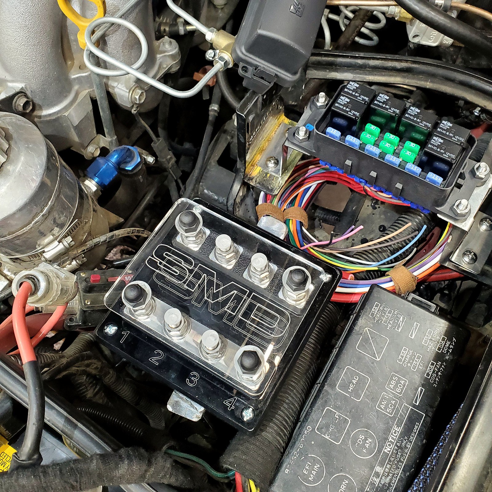

Getting started with cleaning up my electrical. I've had a simple Blue Sea fuse block for years but never had a good solution for the relays. So I'm swapping it out to a Concours Specialties relay/fuse block. Has 6 fused relays and 6 fused outputs in a tiny package. Also will be running a quad SMD distribution block (ANL fuses). Plan is to move everything from the battery to this block including the fusible link (except for winch and main cable).
