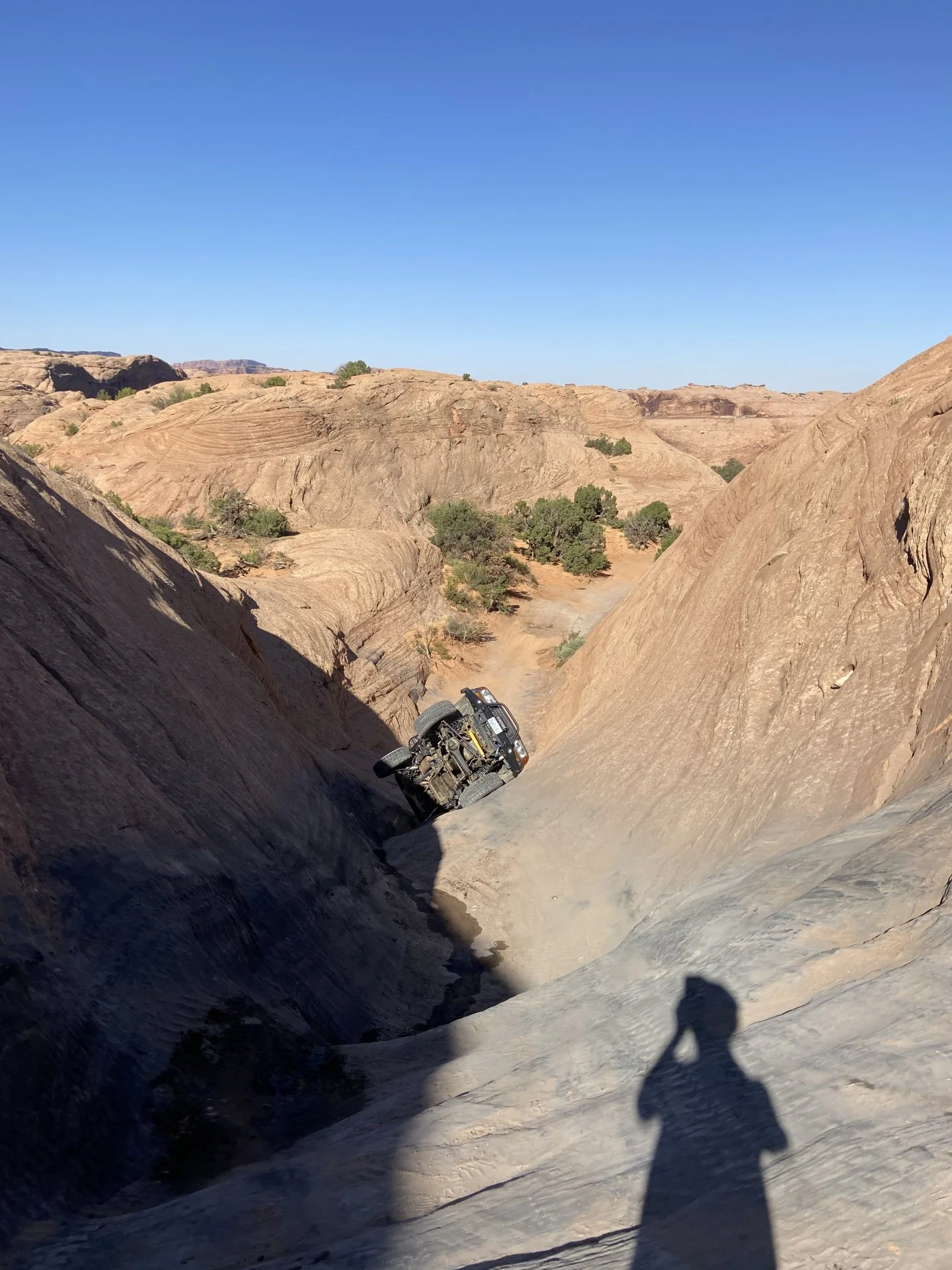

Attempted Hells Gate for the first time. Did not make it. Line was all wrong and my spotter was not helpful. Ended up getting winched back to all fours and up the hill. Bumpers and sliders took the brunt and held the truck off the rocks. Only minor damage.
Learned a valuable lesson though. As nice as having all my recovery gear stored in my drawer set is, when you lying on your side it’s not accessible at all. Luckily my buddies had enough straps and my d-rings were on the front bumper already. After the flop I put my straps and soft shackles in a bag on the floor. They’ll go back in the drawers when I am not wheeling but will be carrying them like this when on the trail from now on.

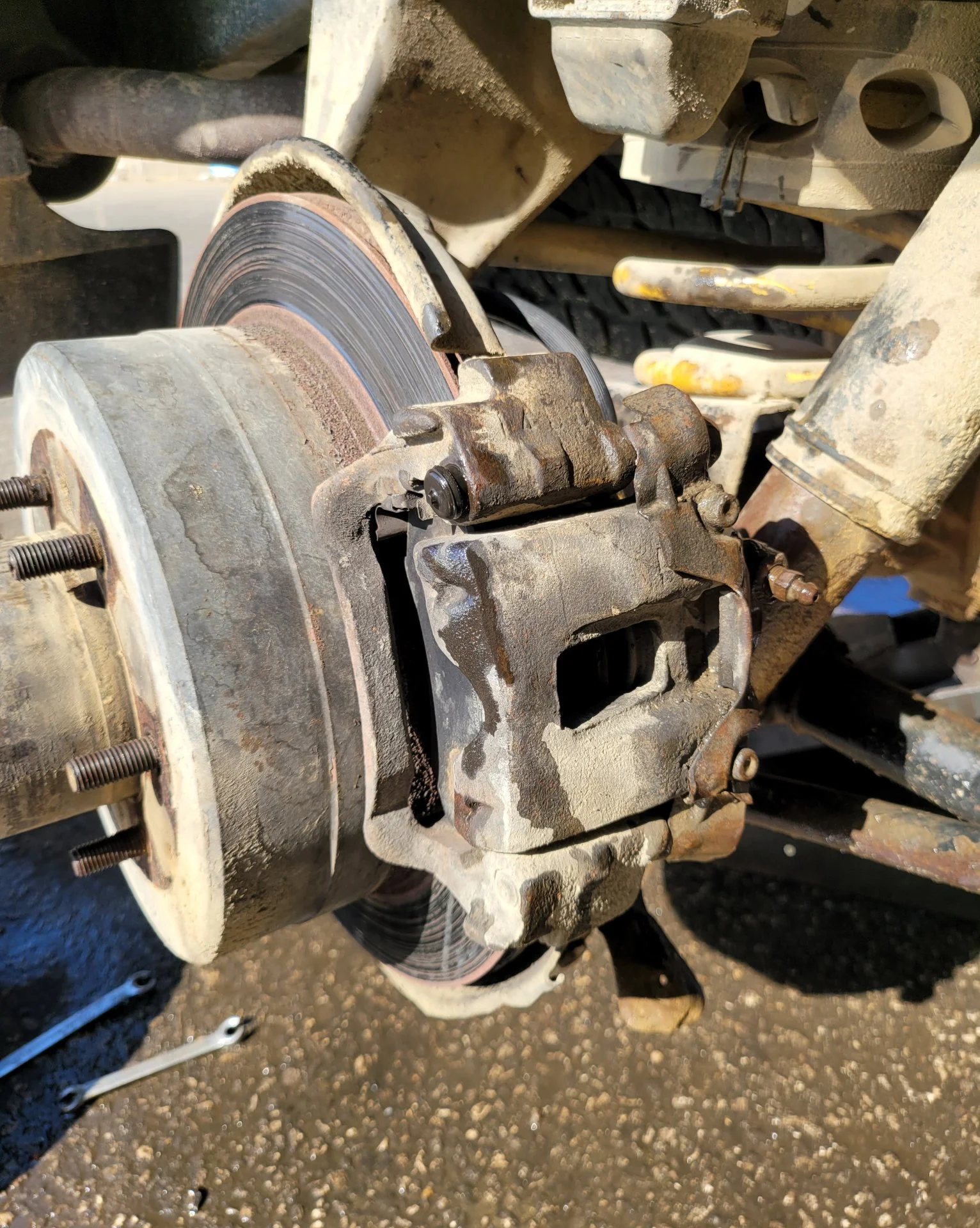

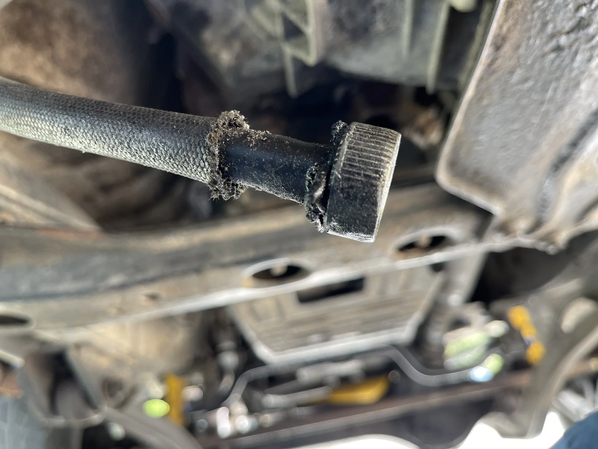

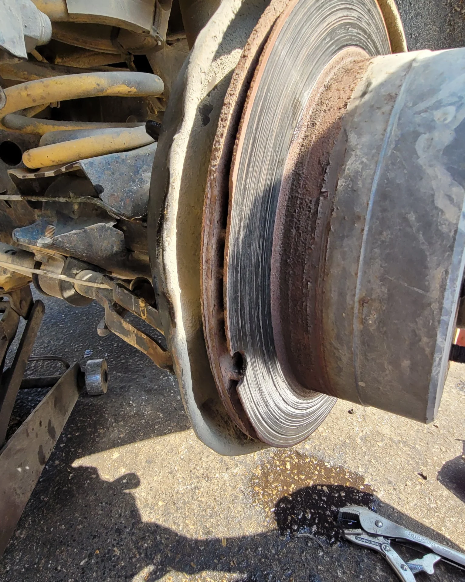

Brakes master cylinder was acting up, took it to a nearby mechanic and took it apart.
The servo needs replacing as well as the master cylinder, there is too much internal wear deforming its cylindrical shape.
One of brake lines was replaced by a short one causing threads wearing out and leaking.
Brake disk is broken ! I can't imagine what on earth the previous owner was thinking... it was driven so long with out brake calipers it reached the brake unit as well.
So lots learned to be honest 🤣
Temp repair as the Toyota parts and mechanic are a good 1 hour drive away, so sorted out and next weekend will drive there to replace with original parts.

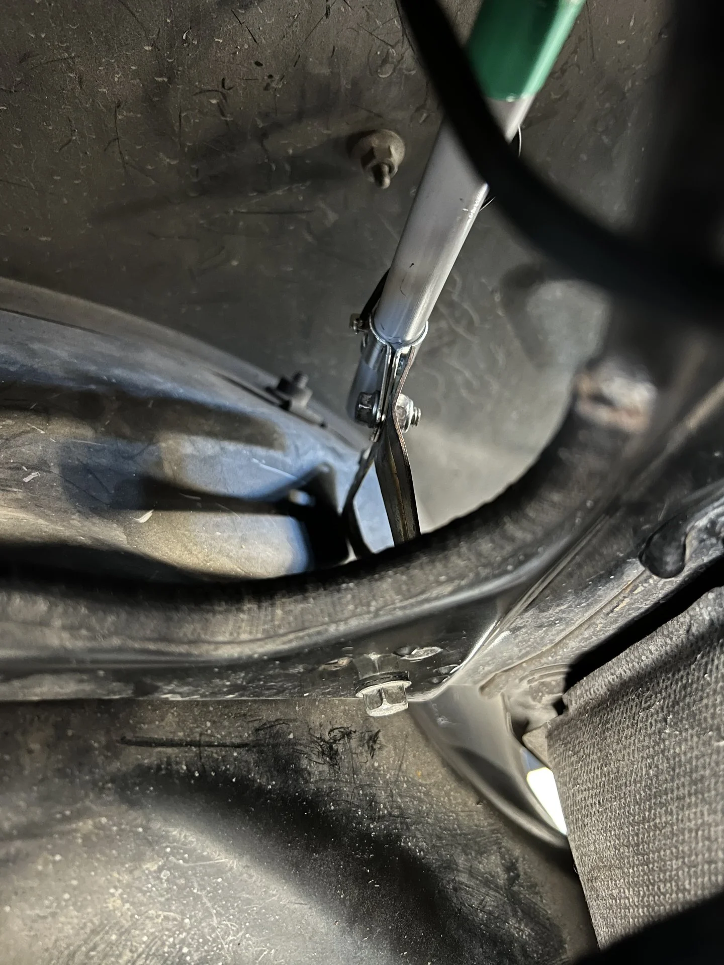

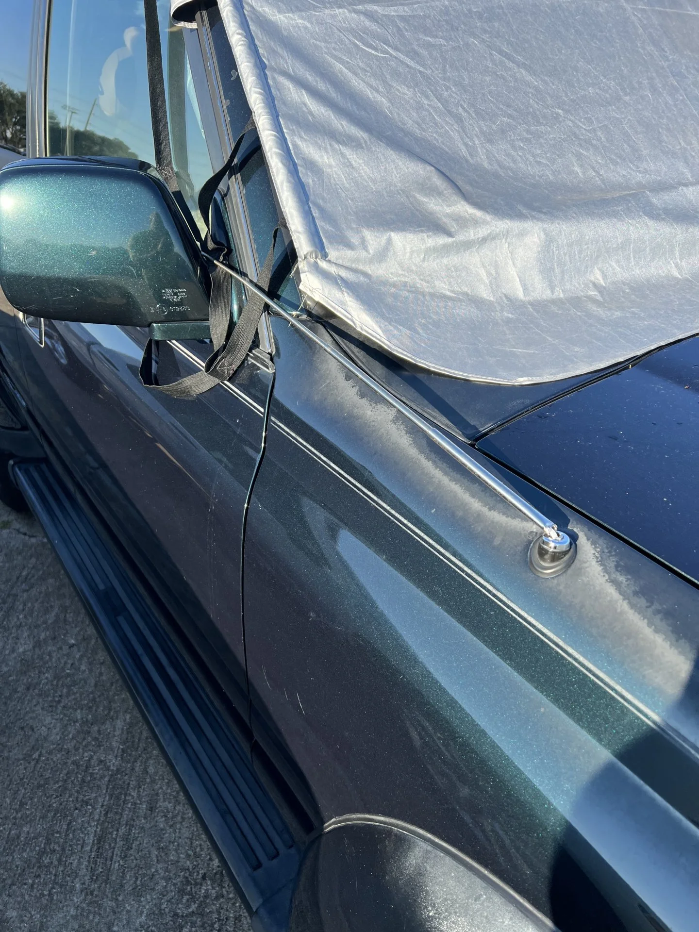

Someone ran my 80 through the car wash with the antenna up, resulting in a very racy streamlined antenna. Replaced with a Tacoma modification. Ran the coax through the firewall rather than try to feed through the the original side gasket.

While you're there, check your E-brake pads. Probably original and the pads are super thin.
Sorry for my ignorance, i don't know whats the e-brakes
That some one is probably in leg cast by now 🤣

and you just noticed this????? from the looks of this you should probably check every single thing on your rig....or more accurately....have someone do it for you.
The truck is in Egypt. It's had a tough life.

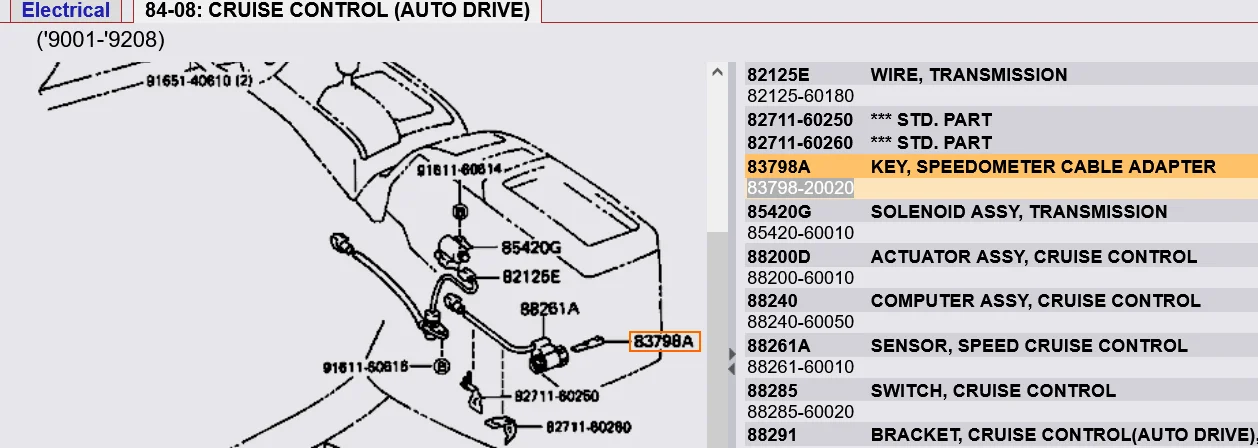

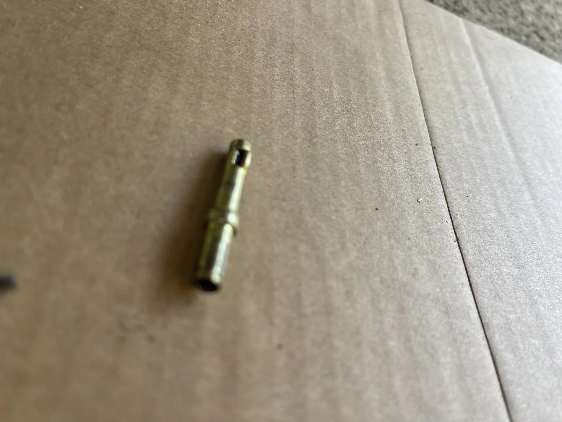

Screenshot 2022-10-15 at 13-24-30 84-08 CRUISE CONTROL (AUTO DRIVE) diagram 1991 TOYOTA LAND ...webp
The key goes between the cruise control sensor and the transfer case. The speedo cable attaches to the other end of the cruise sensor.
