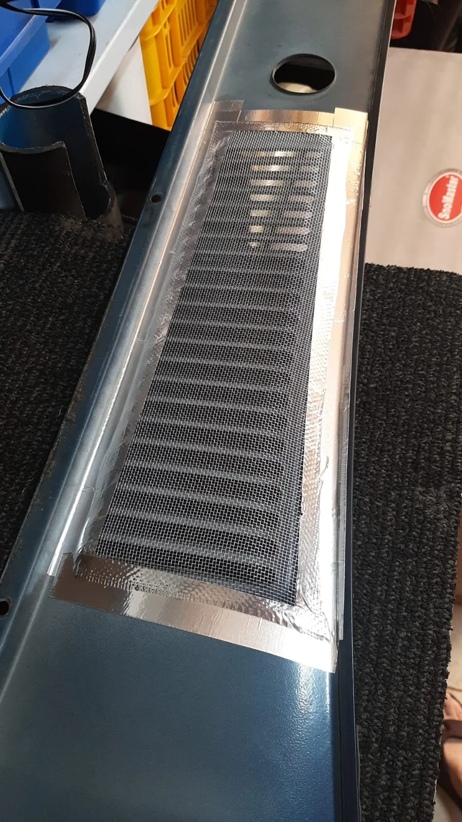

I just bought some of this. After reading about the tape losing its adhesion, maybe I will try some JB Weld and see if I can get a good install.

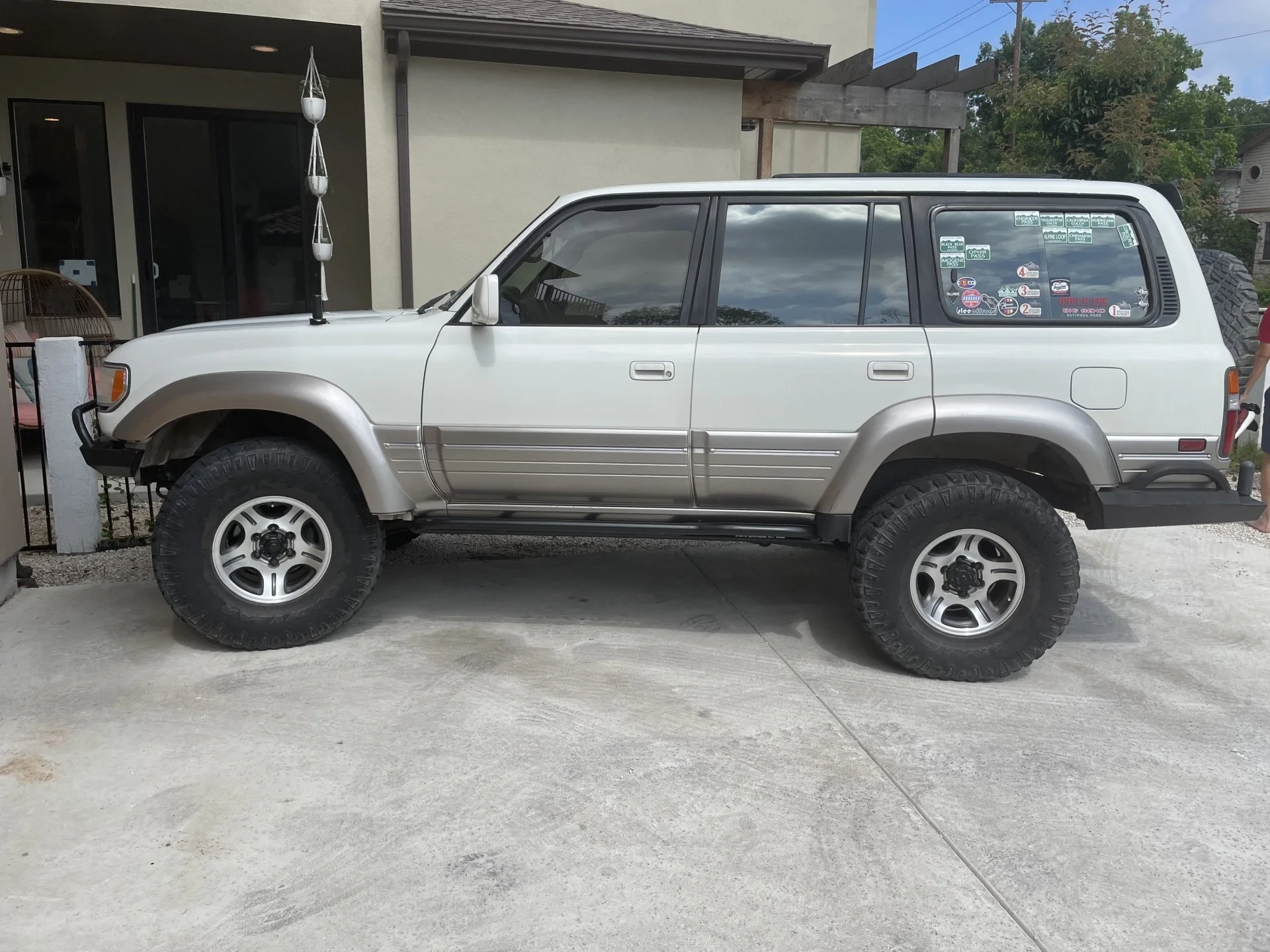

Well, past 2 weekends…
WNOR sliders bolted on…as advertised, they are perfect out of the box and fit snug. (haven’t looked yet, but what do you LX guys do with the front fender gap where running boards used to mate up…modify a LC mud flap?)
Changed diff oil from Nitro gears break in. Like 2 metal flecks total in rear with none in front after about 900 miles. Went with synth 80-140W GL5 as Nitro recommends.
Completed installs for GMRS radio including custom antenna bracket from the Archer brothers (@POTATO LAUNCHER and @BombCity).

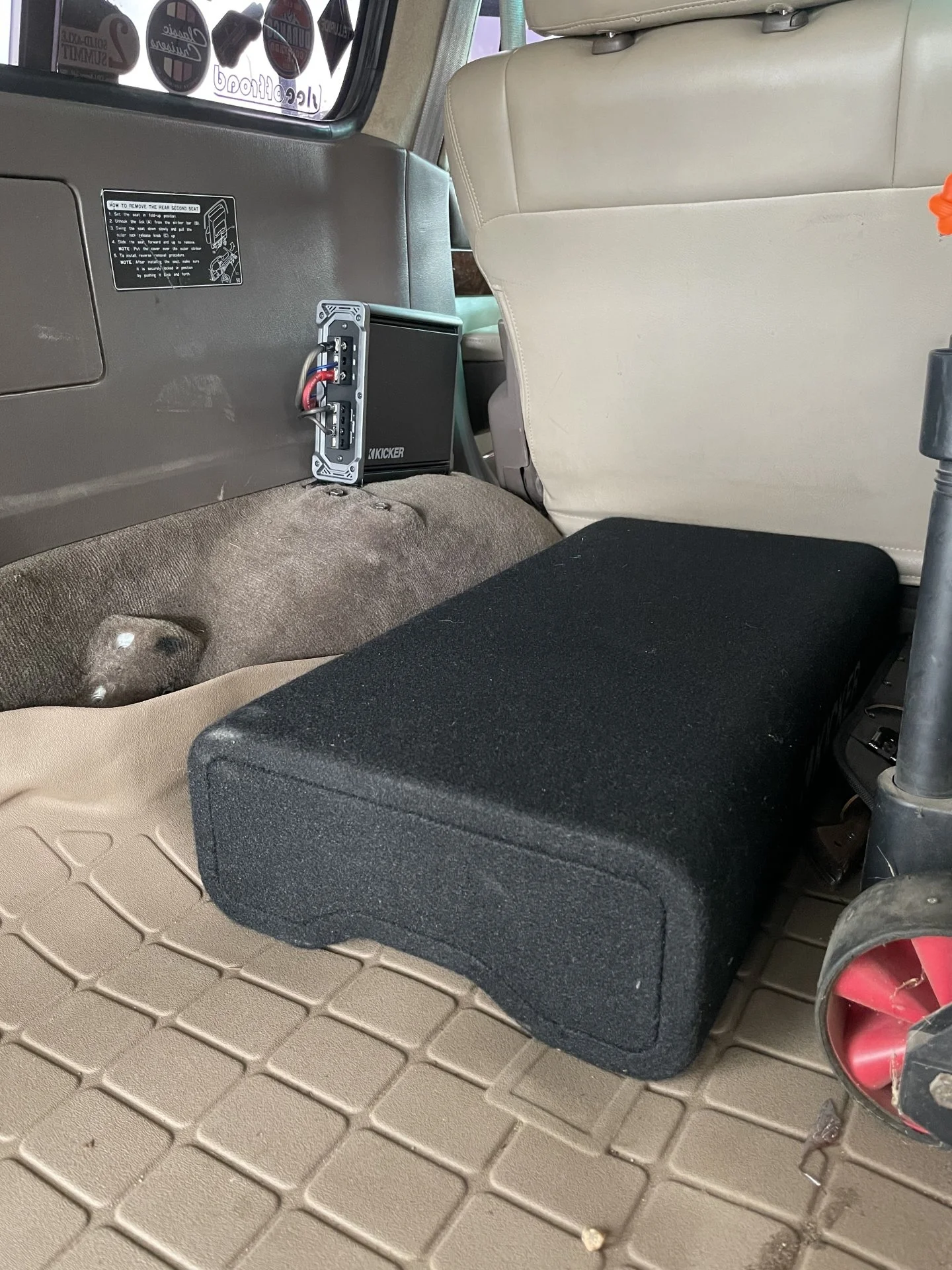

Replacement sound system. JVC head unit cause can’t get Pioneer right now. Focal door speakers and Kicker sub box with amp…the stuff I couldn’t afford when I was 16.
New shoes ordered. Should go on next weekend.

Been eyeing that sub for a while what do you think of it?
Super happy. Much bang for the buck. And I’ve got it turned all the way down for the “break in”. Moves the front seats. It takes up very little space and has extra wire so I can move it around instead of hard mounting. You can stand and jump on the box. No problemo. I’ll set it on top of the drawer system when I get that put in. In the perfect world I’d have gotten the little Alpine amp that mounts behind the head unit to run the thing. Wasn’t available when I needed it and the kicker amp wouldn’t fit into the CD changer slot like I was hoping.

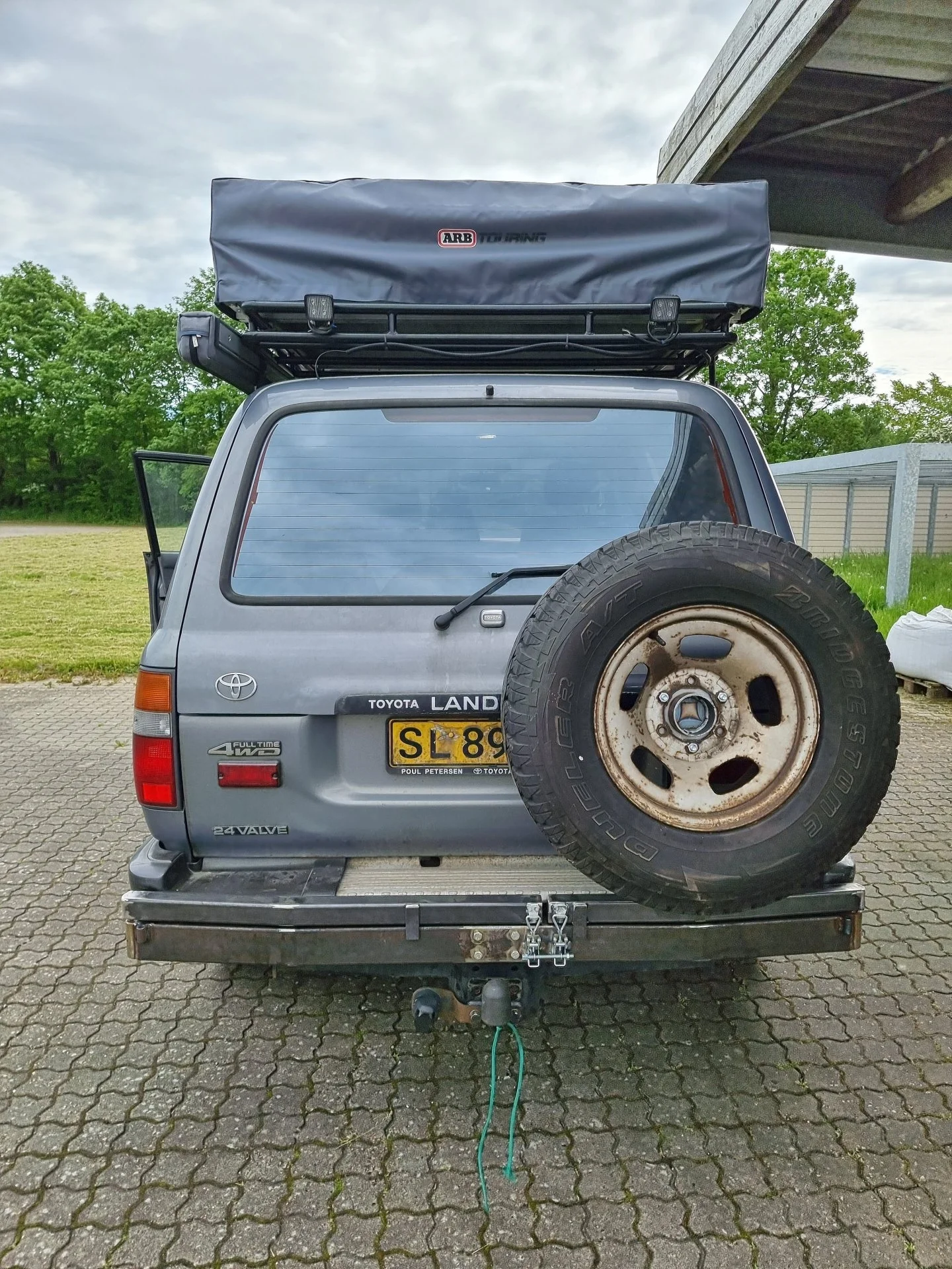

Been working on the rear wheel carry jig-thingy again. Added som curves and found a solition to hold the wheel
Now i need to work on the carrier for the jerry cans and i need to find a solution for the licenseplate and rear lights (they are being covered up by the tire, which is not legal here in Denmark...)
