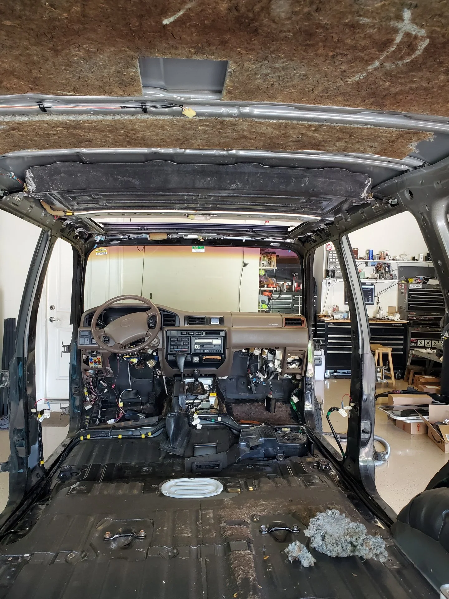

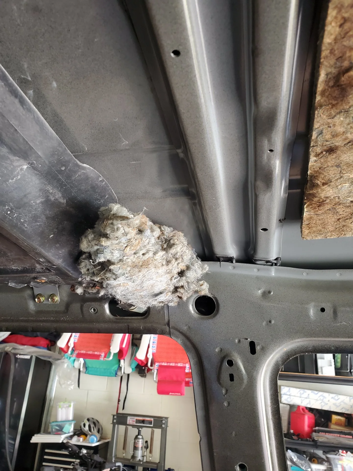

Pulled the headliner down to tackle a few jobs and found a mouse nest :hmm:
He/she/it had pulled the insulation from the back of the roof. View attachment 2690205
Not sure if this was the same critter but i found his "holiday home" under the drivers seat. So far i have found 3 bees/wasps nests and a few other things that i couldn't identify.
Pretty sure there are no more now...:hillbilly:
Looks good. I did a whole interior removal on mine back in the day. I would love to pull my headliner down. Alas I have a 92...
Looks good. I did a whole removal on mine back in the day. I would love to pull my headliner down. Alas I have a 92...
I need to figure out some way of cleaning it without destroying the headliner fabric. It sure looks fragile.
That is a tough one. My headliner looks faded and rather scuffed but it is tight and holding strong. I worry about taking it down and ripping it or not being able to get it back in properly with the metal rods and what not. My main reason for pulling would be to get rid of the roof rack holes. I have them currently taped up with Gorilla Tape. I know that I have seen plenty of posts for the 60's folks that have the same kind of deal as the early LC headliners. I really would like to do a mod and get rid of the cloth and rod and go to a one piece type like the later LC's have. Would probably still be a pain in all the modding that would have to be done. :grinpimp:
