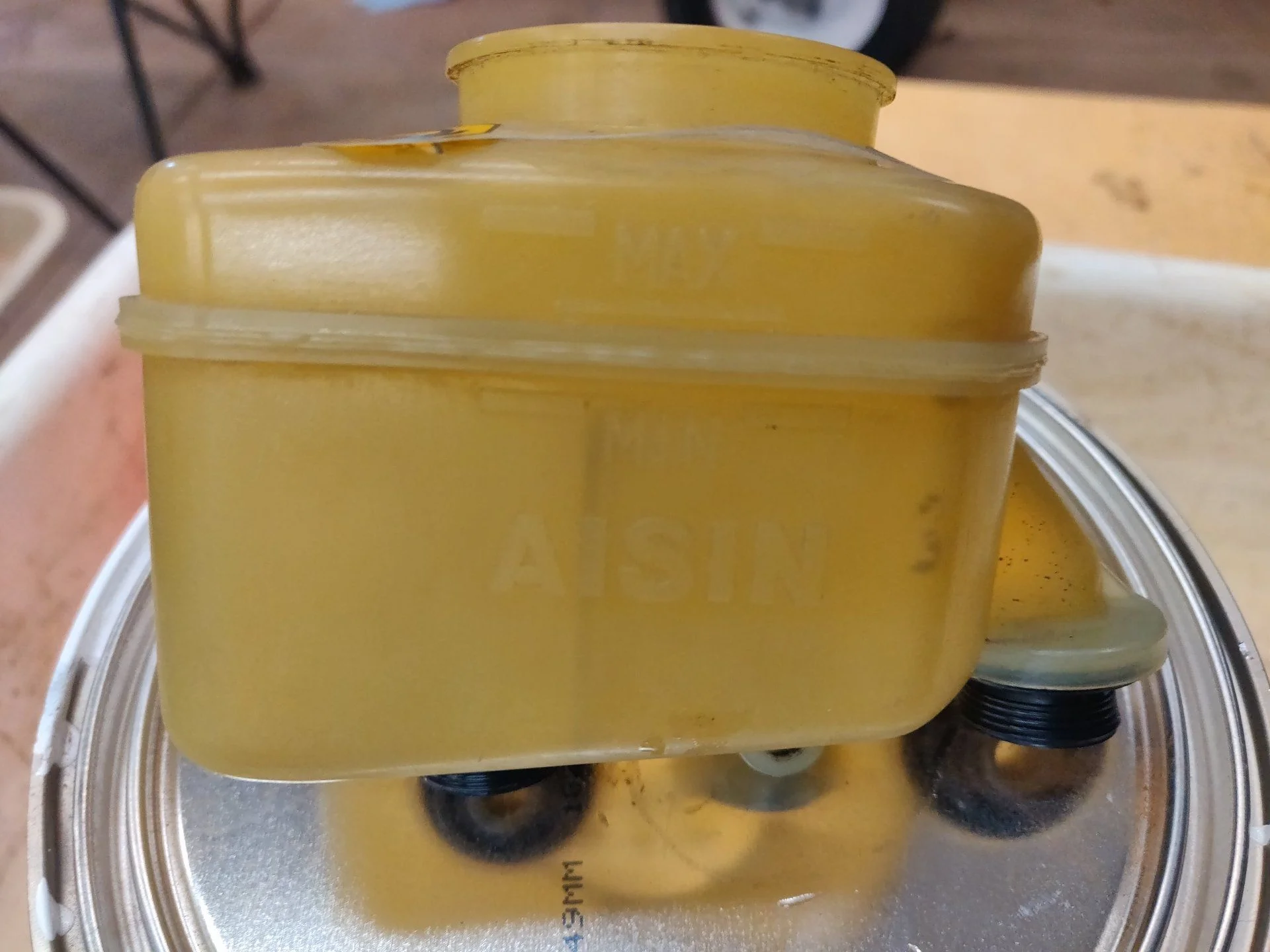

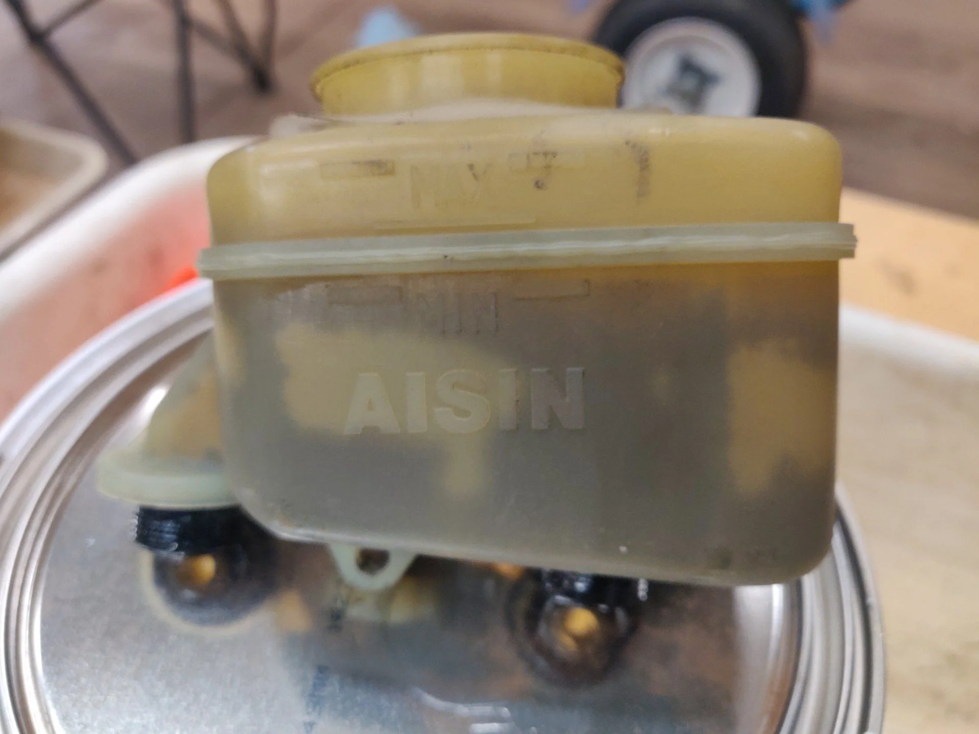

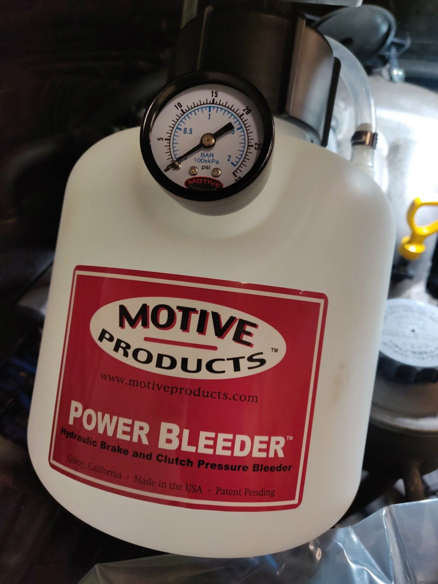

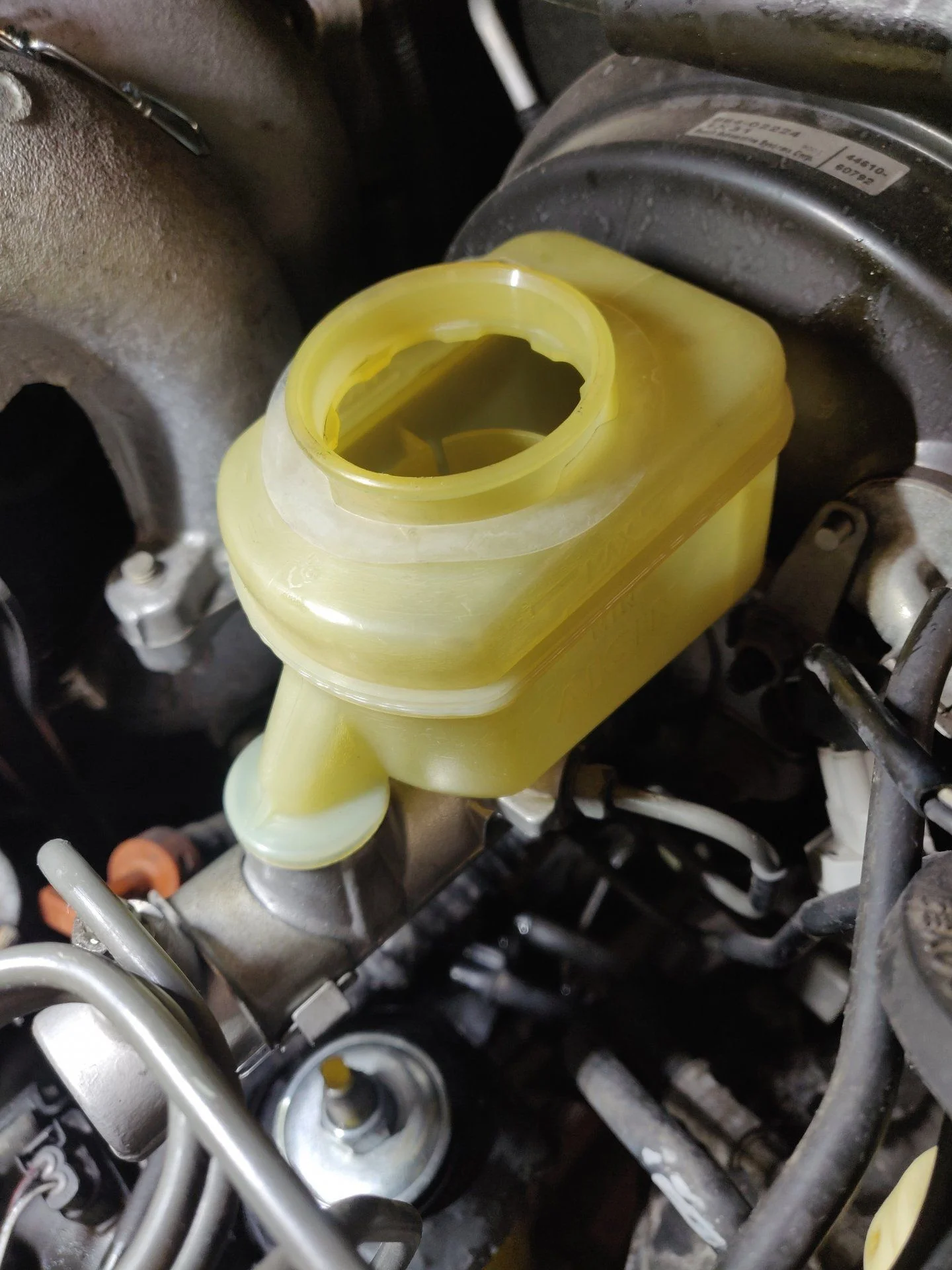

Bled the super nasty brake fluid. I'm sure it's never been done. The Motive products pressure bleeder worked great. The rear bleeders wouldn't allow fluid to come out so I had to take them out and clean then and then they finally allowed brake fluid to flow. That's how nasty the fluid was. Weird tho that the rear brakes started flowing cleanly a lot quicker than the fronts. The fronts purged a lot of dirty fluid before it came clean.
I had bought one of those years ago to bleed the brakes on my Civic that I use to road race. Best purchase I ever made.
