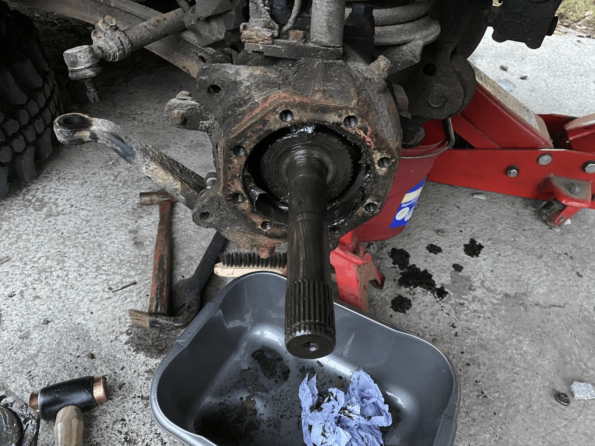

Still, knuckle preload is sloppy and the wheel bearing are slack and it makes sense to get it all apart and be sure it's been sorted right. I am in two minds as to whether to swap my wheel bearings out. They look okay but I'm not an expert.
Taking this pretty slow and steady. The goo looks okay to my inexpert eye

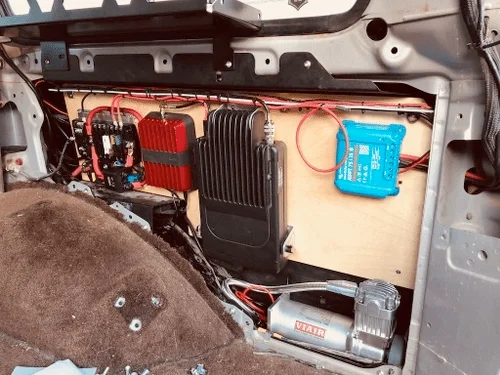

Just ordered for me or the Land Cruiser the rear 1/4 panel mount from Wits End @NLXTACY and also picked up the We Boost OTR antenna to use on the 80 as well.
What would the best setup be for the We Boost, sleep apnea machine, air compressor, winching duties?

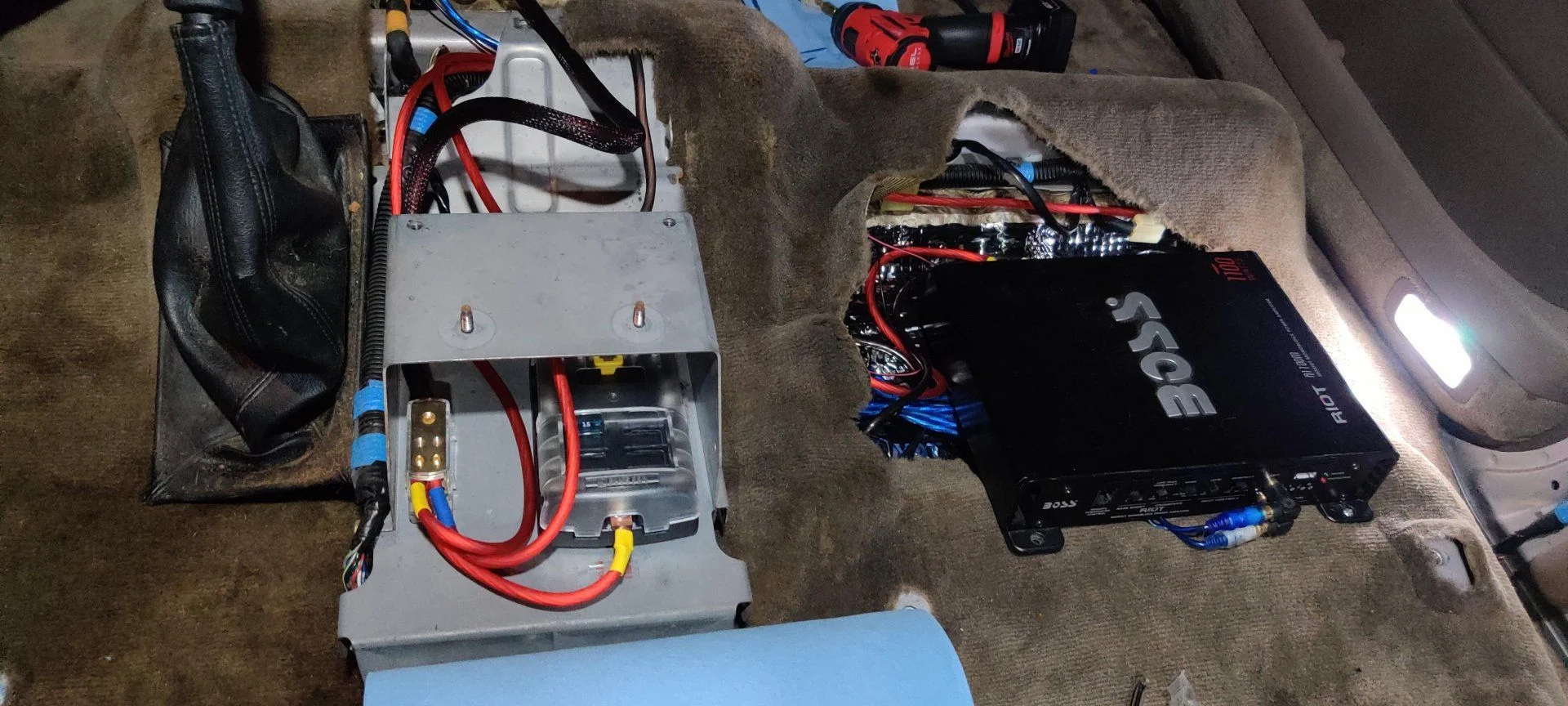

First ripped out the OEM sub/CD player (LX gang) to make room for my distro/fuse box. Also removed the rear heater (already did the bypass years ago) to make it easier to mount my sub amp.
Turns out the Boss amp died after I put everything back together, so upgraded to a much better amp, and with all the space it made for a clean install (showed it before)

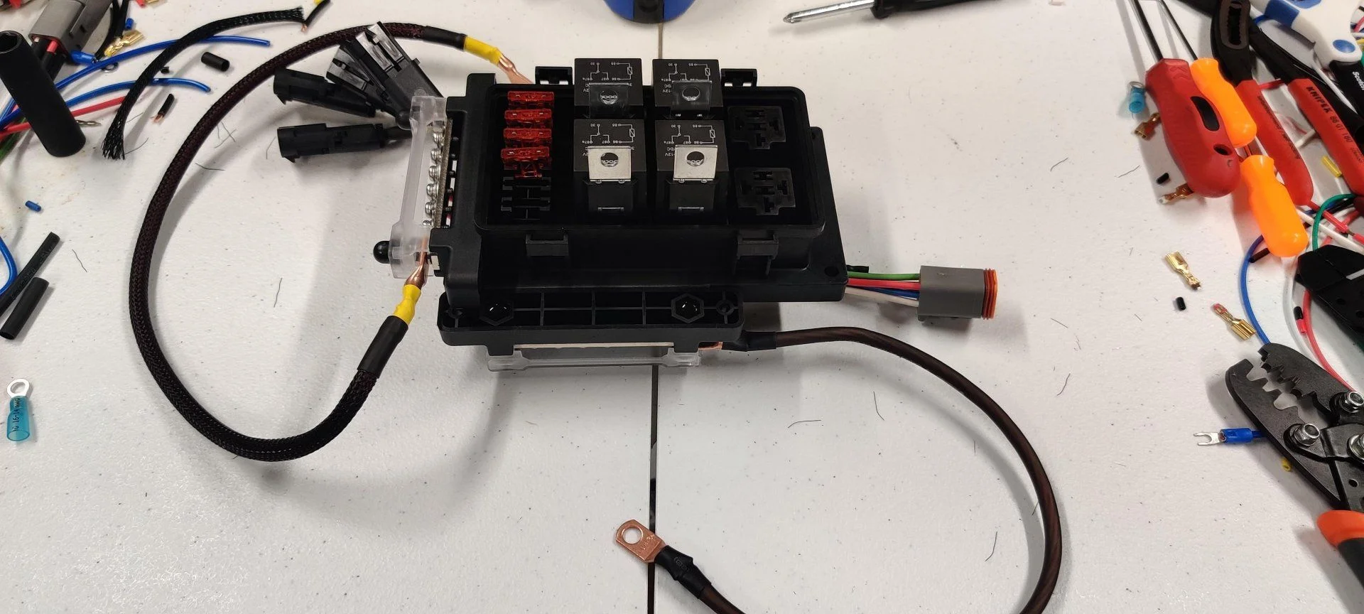

Then built up a relay box using this cheapo box, and these busses. If I were to do this again, I would 100% get a box with internal busses, but I like how it came out. I decided to just add 4 relays, and leave the 2 remaining empty for now. Also used this connector to run into the cab switches. Still need to make the wiring harness to go to the switches.

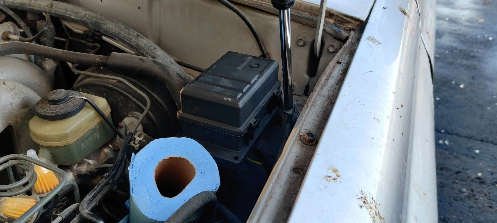

and I'm planning on mounting it here (shop towels keeping it in place), drilling 2 holes in the firewall pinch, spraying some rust-prevention, and then a simple bolt/washer/nut to keep it in place. It's a sturdy box and doesn't weigh too much, so I'm not too worried about it only being mounted on one end. If anyone has an objection to that idea, let me know, but there's no other good place I could find that wouldn't require some custom fab that I don't really want to attempt (yet)
Personally, if there is any question about the condition of the bearings I replace them. I'm sure I have replaced bearings that were probably okay to continue running, but I'd rather know that what is installed is definitely in good condition. I keep old bearings that still look okay as trail spares in the case of a catastrophic bearing failure.

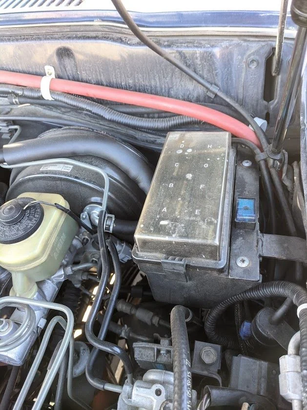

snip... I'm planning on mounting it here (shop towels keeping it in place), drilling 2 holes in the firewall pinch, spraying some rust-prevention, and then a simple bolt/washer/nut to keep it in place. It's a sturdy box and doesn't weigh too much, so I'm not too worried about it only being mounted on one end. If anyone has an objection to that idea, let me know, but there's no other good place I could find that wouldn't require some custom fab that I don't really want to attempt (yet)
Years ago I mounted a Saab relay box in that location. I fabbed a simple bracket that attaches to existing captured nuts on the inner fender. Remove two screws and the whole thing comes out. Its a great location.
A bit of advice; make sure you leave enough slack when you run your wires to be able to fully remove the box to add circuits or service the brake booster. There is plenty of space underneath for that.
