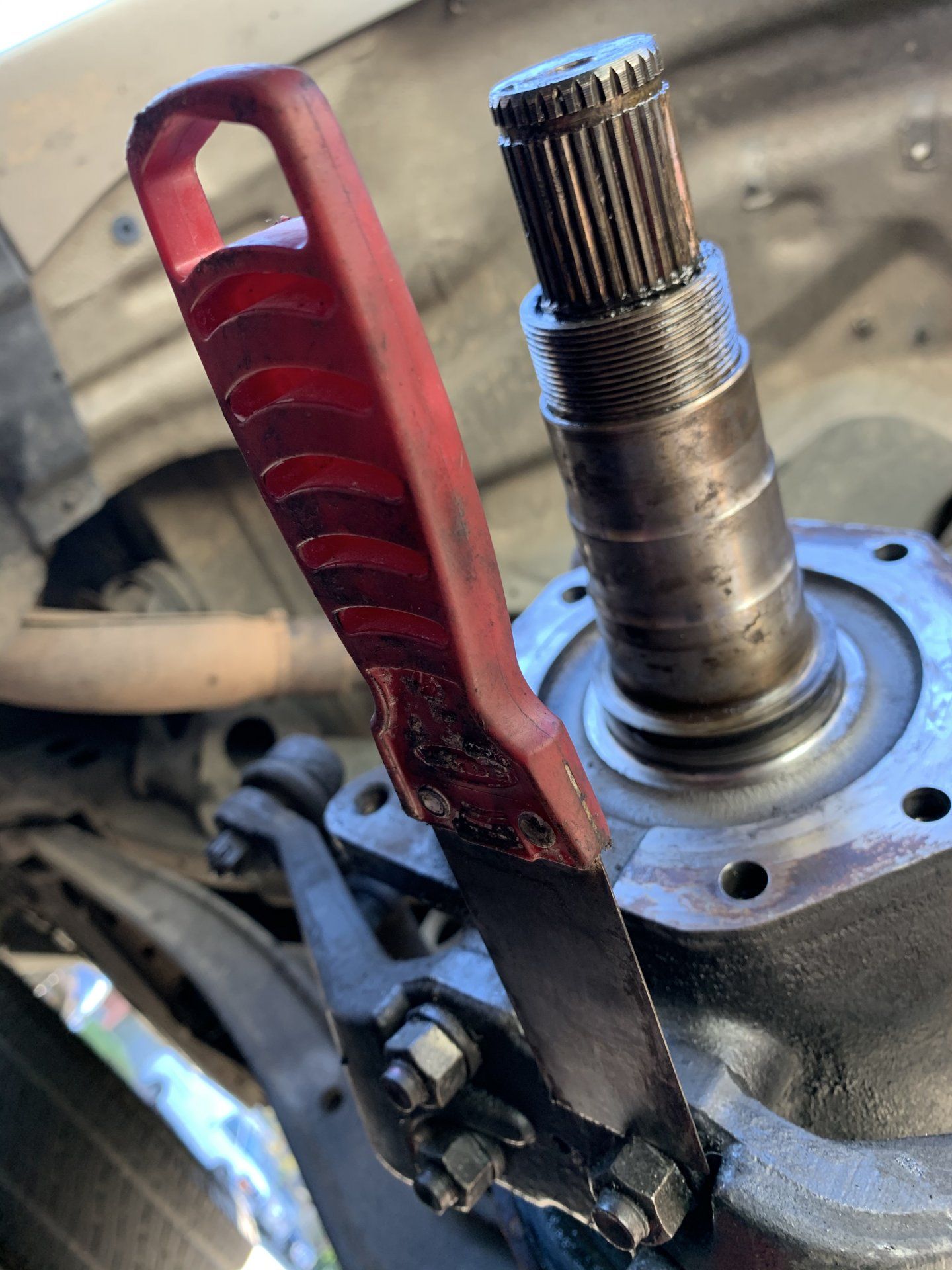

At 0700 this Saturday, in the dark and cold, I am in @ArmyFJ driveway and we are starting to take out this steering box. @ArmyFJ schooled me on the art of using a torch, the FSM, and Youtube to get the job done. Had a few snags but muscled through it. Also, replace the power steering reservoir with a freshly painted one, and replace the hoses I purchased from @NLXTACY. Towards the end of putting things back together, Mrs. @ArmyFJ ordered us in the house for dinner and a beer.

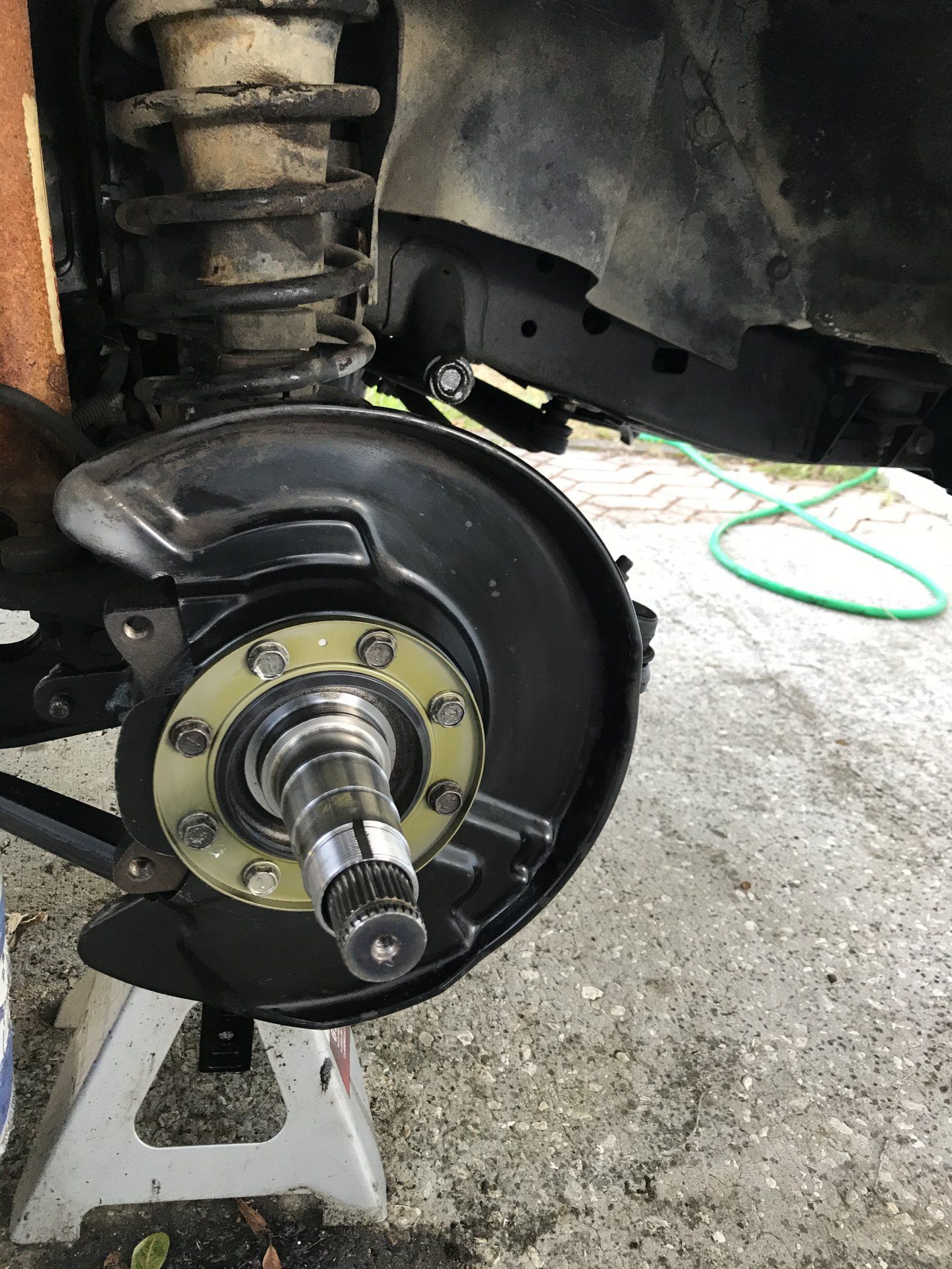

Crawling along but it’s done right and clean. Learning along the way as well. Parts washer cleaned the brake dust shield up and other main parts. I even cleaned all of the bolts, nuts and washers. Tested out my new Milwaukee 1/2 digital torque wrench.

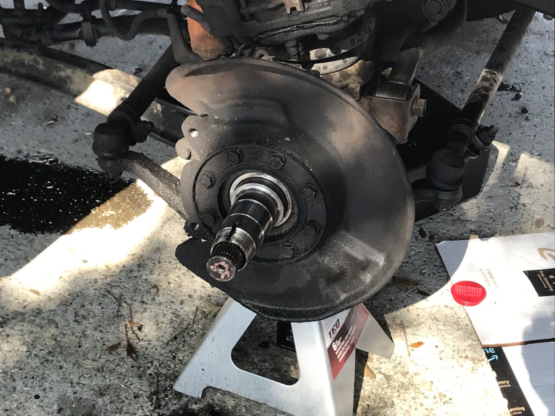

Holy Mother of Mud!!
found the forward two nuts like this....so loose I could mount a putty knife!!
scary... #checkyournuts this is not a drill!!!

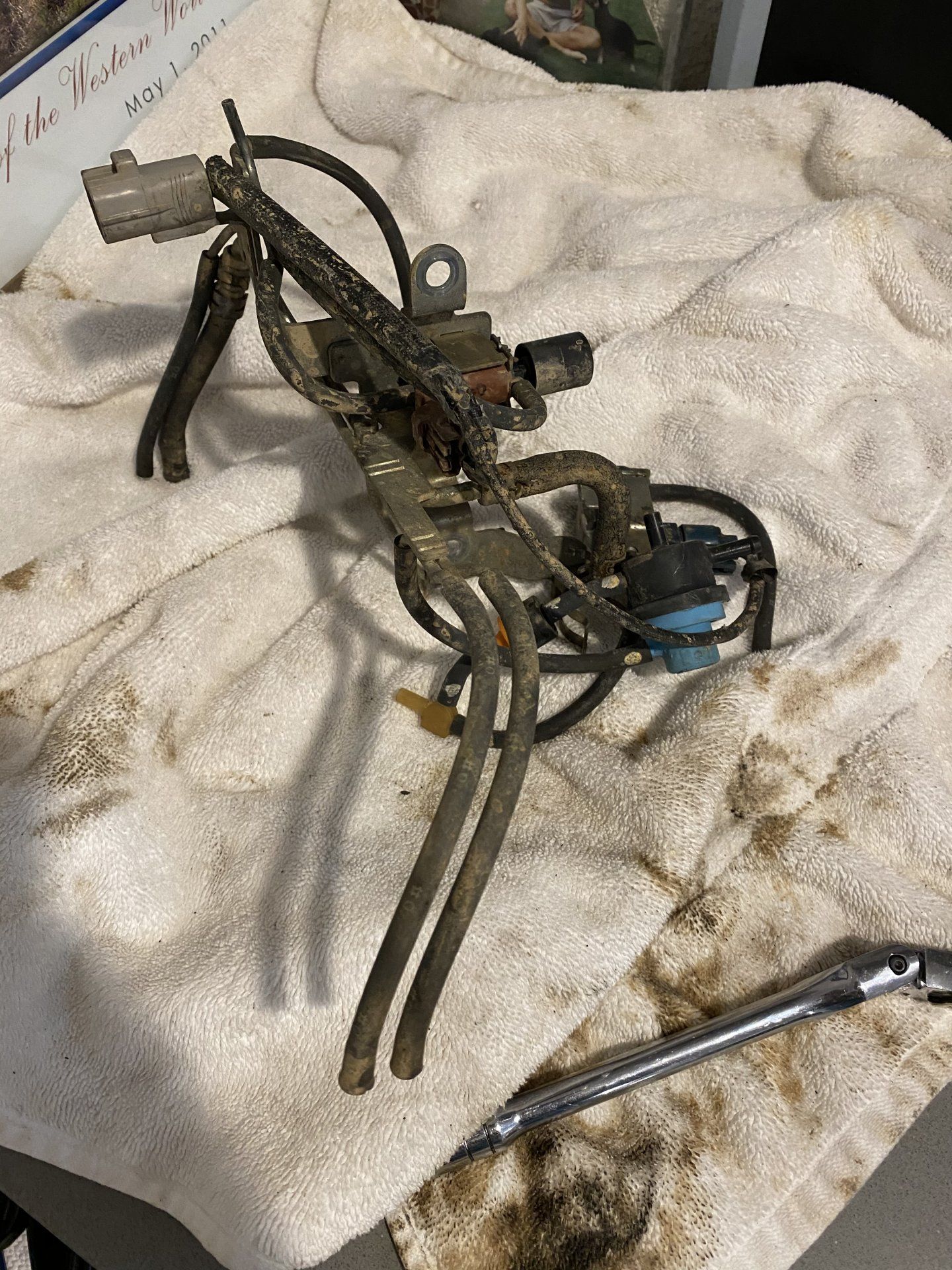

Over the past couple of days I dropped and reinstalled the fuel tank, not a job I want to repeat. The need was to locate a fuel leak. A few weeks ago the 80 was filled with gas and while parked on a slight incline, facing up the slope, liquid fuel began leaking. Planning ahead I ordered new gaskets, fasteners, hoses (except for the two associated with vapor lines), fuel sock.
Dropped the tank and installed new gaskets, etc. Fuel had been leaking at the large hose connection on the tank, the hose clamp was loose and the hose old. Used a floor jack, a couple of jack stands, and a smart 16 year old and the installation was easier (but not easy) than I had expected.
I had overlooked ordering the two short hoses that connect to the top of the tank and mine were looking rough. Checked with local dealership and of course not in stock, but if ordered would be $15 each. I reused what I had. I decided to use heat shrink to "refresh" :lol: them. Not sure how this will hold up but I don't think they'll be splitting anytime soon.
