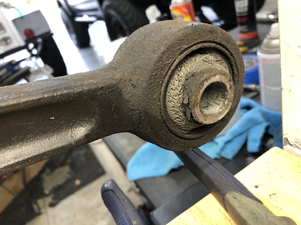

I've had a clunk noise I haven't been able to figure out for the past month. I had checked ALL the things, seriously. When I checked the radius arm bushings while they were on the truck they still looked good so I checked that off as not the problem. Well, after seriously checking just about every other possible culprit, I pulled the radius arms today and a few of the sleeves had separated from the rubber. Not something I could see while they were on the truck.
So I pressed in new OEM radius arm bushings today and voila! - no more clunk. Nice to finally have that not causing me headaches.

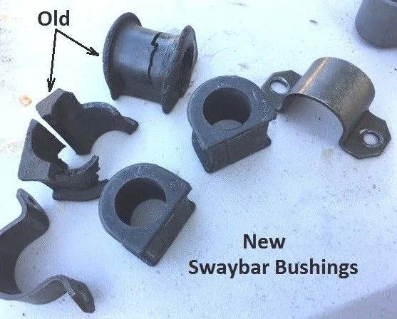

Front Swaybar Bushings and Links.
Old bushings were the originals and I should have done this a LONG time ago. All bushings had deteriorated from use and having been oil soaked. Links weren't completely shot...but very loose feeling and I replaced them as well.

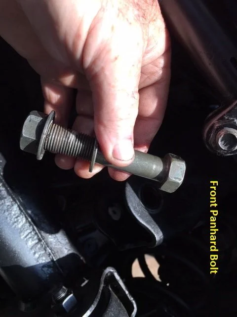

Panhard bushings are on tomorrows list.
Edit: Checked my Panhard Bushings this morning and found them to still be serviceable. So rather than make that my only project today, I will just do them later when I look at the rear suspension and what it needs. One good thing....I didn't have to fight any rusty bolts to remove the Panhard and inspect it. So glad I don't live in the 'rust belt'.
