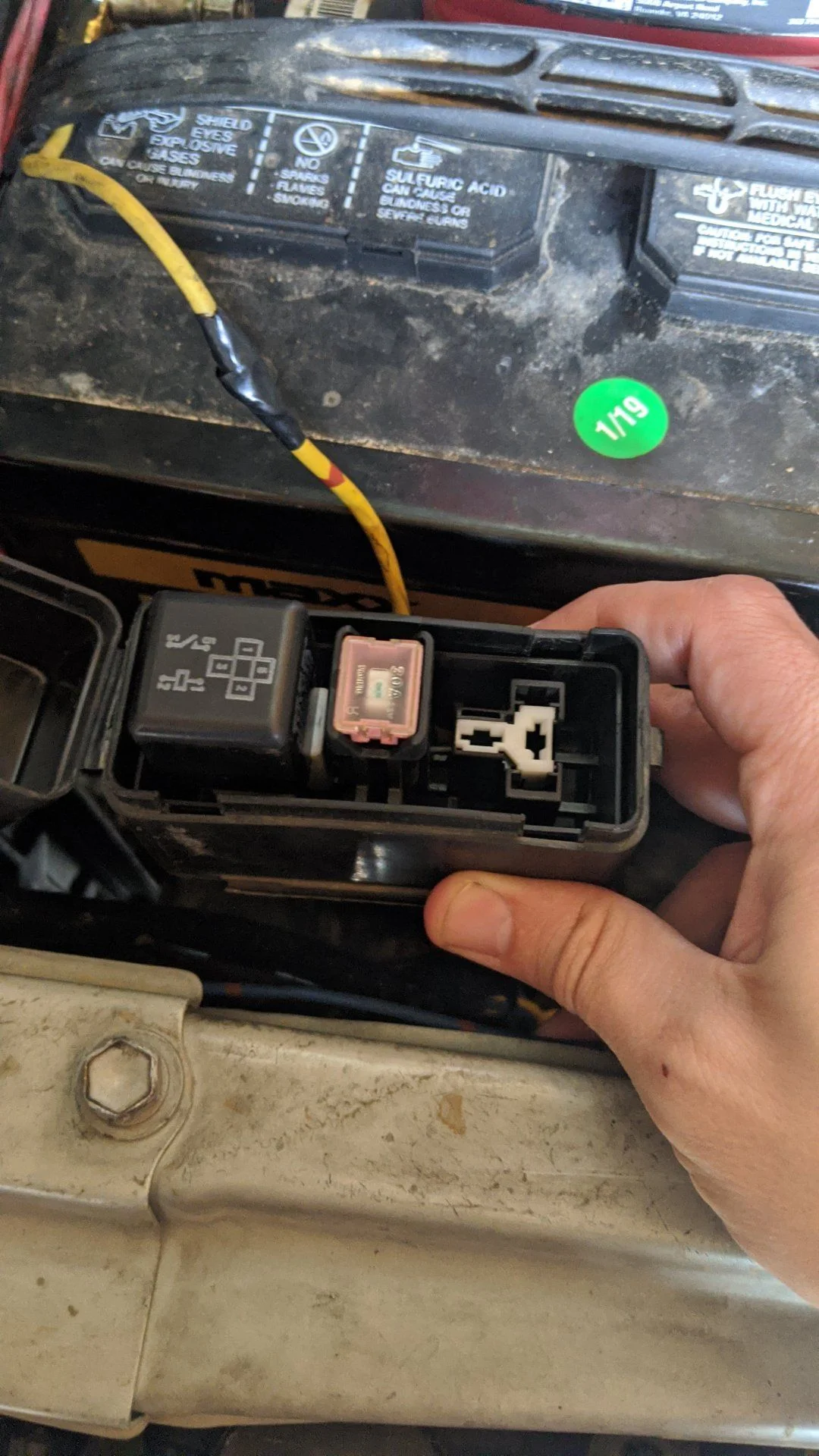

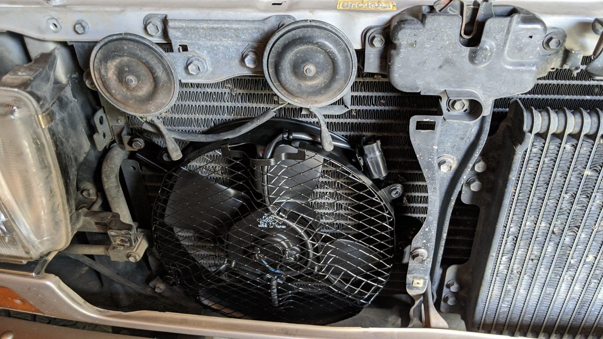

Installed the oem aux fan using a 95 4Runner wiring harness, fuse and relay. Works like a charm. Wired it to the AC pressure switch so it turns on and off with pressure/temperature per SUMTOY's instructions on ABC's of cooling.
Weird timing. I'm wanting to start this project. Do you have a direct link to the instructions from Suh dude? Did you run into any complications? Any tips?
Update. Just found the thread.
That's the one. I also looked at his 2nd edition for clues. I ended up grabbing the whole harness and relay box off the 4Runner and using one of the two relays and the 30 amp fuse. Had to decipher which terminals did what but I figured it out in the end. Still need to clean up the wiring and find the box a permanent home though.
Awesome. Thanks for posting pics. I'm surprised there wasn't any in that how to
