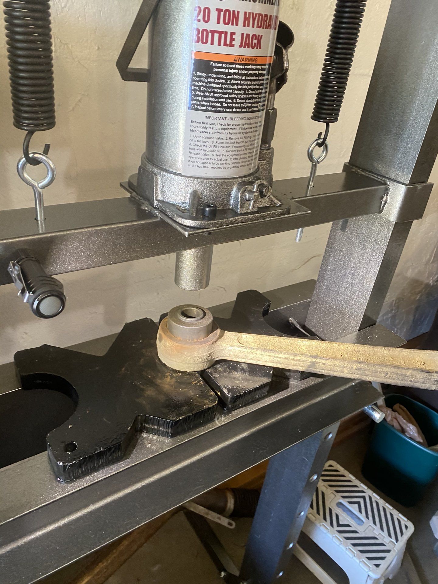

I finally cleaned up my recovery points and remounted. They are 1/4” bent plate.
Through-bolted with sleeves. Grade 8 hardware.
