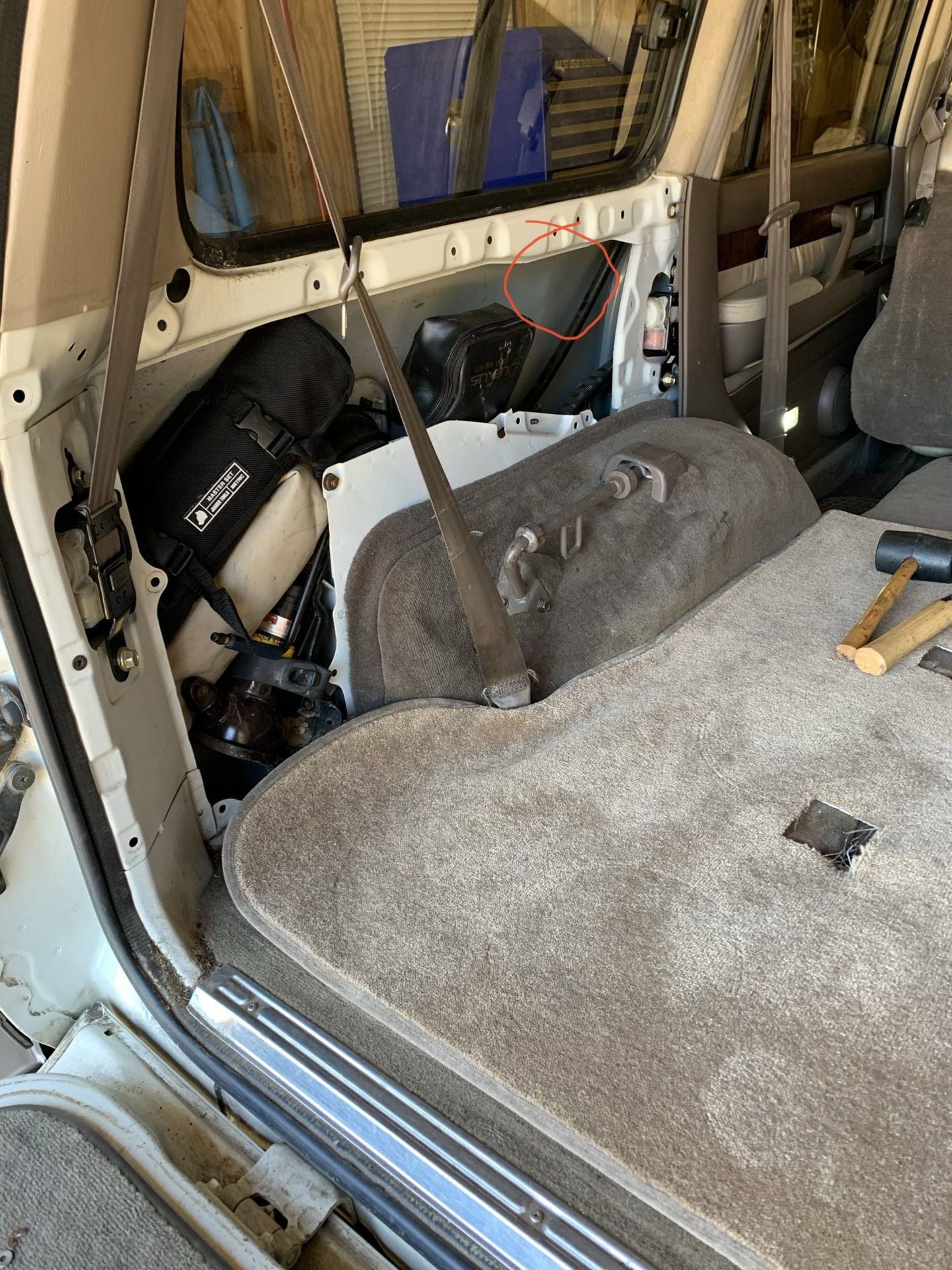

After 1 year of carrying it around in a hard case, finally mounted the bastard.
Panel snaps back into place and I still have access to the compressor. After a year, ****!n? Finally! It took a pandemic to give me a reason to mount it

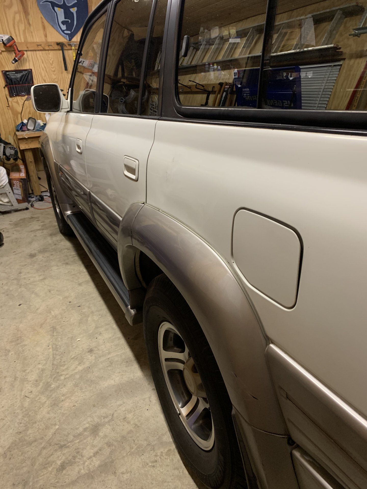

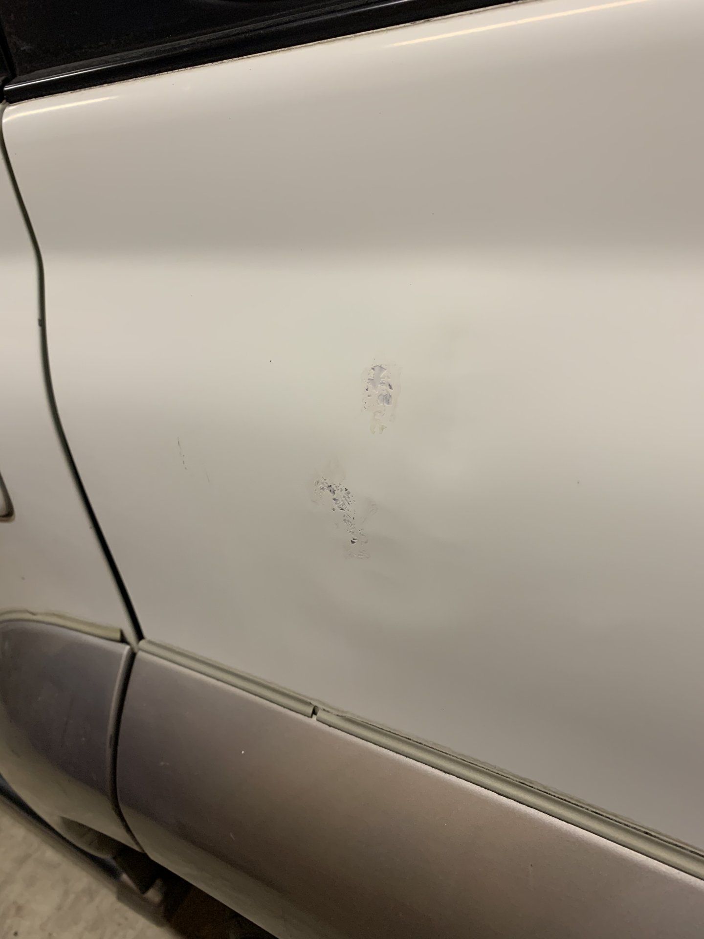

Tried my hand at some dent removal. Used a couple of rubber mallets. Held one at different spots around the dent and tapped with the other. Not perfect, but much better.., first two are before and last two are after
Good lord. I need to put this higher on my to-do list.
This truck came out of Cali last year, spent all the winter inside here so it’s all from its previous life.
