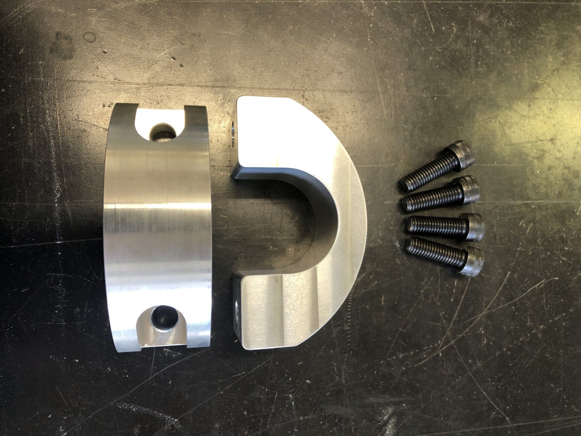

Recently I became a tester for a new product from Witsend Landcruiser products. A few months go I contacted Joey @NLXTACY at Witsend with the idea of making a thicker more bash proof rear sway bar to axle retention strap. So far I’ve destroyed two pair of the stock stamped steel straps and bushings subsequently. I run a dc dear shaft with the pinion pointed up toward the T-case so my sway bar and those straps are closer to danger.
Joey responder immediately and he sent me pics of what he had come up with. These are not yet on the market pending some testing which may be a while given current circumstances.
They are made of thick aluminum and came with 4 Allen head bolts. For me, installation was not exactly straight forward because my rear sway bar is bent which threw off the bolt hole alignment. I did manage but the bushings are in a bit of a bind and will probably wear faster because of it.
View attachment 2274647View attachment 2274648View attachment 2274649View attachment 2274651View attachment 2274652
Stock dia. swaybar?
