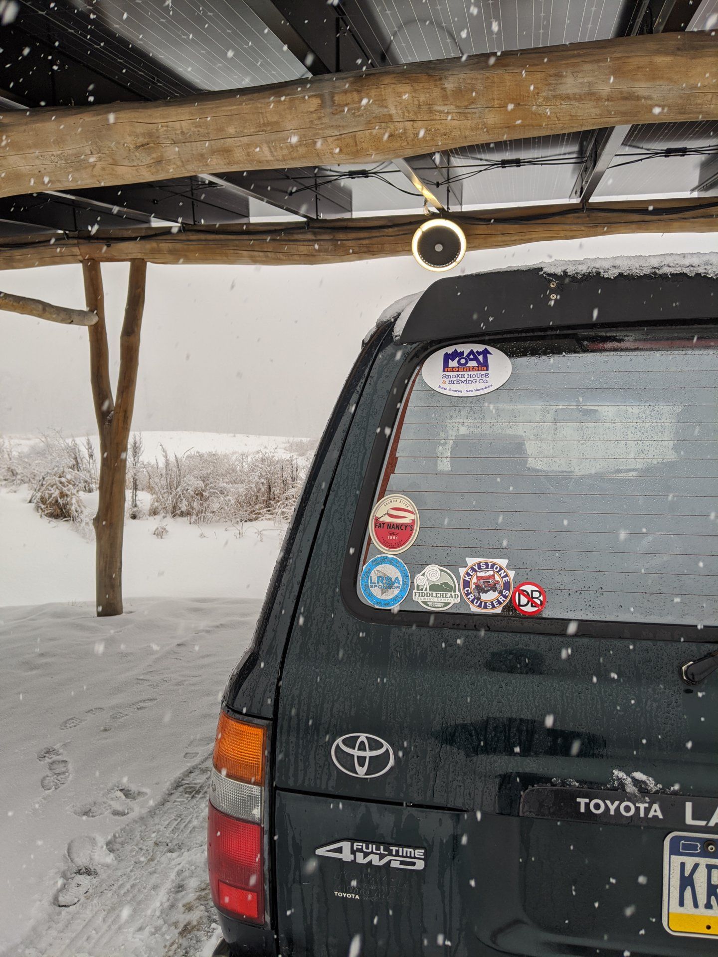

Surprise early birthday present from my girlfriend allowed me to add a few new stickers, a little over a 1000 miles, burned a bunch of gas, drank really good beer, had a bunch of excellent runs at smuggler's notch and generally enjoyed having my Landcruiser performing well in crappy conditions all while enjoying time with my most excellent navigator.
