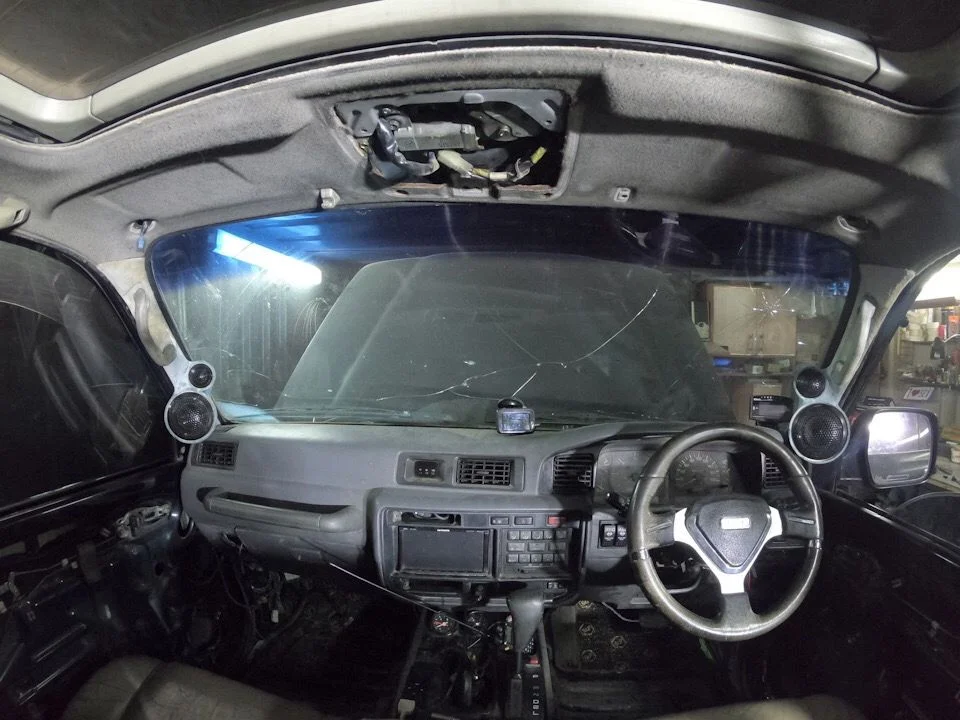

I was driving my 1 ton van pulling the trailer up I-5 toward Lassen and my daughter was, a few miles back, driving the 80 with her always present male friend. The front driveshaft sheered off at the u-joint on the transfer case end while going about 60mph. The driveshaft then began flapping about with quite a bit of force and immediately cut the brake lines. Next, a 5” wide hole was smashed open on the transmission. Lastly the driveshaft attempted to come through the floorboard to access the legs of my daughters always present male friend. Floor board was split and pushed up about 3” hitting only a back pack, thank God. This whole disturbance in the force caused the airbags to deploy in both their faces(the boy was sleeping at the time). Daughter pulls off the freeway but has no brakes. Boy pulls E-brake, no human damage. Not even her arms(10 and 2) were damaged. The windshield had been cracked for years from a very fun trip pushing through trees on the trail. I am guessing the passenger airbag deploying sent the crack into overdrive finishing off the windshield.

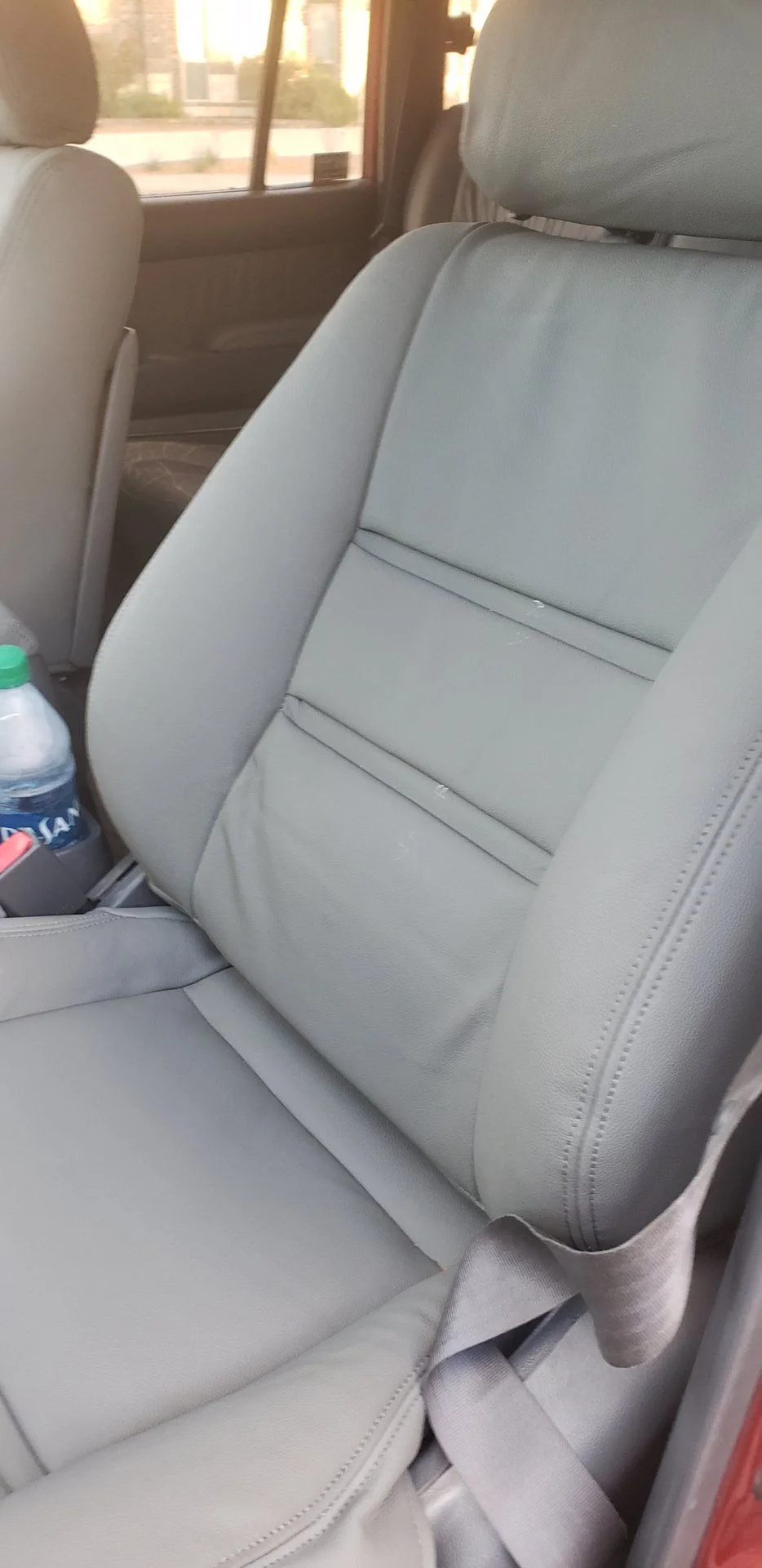

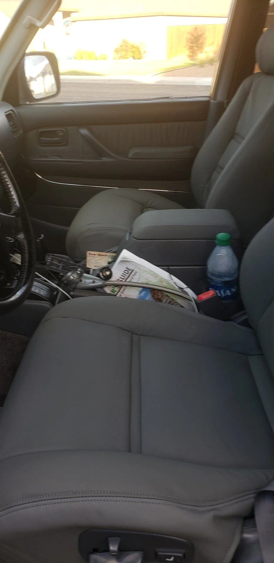

Picked up the cruiser from the upholstery shop today. I had them install my l seat kit. It only cost $250 for the installation and he had it done by lunch today. So it took him 4 hours. Pretty impressive. Overall he did a great job and the seats are comfortable. He wasn't impressed with the quality of the L seat leather but for $300 it's hard to beat and it's a night and day difference. He even fixed the pockets behind the seat.
