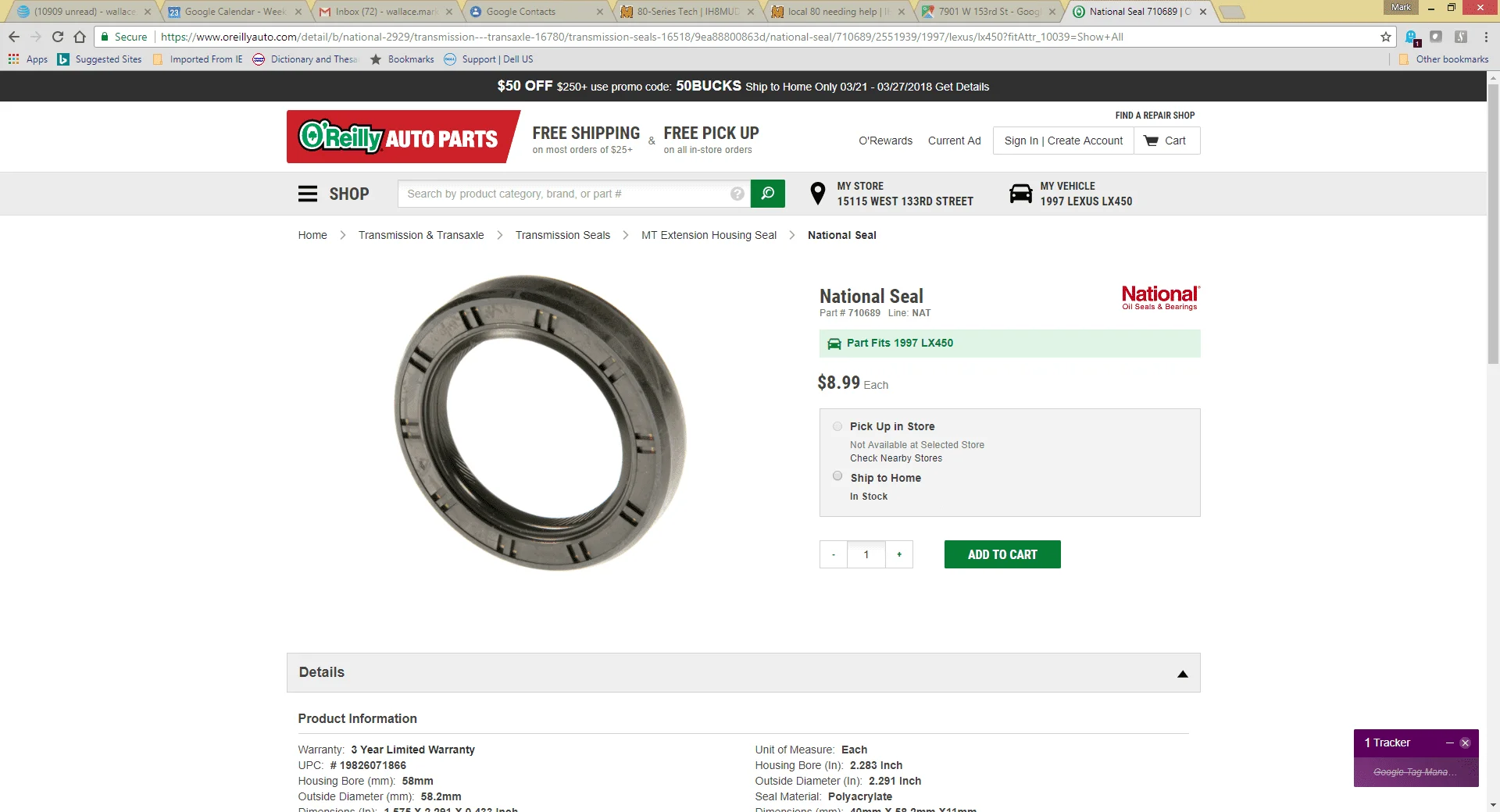

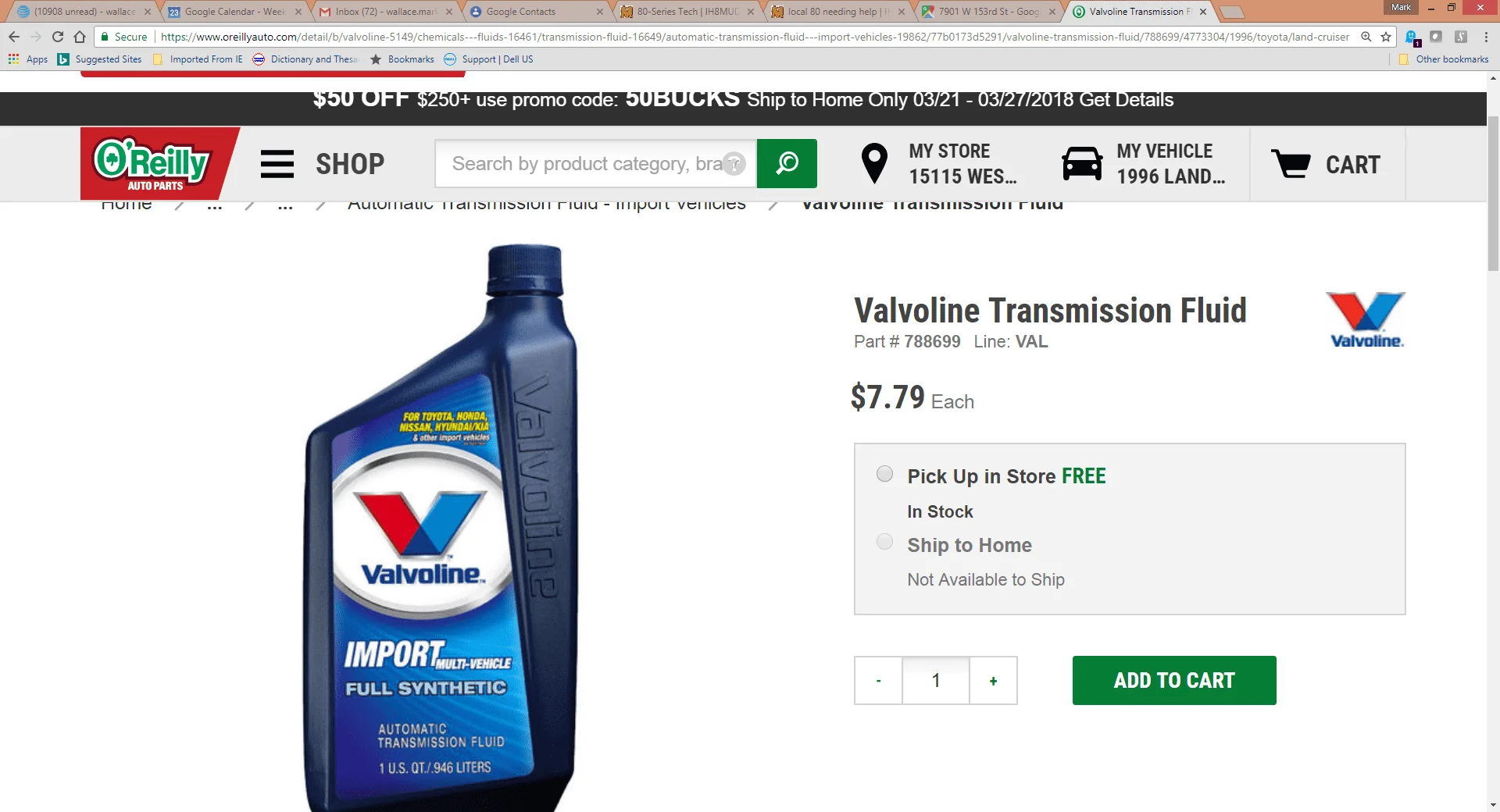

This is the trans oil I will get (I need to verify qty) and the front input shaft seal for after we drop it and verify that it works.
